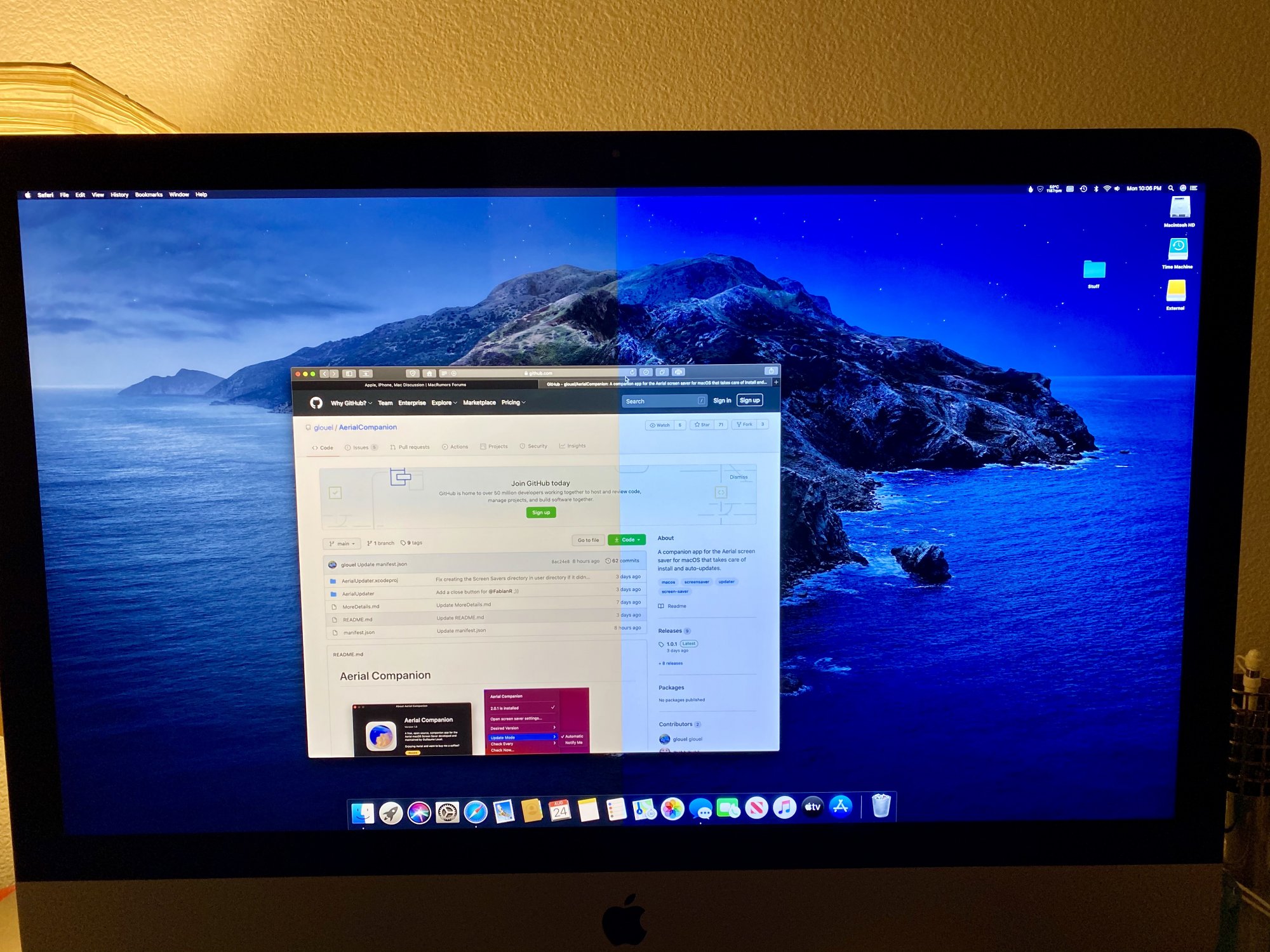

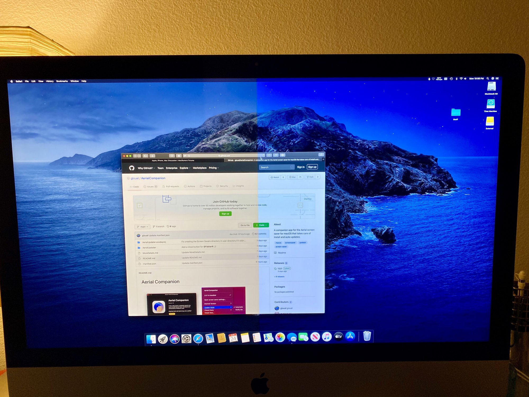

Okay something truly odd is going on here.
Last night, 4+ hours of usage, no flashing white line. This morning I use it for a couple hours, nothing. I'm out all day and get home about 3 hours ago and have been using the iMac since, again no flashing white line. Then as I'm using my iMac and playing around, I wanted to see if the Aerial screen saver would look any different if I change to a scaled resolution.
I typically stick with the default, but decide to change it to More Space (3200x1800) and then this happens (forgive the horrible quality and lighting conditions):
I have True Tone off and have Night Shift enabled, which has been on since sundown. Upon changing the resolution, half the screen is still in Night Shift, the other half not. My display is having an identity crisis! It persists this way until I change the resolution back to Default, then back to More Space, and it's back to normal.
Unable to duplicate this random occurrence anymore no matter what resolution settings I pick, if I enable/disable True Tone and Night Shift, etc.
This may or may not be related to the flashing white line that seems to pop up for us 5700XT owners. Has anyone heard or seen this happen on any previous generation of 27" 5K iMacs?
Whoa! Okay. This is pretty crazy. So, something about the left and right ports being out of sync? Sheesh. I really do hope this is a software fix.
This seems like a different problem than the flashing white line.
More space ("Looks like" 3200x1800) is a scaled resolution of 6400x3600 which is downscaled by the GPU to two 2560x2880 signals. One question: does the glitch happen with scaled resolutions (resolutions that are not the same as the resolution of the display)? For the 5K iMac display, the native resolution is 5120x2880 or "Looks Like/HiDPI/retina" 2560x1440.
