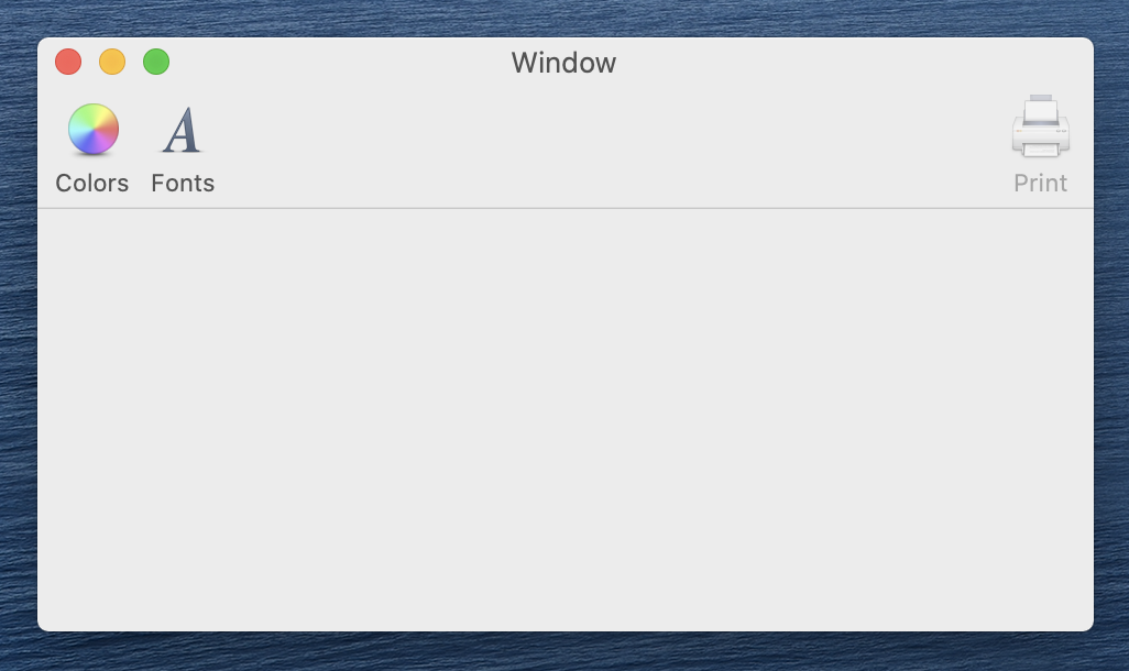

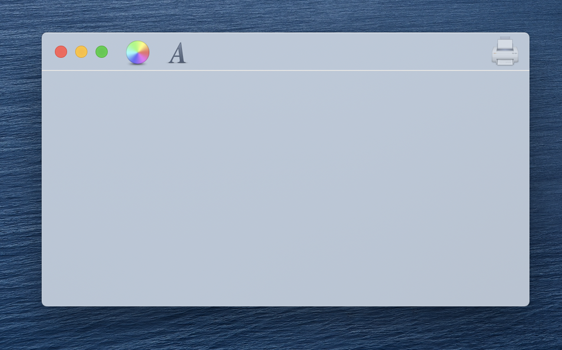

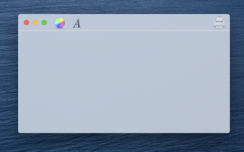

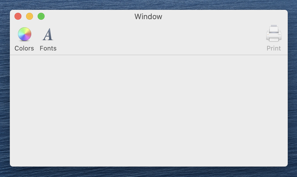

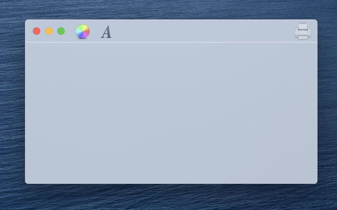

Did some testing in Xcode. By no means exhaustive.
But it looks like the only kind of window that does not exhibit the sharp corner issue is a window with a transparent title bar (see attached). I have never seen this widely used and most apps have an opaque title bar. As soon as I switch back to the opaque title bar, the corner issue returns. Whether the window has a toolbar (the area beneath the title bar or next to the close, minimize, maximize buttons) makes no difference. Whether the window has an actual title (the title text) makes no difference.
A typical real app window can obviously be super complex compared to what I tested and that combination of components can introduce issues on its own.
While doing this, I also saw one white line that extended from the edge of my test window to the edge of the Xcode window. With the white line appearing when the corners were rendering correctly, I wonder if there is an overall window drawing bug and it either manifests as square corners or as white lines but not as both at the same time.

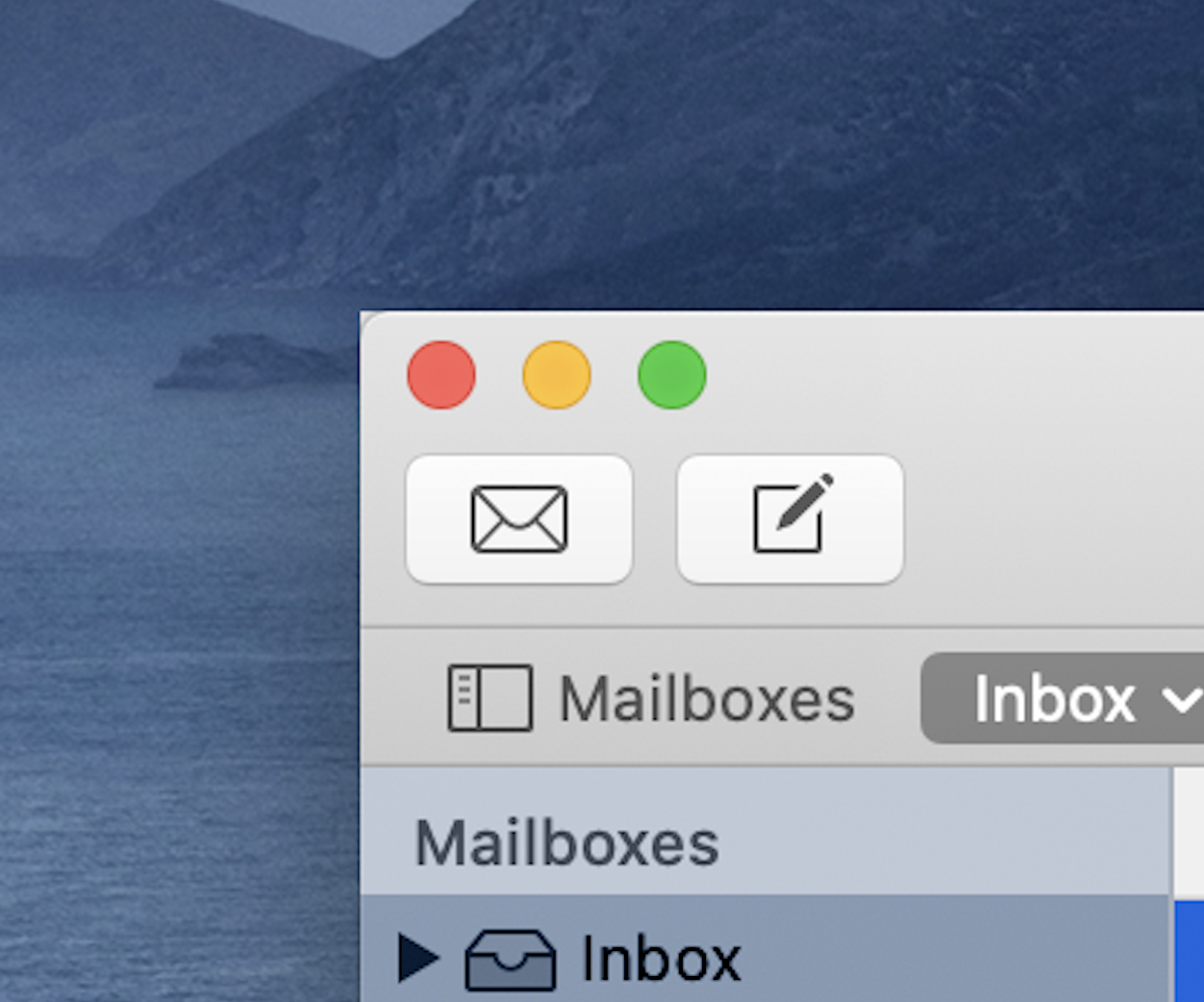

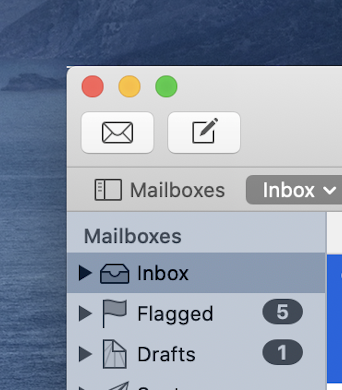

Another observation. Noticed this with Mail again.
If I have Mailboxes shown, with the translucent background, the top left corner flickering is constant when slowly moving the Mail window around. If I hide Mailboxes, the constant flickering goes away. But toggling between the Mail and other windows, the sharp corner still comes back. Same if I go to Accessibility > Display and check Reduce Transparency -- the flickering when moving disappears but the sharp corner returns eventually.
And, actually, when hiding mailboxes, the constant flicker goes away only if your inbox (or Sent, Flagged, or Drafts -- whatever you view instead of all mailboxes) is empty. If you have mailboxes hidden but you're viewing an email, the constant flicker when moving the window is there. So, here, it seems to be some kind of a combination of content being displayed inside the window versus not.

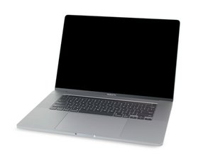

It's not exclusive to the 5700xt but also 5300/5500m MBP 16" . My guess is a driver problem with the 5xxx series that will be fixed soon hopefully since its affecting so many configs.
https://discussions.apple.com/thread/250894628
and my own submission on submission / description on fixit since I first thought it could be hardware related
For now it seems like on the MacBook Pro 16" it occurs when an external display is connected (D-GPU activated) and on the iMacs its constantly.
Because the iMacs only have D-GPU and the integrated GPU on the MacBooks is using different non-AMD drivers.

Interesting. Shift-Command-3 captures it every time for me. At least if it's the Mail window. But I've also seen other windows refresh to normal as I'm capturing them. I haven't yet experienced what you're describing: where it did not fix itself (it remained sharp) on screen while the screen shot shows it rounded. For me, if it stays sharp throughout the screen shot process, it shows up sharp in the resulting screen shot.

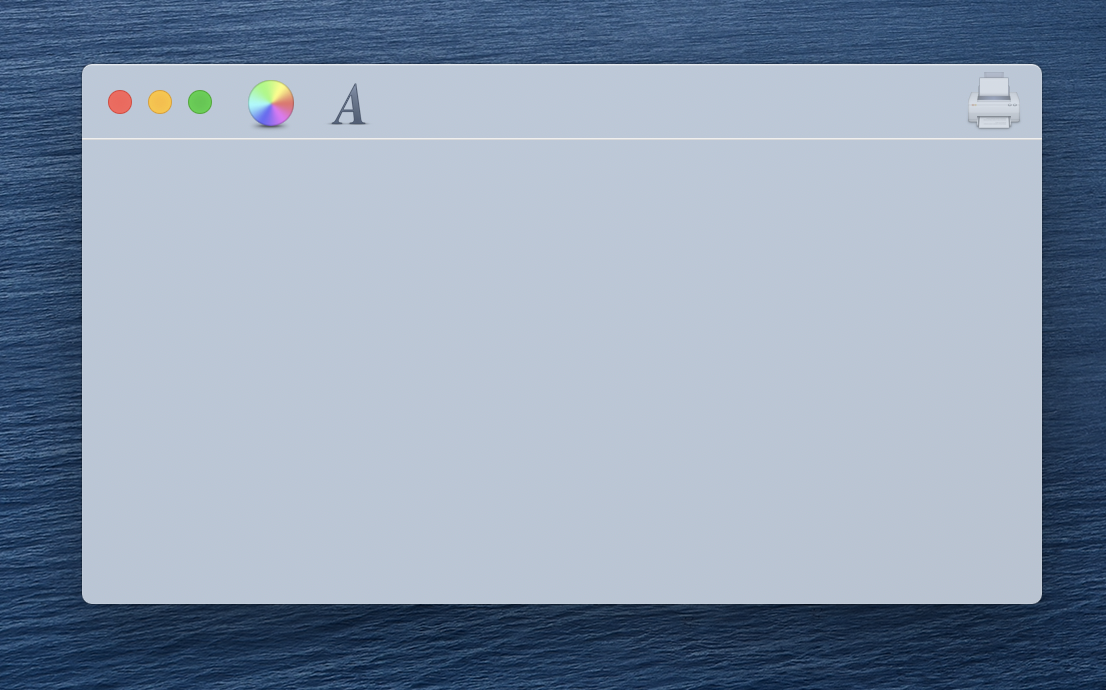

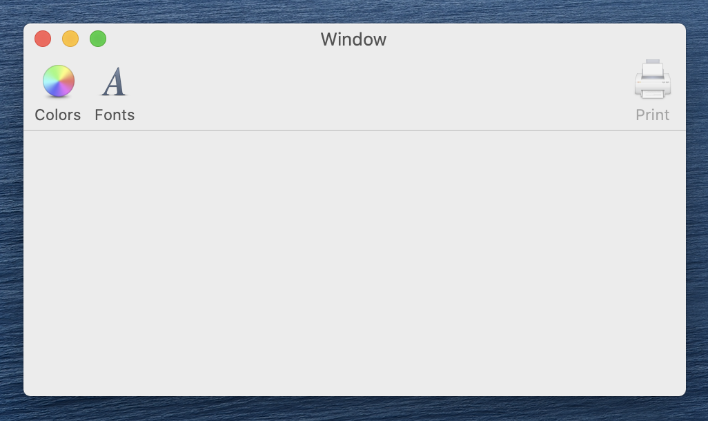

The two "versions" I seem to get very consistently are attached. A corner with no alpha at all. Or a corner with partial alpha, resulting in a solid line on top. Sometimes I get random opaque pixels as sort of a third version of this.
