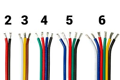

Just go back some pages, on page 12 there is a guide through this.
The cables to connect D+/D-/3.3V are normal flat cables you know surely...
Soldering is easy, I pulled the cables out of the old BT connector one by one and soldered them to the three lines with goes to the adapter board.
The antenna connector looks good, you need the IPEX-4 ones.
If you have no solder point for the 3.3V line it is the leftmost pin on the new smaller port for the new card. You will find pictures showing it in this not so long thread. Search it and read it!
Soldering is easy, I pulled the cables out of the old BT connector one be one and soldered them to the three lines with goes to the adapter board.
