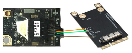

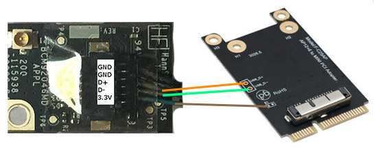

You have to solder both ends :) The 3.3V cable connects to the rightmost PIN on your extension board adapter slot. Somewhere are pictures how to solder that one correctly ....
if you mean. read my tutorial.. yes indeed I have done so, also I did do extra investigation on how to connect, and hook all up.
I'm thinking about to de solder the connector on the old Bluetooth card and put it on the new adapter board. so the connector Just slide on.
as I have no purpose for the old Bluetooth board.
merci for the wiring diagram.

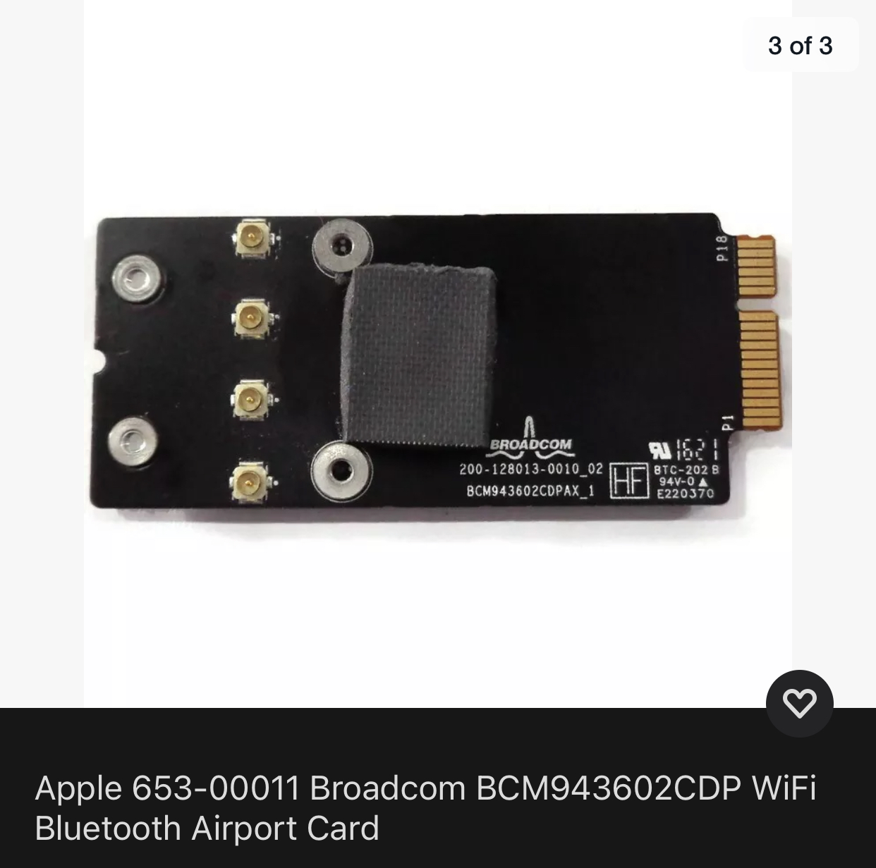

Not sure if this is an indicator, but the BCM943602CDP I had was APN: 653-00005, and reported as BT 4.1. That seller accepted the return so on its way back. I doubt if that alone was the issue, and more likely it was just defective.
I see other sellers listing these with APN: 653-00011, but not specifying the BT version. I may try one of those. Only the OSXWiFi kits with the BCM943602CDP specify that they are BT 4.2, though priced at double or triple the price, and not wanting this upgrade that much.
Based on those that have Catalina unlocking do we know that was only with BT 4.2? I did read through all the pages in this thread and only saw it mentioned a BCM943602CDP card was required. Although BT 4.2 has features I would like, my main concern is that it unlocks with a S4 watch.

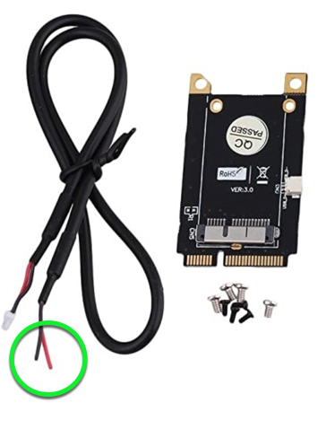

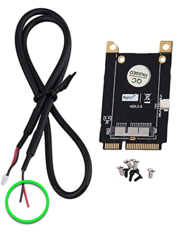

This should be an easy question :)
I understand everything I need to do this update to my Late 2009 27" iMac i7-860.
However, I don't understand how to get the required 5V power with a wire as shown circled in green below. Obviously this needs to attach to my logic board, but I'm unclear on where/how.
Also, when using the BCM94360CD, will I need all 4 antenna connections? Current iMac is of course using two for the existing Wi-Fi antennae, and one for the Bluetooth antenna near the top center of the chassis. What is the 4th antenna connection for?
3x Wifi, 1x BT, you can buy a WiFi single additional antenna or you just connect the two of your iMac to channel 0 and 1.
I am sure somebody had written this before, read this not so long thread to gather all possibilities...
Reactions: BeatCrazy

Hey all --
This upgrade while it seems simple, there sure is a lot of informations spread out all over the place which makes it ultimately confusing to try and follow. I have a mid-2011 27" iMac and I'd like to upgrade it. It looks like some web sites are sending another bluetooth antenna (antenna wire that goes to an antenna board) along with a power cable. Then some other places don't send a power cable.
I'm a do it yourself type.. I've already upgraded the video card in this machine to a K4100M. How do I know if I need a power cable or not for this Bluetooth card? Does it depend on the card? Any insight would be helpful. Thanks!
Yeah, you're gonna need to get power, typically be re-purposing the wire(s) going from the logic board to the original bluetooth module. I just ordered an extra cable so I can hack away at it.

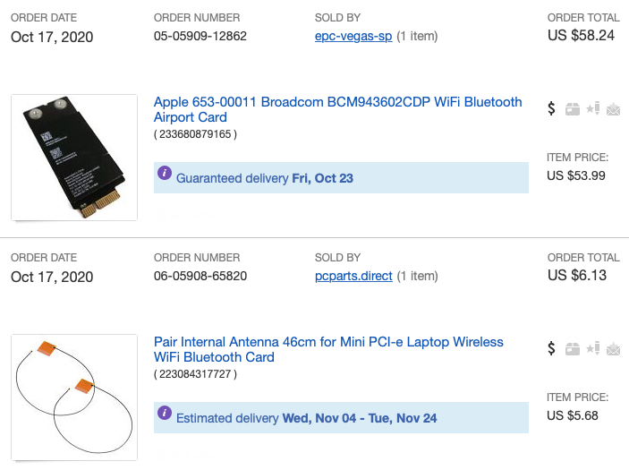

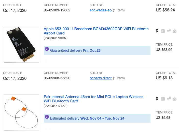

Found a BCM943602CDP which supports BT 4.2, and is en route from eBay. I think I have all the associated pieces, also. Assuming I have success, I'll be sure and post pictures and my end result in this thread.
Awesome, please let me know how it turns out. I really want the Apple Watch unlock feature. Would you mind sharing the link to the board you bought on eBay? I think I’m going to buy one.
Are you going to extend the BT antenna cable or are you going to install a new, separate BT antenna? I saw some that go to a little board that they’re calling the antenna but not sure how well they work. They claim they work really well.
Here’s the one I bought: https://www.ebay.com/itm/Apple-653-...2CDP-WiFi-Bluetooth-Airport-Card/233680879165
Yes, I plan on using a pigtail extension and this adapter: https://www.amazon.com/gp/product/B0762N451V/

I bought the same one, I agree with you that I think that's the one that's 4.2 and that will for sure work with our Apple Watches. I also got an antenna extension as well as a separate BT antenna board thing that I can use if the existing antenna with the extension doesn't work so well. I'll post everything with pics when I get it along with the data.

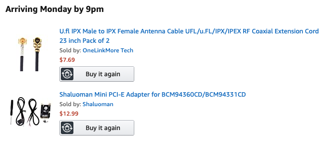

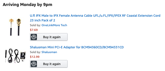

I figured between the items below, I should be able to make it work. Two options for the antennas in case one doesn't work well.
These are the items I bought:
Curious on why you bought the extra antenna? I realize they're not expensive, and there is a spot for another connection, but from my observations, it just doesn't seem like there's any place to stick one? Of course you can stick it anywhere, but the "good spots" like behind the Apple logo, and near the top of the chassis, are already taken by the existing two.
Also, how do you plan on getting power to the mini PCI-E adapter? I bought that same one from Amazon, it arrived today. Looks like I got a "Gen 4", which has some extra mounting points in the center in addition to the top end of the card. I think there's gonna be some hackery needed to get the BCM943602CDP to attach securely to this particular adapter.

I bought the other antenna so I would have an option on hand if I needed it. If things go as planned, I’ll use the existing BT antenna and just extend it so I do t have to find a location for it.
After seeing some of those adapter boards, it looks like the upper portion is just for mounting points. I could drill out a new hole and put a screw and stand-off in there. Will see what I get and what I end up doing. Will post some pics and such.
In regard to power, I’ll have to see if the included wires are able to reach the old Bluetooth board location and tap in there if I can. Otherwise I’ll have to do some more reading.
