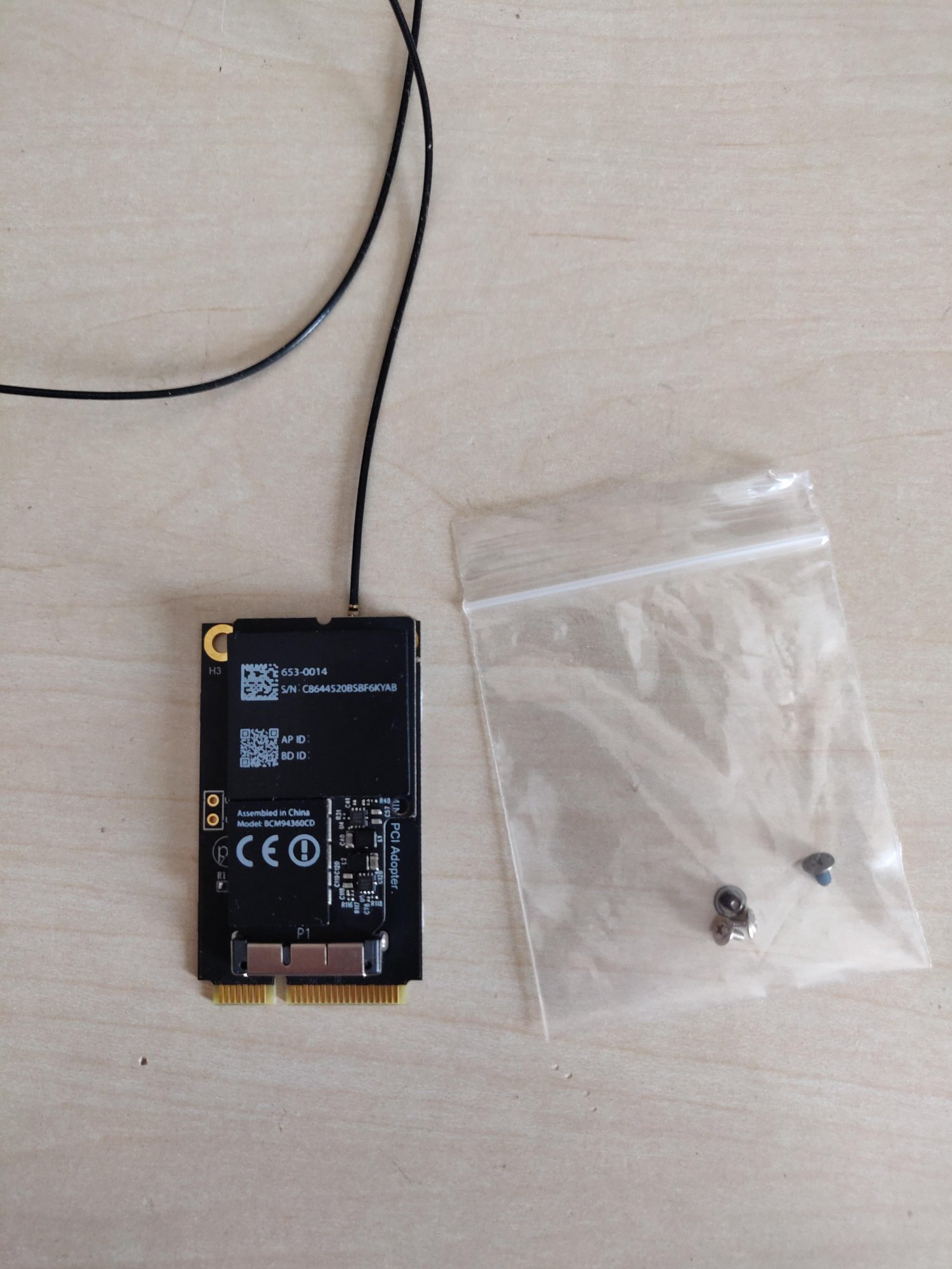

got the board + adapter. (no it din't come pre attached/inserted)
and RF cable to connect to the other side of the imac.
now the fun, again take the imac apart again. but for this mod. i dont have to dig so deep.
😅 if i can do the GPU and CPU.. this wil be a a easy job..
You have to solder both ends :) The 3.3V cable connects to the rightmost PIN on your extension board adapter slot. Somewhere are pictures how to solder that one correctly ....
