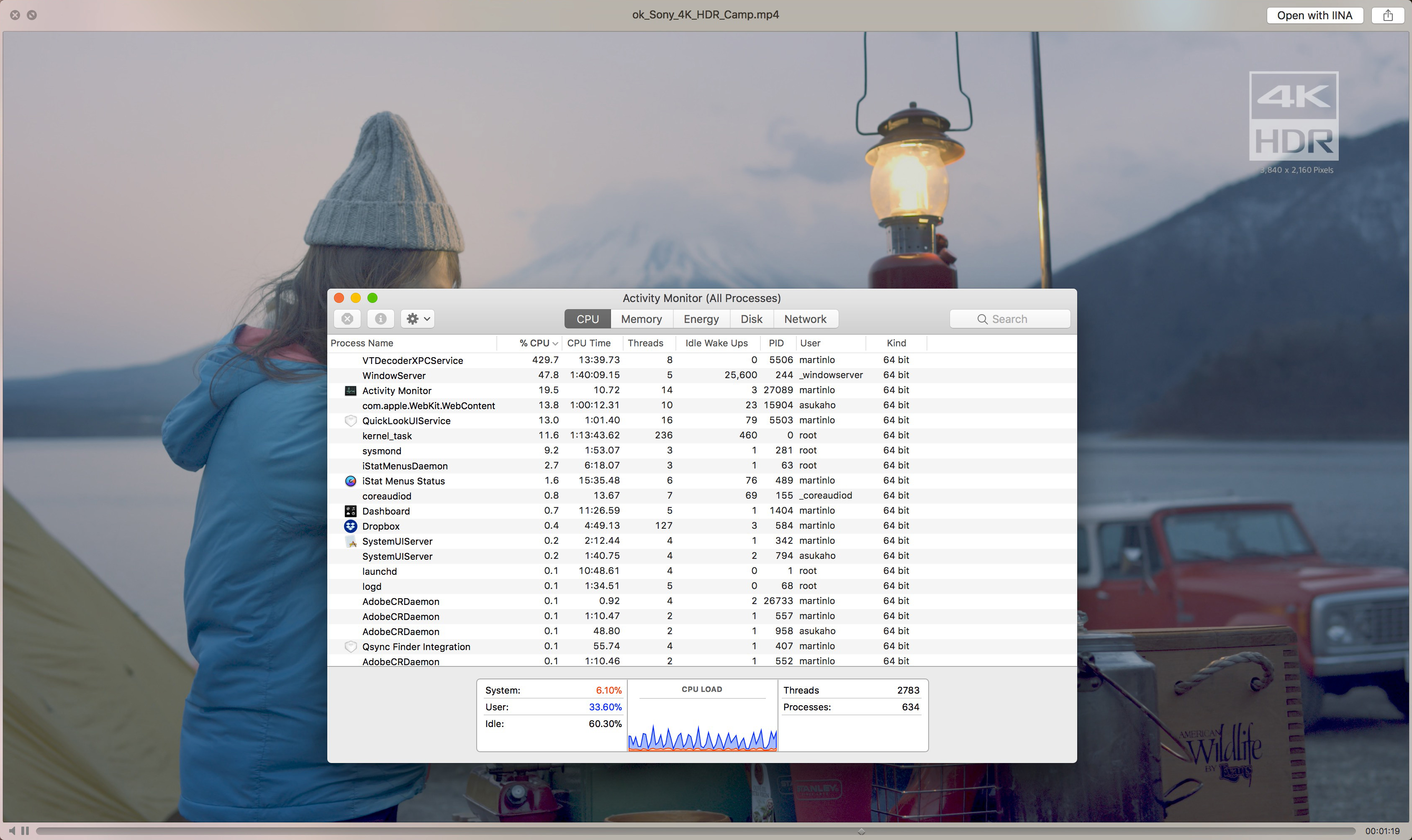

Reposting myself from the MacBook sub forum, but here is my recent experience:
I downloaded this 10-bit 4K HDR HEVC "Sony camp" video. It plays back on this machine perfectly smooth, using ~8% CPU. Since this machine has Xeon processors with no Intel Quick Sync Video, I have to assume that Apple has optimized the built-in AMD Radeon Pro Vega 56 to support decoding of 10-bit HEVC?

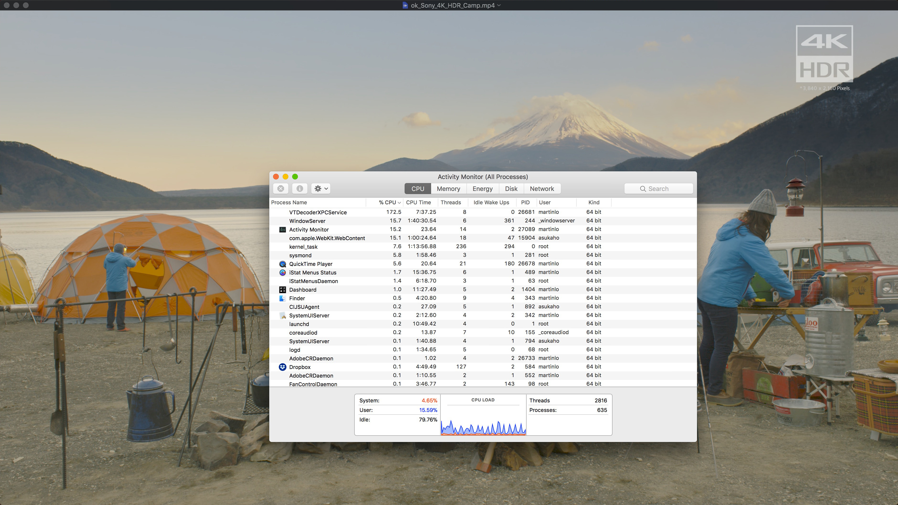

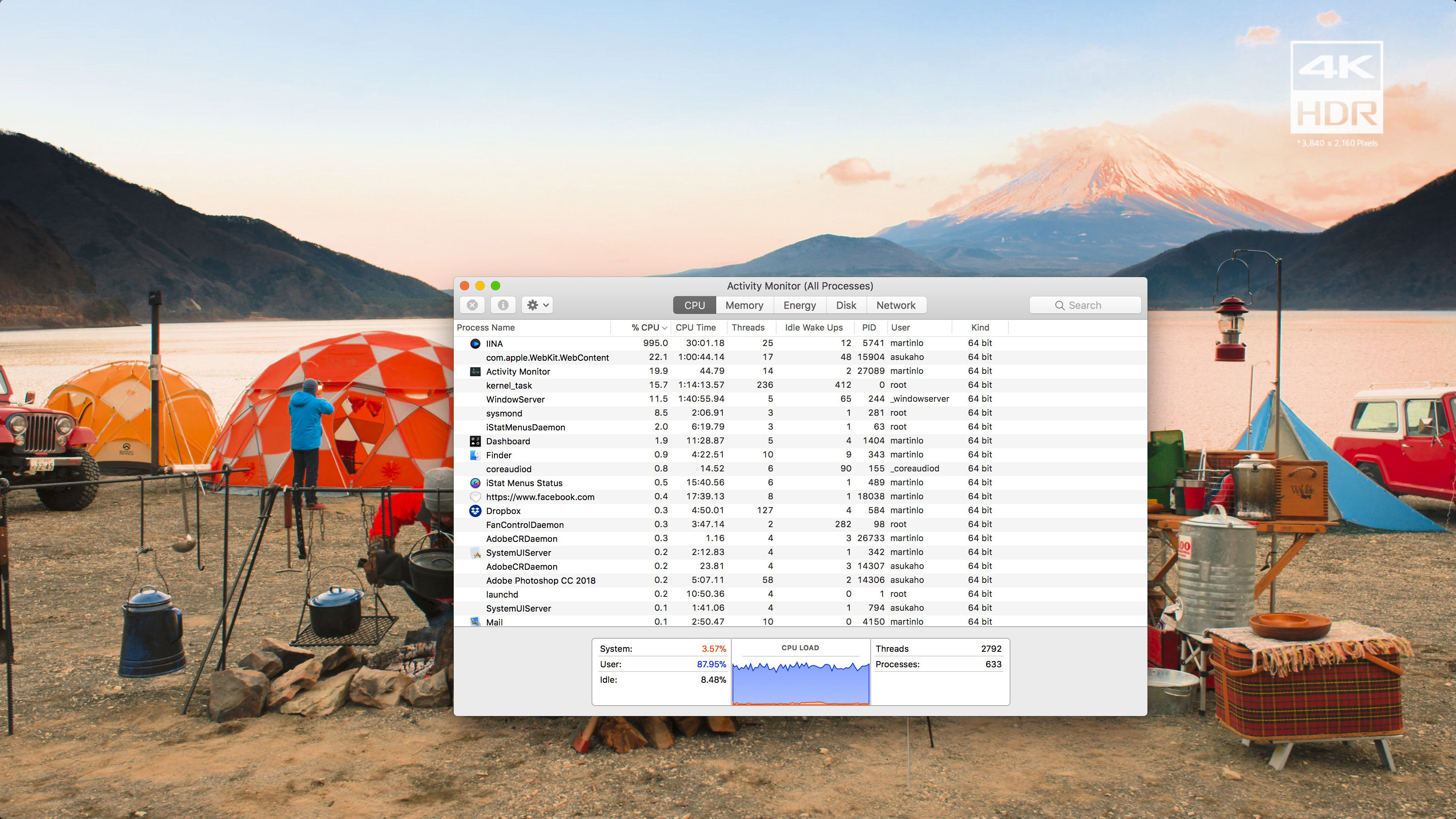

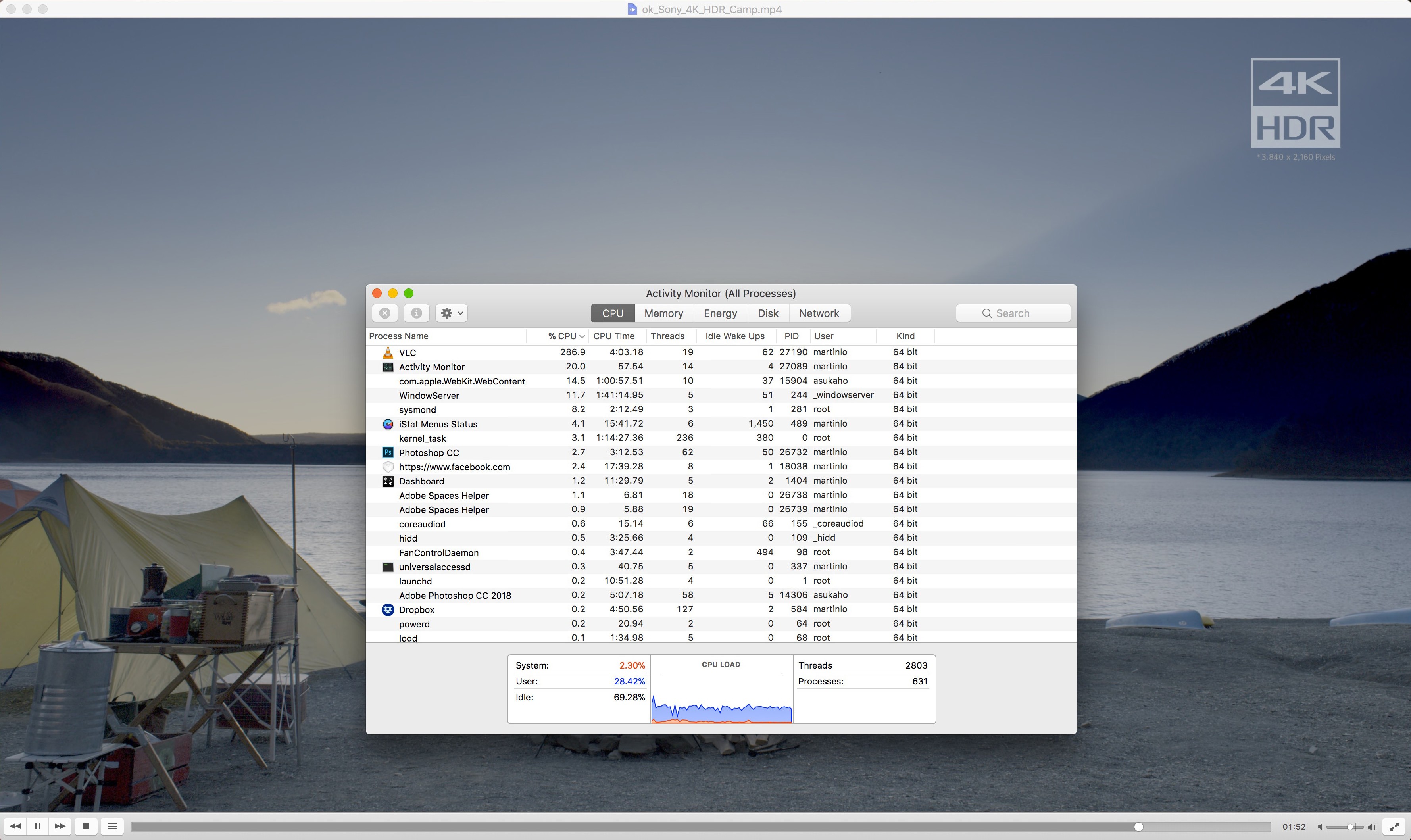

Just did some test with that video. I think there is nothing to do with the GPU acceleration, but just because the iMac Pro has a stronger CPU.
When I use Preview and QuickTime Player. The CPU usage is low anyway. And this is on my ancient Mac Pro 5,1 with the old Xeon. The video is definitely not smooth, but it plays.
Preview: The CPU load history shows that the CPU is intermittently used, every time when the usage drop to zero, the video will be freeze for a moment (choppy).
QuickTime Player: Basically the same as Preview (of course, preview is actually using the QuickTime player in the background)
IINA: playable, not smooth, and high CPU usage.
VLC: Low CPU usage, but there is no "video" at all, it's always stay at the same frame. Click on the time line will move to a new frame, music normal, but no video.
Even on my W3690, the average CPU usage to play this video (in QuickTime) is just above 20%. I can imagine on the iMac Pro, the CPU usage can further lower to about 10%. Which actually match your observation.

nightly builds of VLC play HEVC videos just fine ->
https://nightlies.videolan.org/build/macosx-intel/
Thanks, just tried the latest V4 nighty build. Still no joy with the 10 bit sample.
But 8bit can play smoothly with around 600% CPU, better then IINA actually.

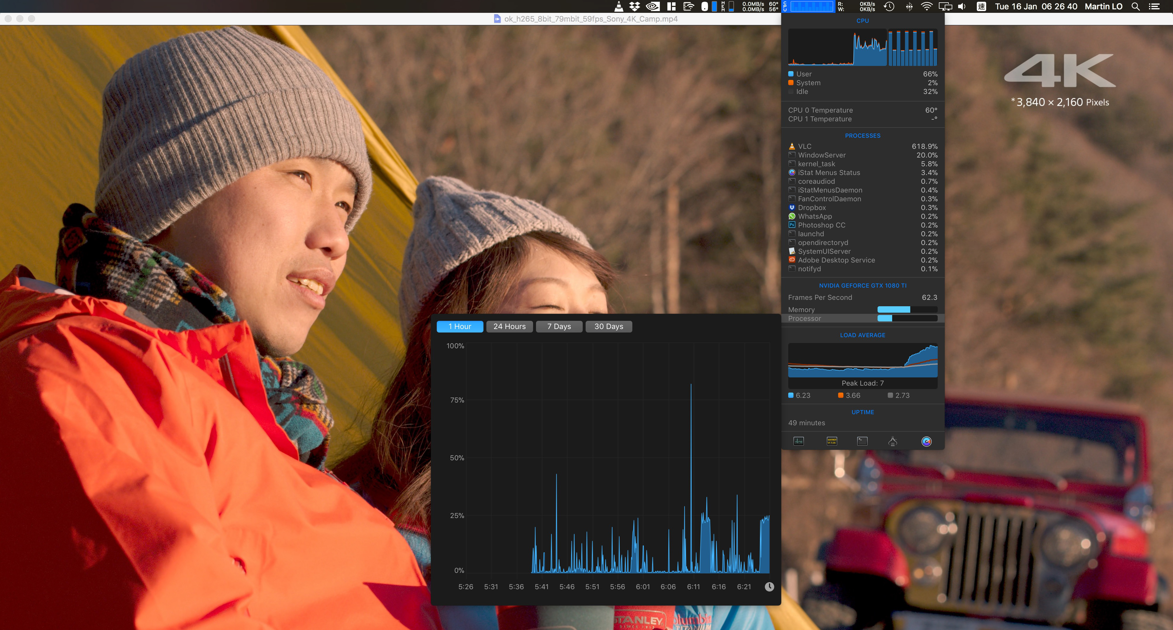

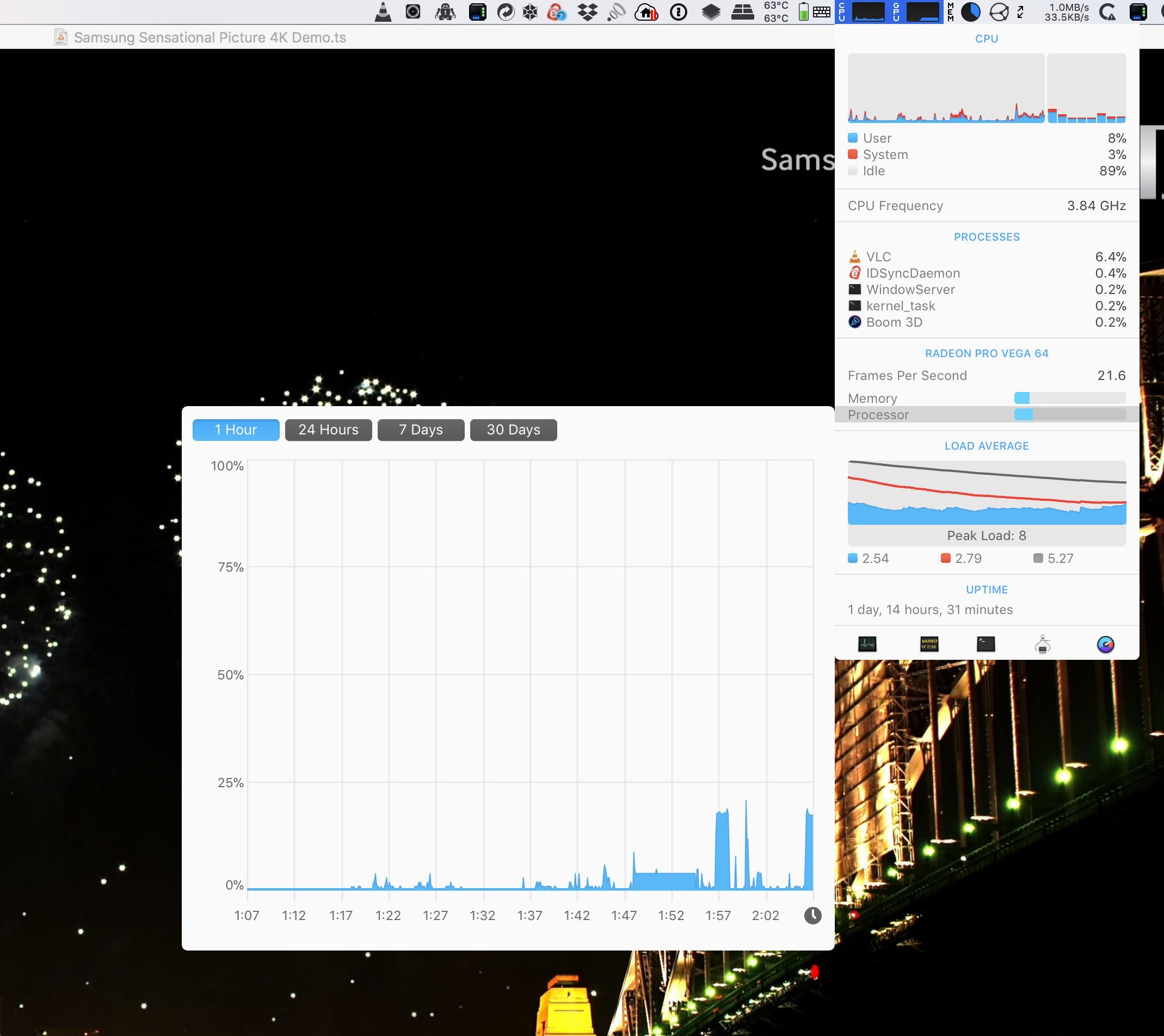

I've check out HVEC decode, VLC4 is using about 15% of my GPU (istats menu will show you). My Blu-ray player only uses about 5% & doesn't decode well...probably why the performance seems better.

So what could I do to test/confirm these theories? I don't use Boot Camp, but I'm mainly concerned on how macOS would/could support this anyways.
Surprisingly, I already mentioned that it is hardware accelerated. I'll post a test of the proof in a few mins.

Ok, if the T2 is doing some of the work, it's helping the GPU. My confirmation would not have produced a significant GPU hike. To produce this, you need a very large 4k HEVC video. The CPU was not even bumped by playing the video. Likely, VLC is pretty poor at playing this. Also, quicktime does not recognize HEVC files of any container for me.
fixed

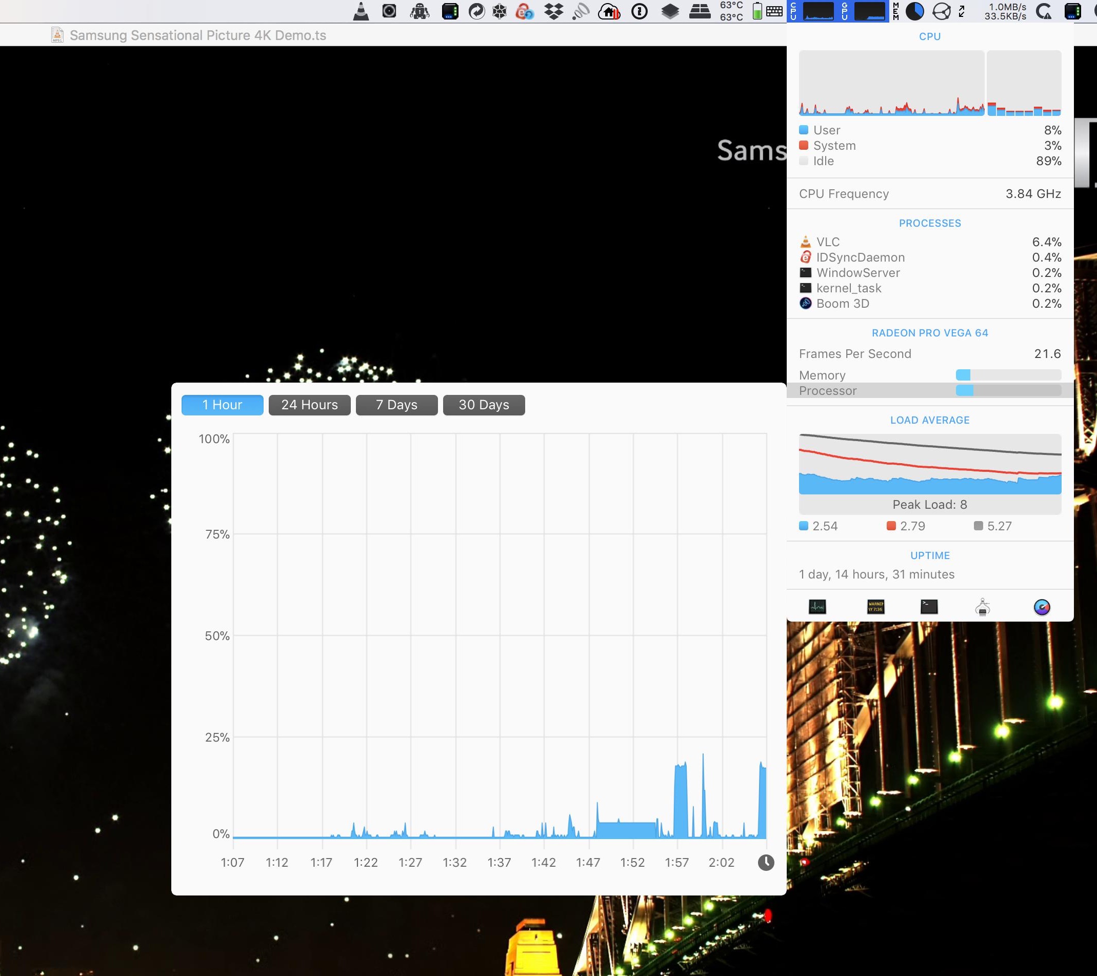

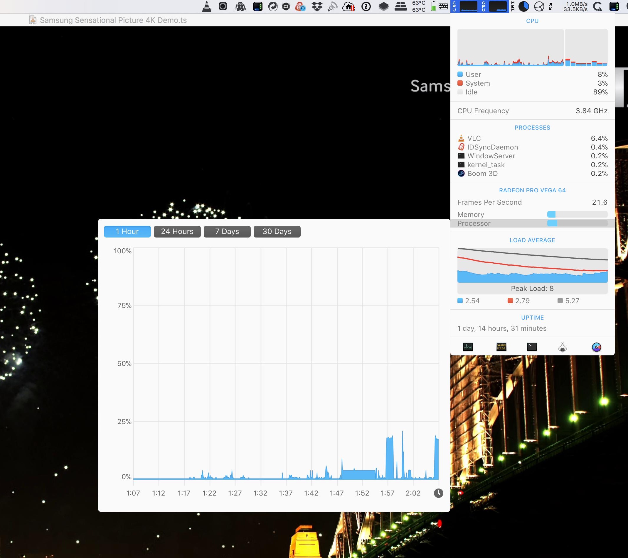

There is no doubt that the GPU need to do something when playing 4K video, but not necessary means the GPU is doing hardware decoding.
On my Mac Pro, 100% no hardware acceleration available when using VLC to play 4K HEVC video, but the GPU still has ~20% loading. It may be just because need to drive the pixels.
From your CPU usage, I totally agree that there should be some hardware decoding, but can't tell if it's from the GPU. If it's really from the Vega, that will be a great news.
