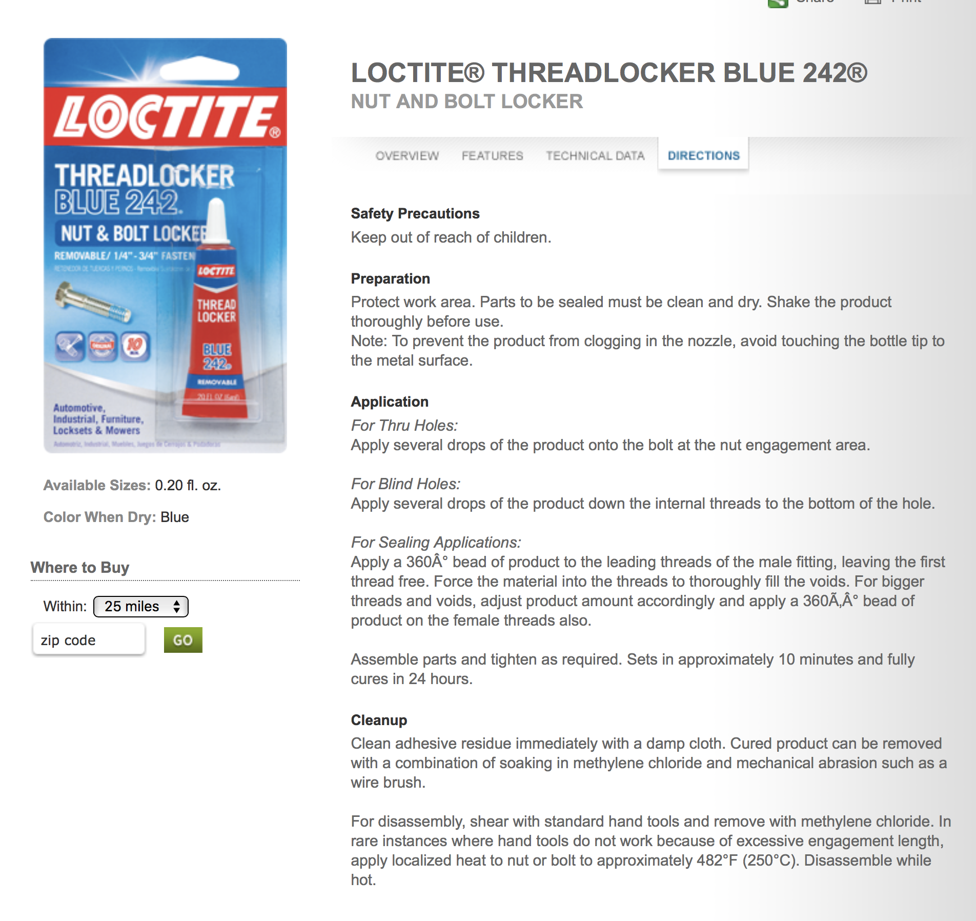

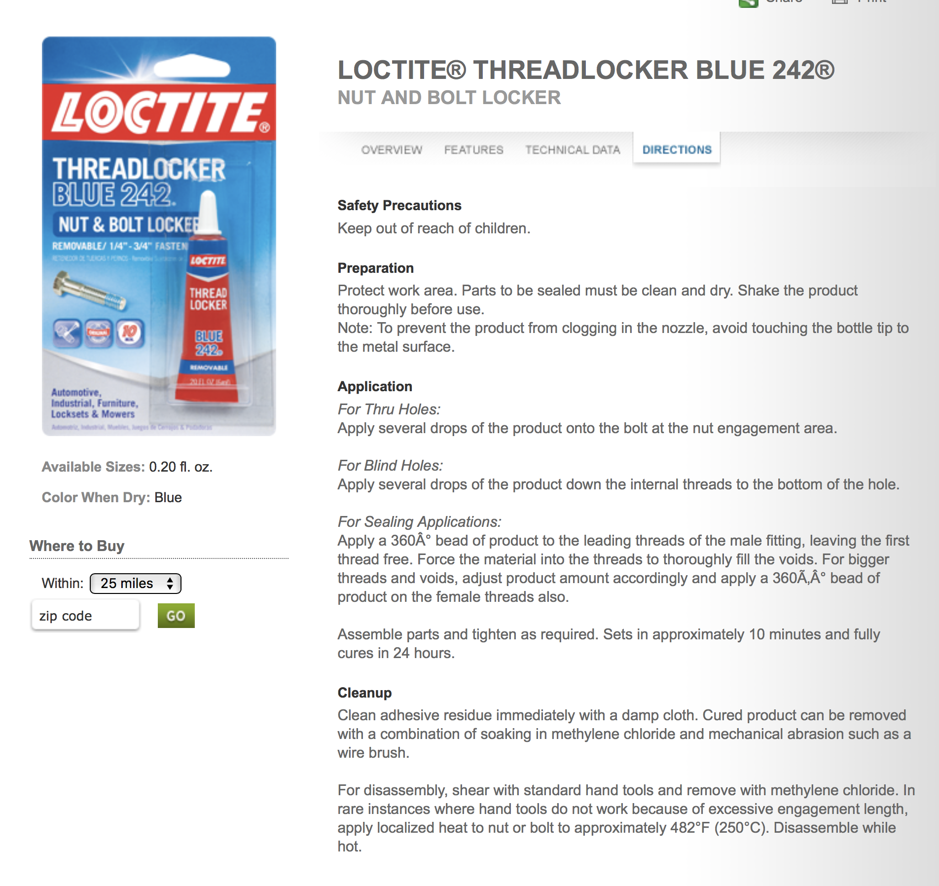

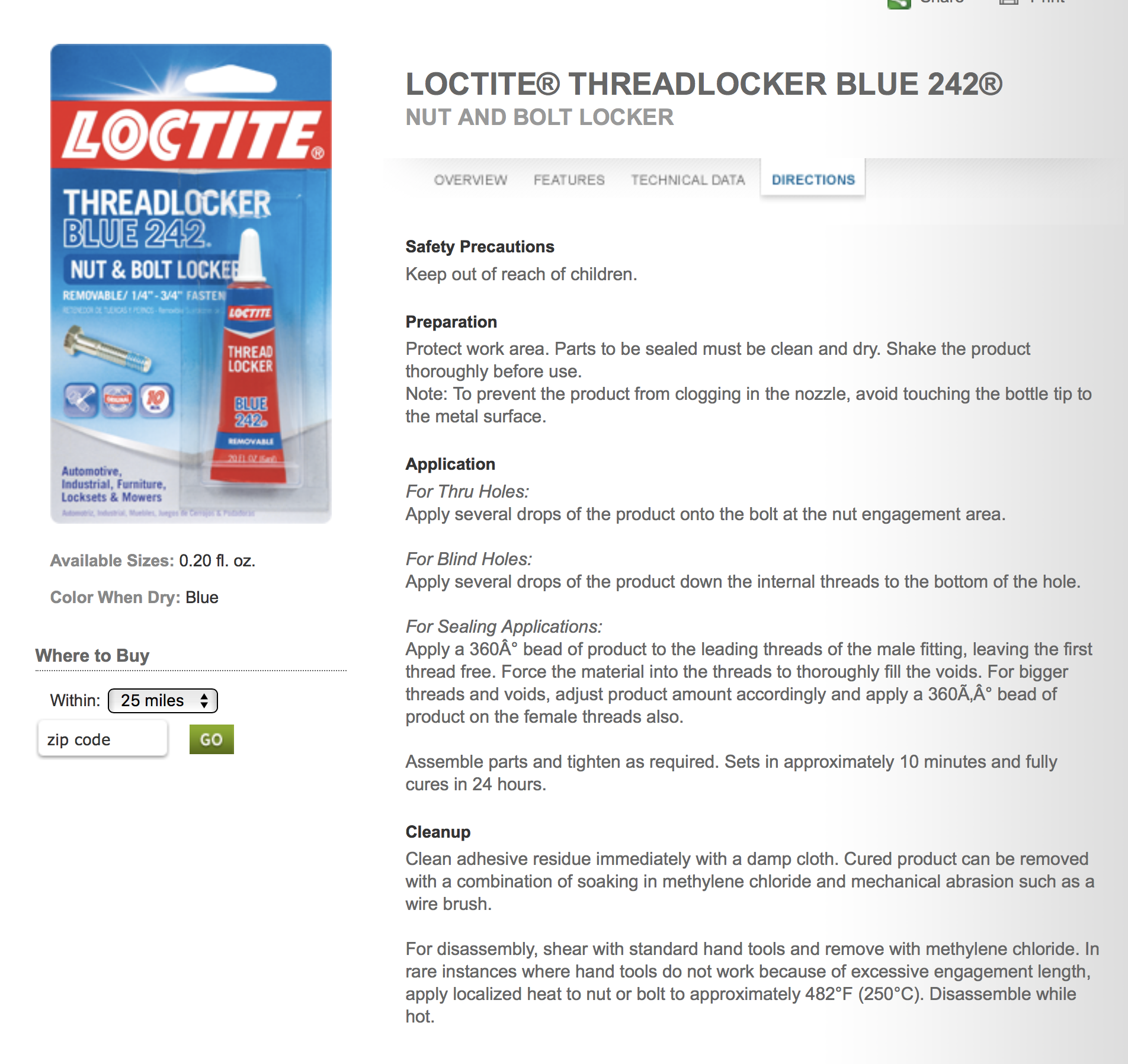

And, yes, look specifically at the product pic I just uploaded - yes, almost 500 degrees F are required to loosen Blue Loctite. I've used it, I've specced it out - I'm surmising you don't have one of these mounts (I do) and I'm surmising that you've never used Blue Loctite before (I have). So, yes, he's supposed to have figured it out. Apple's culpable for not properly calling out how to disassemble the mount, and I've already informed Apple Engineering of it.
Again, read the specs in the pic from the Loctite web portal. My main issue with the YouTuber is that he's griping about the zinc fasteners - they're not made of zinc. OTOH, if you don't know what you're doing, pay someone. The YouTuber's use of a drill, gawd what an idiot. Get off my back.

It clearly says in loctites own instructions to shear the bond with hand tools.
In RARE circumstances where hand tools don’t work due to excessive engagement length you can apply localised heat.
But you categorically should not need heat to undo a screw of that length because of Blue Threadlocker!
