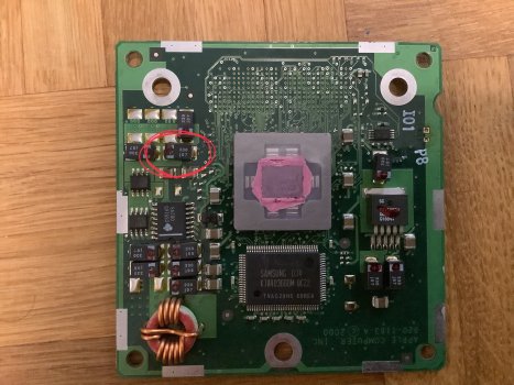

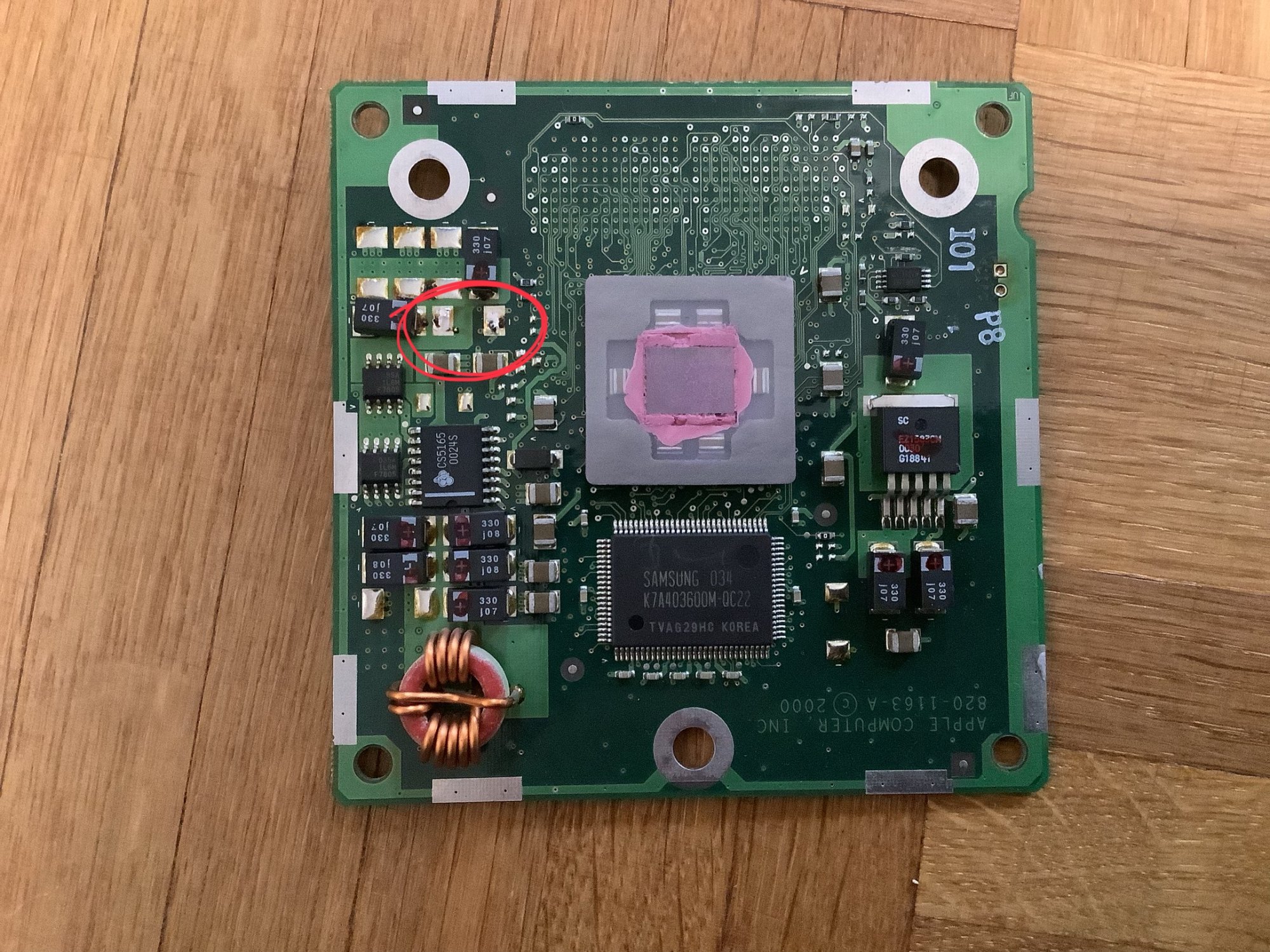

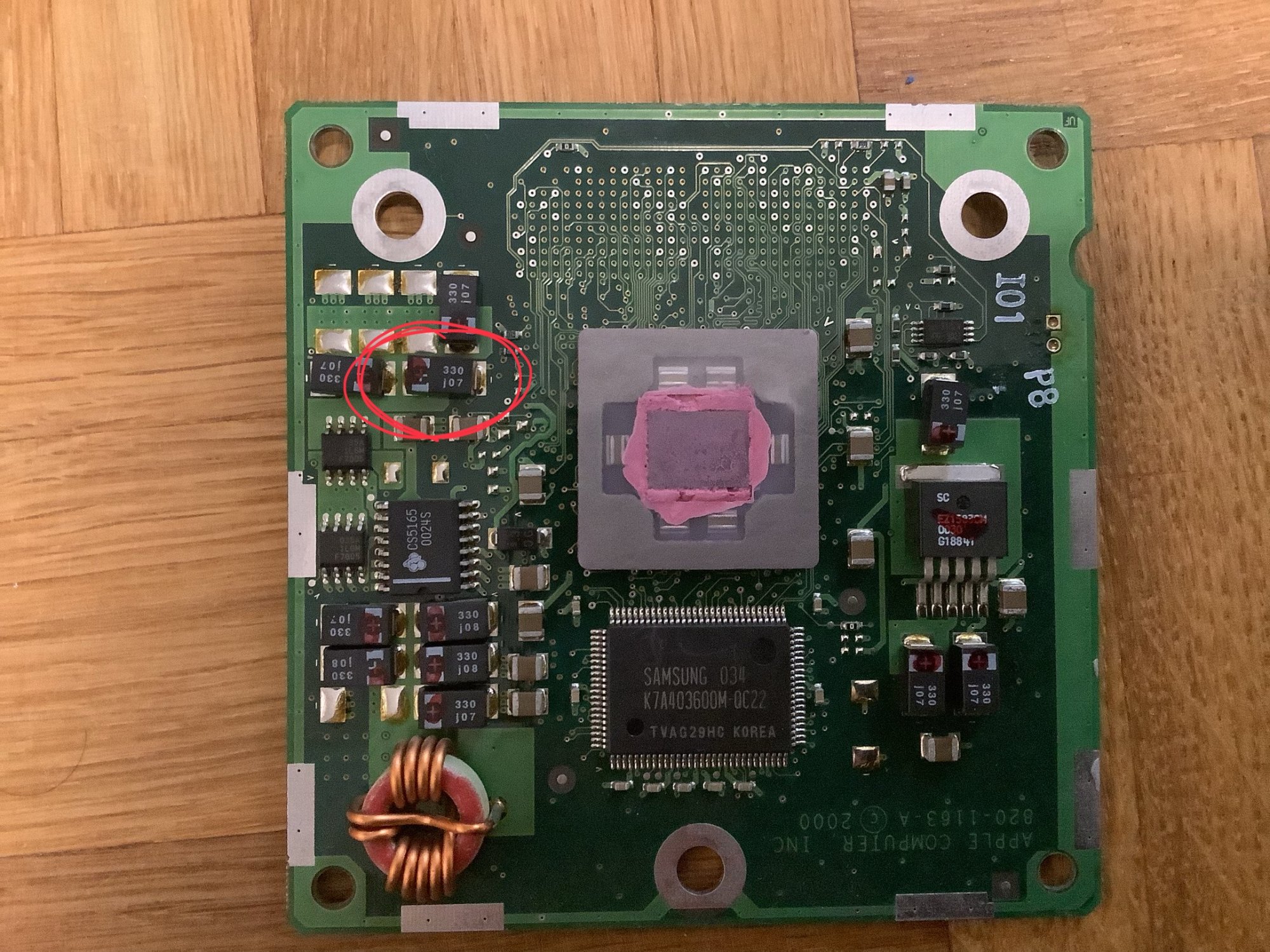

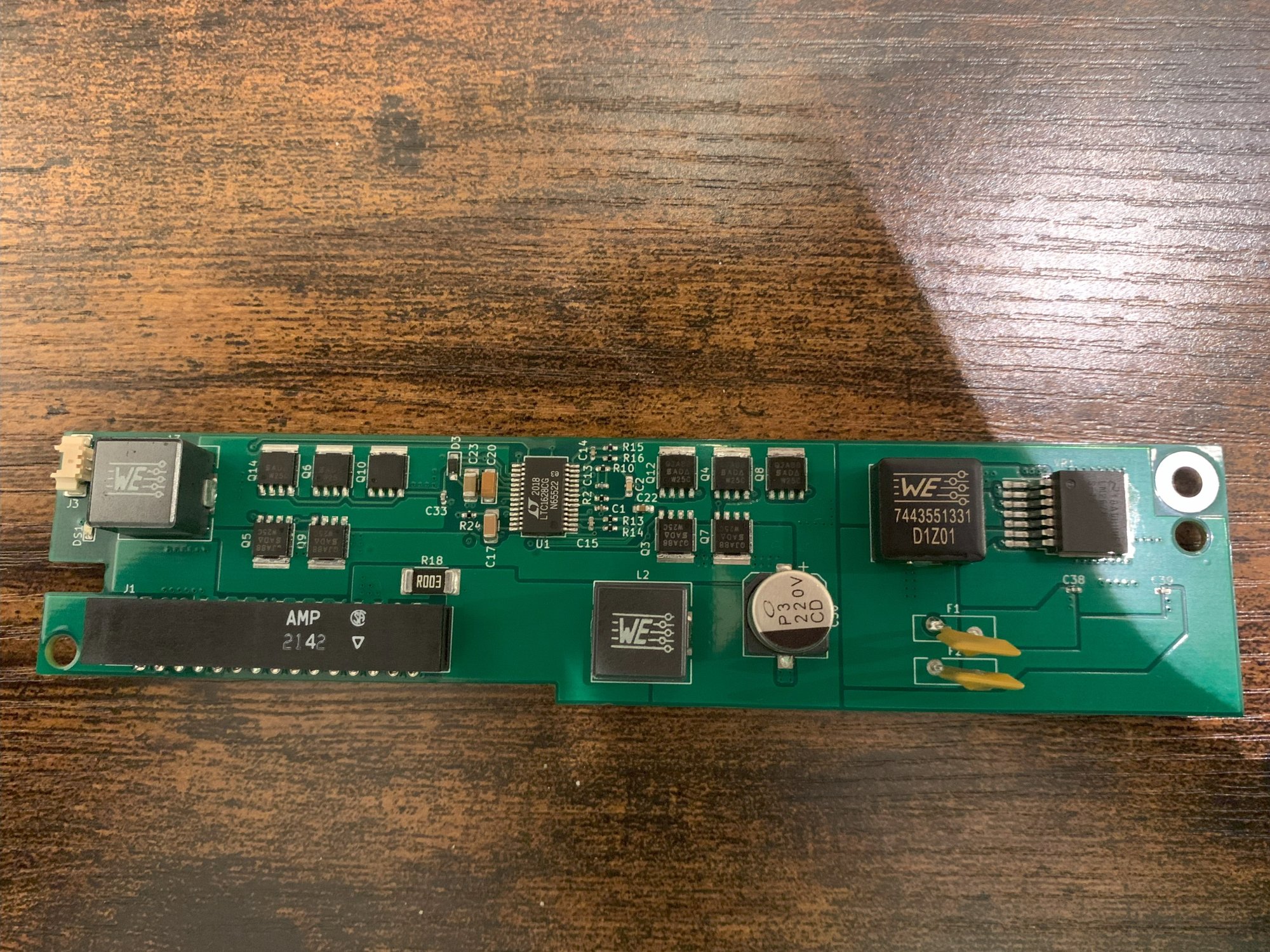

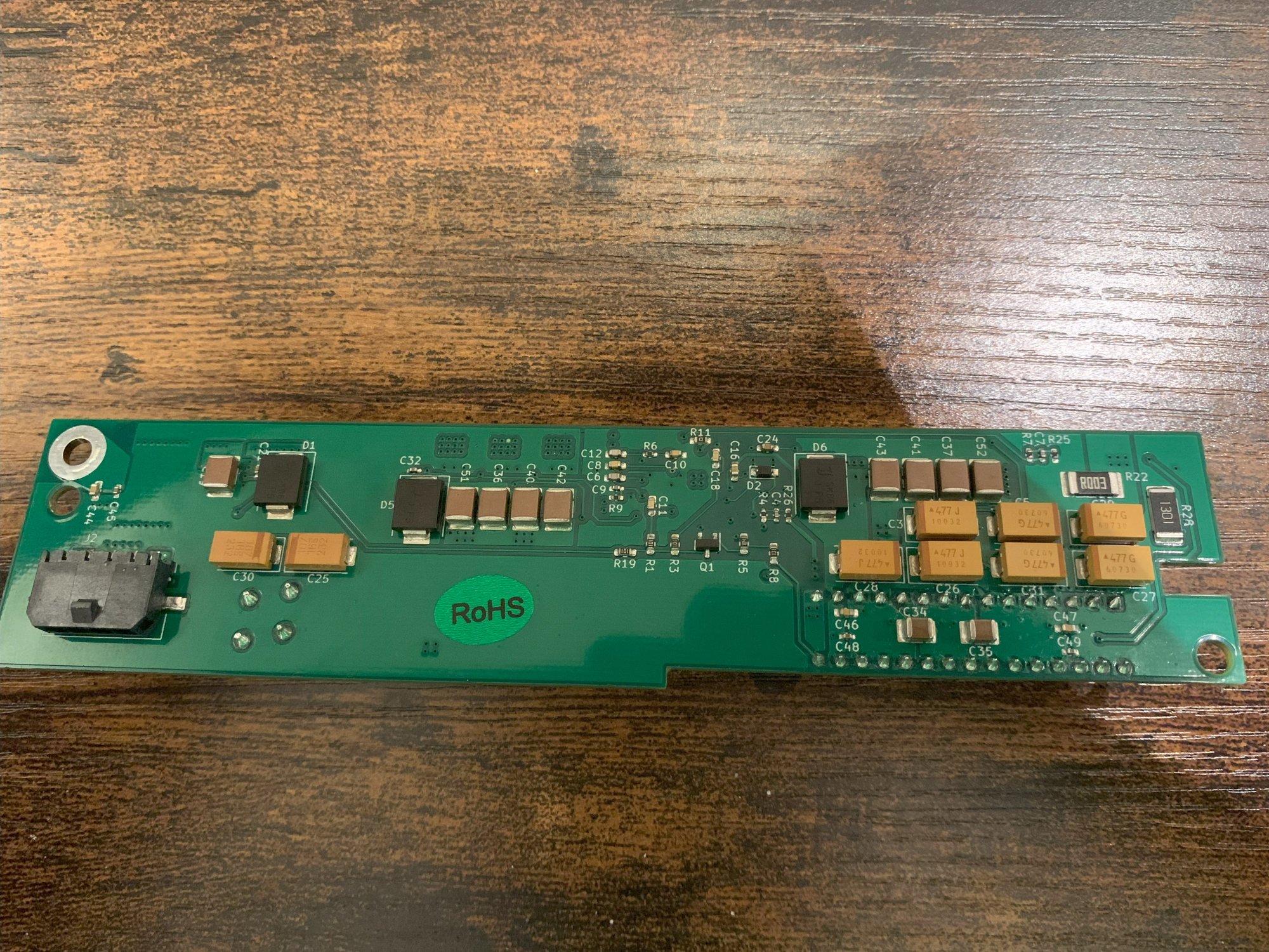

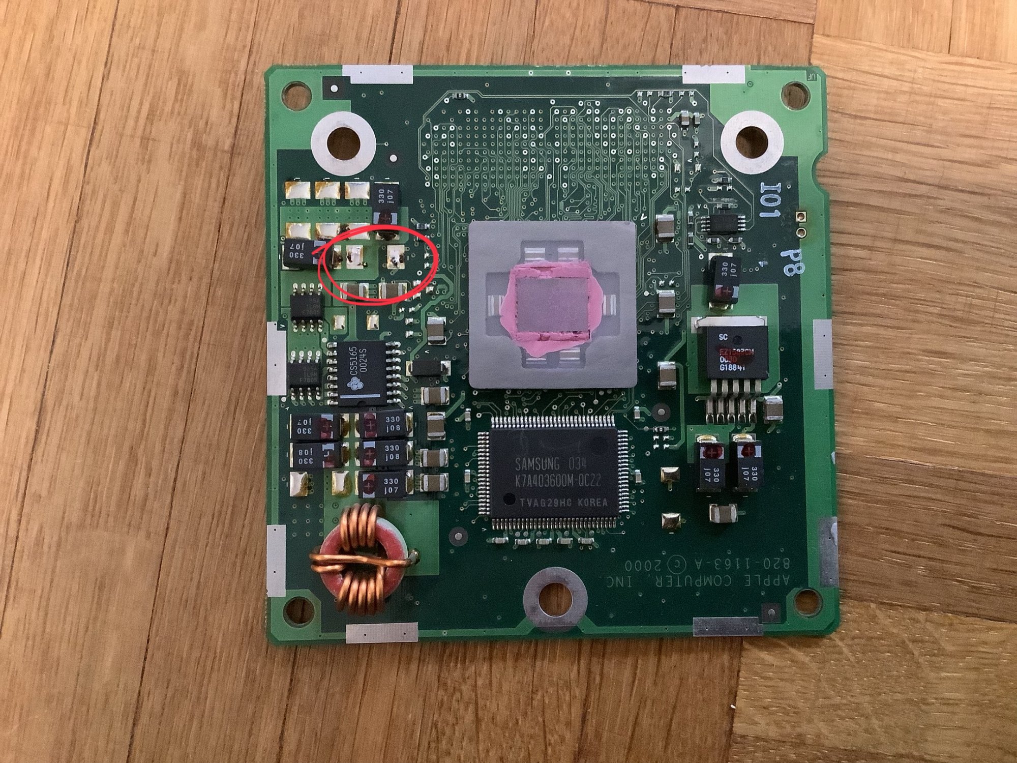

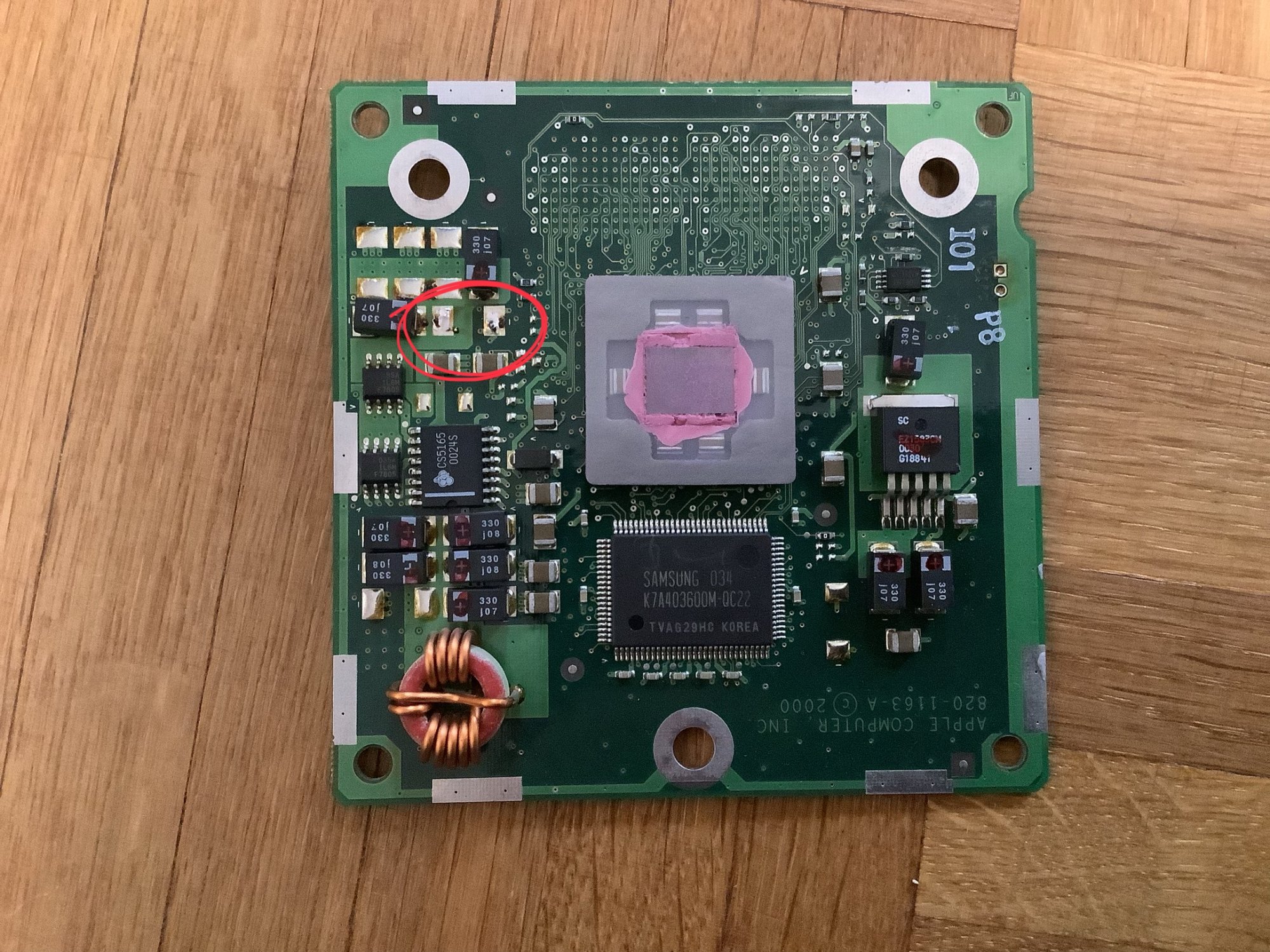

All of the LEDs you saw come on are part of the standby/powerup circuitry. They are always powered any time 28v is plugged in, so seeing them come on immediately is normal. When they went out, this was caused by voltage being removed from the LEDs somewhere. Either a chip they rely on getting damaged, a fuse blowing in the external PSU, or OCP tripping in the external PSU.
The FETs you picture are the high side FETs for the 5v rail. If they failed short D/S, that could have applied 28V to anything on the 5V rail. That could be why the CS5165 smells bad. It is possibly dead, and depending on the status of the high side FETs on the CPU card, it could have damaged the CPU itself as well.
These could have failed for a number of reasons. If a FET was installed backwards, I would expect it to blow nearly the moment it was plugged in. A backwards FET would have also applied 28V to the gate driver and blown the LTC1628; the fact that the green standby LED came on makes me think this is unlikely. It is still possible though depending on the path the power ultimately took and the resistances involved. A FET could have also been damaged by excessive heat during soldering. FETs can generally tolerate a good amount of soldering heat, but all parts do have a max spec for soldering temperature where things could get damaged.
A small ball of solder could have floated off when soldering with paste and shorted something near the LTC1628. If something got shorted around the gate drivers, the FET could have been held open permanently after the controller powered up. There is also a very small chance that you got a defective/damaged FET to begin with or it was damaged by ESD during handling.

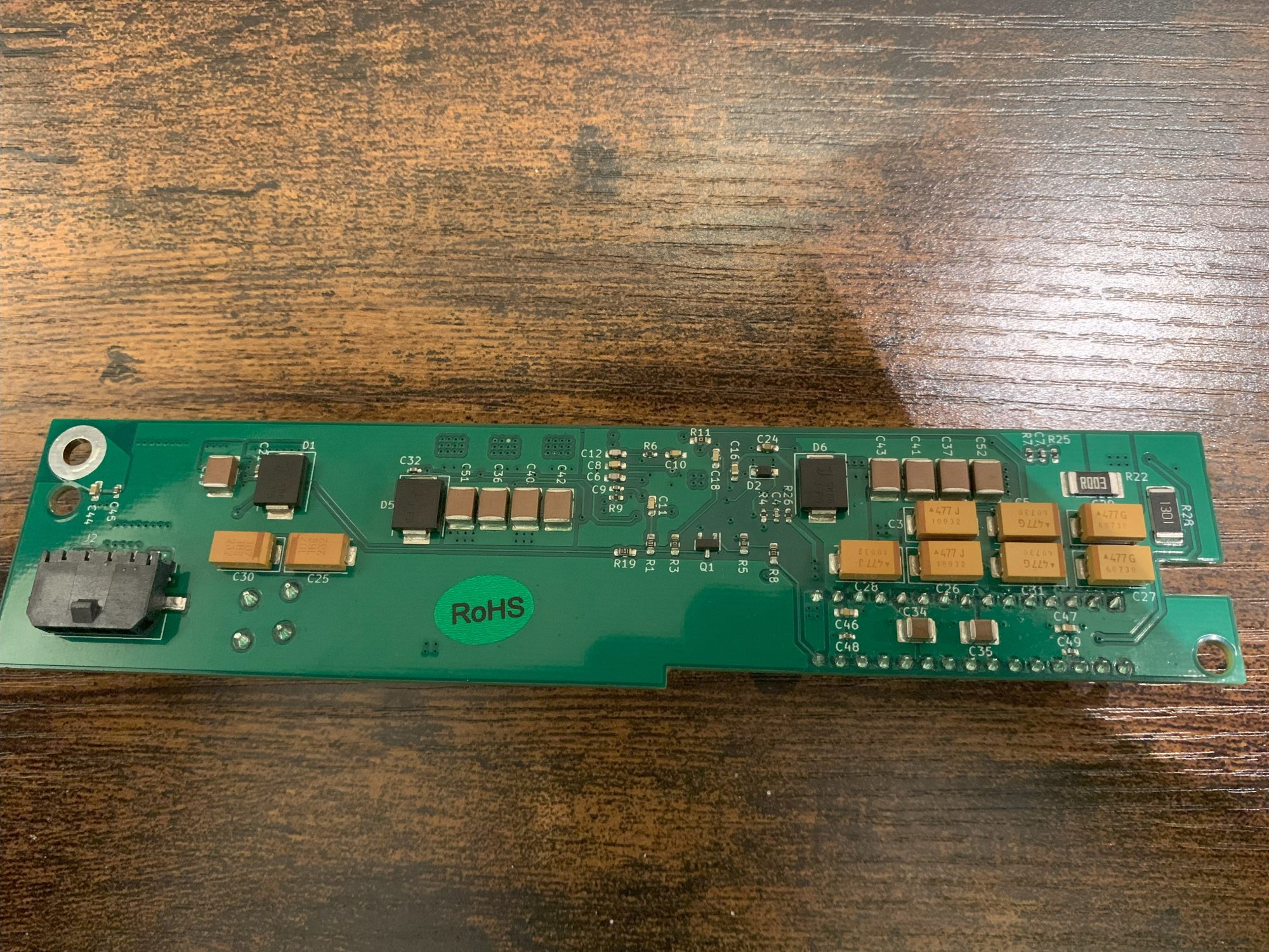

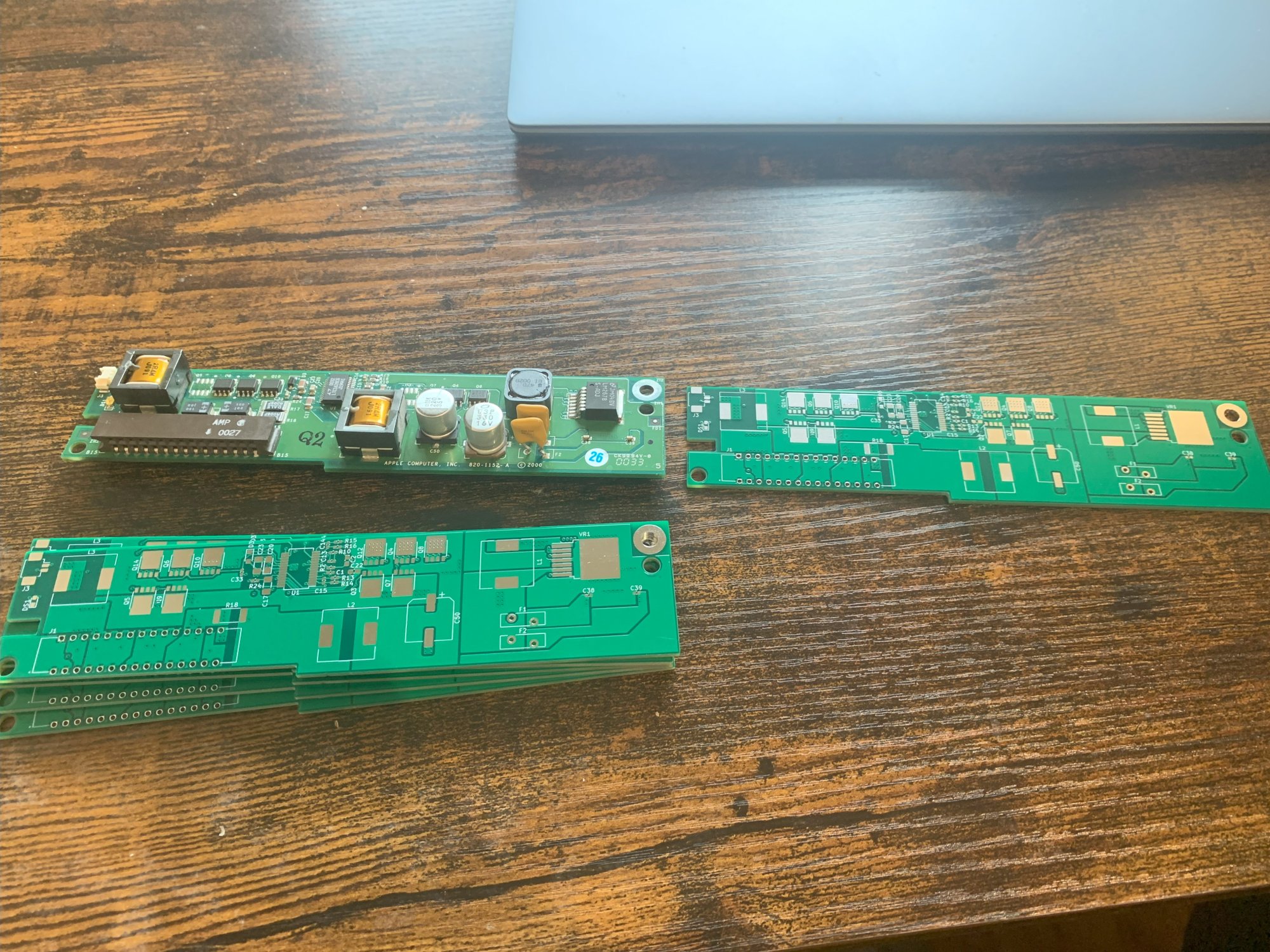

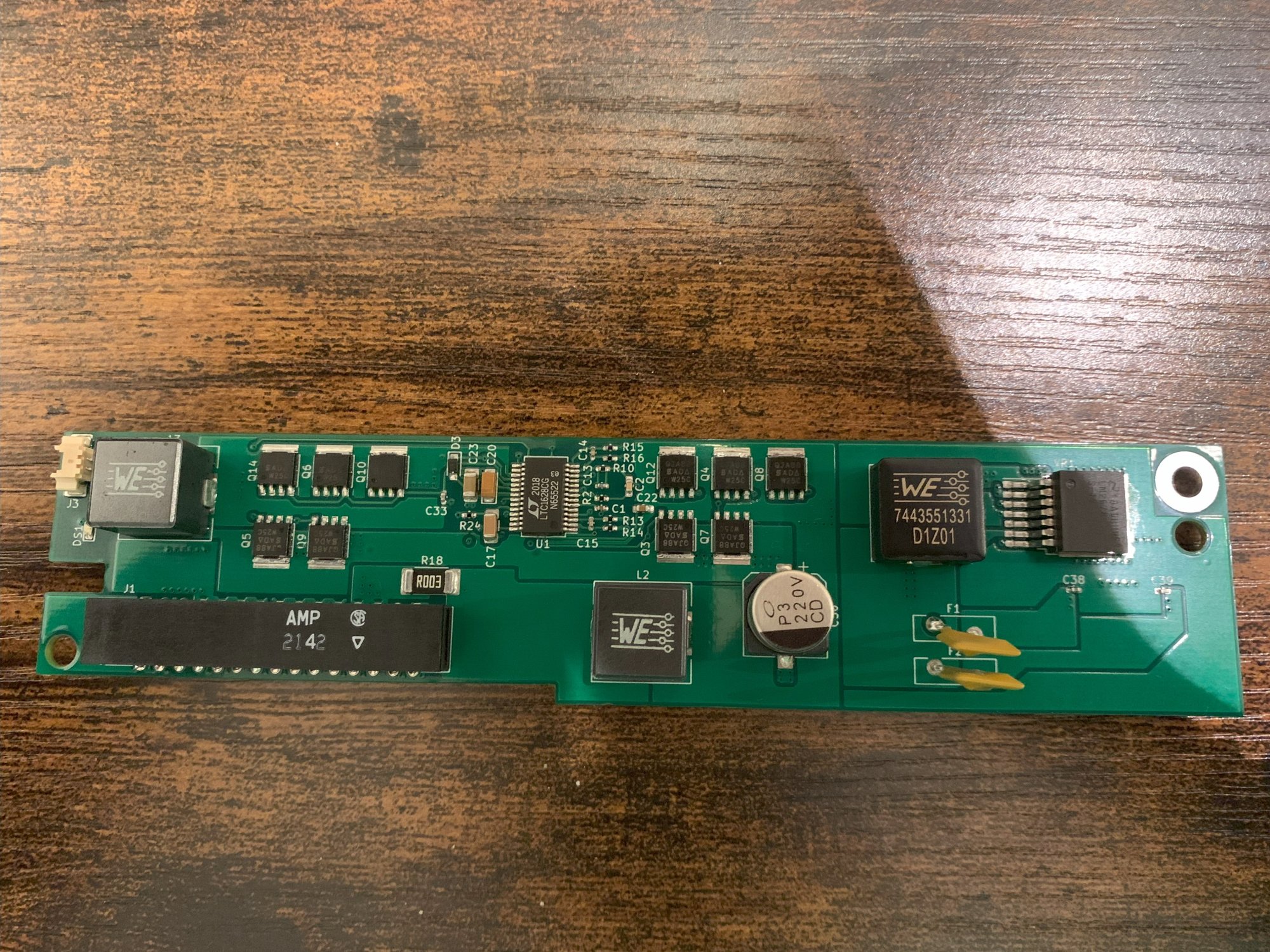

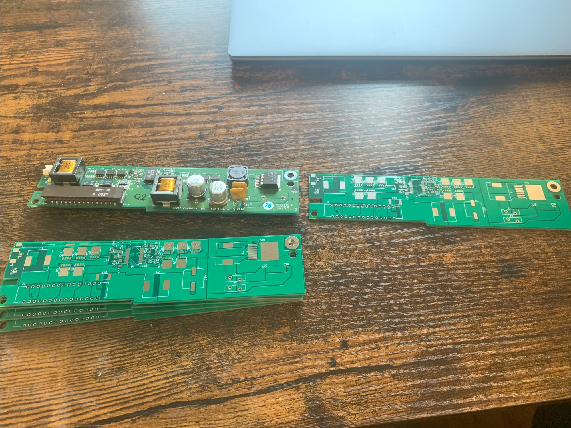

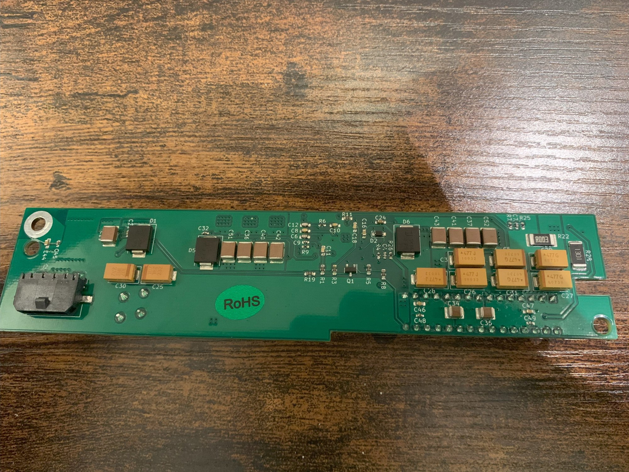

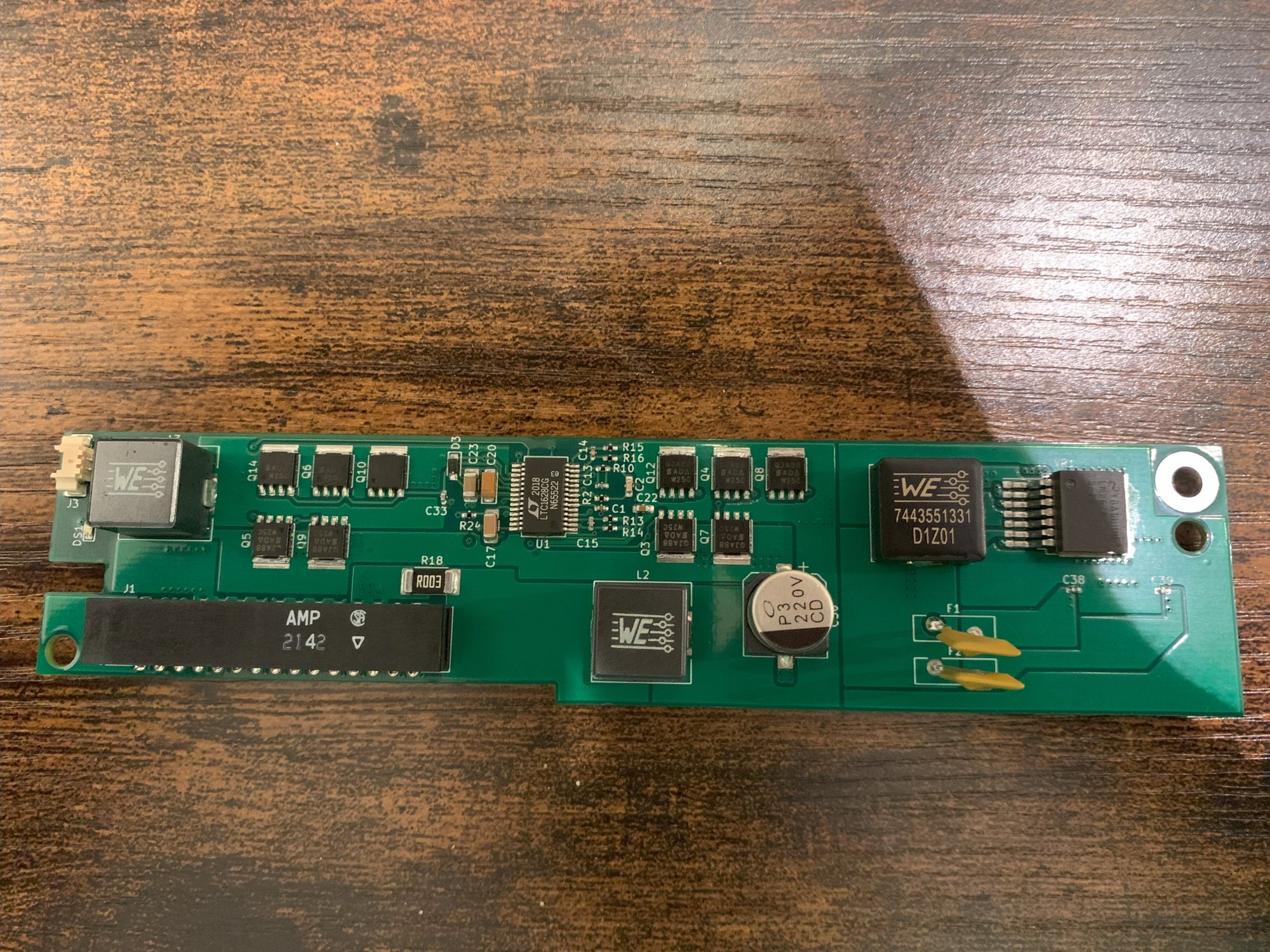

Well this is crazy but I just found this thread because I finished building a 2nd of my own VRM module for a cube as well. I designed it around a year ago but only got around to really putting it together recently and was googling around.
Sorry if I'm hijacking your thread here, but if you want to share ideas, I'd be happy to.
My own conclusions were very similar to yours- improving current capability by increasing the capabilities of the freewheeling diode for the 12V, and in my case using power pad mosfets that are heatsinked to buried copper layers, larger inductors, and larger capacitors for peak power delivery. I'm able to pull 15A with ease on both the 5V and 3V3 rails, even at a 100khz step load with an acceptable amount of ripple.

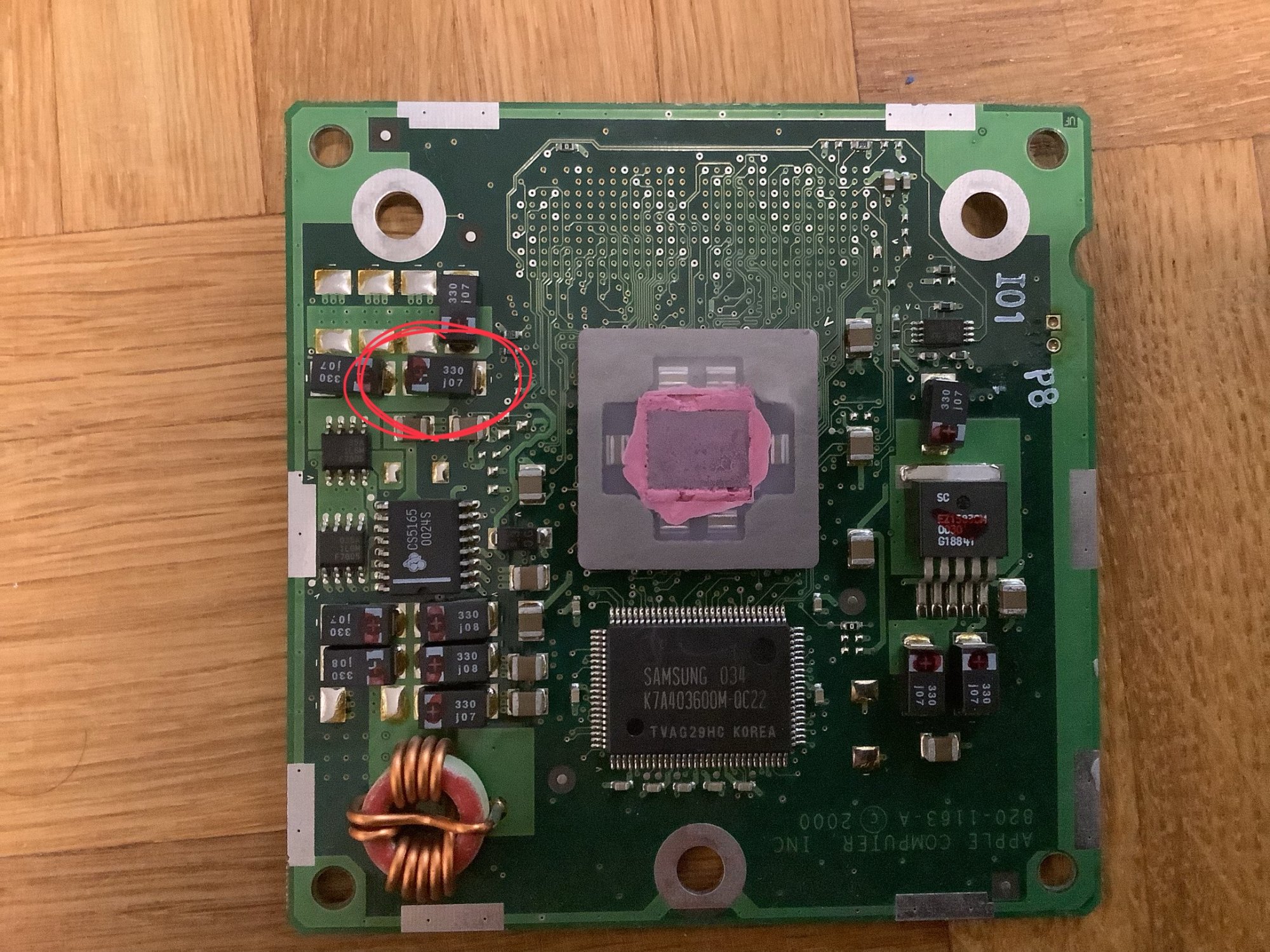

The part that could maybe be the one that exploded is one of these black diodes or whatever they are with the print 330 j07. Part of the plastic on one is gone and the material under looks burned. And it is the part which stinks😂.

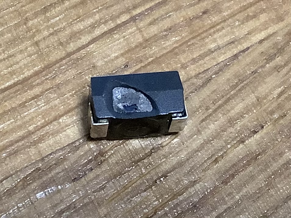

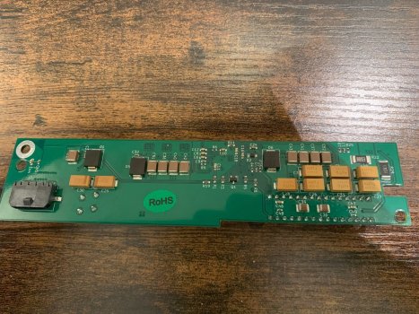

Those are tantalum capacitors. That one is one of the input caps for the CPU VDD rail (sitting on 5v). Sometimes they shoot flames out rather spectacularly when they fail.
Reactions: CooperBox

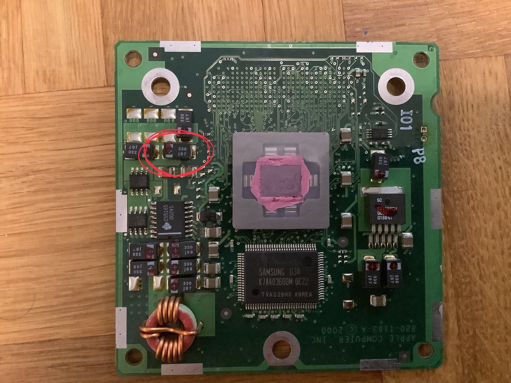

Okay, so then we know for sure that the 5V rail failed. Throwing the old VRM away is maybe the best thing to prevent any other damages, so I will not even try to repair it. And what exactly is the part number vor the capacitor that failed? I would really like to to repair the CPU card.
Finding an exact replacement for a capacitor is almost impossible without a donor board. All I really know about those caps is that they are 330uF tantalum polymer. They would likely have a voltage rating of at least 10v. 16v is a really common voltage rating that Apple liked to use, so my best guess is that they are rated for 16v. Just about any tantalum polymer cap with those specs should work as a replacement. Definitely test the MOSFETs on the CPU VDD/VCore rail to ensure they weren't damaged and shorted by the overvoltage. I'm not sure what the pinout on them is, but you should be able to search the part number to find the datasheet and determine that. If they are shorted, the CPU itself is likely damaged. The overvoltage could have also damaged the CS5165 itself, but that will be difficult to determine without trying to run it.
I'd also suggest testing the video card in another machine if you can, as it also uses the 5v rail. If you got lucky, just that one cap on the CPU card blew and failed short, acting as a kind of shunt for the overvoltage condition and preventing other parts from being damaged.
That's a panasonic TPE series polymer tantalum cap. 330uF, 6.3V
It's a bit hard to tell what the case size is from your photo but it looks like a D3L or D4 case. So your part number would either be 6TPE330MFL or 6TPE330MAA
Maybe order both and see which one matches best, though both would probably work just fine.
After figuring out the height of the capacitor (4mm), I will order the 6TPE330MAA with the D4 case. Thanks for the tip with the part numbers, that helped.

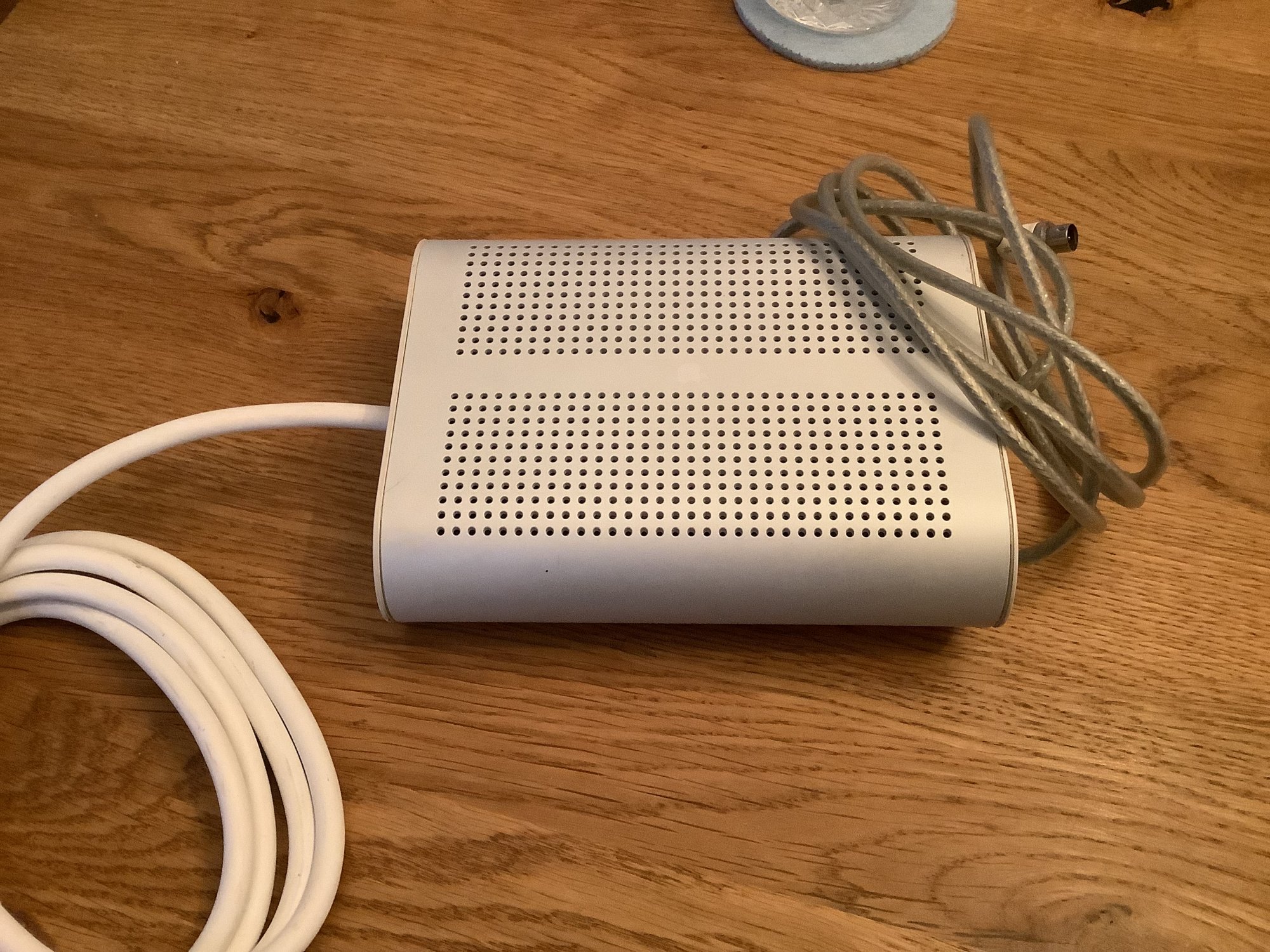

On a somewhat related note, if you need a new 28v external PSU, I found one that is very cost effective and should be capable of powering a heavily upgraded cube with a 23" Cinema or CRT ADC display. I also found the PSU connector thanks to a thread on 68kmla. It isn't as sexy as a stock PSU, but I won't complain for something modern, efficient, and reliable.
New PSU: https://www.digikey.com/en/products/detail/mean-well-usa-inc/ENP-240-24/7703107
Power connector: https://www.digikey.com/en/products/detail/kycon-inc/KPPX-4P/9990085
It would also be neat to 3D print a case for a chassis mount PSU that maintains a stock look. I found one that would work along with some white power inlets. It would be a lot more work and require hooking up mains voltage, but way cooler than a plain black rectangle.
Chassis PSU: https://www.digikey.com/en/products/detail/tdk-lambda-americas-inc/CUS400M-28/13531585
Power Inlets: https://www.digikey.com/short/dfhjc52c

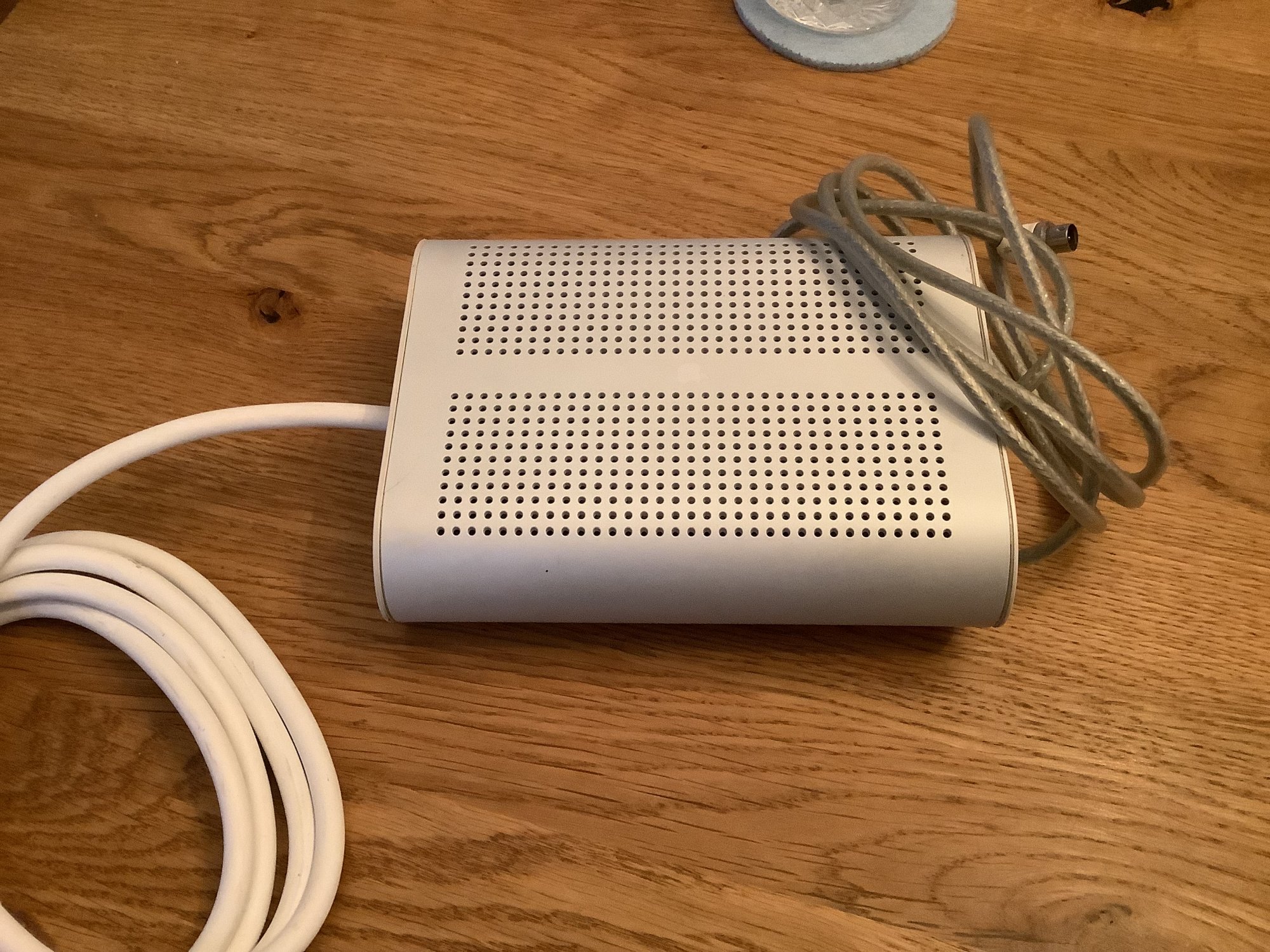

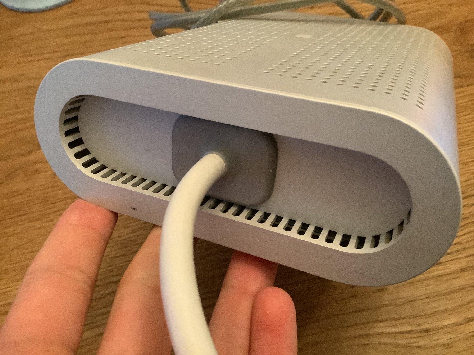

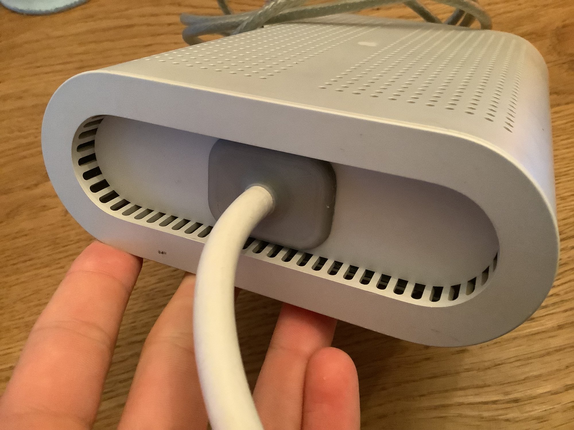

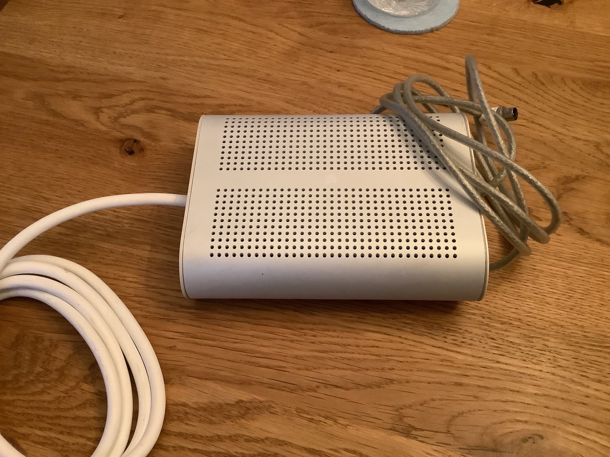

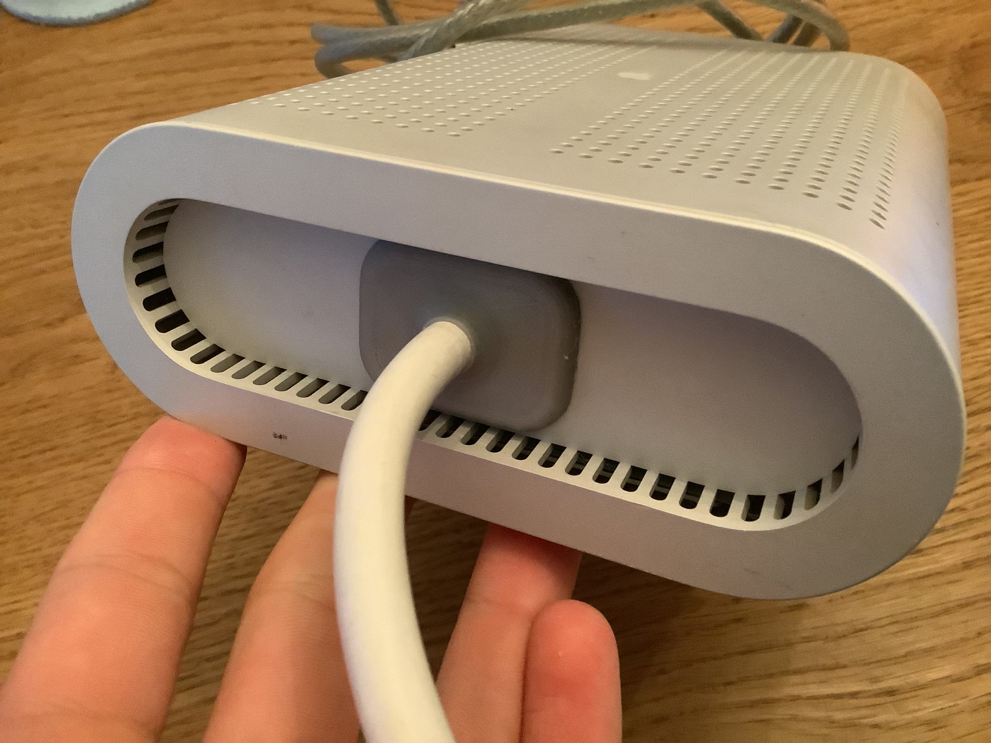

The Cube that I got had a dead PSU and I got a new one that just barely fits in the original case of the PSU, actually looking almost as "sexy" as before, with the difference that the AC cable is now mounted and not removable. It works good with a surprising low heat radiation.
So if anyone still has some dead original PSUs lying around, you can make them work again by swapping the internals for the cost of around 50 bucks and an extension cable. For completing the "sexy" look, you can attach a 3D-printed cable fixer to it so the mounted AC cable does not wobble around (view photos).
Note that the PSU replacement is 230V AC only, but it should be easy to find one for US 110V as well. Maximum sizes for a fit-in replacement are approximately 15.5x12x4.5cm or 6.1x4.7x1.8 inches if you want to find one on your own.
PSU replacement, 7A (230V only): https://www.ampul.eu/de/schaltnetzteile/4764-netzteil-28v-71a-200w
Cable fixer (stl format): https://drive.google.com/file/d/1q6lx5I1KuXfIMCA2S32jbx4UFC7nFziT/view

Hi there, really nice thread, thanks for taking the time writing out your thoughts and result of analysis, as well as developing and publishing the upgraded VRM. I'm not too educated on electronics, but as I understood it, the main danger is of the FET overheating and blowing up and taking the motherboard/cpu/graphics card with it, and the remedy is to design a completely new board to accommodate modern and higher rated components.
However, I lack the skills in constructing the new VRM you put up, and I don't really feel like pushing my cube to its absolute limits, at least not until the VRM design is finalized/battle-tested... I have unfortunately learned the hard way about the weaknesses of the stock VRM, after a blown Q7 and toast motherboard (thankfully a second Cube I was playing around with)... but either way, I can't and don't want to push for the maximum, for now.
Instead, I'm wondering how well an upgrade of the original VRM would work if I went easy (?) on the upgrades: a single 7457 cpu upgrade, Radeon 9000 Pro, and SSD. If i steal the FETs from the dead board and stick them in the empty slots on the working board and put heatsinks on top, what kind of improvement in safety can I expect? If i understood correctly, there is still a risk of catastrophic failure before the overcurrent protection kicks in when using the stock board, due to other components? I'm not too sure calculating ... if it's threading too close to the limit then I'd rather not gamble.
Apologies for the delayed response. Lost track of this thread and got distracted with other projects. I think an upgraded stock VRM should be able to handle a 7457 and a 9000 pro. I wouldn't recommend using the original FETs though. The ones I shared in my DigiKey list have much more current capacity than the stock parts and also haven't been exposed to many years of stress. Some heatsinks on the new FETs are still recommended.
With an upgraded VRM, the overcurrent protection *should* kick in at 18.5A, before the new FETs blow. The only thing that will kill other components on your board is a high side FET failing short. However, I haven't actually tested an upgraded VRM on a load tester yet to ensure that OCP actually trips. I recently got a second cube, so I don't mind potentially blowing up one of the stock VRMs for science now. I'll try to update this thread once I get around to that.
In short, a stock VRM with 4 new FETs on each rail should be just fine for a single 7457 and 9000 pro.

And another possibly dead VRM!😭
A few minutes ago I powered on my Cube (with a stock VRM, stock CPU and GeForce 6200 which consumes less power than the stock ATI) just as normal and as I had it not in its case, I saw the red light on the Motherboard blinking a few times and then the MOSFET on Q9 blew up, produced a hell lot of smoke.
The last time I powered the Cube on was one week ago and it has been untouched since then, no parts replaced, so I have no idea what the problem could be.
I measured resistance on the Motherboard and luckily it is not damaged like the first MB was when I failed replacing the MOSFETs on my first VRM a few months ago.
I have still stored the original MOSFETs from the first VRM (which worked fine before unsoldering them) and replaced the dead one.
Measuring the resistance on all pads after replacing the dead MOSFET shows that nothing seems to be damaged and they didn’t failed D/S, G/S, or G/D. Now I am wondering what I could check next to make sure nothing has been damaged, and more importantly, WHAT THE HELL CAUSED THE MOSFET TO BLOW UP???
