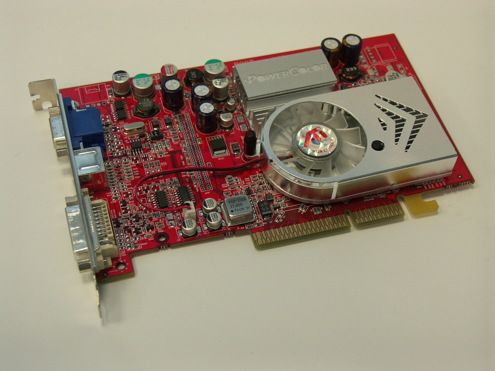

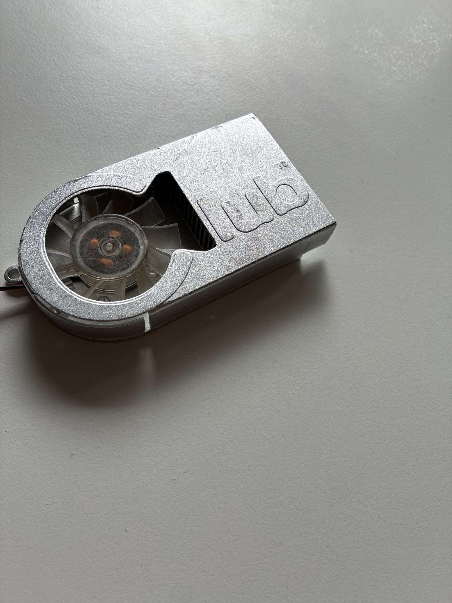

Which GPU is the one in the photo and especially interesting for me: where did he got this heatsink from? It looks really good. Another mention of a heatsink with a fan for the Cube is the one of the Club3D/Powercolor Radeon 9600 XT:
The GPU is a Radeon 9250 (unknown brand). I bought it used, and it has a 9200 ROM and displays 64MB of VRAM. I extracted the heatsink from a damaged FX5200; the mounting holes fit, so I just had to trim them to avoid interfering with the diodes and crystal. My plan is to add a 40x40 centrifugal fan between the heatsink and the DVI connector.
