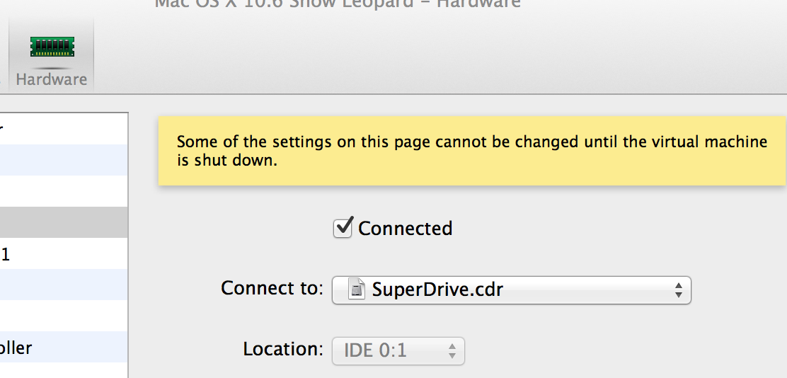

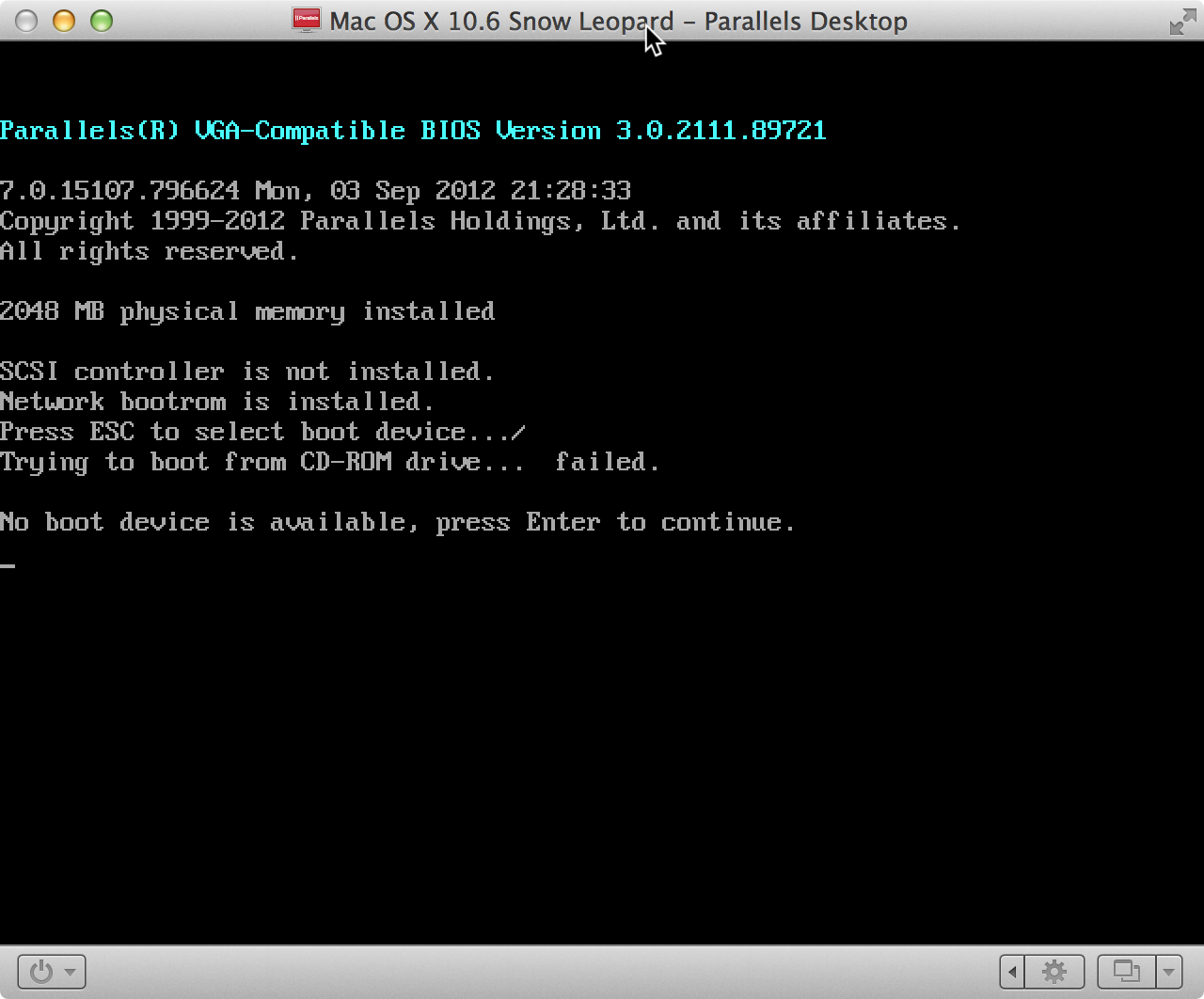

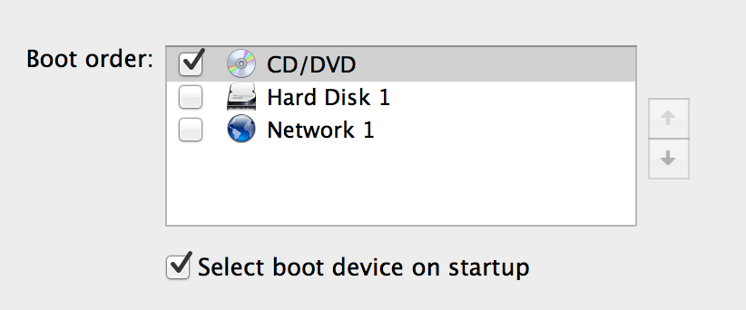

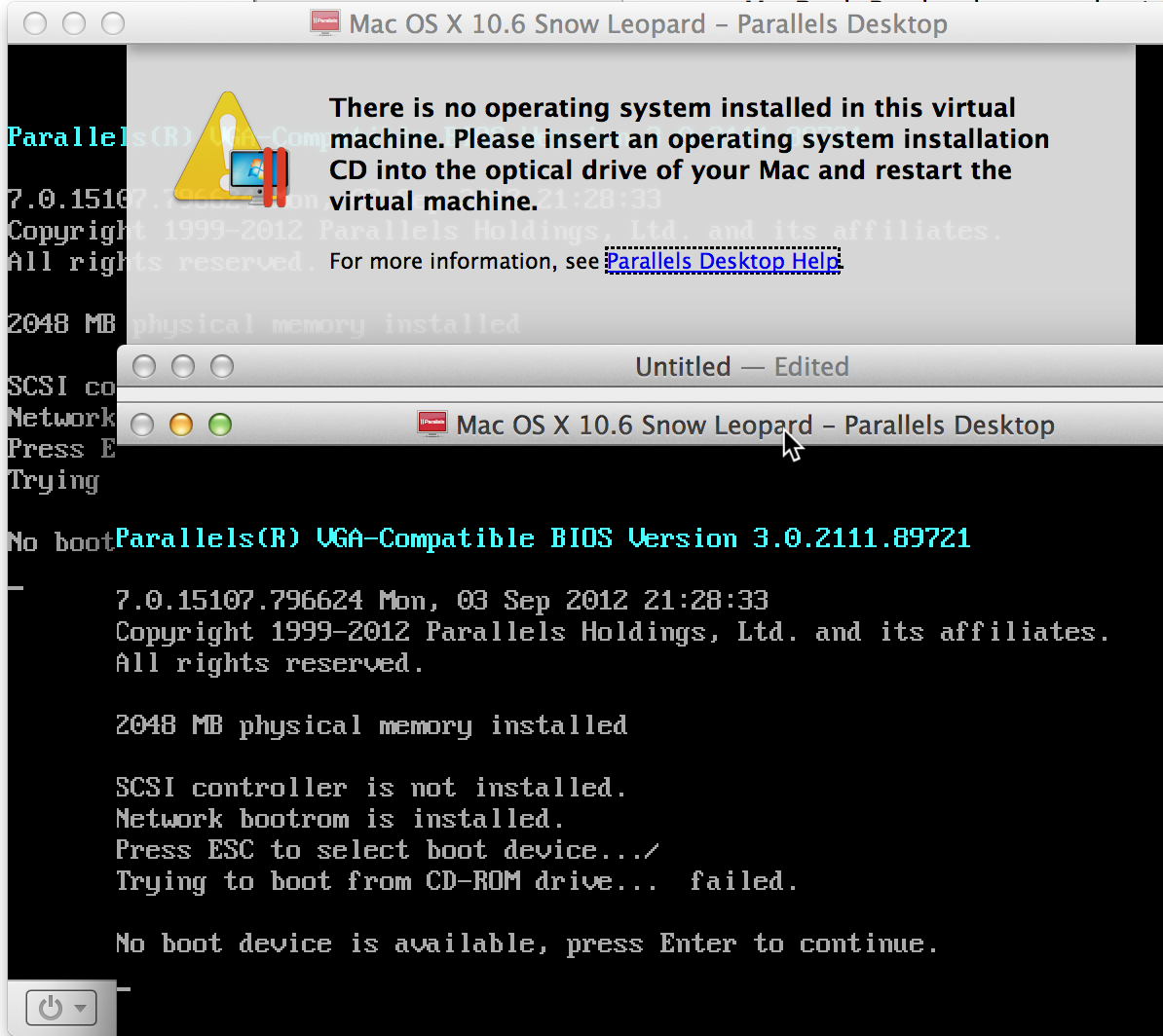

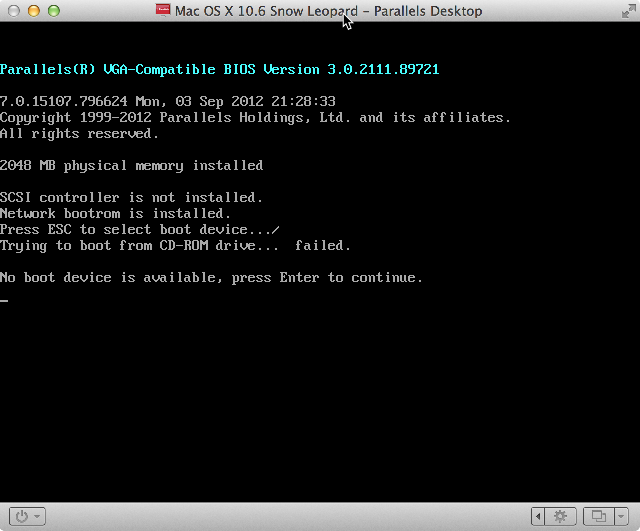

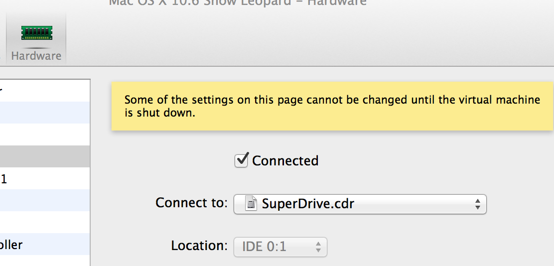

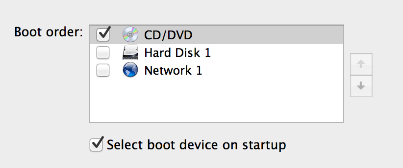

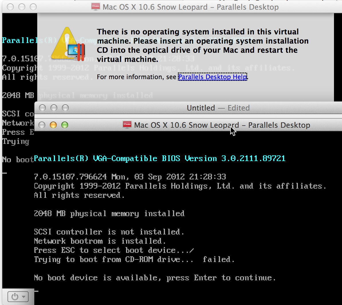

Parallels 7.0.15107/OS X 10.6.8 - MBPr - stuck, no OS
Hi all and thank you Michael for all the instructions.
Up to now I have not been able to create a much needed Snow Leopard virtual machine.
Tried step 1 on a Machine running 10.6.8 from an image file of a Snow Leopard disk (official, my university, works like a charm to install Snow Leopard), verified the needed file. Then copied SuperDrive.cdr to a USB flash drive, and copied to Desktop on my MacBook Pro Retina, runnning 10.8.2. Parallels 7 Build 7.0.15107 (Revision 796624; Mon, 03 Sep 2012).
Continued as per your instruction, gave the .cdr read and write permissions for everyone (in addition to myself), created virtual machine with the boot order correct (see below), and then pressed start. Got DOS boot screen (see below), pressed escape, verified SuperDrive is attached (see below), selected option 1 CD - return to DOS boot screen, no OS installed.
Pretty much stuck for now :-(
Need it urgently since my MacPro with SL will go away, and need 10.6 because my (Swiss) accounting programme has not yet been updated to work with 10.7 or 10.8.
Residing in Switzerland. Getting it up and running would solve a major headache!
(BTW looking at the image file, and opening it, it looks like in post 152 - I do know that there is no need to open/mount it to run the installer in Parallels.)

1) Are you sure that your Snow Leopard installation DVD is a retail version and not a machine specific one? The difference is highlighted in the photos at the end of post #1.
2) Are you sure that you are completing ALL of the sub steps of STEP ONE on the Snow Leopard machine? Once it is modified, then you can copy it on the flash drive and move it over to the Mt. Lion Mac.
Apparently Mt. Lion does not allow for read/write of this type of image file and so far those helping me have not found any way to change this in Mt. Lion.
Since you have access to a Snow Leopard machine, you should be able to successfully complete STEP ONE there and the remaining STEPs on the Mountain Lion machine.
Another option is to complete ALL of the STEPS on the Snow Leopard Machine and then move the resulting Snow Leopard.pvm file over to the Mt. Lion Mac at ~/Documents/Parallels. It will be over 16GB large!

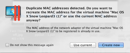

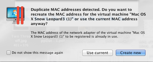

When you have it on the Mt. Lion Mac and double click it, click on CREATE NEW when the following dialog box appears:

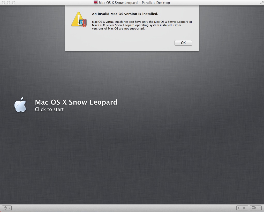

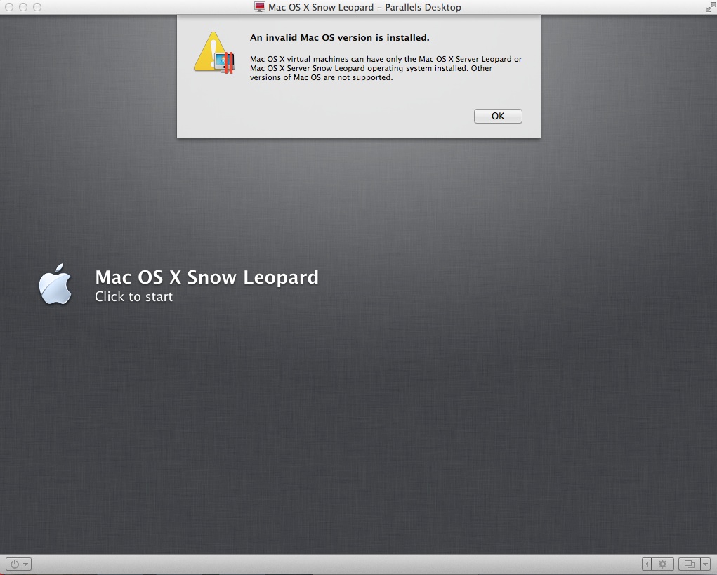

Dreaded "Invalid Version" Message
My virtual SL worked fine for a few days, then today when starting up I saw the dreaded "invalid version" message. I did notice that the VSL seemed to go to sleep frequently and I was presented with a "resume" screen from time to time to get it to wake up. Could this have created the equivalent of a "suspend", which is known to cause problems? Or must it be a true selection of "suspend" from the Parallels virtual machine menu to cause the error?
I tried the repair method from msg #68 but got only as far as step 6; when the Snow Leopard VM window appears, the "invalid version" message also appears and I can't start it up. Guess I misunderstood something... should I have launched the second HD? Must I now delete the second HD and start over?
Thanks,
K
DO NOT DELETE ANYTHING AT THIS TIME!
OK: Let's get you up and running again!
I have Sleep turned off in both environments, my main computer and the vSL environment, so actually I never run into this problem, except maybe once, when I forgot that Parallels was running on my MacBook Pro and shut the screen.
Actually, if I remember correctly, when I opened the screen back up and it came out of Sleep, vSL was still up, of course, and I just did a normal Shut Down and Quit Parallels and all was fine.
So, somehow you Quit Parallels while vSL was running without the necessary Shut Down within vSL. This would result in this failure when an attempt to Start Up without the necessary ServerVersion.plist in place.
The instructions in post #68 should work for you. A failure at Step 6 would indicate that your backup .pvm file is also corrupted, with the necessary ServerVersion.plist file missing. Is that possible? Have you previously booted up your backup .pvm file?
What version OS X are you using: Lion or Mt. Lion? I seem to remember some posts here by Mt. Lion users that complained that Mt. Lion was negatively affecting the Post #68 fix and I will look into that.
UPDATE: [Also you ask: "should I have launched the second HD?" YES: the point of this fix is to boot from the uncorrupted HD and have the corrupted one show up on the desktop as the non-booting HD, so that you can fix it.]
In the meantime, check out the fix in Post 150: "Troubleshooting "An invalid Mac OS version is installed" with NO backup .pvm file" and see if that works for you!
Good luck and let me know!

Parallels Version 8
Michael
I (sadly) am running Parallels version 8. I have followed your instructions to the letter - twice - including the extra step in your Troubleshooting Steps ...
cd '/Volumes/Mac OS X Install DVD/System/Library/CoreServices/'
and
ls
All OK so far
but after the OS installation, Parallels came up with the.....
Mac OS X virtual machines can have only the Mac OS X Server Leopard or Mac OS X Server Snow Leopard operating system installed. Other versions of Mac OS are not supported.
Any ideas
Best regards
Kevin
Are you attempting STEP ONE on a Mac that is running Mountain Lion? If so, as pointed out in the preliminary notes at the beginning of the post, there is a known problem with Mountain Lion.
The only current workaround is to complete STEP ONE on a Mac that is running Leopard or Snow Leopard, and then move the resulting Mac OS X Snow Leopard.pvm file over to the Mountain Lion Mac and complete the remaining STEPs.
Let me know if this helps. If not, let me know more about your situation: including which OS X, which Mac, which specific sub Step you are at, which specific Troubleshooting Step, etc.
