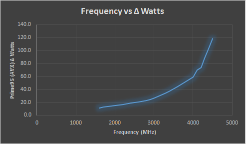

How does the frequency of the SOC influence the performance/consumption ratio?
I have read that performance increases linearly and consumption quadratically with frequency. Is it true?
Power consumption is capacitance driven times voltage squared times frequency. If you keep the voltage the same and increase the frequency, then power increases linearly with frequency. Sometimes you need to increase the voltage to increase frequency, however. Depends on details of the physical design.
Performance increases linearly with frequency.
You're living in a fantasy land.
Its not me who‘s living there… I know, its hard to believe, in particular if standing on the Intel side of things. But in actuality that‘s what it is
It’s not nearly that simple when it comes to consumption. It kind of works that way with performance though, provided you are not bottlenecked by anything outside the domain of frequency increase, which you are likely to be.
power vs. frequency is a function that starts out as a constant then gets into a linear region which gradually moves to higher order growth when you need to increase drive voltage to increase frequency.
This is a practical example from a desktop processor. The curves I’ve seen from CPUs and GPUs are all similar but not identical in behaviour, due to for instance process specifics.

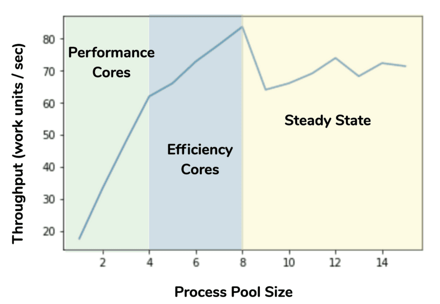

Would it go crazy like this? Anaconda run a microbenchmark (calculation of a cosine a million times) to test the differences between the P and E cores of an M1 Mac and got this.
Source: https://www.anaconda.com/blog/apple-silicon-transition
This is more of a problem if you have few, but very long running tasks.
I assume that benchmark tools run much more tasks than a common CPU can process in parallel, otherwise low granularity would indeed be a problem.
Cinebench divides the scene in 200 tiles or something.
Yes. You usually chose a number of threads equal* to the number of cores *precisely* to avoid this (before Apple Silicon and heterogeneous cores). If you try to run more threads than physical cores at the same time, cores have to (needlessly) context switch from one thread to another thread and that decreases performance (context switches are expensive, mess with the data in the caches, and should be avoided as much as possible).
*sometimes the number of threads is set to twice the number of cores in SMT-capable (multithreading) machines, since they were designed to be able to run two threads per core. Didn't make much of a difference in any workload I ever tried, since the point of SMT (someone correct me if wrong) is to keep the core ALU busy and that's not a problem for numerical simulations since they're ALU-heavy by definition. I assume context switches here are less of a problem since SMT-capable cores have two sets of registers so context switching between (just) two threads should be cheaper, so performance doesn't improve nor decrease.
Many benchmarks go around this problem by measuring throughput (like the anaconda graph above) instead of time to finish a task. For example, Geekbench in the physical N-body simulation measures interactions computed per second, not the time to compute, say, 1M interactions. That takes granularity and task scheduling out of the equation.
