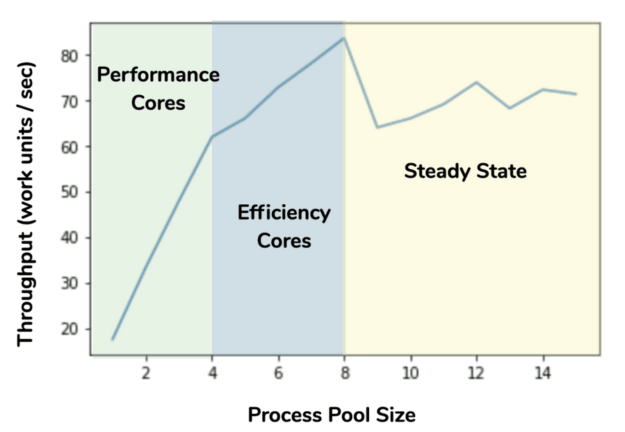

Many benchmarks go around this problem by measuring throughput (like the anaconda graph above) instead of time to finish a task. For example, Geekbench in the physical N-body simulation measures interactions computed per second, not the time to compute, say, 1M interactions. That takes granularity and task scheduling out of the equation.
You mean that geekbench counts the number of interactions computed at short intervals (like every 0.01s) and makes an average? That's indeed a better solution.
It's not entirely clear to me if the throughput shown on the anaconda graph is measured this way. It could be the amount of work divided by the time taken by the whole CPU to finish the task. This also gives you a throughput.
What do numbers in the Geekbench report mean? Mean throughput? Maximum instantaneous throughput?
It is the same as SpecCPU rate-N. You are running the same workload/code on each core and after some time you measure how much progress has been made overall.
This way you avoid distributing your fixed workload fairly to all cores (like in Cinebench).
Reactions: Xiao_Xi

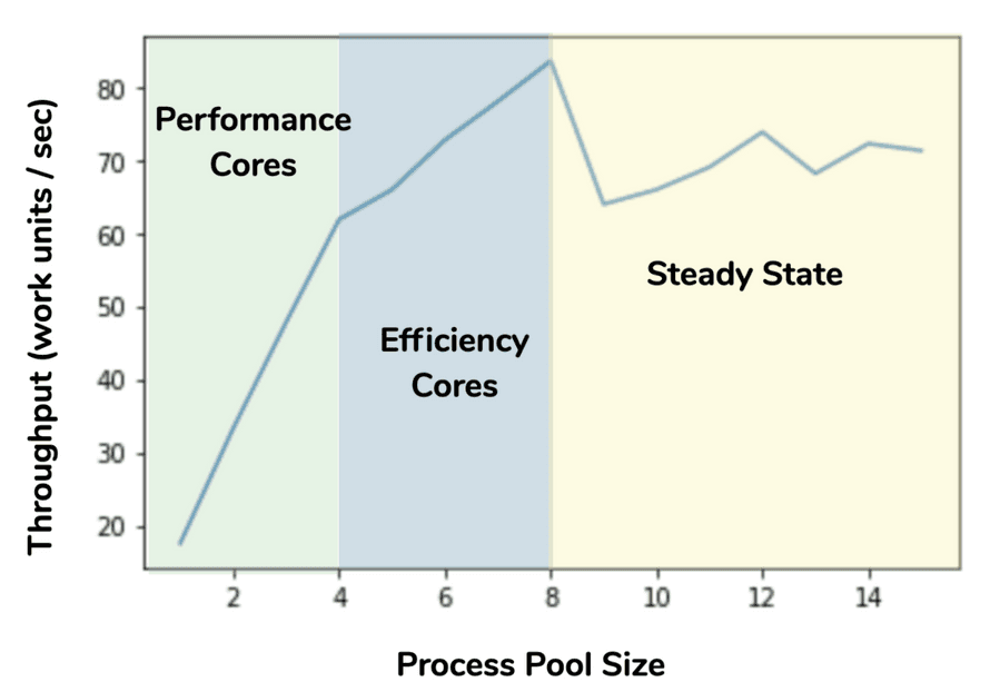

Would it go crazy like this? Anaconda run a microbenchmark (calculation of a cosine a million times) to test the differences between the P and E cores of an M1 Mac and got this.
Source: https://www.anaconda.com/blog/apple-silicon-transition
Doubtful that is actually "steady state" on the right hand side. It is more so just non steadily increasing state. Very good chance though that continues to decline over the extended range as one hammers the cache , OS thread scheduler , etc. with larger and larger overhead of having too many "higher priority" threads around clamoring to get a time slice quantum allocation. At some point the ones that are being "starved" will be pushed to the front of the queue and once bounced out, the line to get back in is even longer.
That said calculated a cosine a million times is a bit of a joke benchmark. That is a much measuring cache sizes and cache set associativity as the whole thing is likely encapsulated by a modern era cache. The shared common instruction set binaries can land in a L1. Not really pulling any data. The data dependences between loop iterations is pragmatically non existent . This is just lobbing a super duper slow pitch softball over the plate at an olympic Gold medal winner softball player.
If the benchmark only uses one number for the cosine, how could it test the performance of the cache? Can you explain what data the cache stores?
It is not testing the cache if the cache can hold the whole problem. That the point. The cache is a principal component of a CPU "package" or "SoC". If you are not testing one of the major components then it is test that doesn't give a complete evaluation of the overall unit.
Even if it was just using a 0.5K block of numbers. It is mainly going to come down to the "all core" clock speed if have split it up into "work" chunks. The architecture differences probably are not going to matter much.
P.S. missed the "what is a data cache". The data cache is just the data used by the thread/application. If have global/local variables... that values in those are data. Each thread would have its own set of local variables. ( e.g. keeping track how many times when around the loop. ... each thread is on different iteration then needs it own count-tracking variable. The result of the cosine is probably saved. in some variable. x = cosine ( y ). Doesn't go anywhere but there is still a step to store it ( unless optimizer throws that step away because pragmatically useless in a 'nothing' computation. ) .
The instructions to execute are a special kind of "data". They are instructions not the operands to the instructions. At the L1 level those are usually kept in a separate cache because the frequently usage characteristics are grossly different than that of data.
Benchmarks can be used for different things but outside marketing, their value lies in the conclusions you can draw from them.
Calculating a cosine a million times is very different from any actual workload on the system I can envision. Apart from demonstrating that the scheduling seems functional, I can’t see what conclusions I’m supposed to draw from it. It doesn’t seem to represent anything beyond itself.
