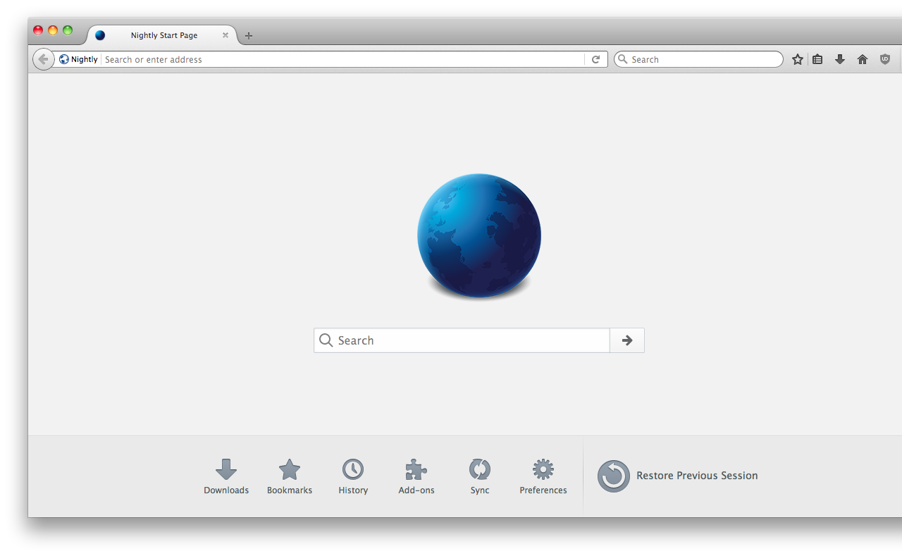

Hello everyone,

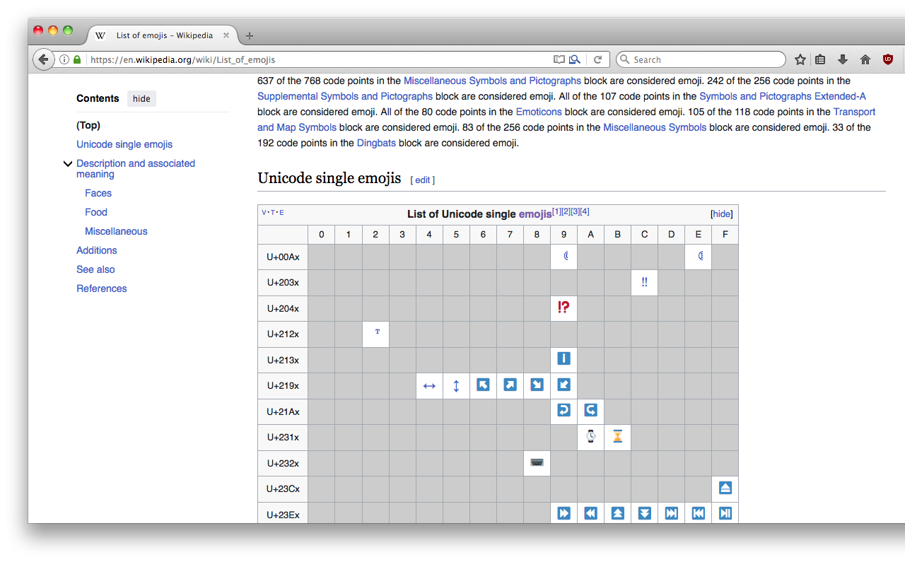

I'm proud to announce a new web browser for 10.6 which I am tentatively naming "Nightly55" (will probably change once I settle on a name I like.)
It's based on upstream code from Roytam1's Basilisk 55, which itself is based on Firefox 55/Moebius/UXP. The codebase is quite modern, with a Javascript engine new enough to run stock Discord (see screenshots).
Download a copy from here and let me know how it goes!

Notably, I've managed to enable out of the box color emoji support, meaning that you'll be able to see any emoji on any website without any extra fonts installed.
I hope everyone enjoys the new release, and be sure to let me know if you run into any issues.

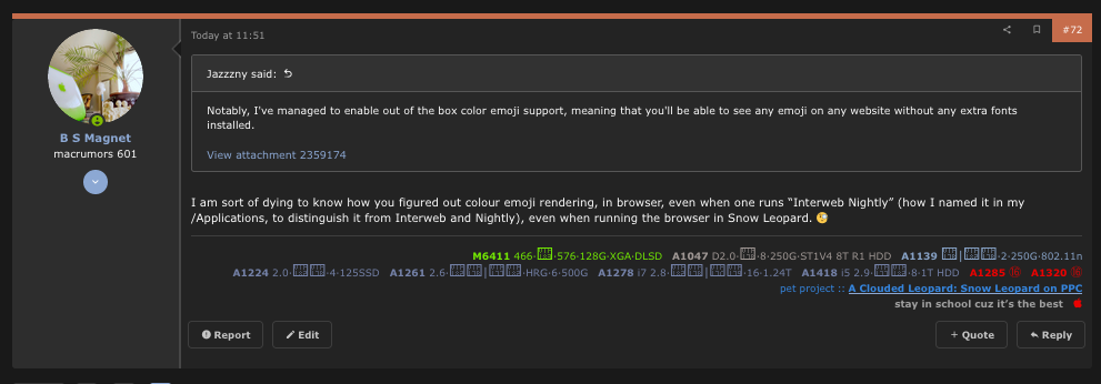

I am sort of dying to know how you figured out colour emoji rendering, in browser, even when one runs “Interweb Nightly” (how I named it in my /Applications, to distinguish it from Interweb and Nightly), even when running the browser in Snow Leopard. 🧐
(Yes, I see the inverse square letter glyphs in my signature didn’t render, but nevertheless impressed the monocle one did, and in colour.)
Many years ago, Mozilla implemented some color font rendering workarounds for Windows XP-7 as those operating systems don't support color glyphs either. However, it seems like they forgot about 10.6, likely because of the much smaller userbase. After poking around the codebase, I found that all of the features that are used to support the workaround rendering were present in the macOS port, so I was able to enable the color rendering workaround without much difficulty.

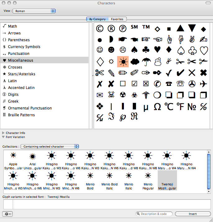

An inspection of the nested 'Twemojimozilla.ttf' in the application directory, when added as a system font, offers font alternatives in the system character menu (see attached), but each of the glyphs are visually blank (alongside several other system fonts which, for the most common of emojis, render them as monochrome glyphs). This also includes the use of Quivira and/or Symbola, which are monochrome fonts purpose-designed to render emojis on pre-Lion Macs.
I’m guessing there must be a library within the mozilla source code which works in tandem with twemojimozilla.ttf to synthesize the rendering of emoji glyphs (and in colour) — with the changes in code you linked to being the call-outs to activate those.
Reactions: TheShortTimer
