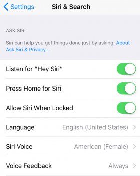

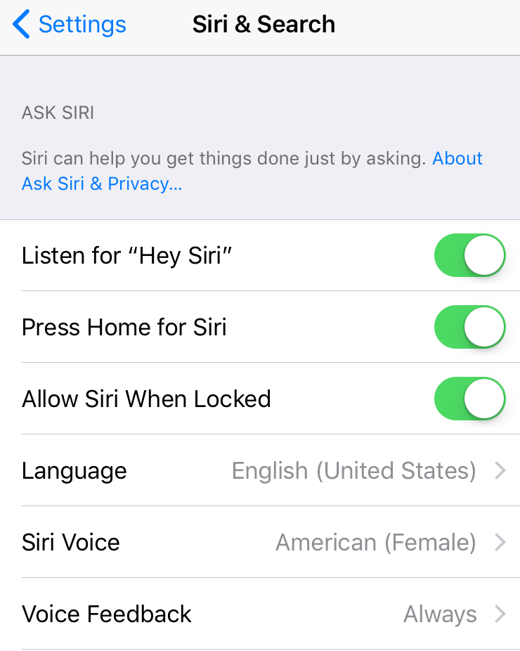

So I just attempted something and the issue of reading and dictating SMS via CarPlay was solved: I enabled “press home for Siri” in addition to the previously enabled options. Please see attached.

Just to let you know, try the fix posted above this post and see if it helps.
