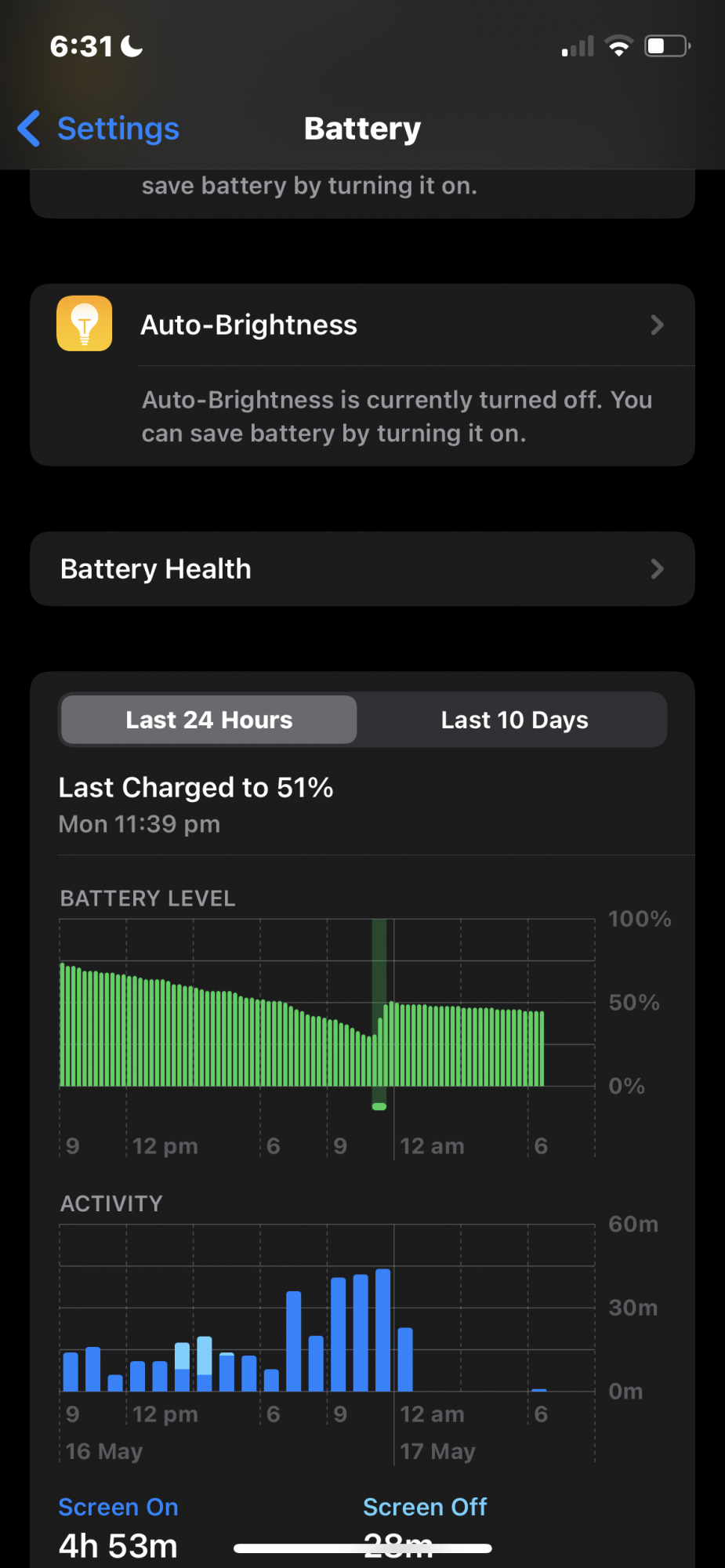

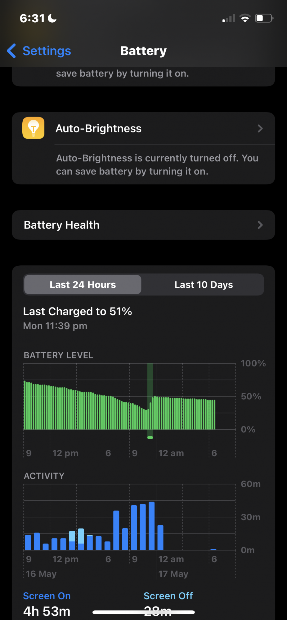

Do you see an improvement after the reinstall? Your previous screenshot shows idle battery drain around 50% so could you post the results around the same?
Battery drain tends to be flat when it’s close to 100% so this may not be an accurate observation.

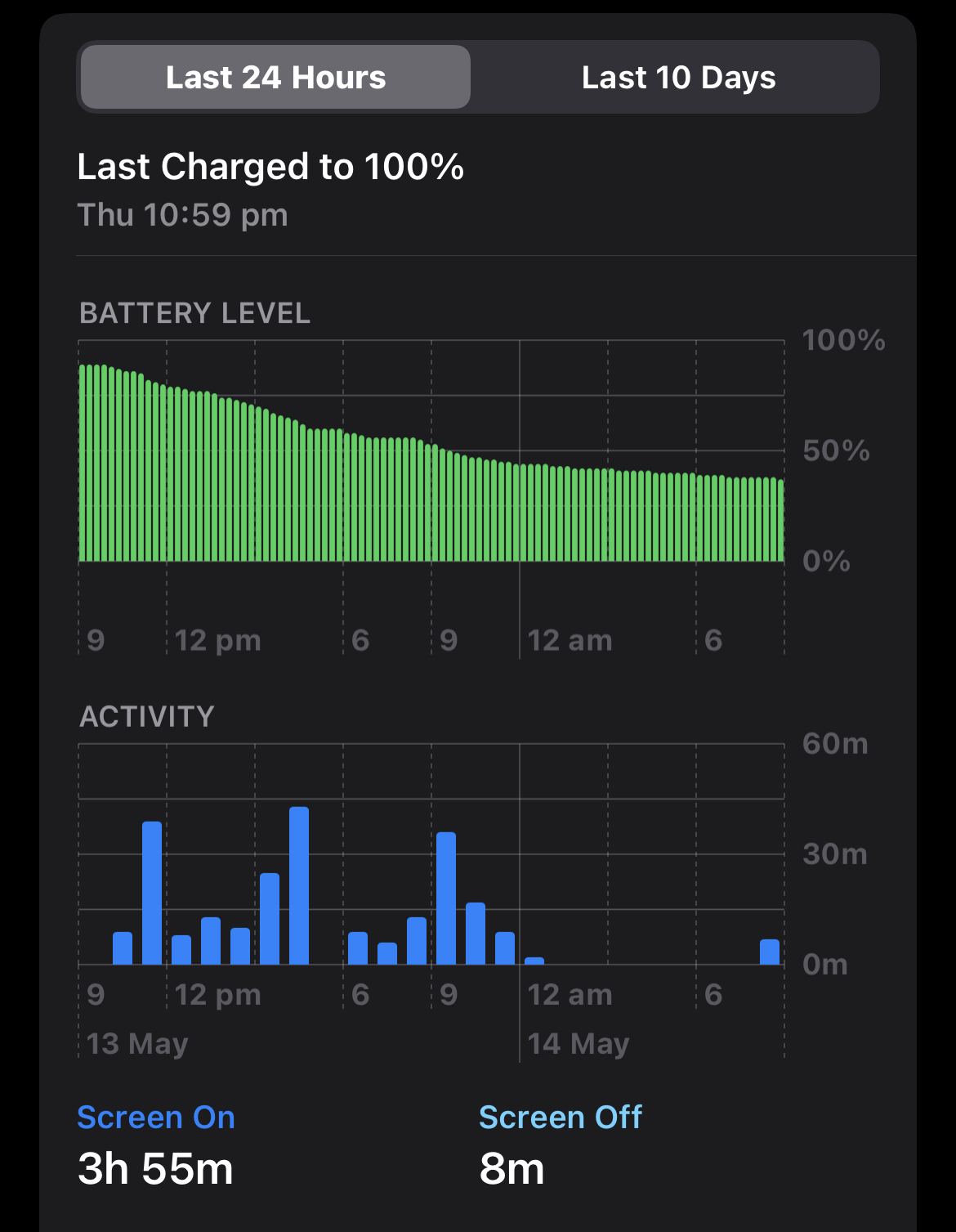

ORIGINAL INSTALL

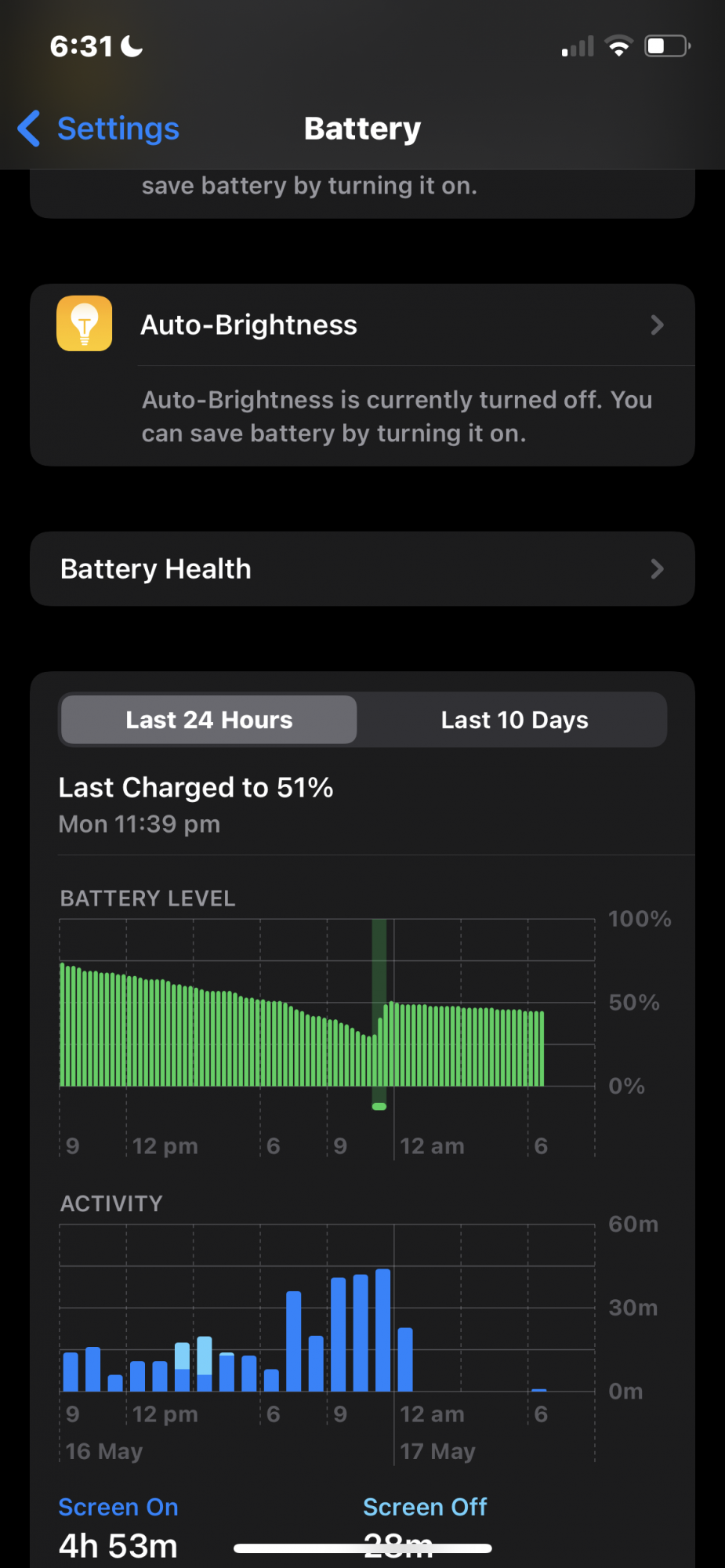

REINSTALL

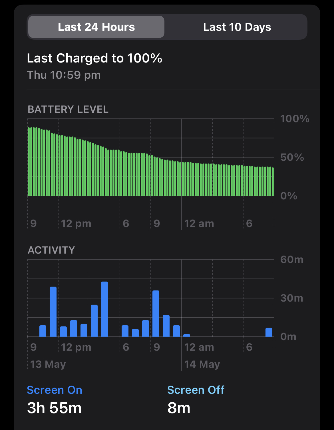

REINSTALL VERSION AT 50%
Battery drain in periods of non use much better. Even after 50% of discharge. 4% last night compared to 12% on the original install.
