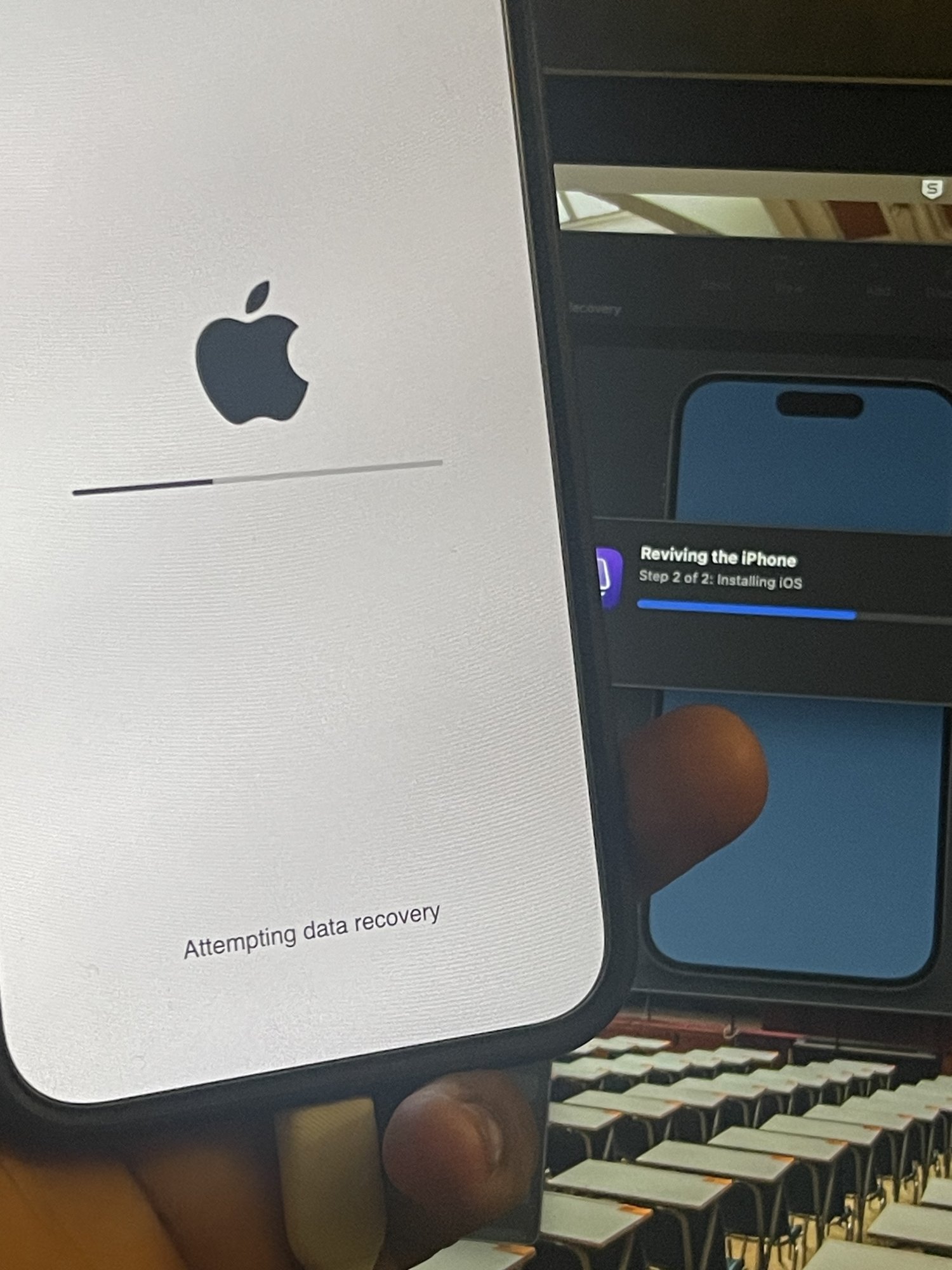

attempting a repair using apple configurator, data recovery process is happening on the phone, hopefully it works!
