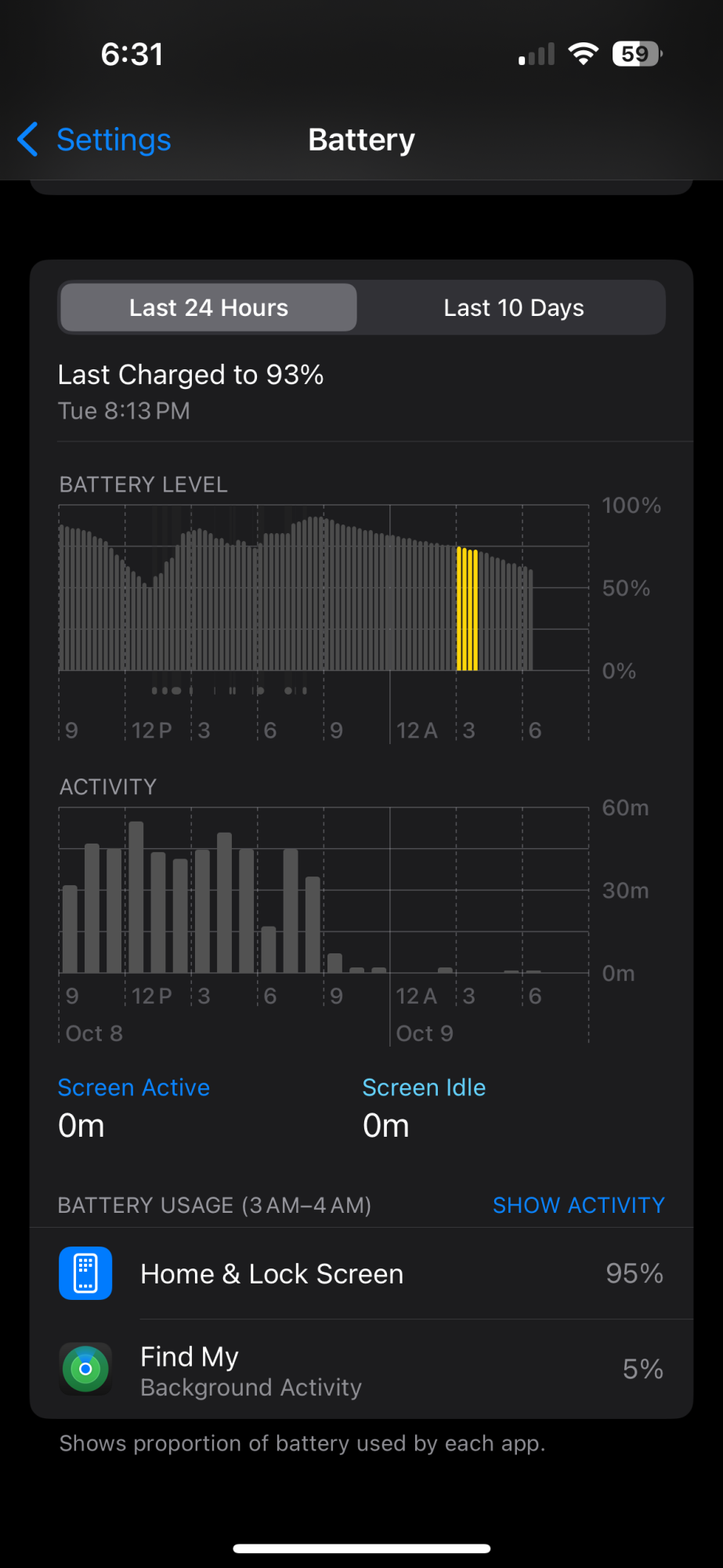

In Not happy with the Batterie Life. Standby drain over Night with wifi 6-7%. No flat line Like my 15PM After Release.
I turned find my off, Mayen this helps.

Idle battery drain is bad and getting worse. Sleep focus was on battery saver mode is on using a Lock Screen with zero widgets. Full WiFi signal. The only thing that has a bad connection is 2 bars of cellular but that was never a problem in the past and I’ve tried it with cellular off overnight with zero positive impact on this battery drain. At this point I’m at my wit’s end. iPhone 14 Pro running 18.01.

I am going to try one last experiment. I have my MacBook Air plugged in and in standby mode at my desk when I'm not using it (I only restart it once a week). With the introduction of iPhone Mirroring in ios18 and MacOS 15, I've noticed that even when I don't have screen mirroring open, my Mac still pulls in notifications from my iPhone which indicates some level of maintained connection. I wonder if it is maintaining this connection to my phone even when the computer is in standby, and my phone is in sleep focus / battery saver mode. I have disabled iPhone Mirroring on my iPhone and will test tonight to see if this helps. If it doesn't, I will try fully shutting down my MacBook. Will update with results.

You’re a genius! I bet this is what I going on! I am gonna do the same. So you turned it off on the phone side not on the Mac side?
Now that I think about it, that feature from Sequoia (and iOS 18) forces the iPhone to be constantly communicating with the Mac… hopefully they will make it more efficient, because it is a feature I really want to use once I have my M4 Mac mini.
Correct, it appears the only way to turn it off is to remove the mac from your phone by going to Settings > General > AirPlay & Continuity > iPhone Mirroring then swipe your mac to delete it.
I did this and while there was some battery drain overnight (Around 10%) it was significantly less than before (20%) and Home Screen / Lockscreen no longer showed as the main culprit! It's a shame because I quite like the feature but it's not worth the impact on battery life and the hassle at this point. Hopefully they are aware of this and optimize it in future releases.
Thank you! Yes, I do enjoy the feature as well, but it's not worth the battery life.
I was able to access my MacBook Pro and stop mirroring my phone, so it no longer appears in the settings. However, I'm not sure if that worked because I've still noticed idle battery drain, which seems almost the same as before. Maybe I need to remove it from the actual phone the way you did.
Yeah definitely try that. It could also just have been a partial solution for my particular case. Feels like there are just so many issues introduced with this release it’s hard to pin it to any specific cause.

After trying your trick on the phone, I can definitely see an improvement. I don't use mirroring often, so I'm not too upset. However, I would prefer not to have to turn it off to improve battery life.
