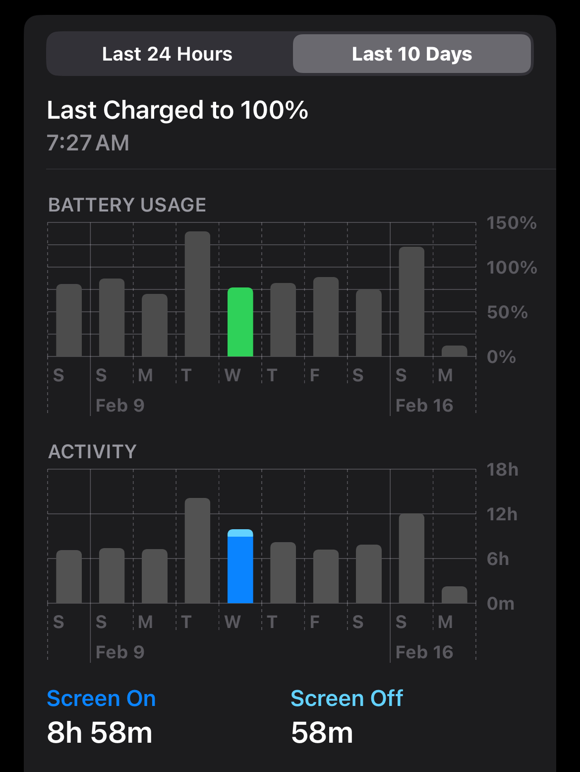

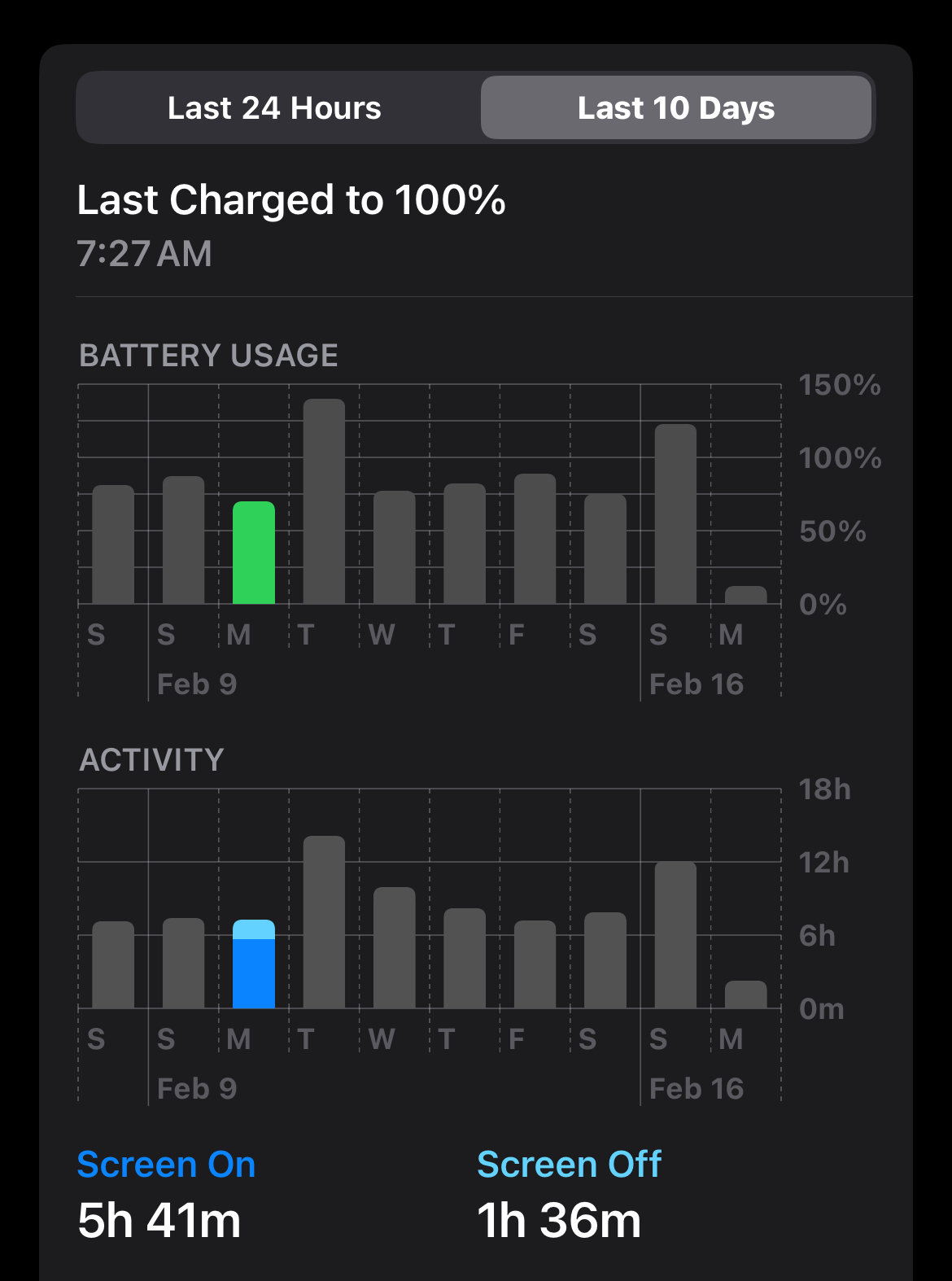

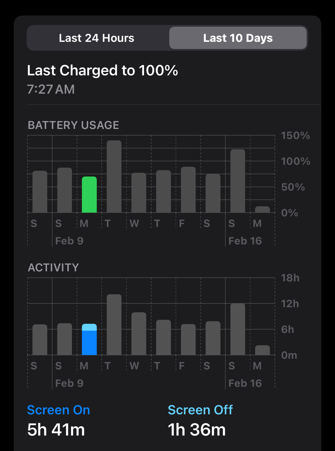

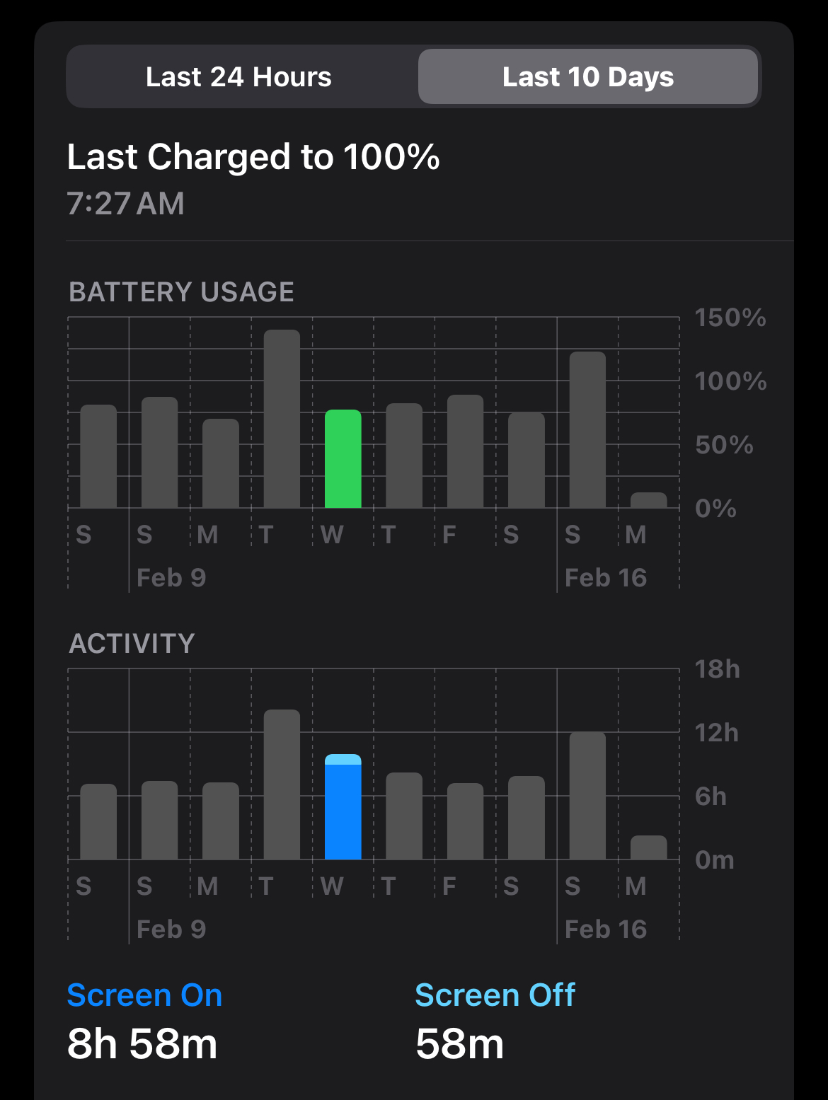

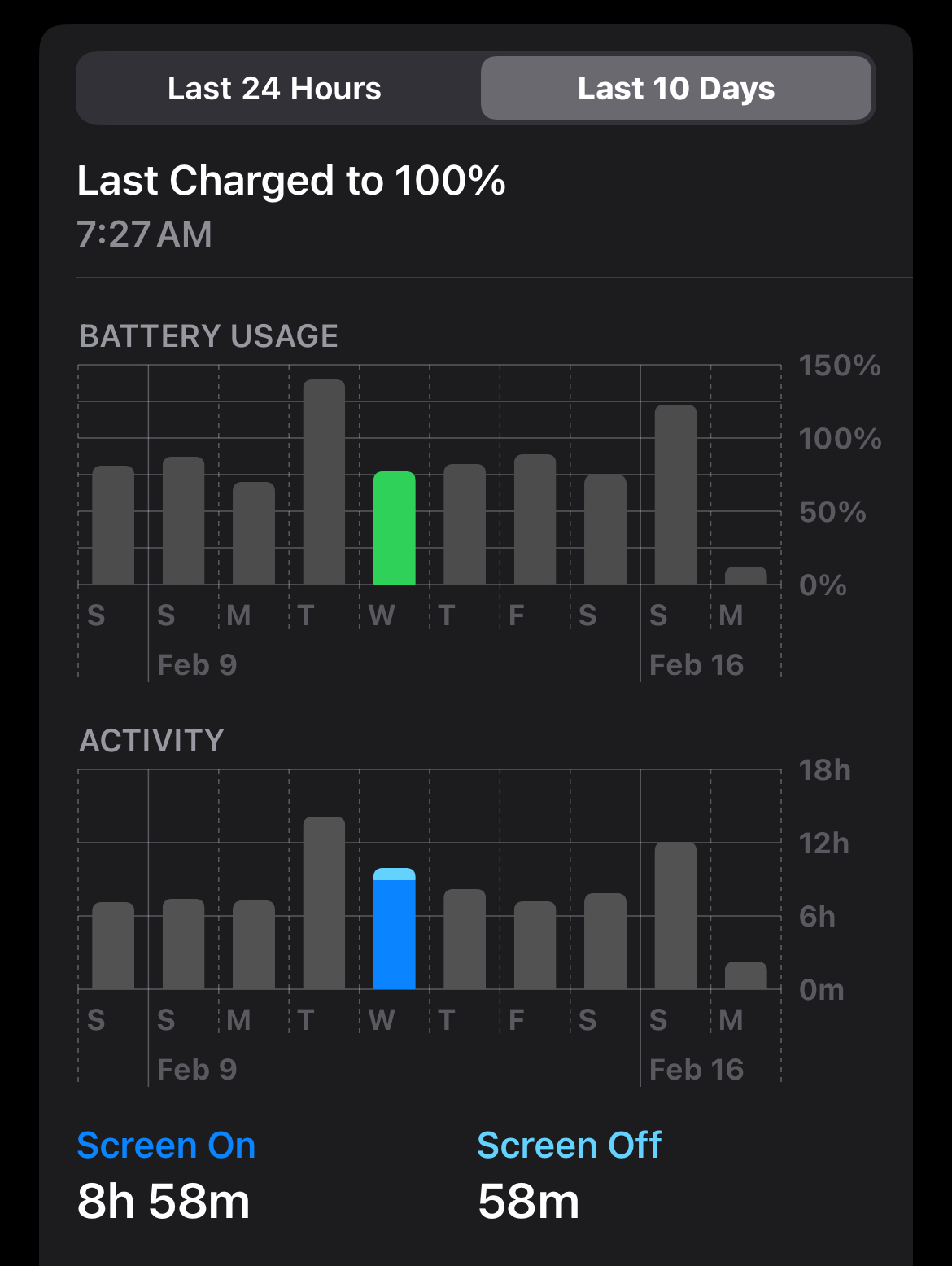

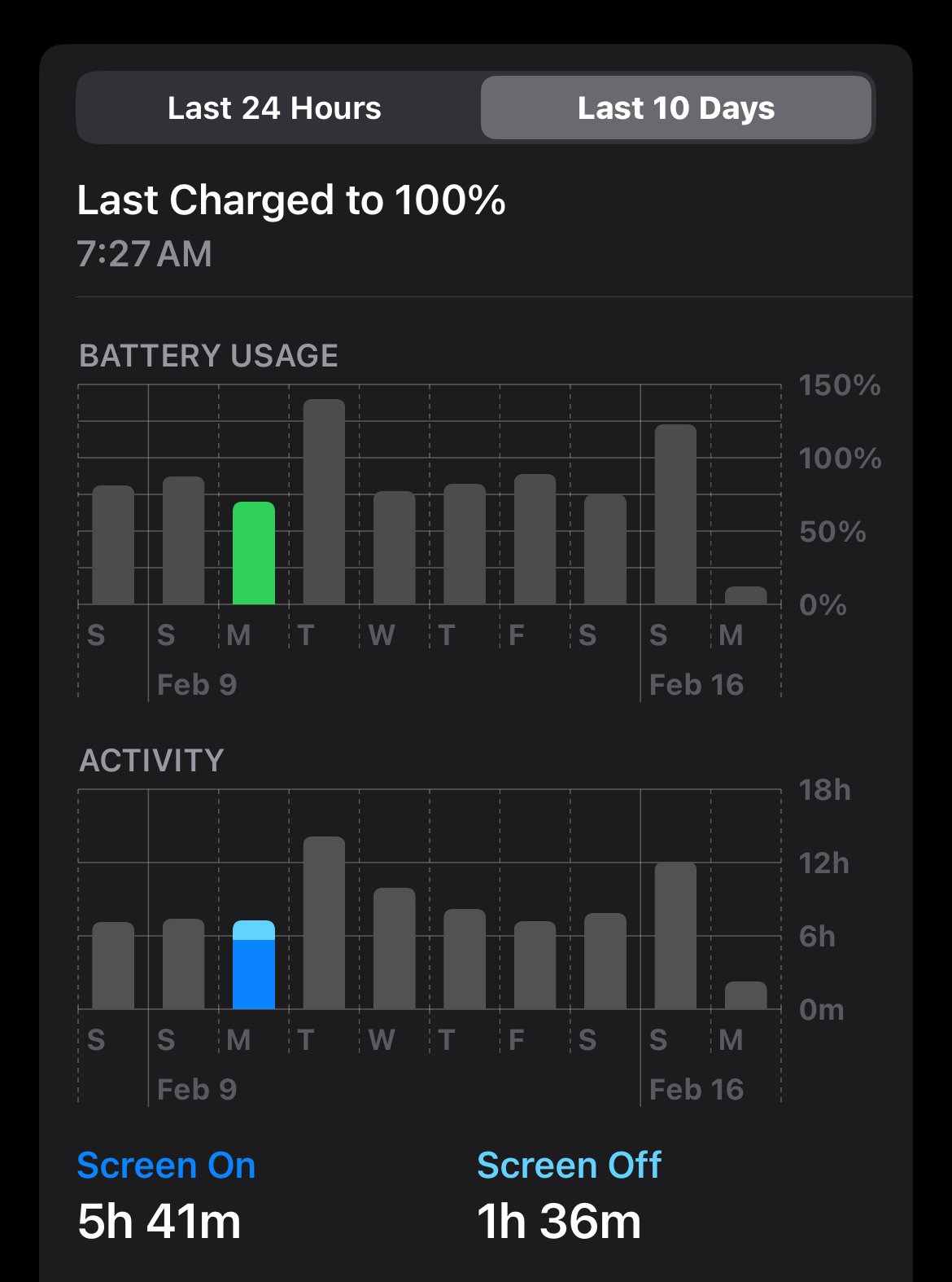

Didn’t make sense but that somehow turned the graphs from slopes to flatlines. You can see the difference between Monday and Wednesday.
