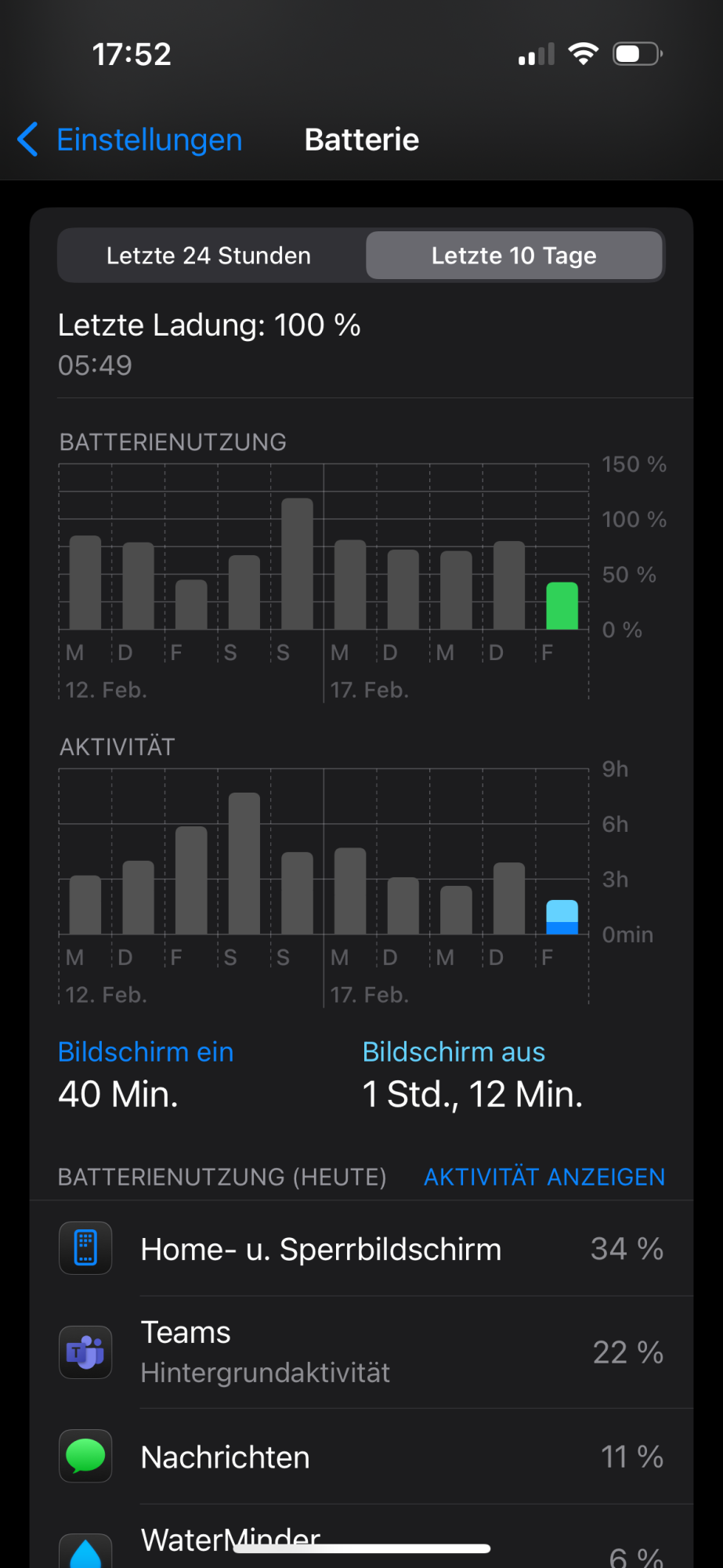

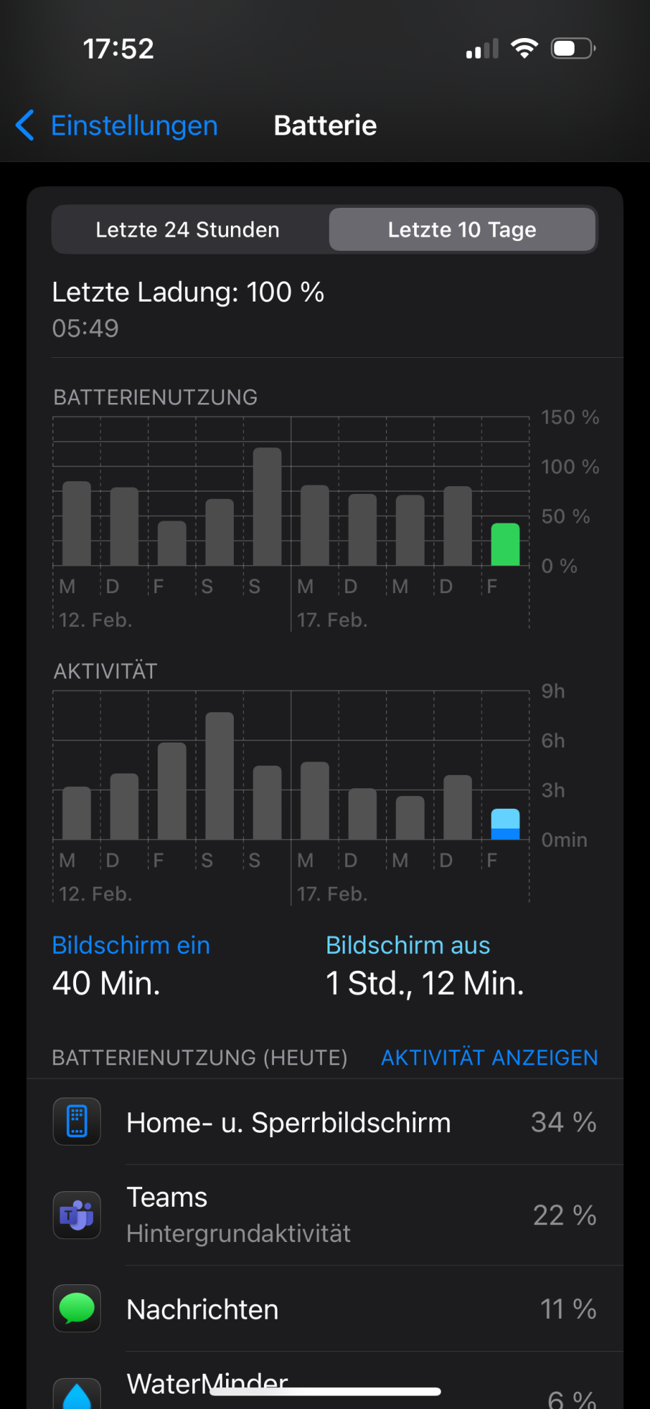

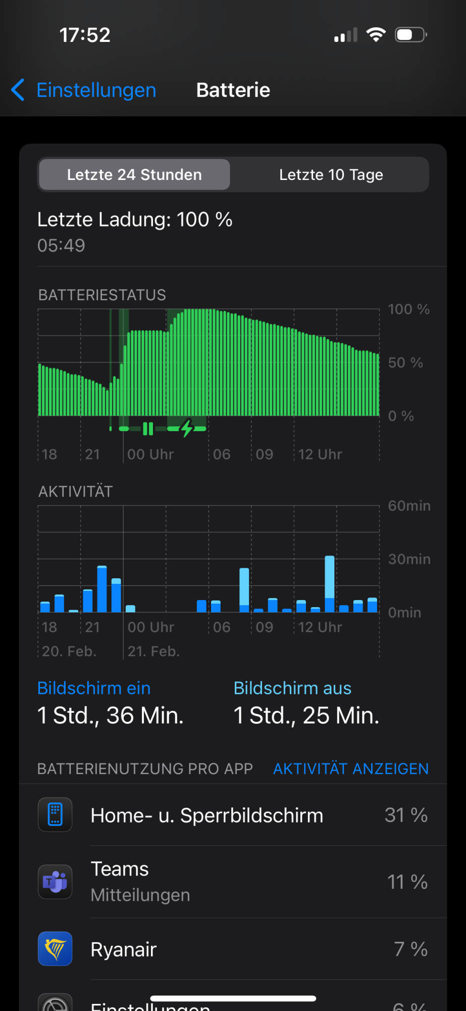

It‘s at 58 % right now, for 12h off the charger, 40 minutes SOT, 1h12m standby usage (which were phone calls over WiFi), on WiFi the whole day.
Reactions: Tomas1988
Your home/lock screen is eating all the battery. You probably have a widget refreshing too often. Remove the widgets, reboot, and test it tomorrow.
Only the stock photo widget is on the homescreen.
Nothing on the lockscreen.
On the widget page: Battery, Calendar, WaterMinder (had it removed for testing), Notes, Weawow (weather, also already removed), Shortcuts.

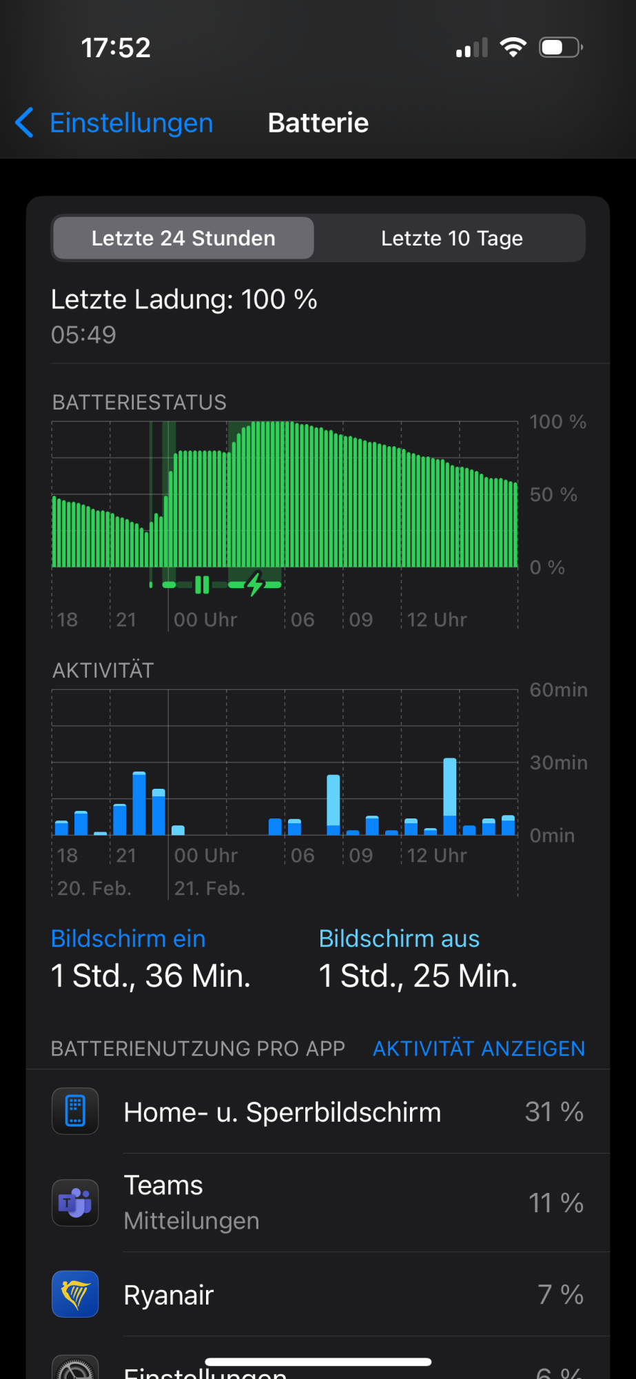

I don't understand you..you can see for yourself that background programs dominate to your battery life
Beside of background app refresh is of for all of the top apps, there is no significant drop when background usage is shown compared to when not …
And even if you add the times and round up, it’s only 2h (1h12m + 40m) …
Teams had 50ish minutes, homescreen 20ish and is still on top, tell me which programs … I‘m begging you …

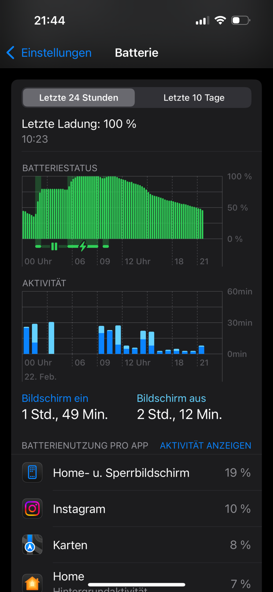

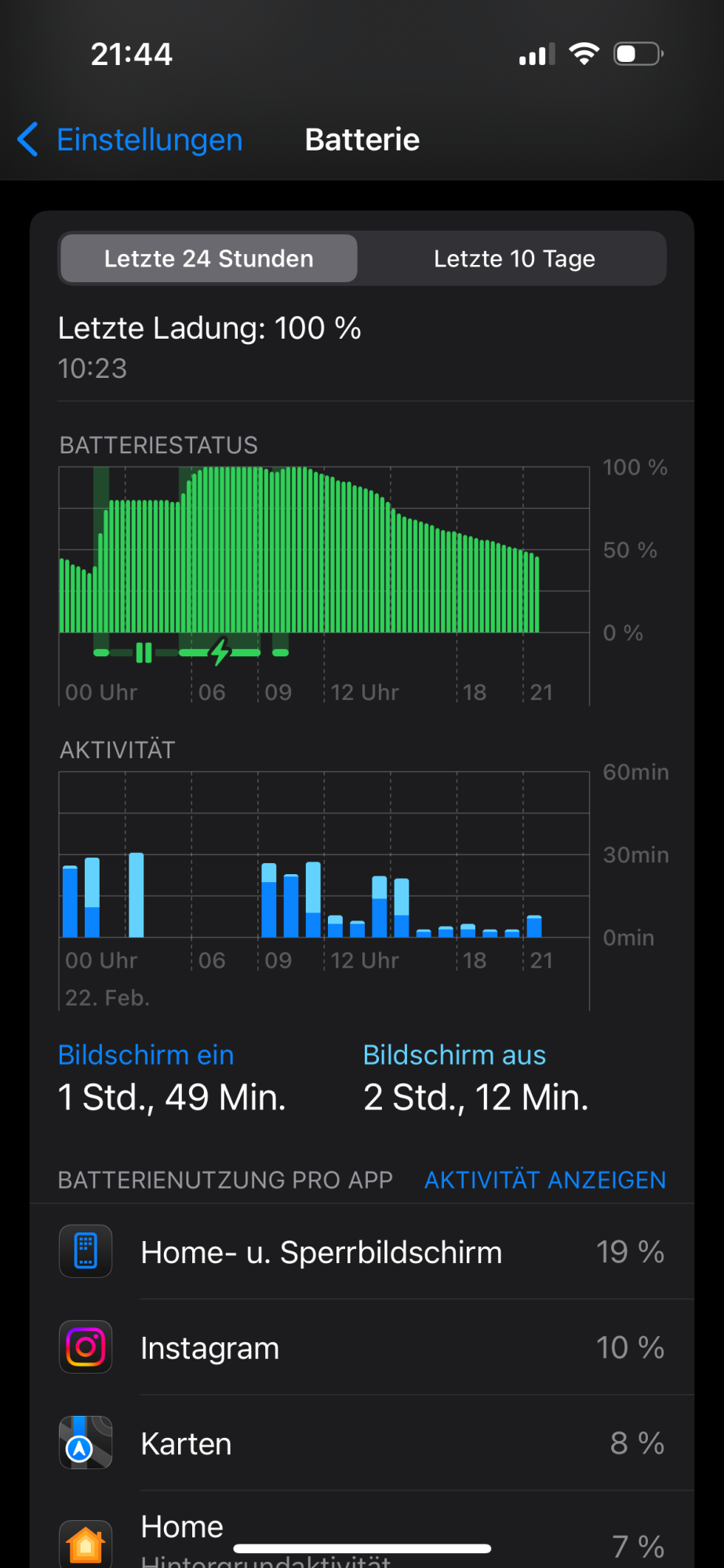

11h off the charger, I‘m at 48% with 1h49m SOT and 2h12m standby usage. I was driving with CarPlay, Apple Maps and streaming music (Apple Music lossless).
This looks better to me than usual, but also doesn’t make any sense to me.
