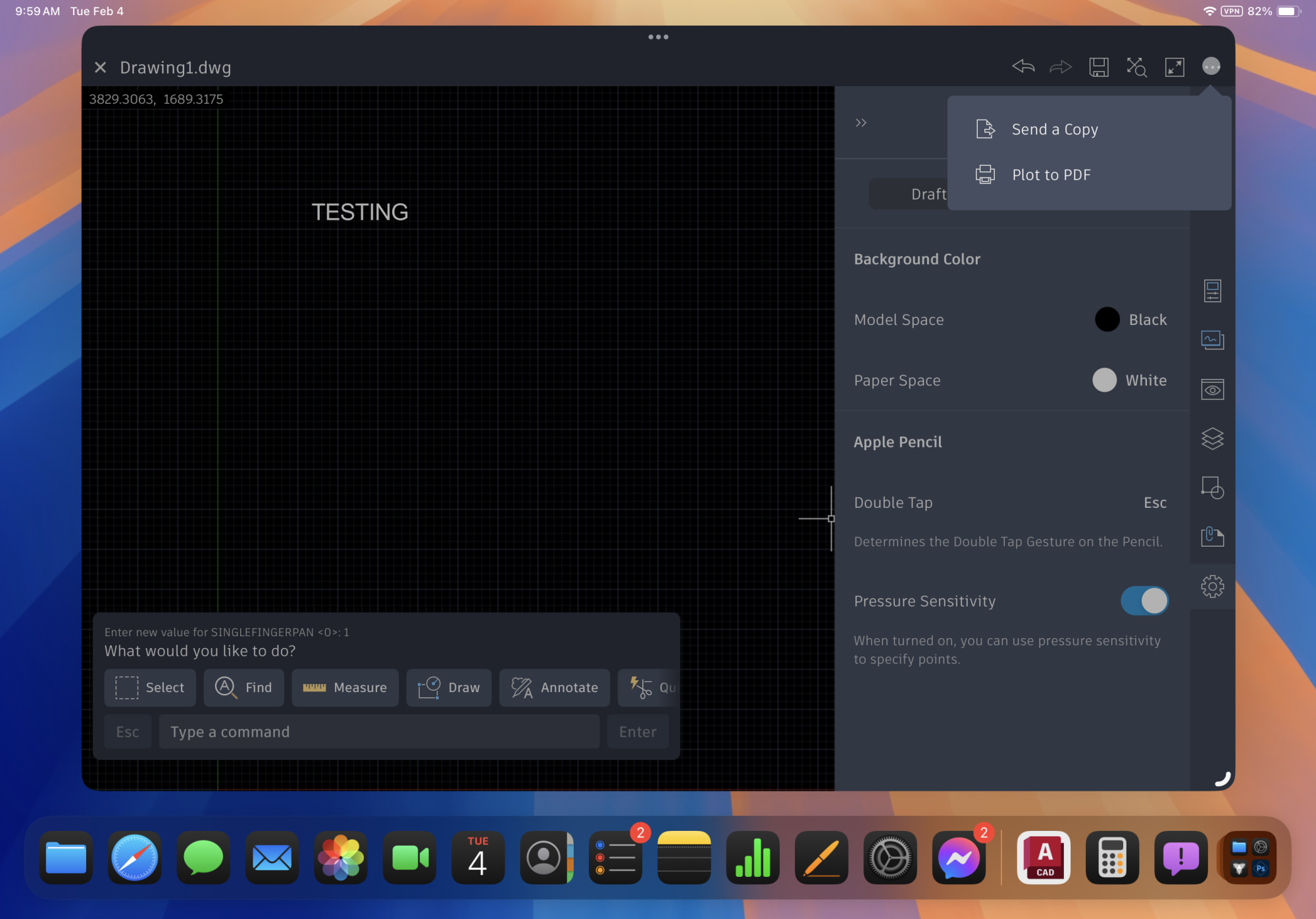

Awesome! I just installed AutoCAD, and I can set up a 30-day free trial. 👍🏻 This will be interesting, but I enjoy testing new apps, so it will be fun as well. Hopefully I can figure those things out for you. 👍🏻

A few quick questions. By color tables, do you mean changing the background color of a table? Or is that some other feature? And by addition of fonts do you mean adding fonts into the app like for missing fonts? I was already able to confirm that it does in fact support plotting to PDF, and I’m pretty sure that it supports the other two, as long as I’m understanding correctly, but I want to make sure I’m understanding what you’re talking about correctly. 👍🏻. I can get together some screenshots to show the features and how they work. 👍🏻

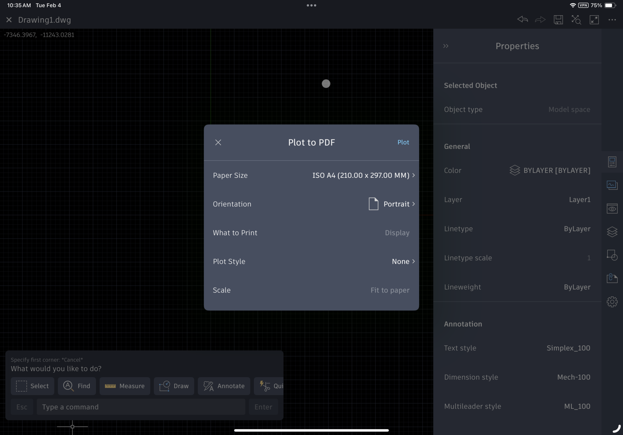

A colour table is a file that specifies a line weight to a colour, so drawing a cyan line prints a thick line and a magenta line is thin. Looking them up, they’re called Plot Styles, though they’re *.ctb files.

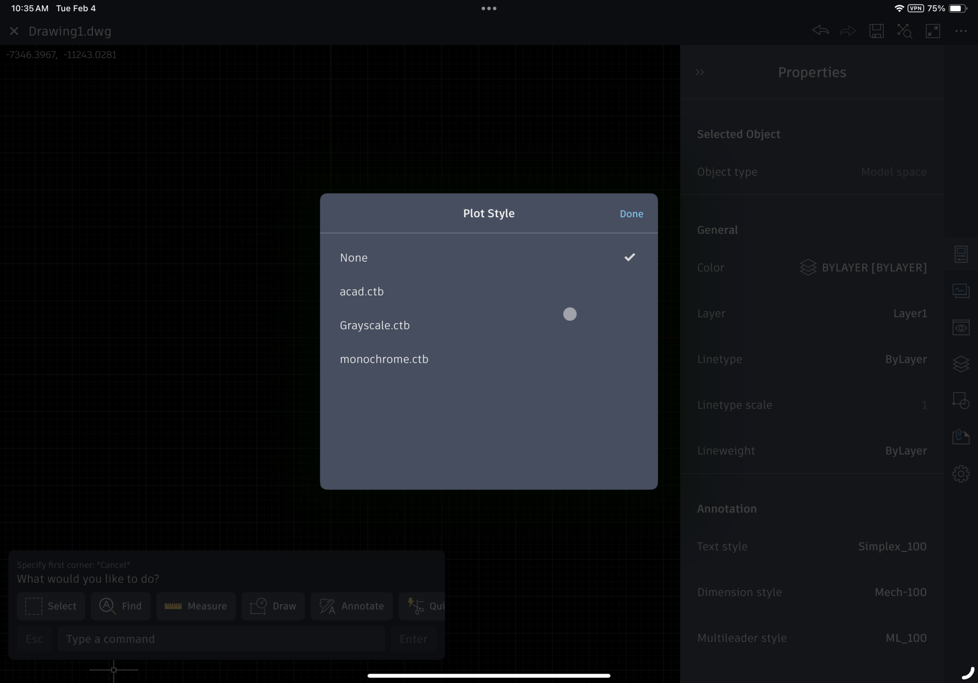

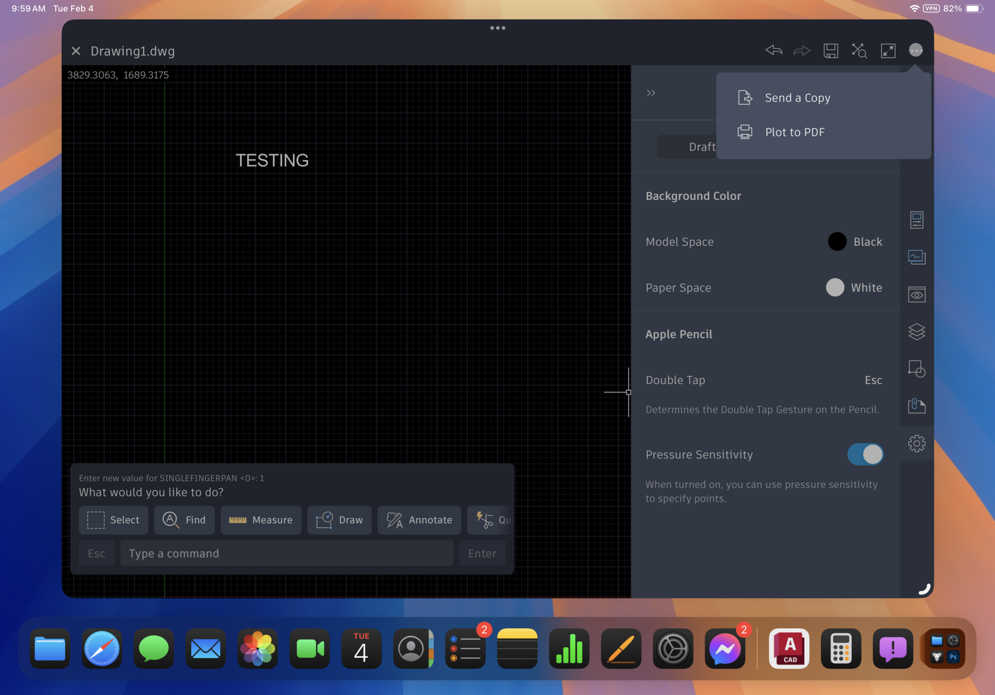

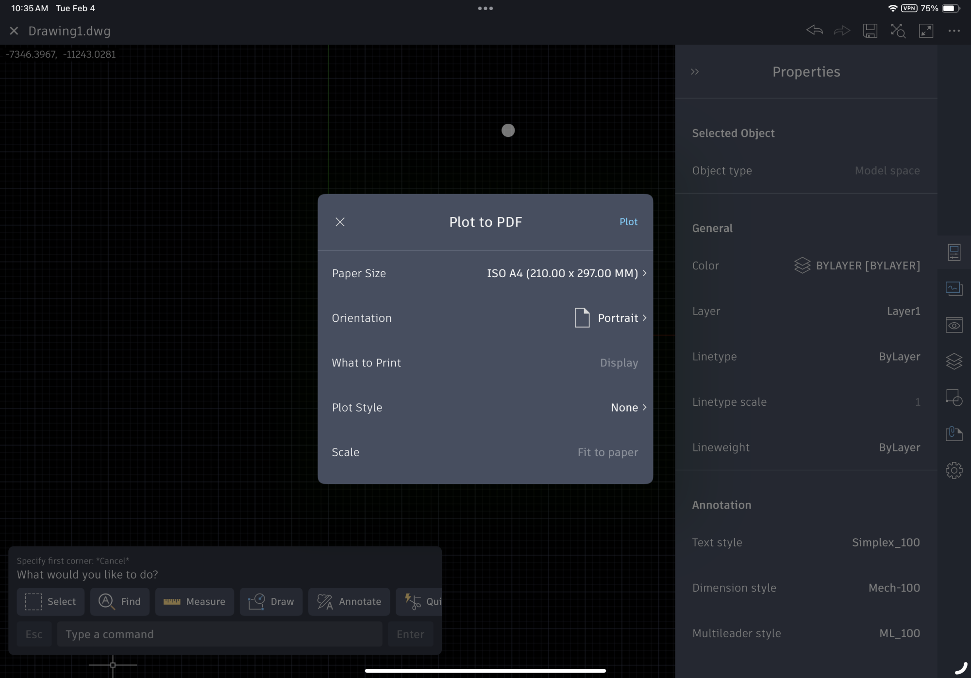

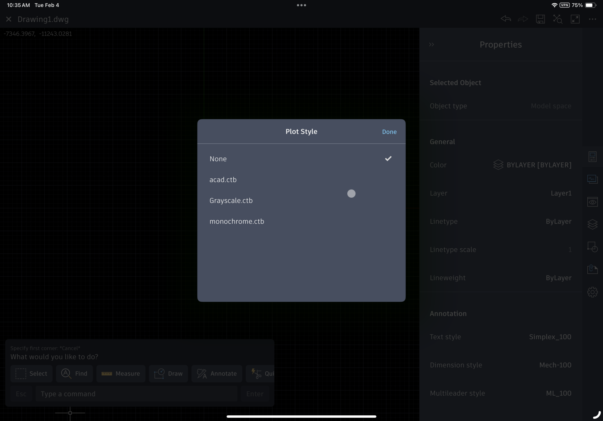

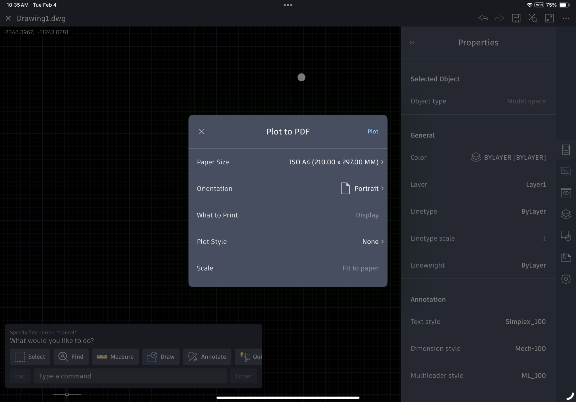

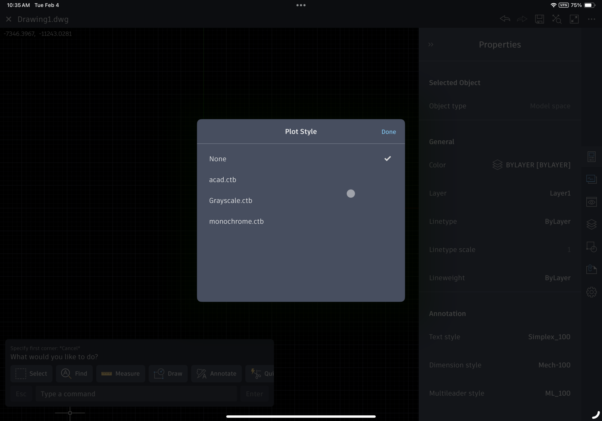

Ok, that makes sense! 👍🏻. Yeah, I was just looking up tutorials for color tables in AutoCAD and realized you were probably talking about Plot Styles, which I think some called color style tables as well. 👍🏻. Do you know of a good source for SHX fonts I can try adding? For my graphic design, I don’t think I have a single SHX font. I can try looking some up to download and test. But I did read an official support tutorial from AutoDesk describing how to import SHX fonts into AutoCAD on the iPad, so it should work. I got a screenshot of the the “Plot to PDF” button as well as the “Plot Styles” interface that pops up for it. 👍🏻.
Also, I believe you can import .ctb files the same way you can import fonts, I just don’t have any .ctb files to try.
PS It added the screenshots in the reverse order of the way it works.

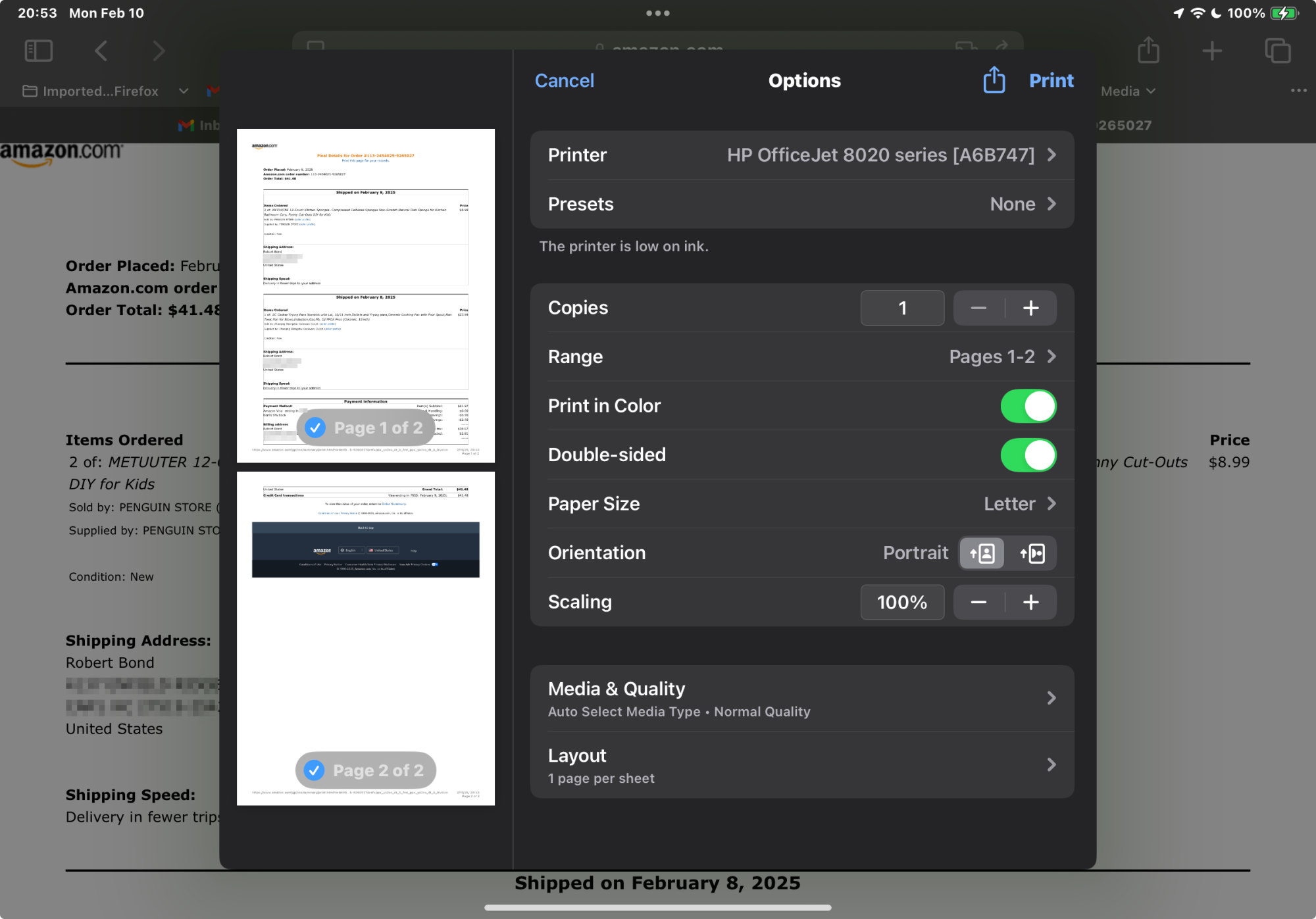

Interesting. I just went to Amazon.com with Safari on my M1 iPad Pro 11 to open one of my orders. I opened the invoice, hit the print button and found my printer (HP OfficeJet 8020), and it printed the invoice with no problem.

Interesting. I just went to Amazon.com with Safari on my M1 iPad Pro 11 to open one of my orders. I opened the invoice, hit the print button and found my printer (HP OfficeJet 8020), and it printed the invoice with no problem.View attachment 2481064

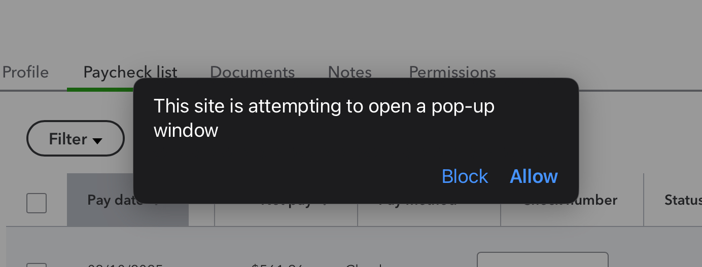

It's specifically Quickbooks Online website. On the Windows PC, it opened a pop-up window with the PDF to print. I couldn't get that pop-up window to open on the iPad (clicking the button did nothing). I have no issues printing anything else from the iPad in Safari, Mail or any other app (I print probably 20-30 pages a day from it at work).
I went back to Quickbooks just now as I’m posting this comment to try to get a screen recording of what I was trying to explain. Of course now that I try it again this morning, I'm getting a message saying "This site is attempting to open a pop-up window." Tapping Allow opens up the paycheck PDF file I had issues with yesterday. I was on a slightly different page inside Quickbooks yesterday, maybe it was just an issue on the specific website page.
I guess problem solved! 😅
