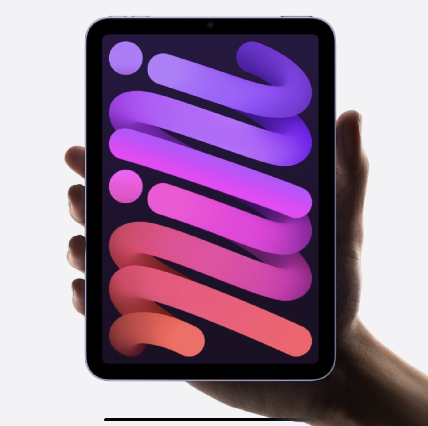

So what we know so far is this: this problem only appears when scrolling in portrait orientation - this means the cause is most likely hardware. The screen is likely mounted sideways, meaning it is refreshing from left to right when the iPad mini is in portrait mode (rather than from top to bottom). On the Mini 5 some people can see this issue (albeit not as bad) in landscape orientation, as the screen was not mounted sideways.
The problem Apple has is this: The Mini is often shown in in their advertising in portrait mode. The orientation of the logo on the back suggests it’s main use is in portrait; even the smart folio book-style cover encourages you to use to use it in portrait mode. Therefore, it should be useable in portrait mode, without this much of a display issue imo. And I bought it to use in portrait mode!

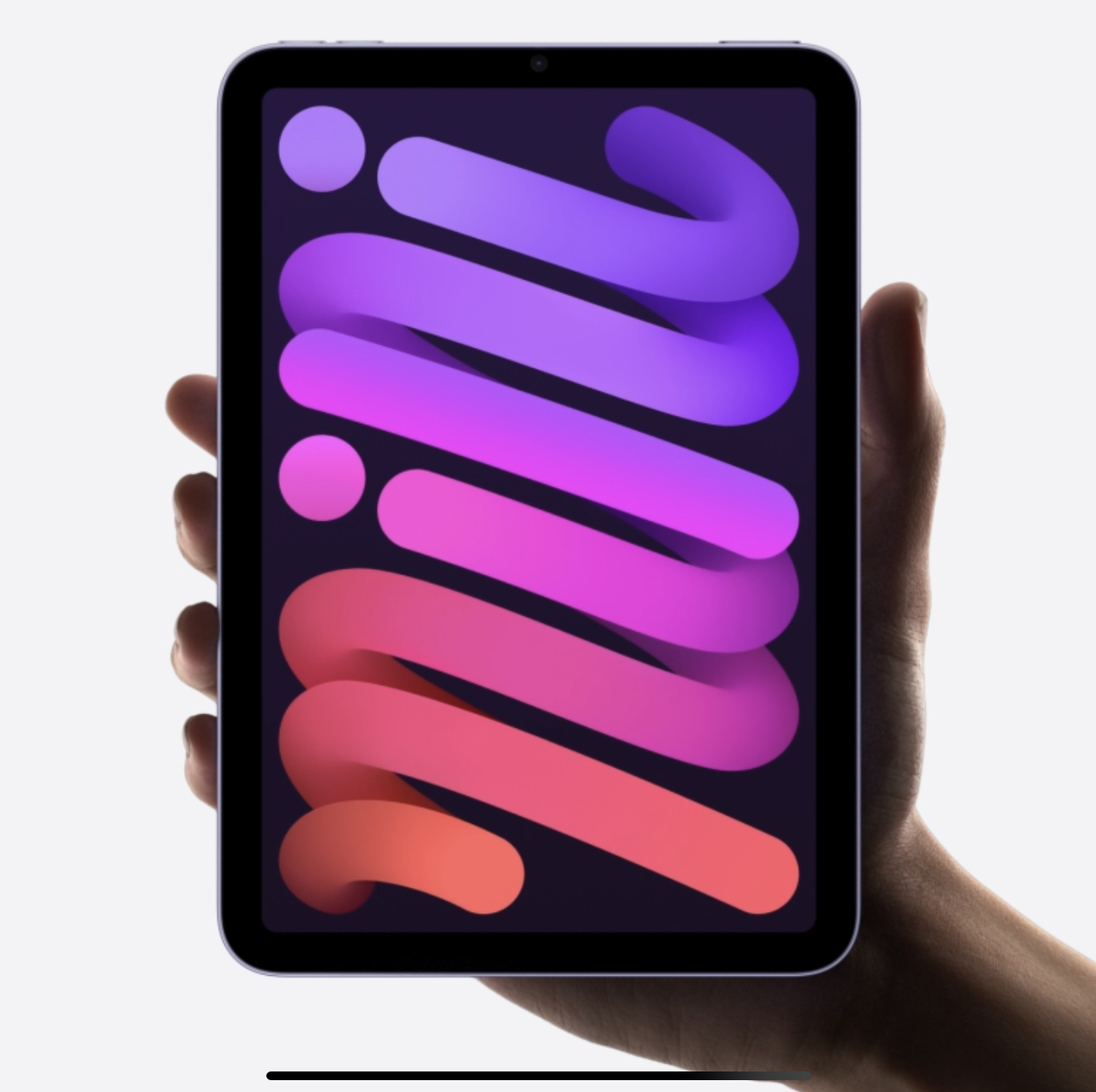

The front camera is positioned for portrait use, so the Mini is absolutely designed by Apple to be used in portrait. No excuse for this amount of jelly scroll in portrait.
