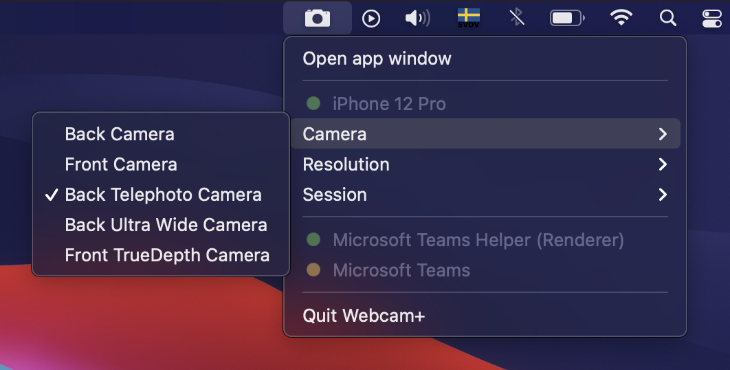

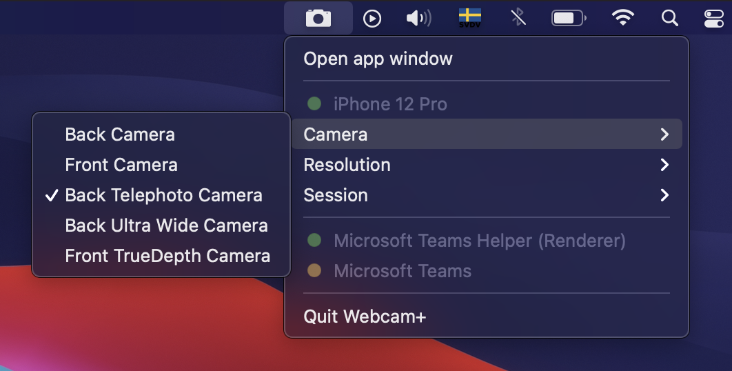

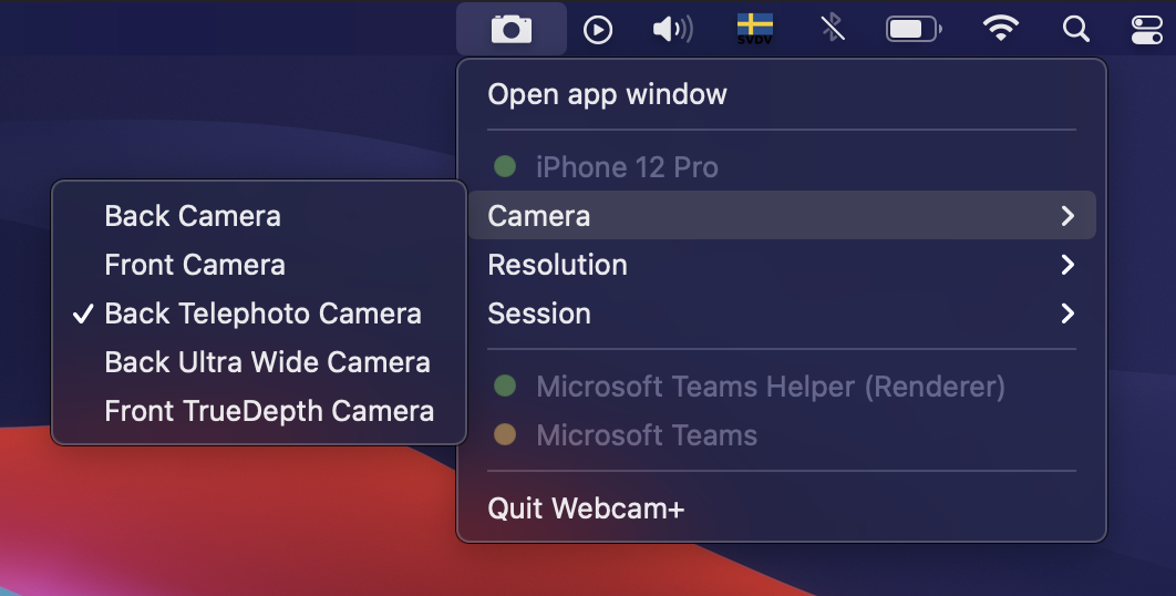

In my app, I have also added greater session control from the Menu Bar:
