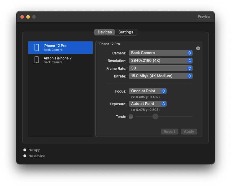

Hello guys! I'm back again with some updates to this project.
I have added settings for 4K resolution (2160p), Focus, Exposure, and LED control. I am starting a new beta round for these features.
Keep in mind that 4K is not recommended for Video calls. If you run 4K during a video call, it is likely that the video will be downscaled resulting in a worse quality, higher latency, and unnecessary performance stain. So, make sure that 4K actually makes sense for the software that you intend to use (such as OBS).
For Focus and Exposure I have added 3 options:
- Auto
- Auto at Point
- Once at Point
The coordinates for the points can be set via the Mac's preview window for now.
Signup via: - LINK REMOVED -
