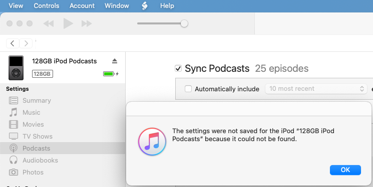

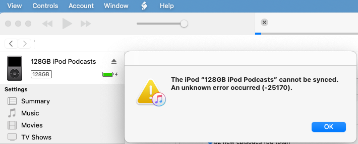

I have just spent two full days and several calls to Apple support trying to figure out why my beloved iPod Classics suddenly stopped syncing with the Music app as well as iTunes (via Retroactive 2.0). After a lot of testing, it appears that everything works fine on 13.1 but not on 13.2. I would appreciate it if other people could confirm if it is the same for them or not. I have tried 5.5G, 6G, and 7G iPods, and it's all the same.

With iPod "sleeping" (screen off), if a sync is activated, iTunes pops out an error message (unknown error -25170), which I could also find in the log.
In this situation the iPod could be synced by closing iTunes and reopening it.
Once it has finished with the "pairing" with the iPod and the iPod screen is still on it can be synced without errors.

The error messages I get are "The iPod cannot be synced. An unknown error occurred (-25170)" or "The settings were not saved for the iPod because it could not be found".
