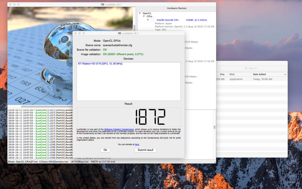

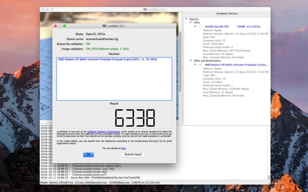

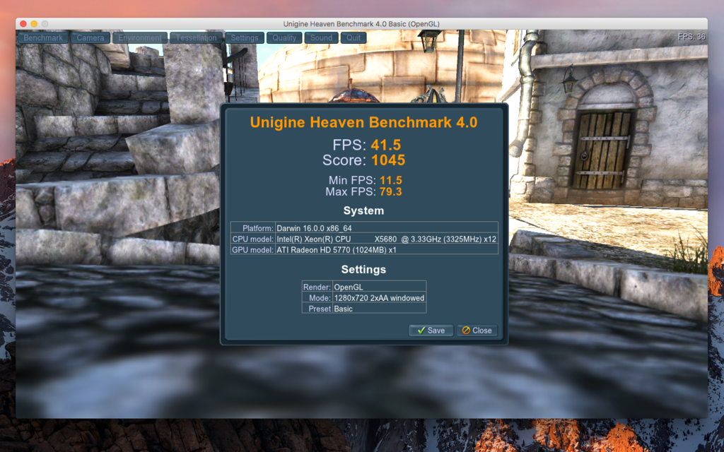

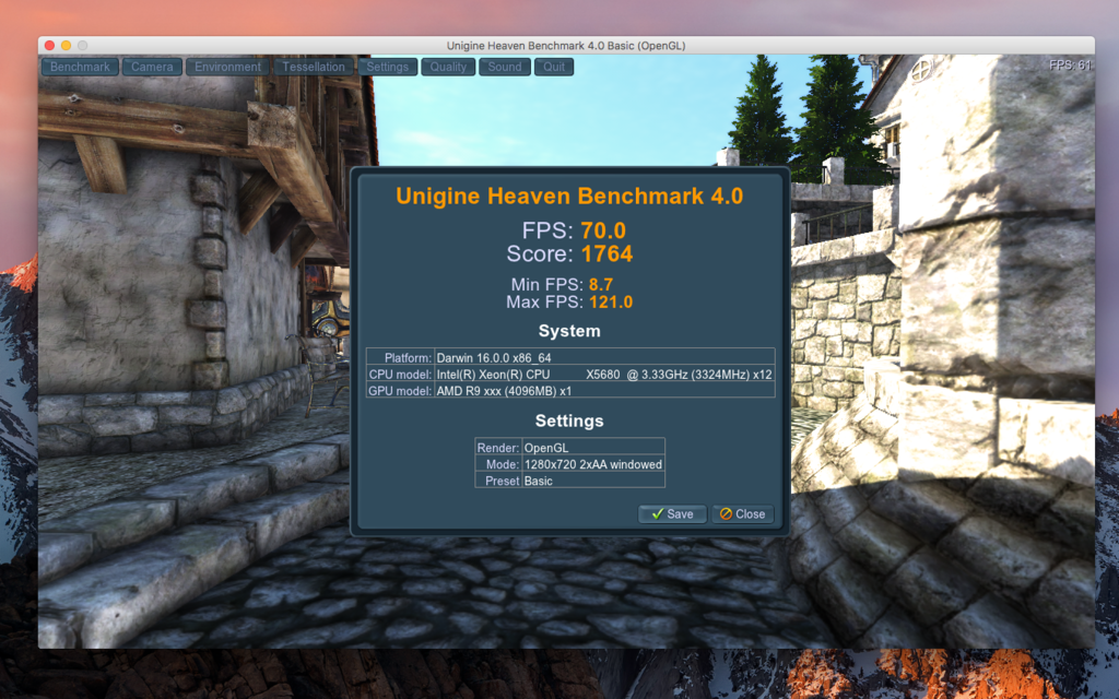

I got a Gigabyte RX 460 working OOB. And, happy with it. Works fine! No pcie cables and runs lower power usage than HD 5770... and is faster at the same time. So, it's fine.
Thanks though!
Here's some pix & compars!
RX460 Luxmark:
HD5770 Luxmark:
RX 460 Unigine Heaven:
HD5770 Unigine Heaven:
No cables, faster, lower power consumption than HD5770, more VRAM, too and it's affordable:
