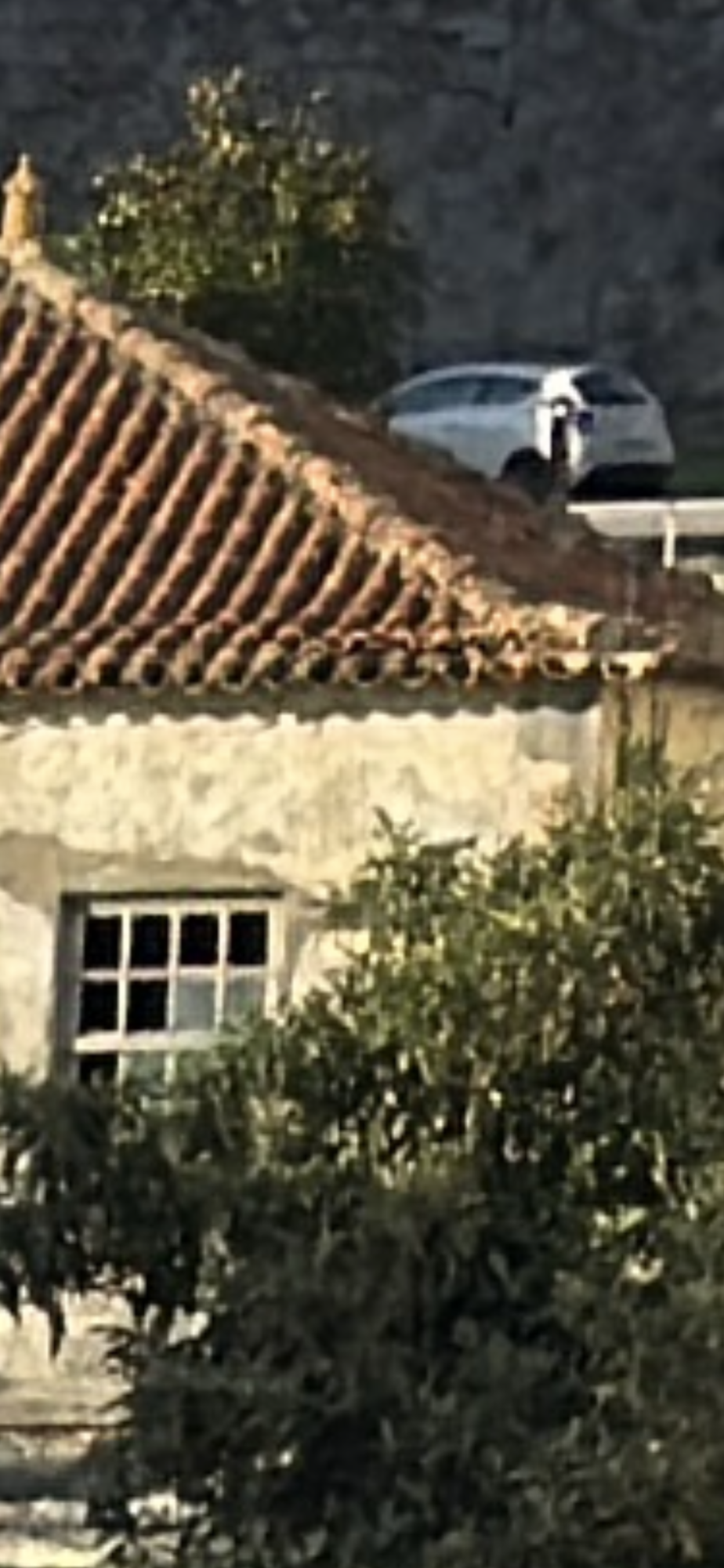

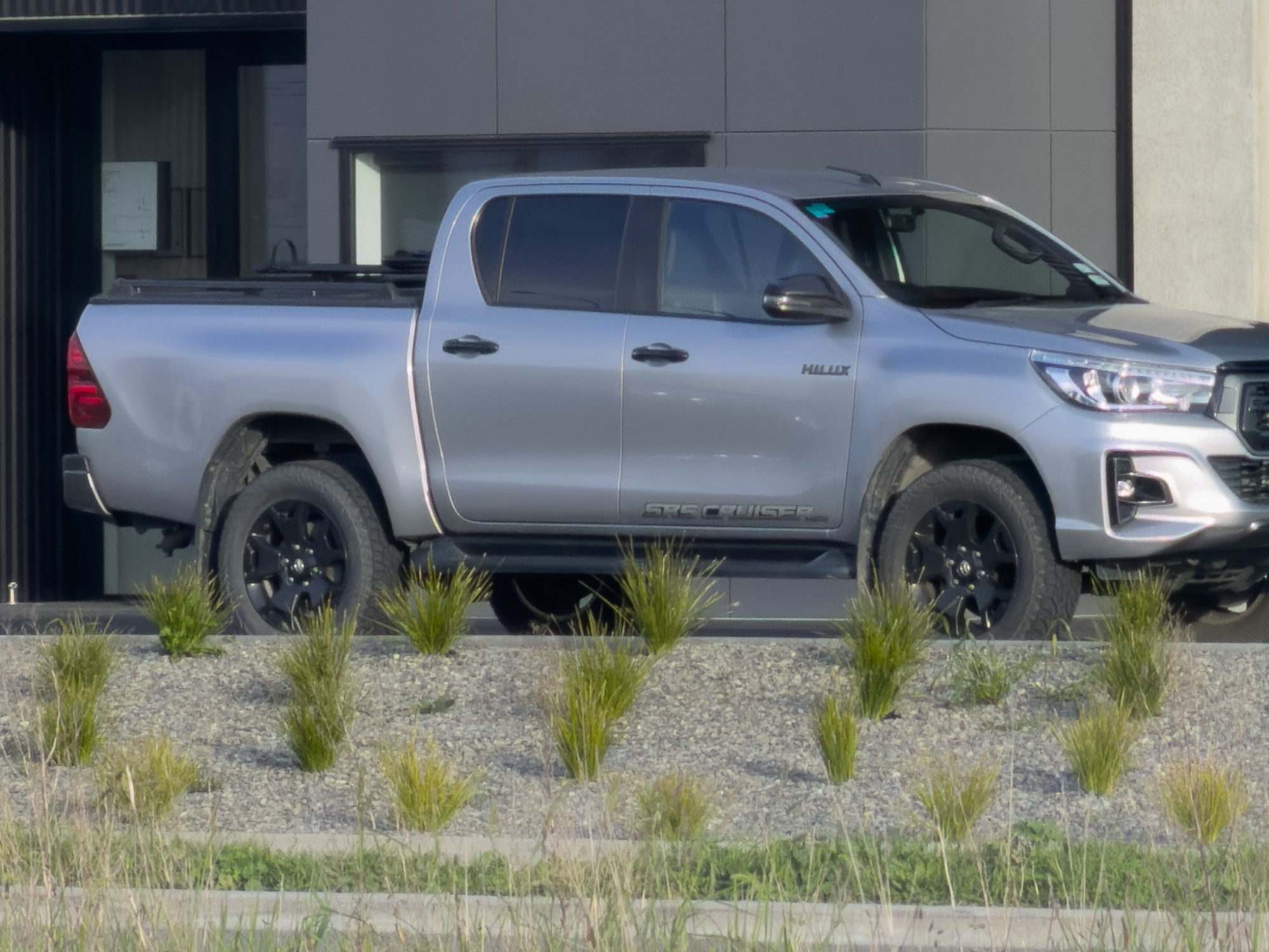

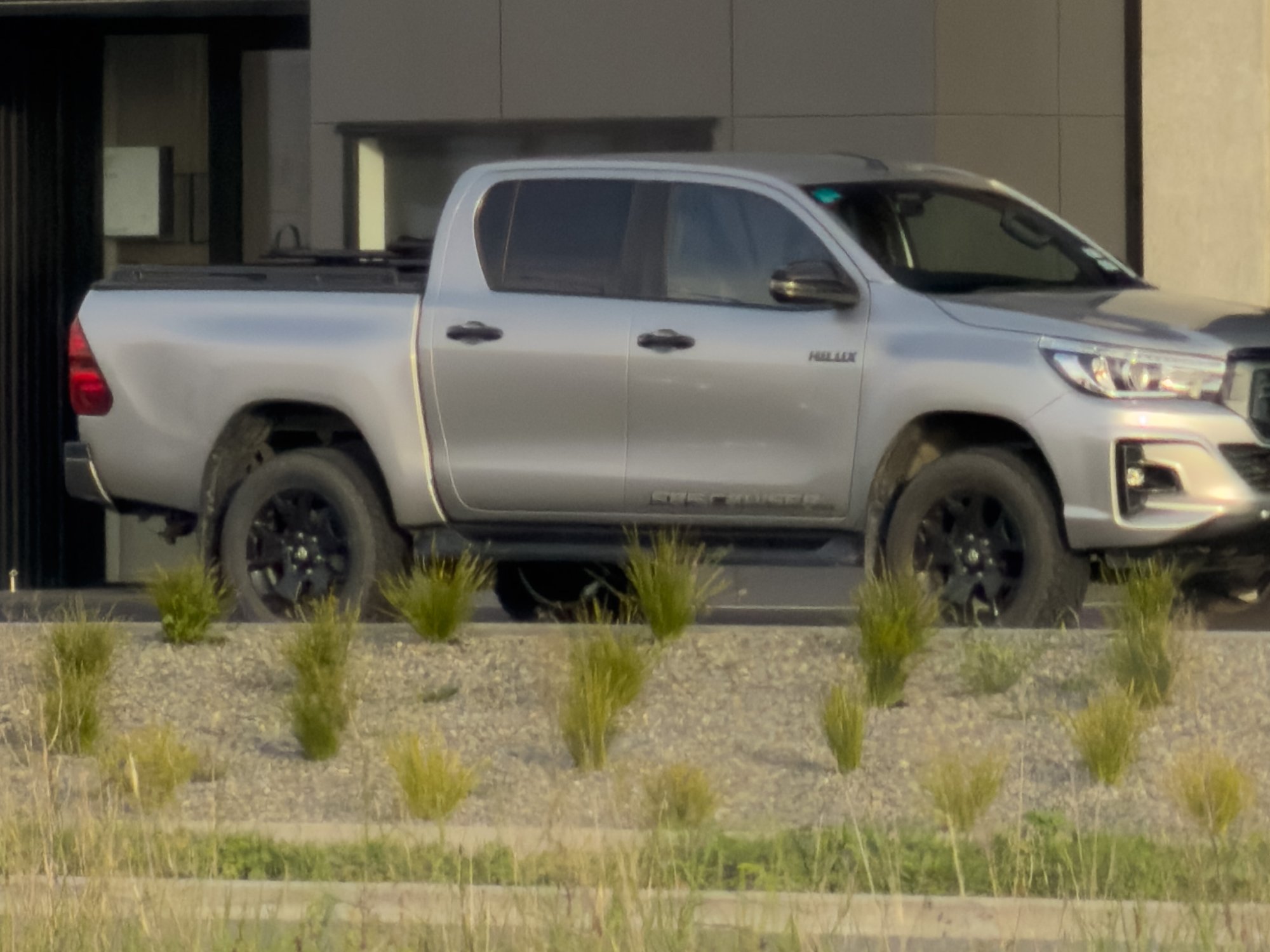

So, after watching this video, I may have just had a small breakthrough.
Like the Youtuber, I use the ProCamera app so that I get much better manual control. I noticed during his video that under-exposing the 17 Pro and then pulling up the exposure results in a completely blurry slurry of information that is unusable. So I wondered, what happens if you do the opposite?
So I took a photo out the window here at work using the 4x Telephoto. The first photo, I took using the normal 'auto' exposure settings that the iPhone applies. The second photo, I pulled down the shutter speed as far as I could without causing massive clipping at the highlight end, and retook the same photo. I then imported both into Lightroom and pulled the overexposed photo down to a more normal level. Have a look at the outcome:
17 Pro 4x Telephoto 48MP ProRaw 1:1 @ Auto Exposure (shutter speed auto-set to 1/400th sec)
17 Pro 4x Telephoto 48MP ProRaw 1:1 @ Overexposed through longer shutter speed. (shutter speed set to 1/120th sec)
Check out the Hilux and SRS Cruiser text. As you can see, forcing a slower shutter speed and letting more light in essentially completely resolves the issue. The over-exposed photo is pretty much tack-sharp at full zoom and 1:1 pixel ratio. (Incidentally, it also renders much more natural colours without the yellowish overtone that seems to plague ProRAW).
So that, for my phone at least, confirms it is 100% a software issue - I suspect the default exposure settings are essentially under-exposing the image and the computational pipeline is then trying to compensate, resulting in a blurred image.
Give it a go yourself - push the shutter speed as slow as you can without completely ruining the highlights, and then compare to a normal exposure.

Supplementary finding to the above : Over-exposing to the same level through decreasing the ISO sensitivity (in this case, to the minimum setting of 25, which the iPhone then decided to increase to 40 through its infinite wisdom) also improved the situation - but nowhere near as much as lowering the shutter speed did. It also retained the yucky yellow ProRAW tint.

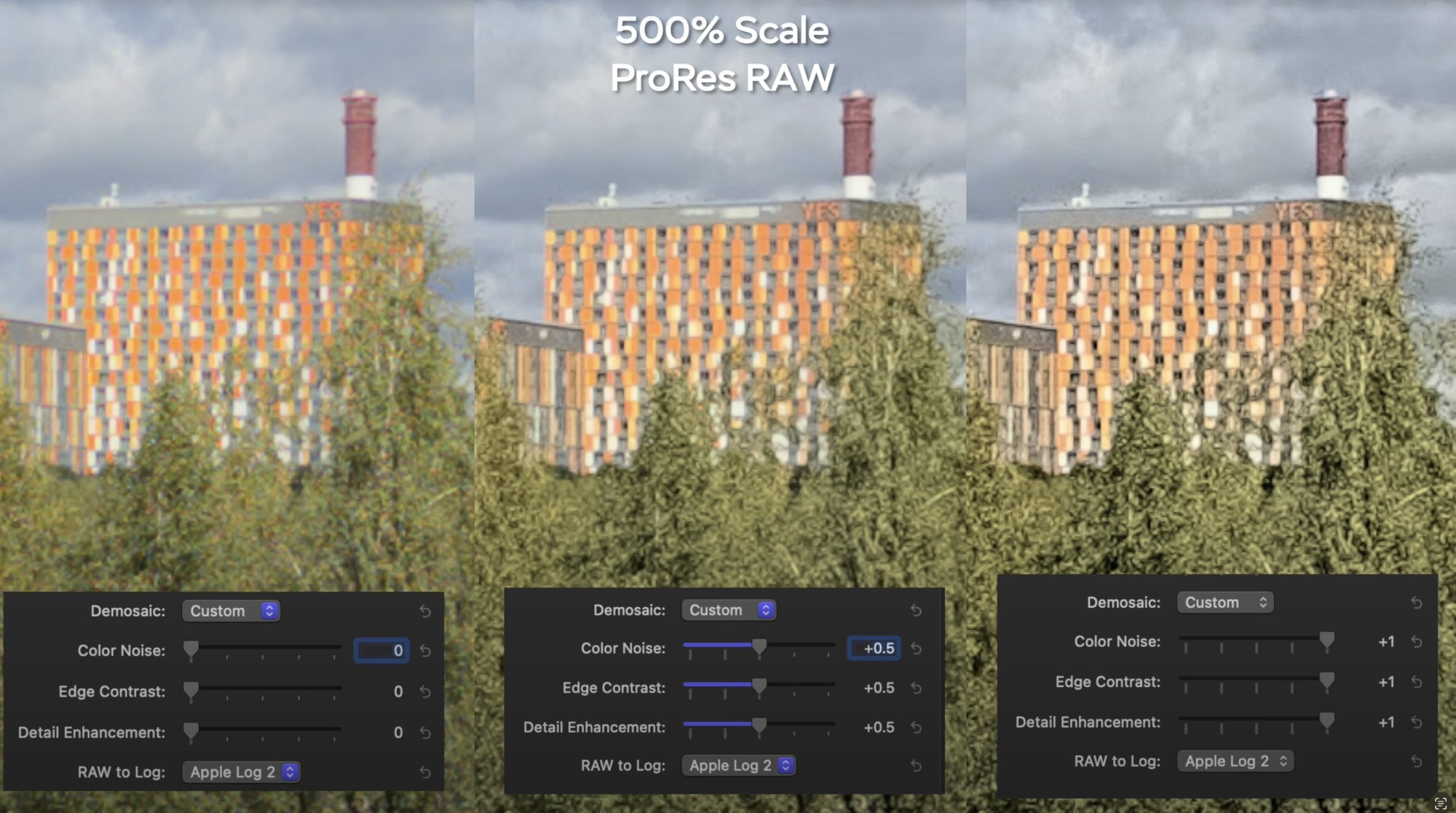

I guess no amount of computational trickery or sensor sensitivity can compensate for just letting in more darn light in the first place :)

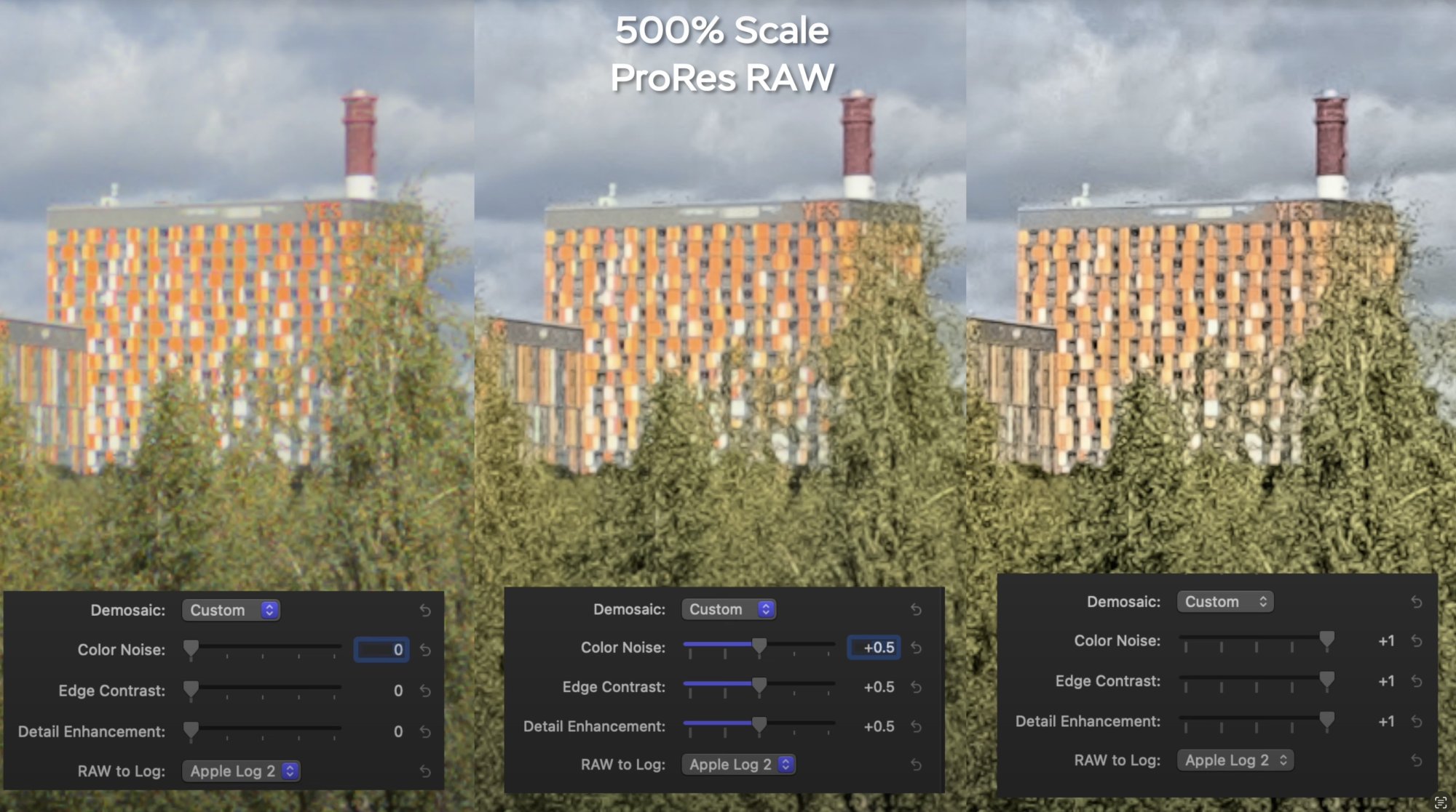

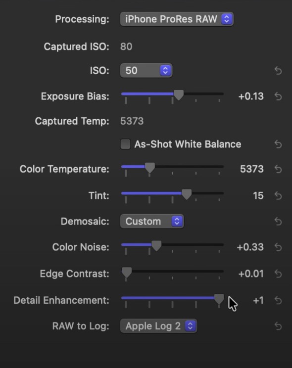

This is what ProRAW for Photos could've been.​
Instead they've added these attributes to ProRes RAW for Videos... Source
If Apple wants to call this format "ProRAW" they need to do a couple of changes:
  • Completely remove all denoise algorithms. Removing noise by stacking/merging is ok but don't apply any denoise algorithms that remove detail from the images. Let the end user denoise it in post processing to their own liking
  • Don't perform any artificial sharpening on the image data (it looks particularly bad after the heavy denoising)
  • Don't perform demosaicing - let the user do this in post processing as there are many better methods for this than the one Apple is using

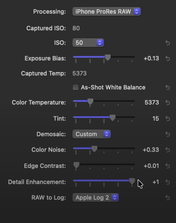

I've done some further investigation / detective work:
It appears that the issue resolution is not, as I suggested above, as simple as decreasing the shutter speed. I took some photos outside in bright light, of the scene I had already posted earlier in the thread to demonstrate the blurriness, and as you can see, there's no 100% correlation between shutter speed and clarity.
What their IS a correlation between, is the phone using its native ISO of 16 and/or 40, and clarity. Annoyingly, even when using an app like ProCamera to force a certain ISO, the phone will just arbitrarily decide to ignore that and use an alternative ISO it favours.
For example :
17 Pro 4x Telephoto 48MP ProRaw 1:1 @ Auto Exposure (shutter speed auto-set to 1/950th sec, ISO auto-set to 16)
17 Pro 4x Telephoto 48MP ProRaw 1:1 @ Manual Exposure (shutter speed manually set to 1/390th sec, the phone arbitrarily decided to take the photo at ISO 50 despite the slower shutter)
The top image is very sharp; the bottom image, where the only differences were me changing the shutter speed and the phone deciding to use a different ISO, is a blurry mess. It's definitely not because of any motion - 1/390th of a second is more than fast enough to ensure a clear shot, even without OIS factored in.
There's obviously something serious funky going on in the ISO selection and/or processing logic behind the scenes - and with the phone seemingly deciding to just ignore manually set ISO's and just picking what it feels best, I have no idea how to ensure you're going to take a clear picture... other than perhaps taking 2-3 pics at differing exposures and hoping for the best.

That's weird. In my samples, both images had an ISO of 80 with a shutter speed of about 1/2200 (for the 15PM) vs. 1/2400 for the 17Pro, with the 17Pro turning out to be smudgy and having that yellow tint. I guess they really need to work on that imaging pipeline.

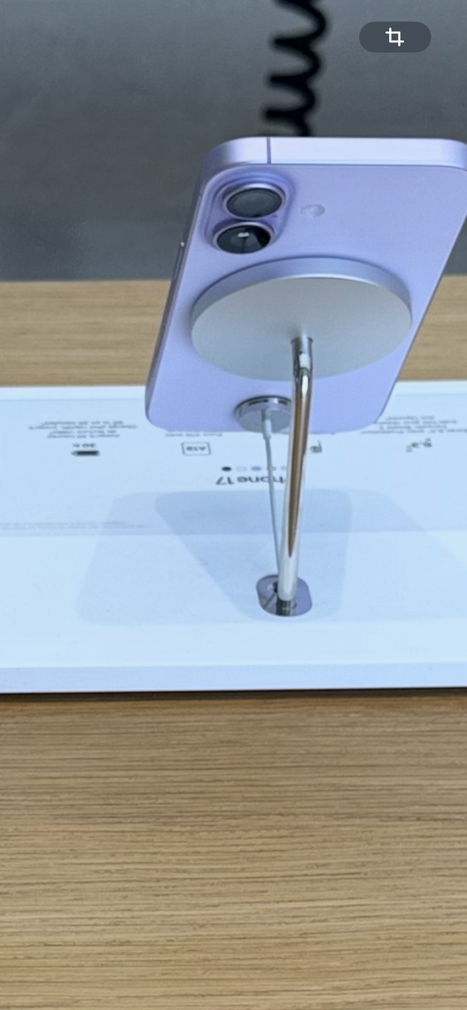

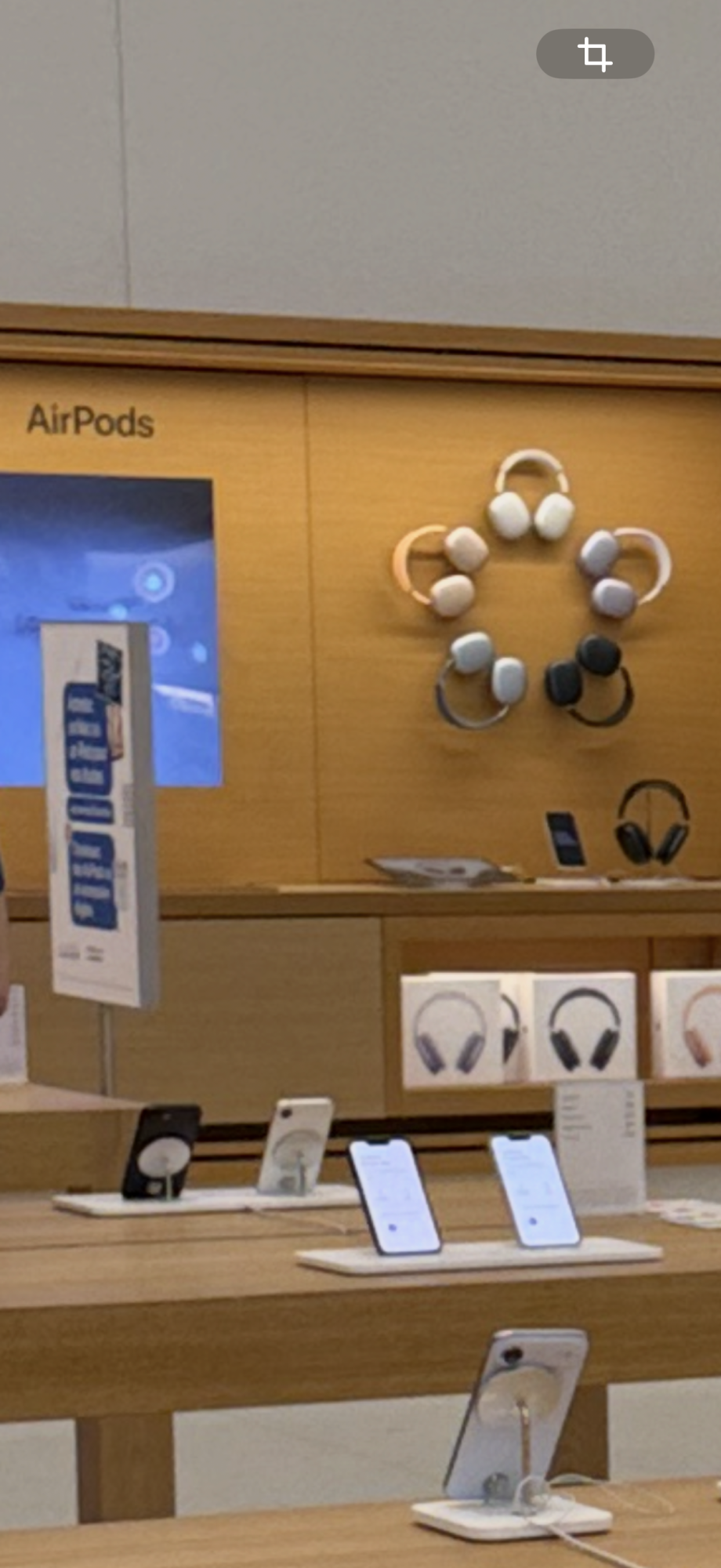

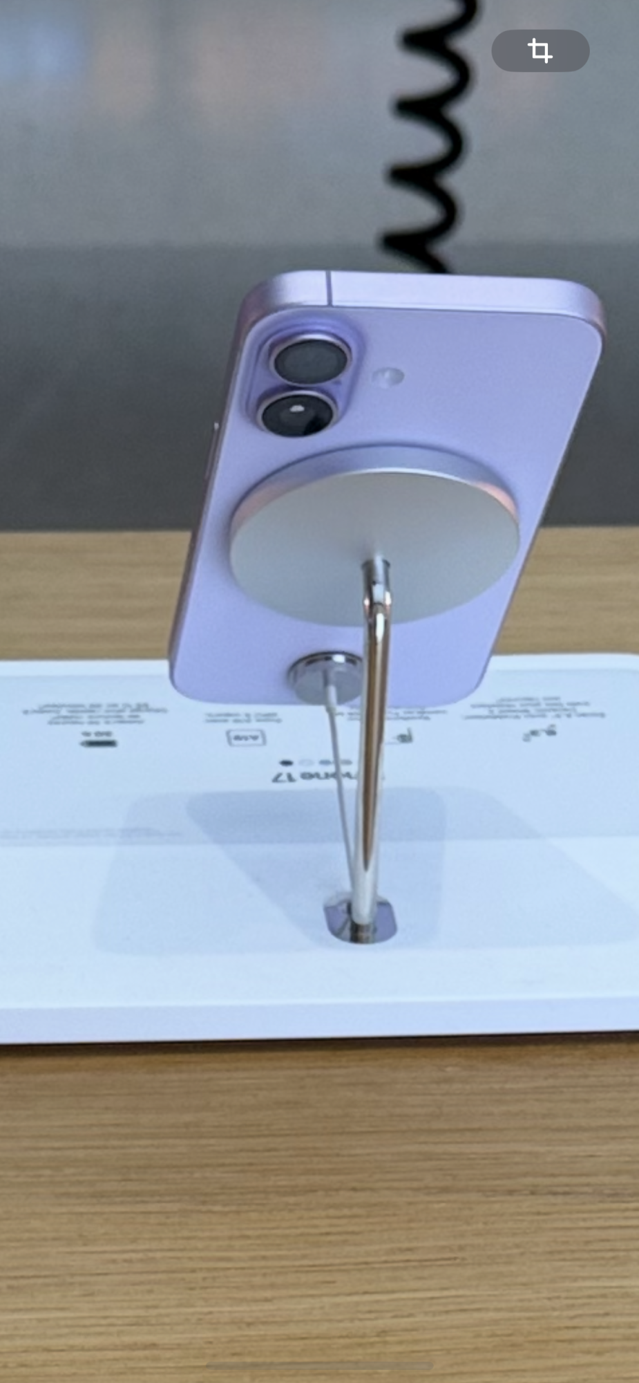

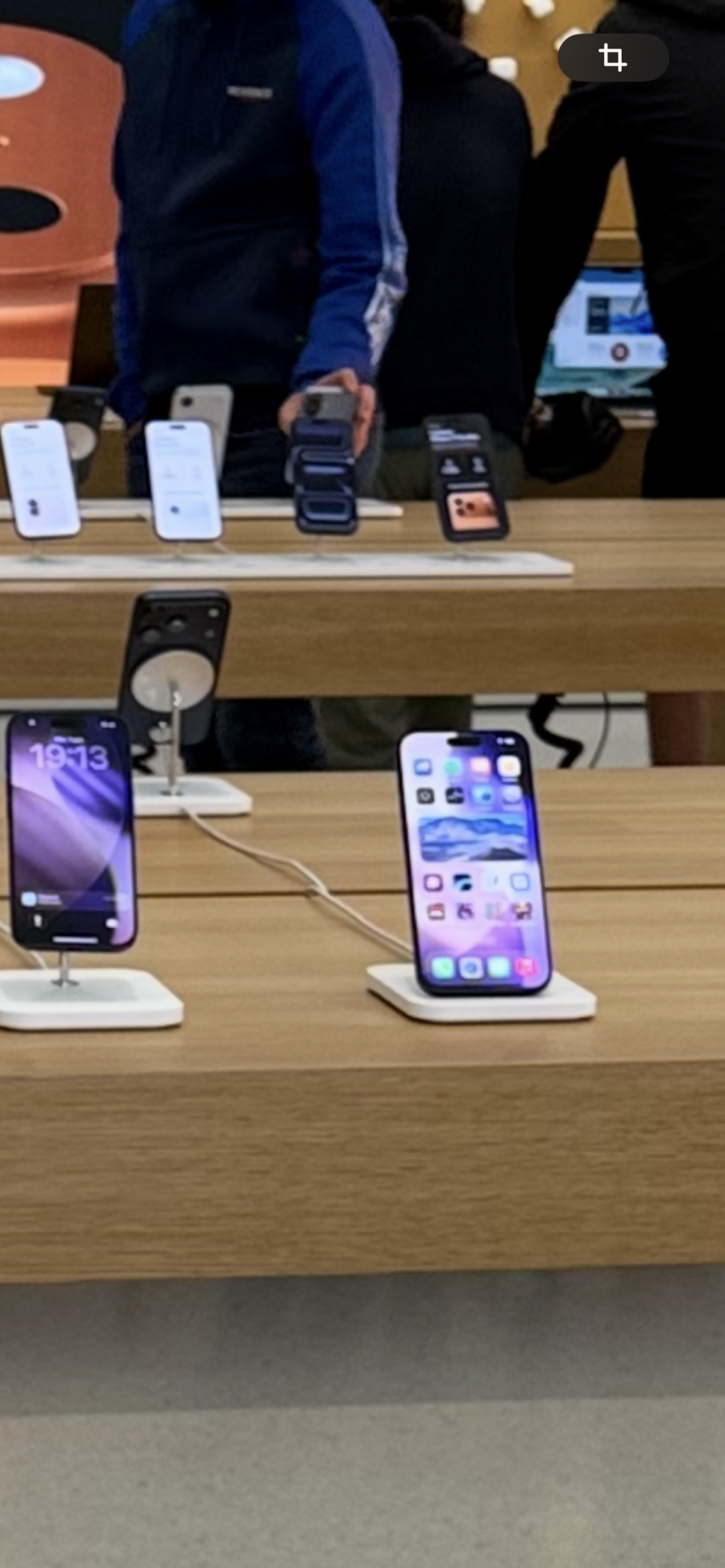

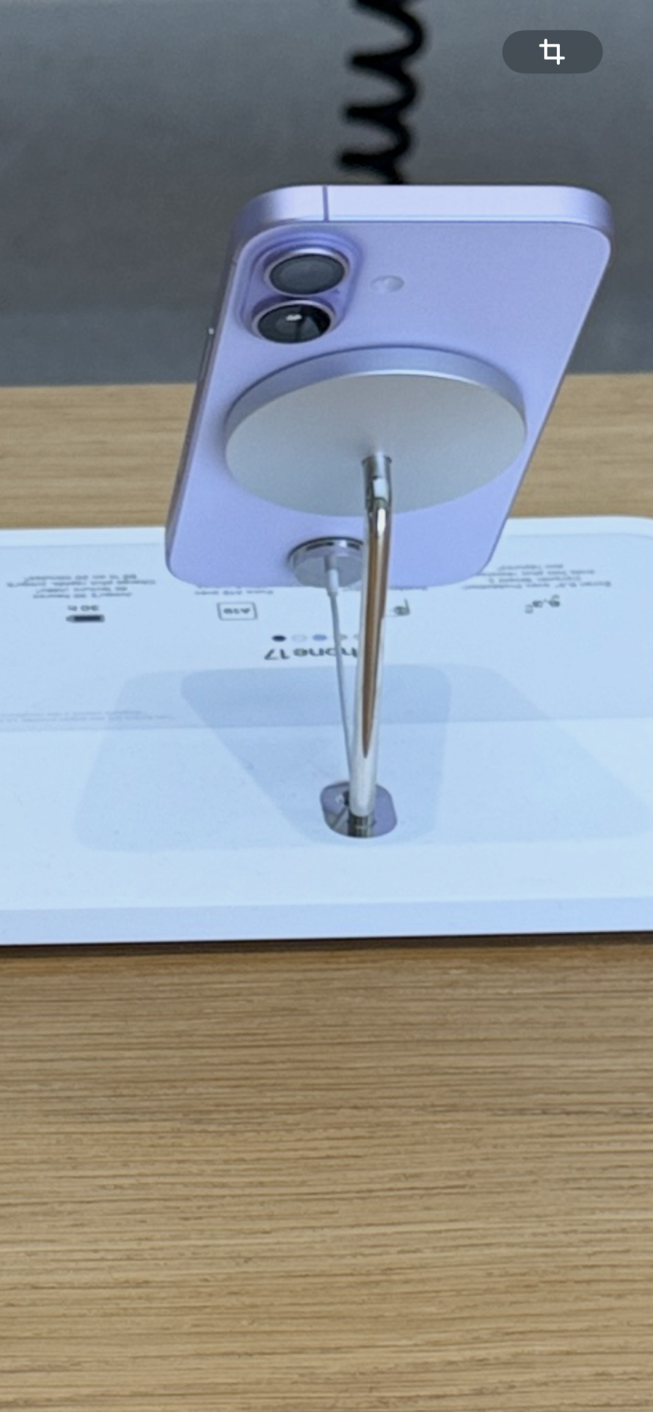

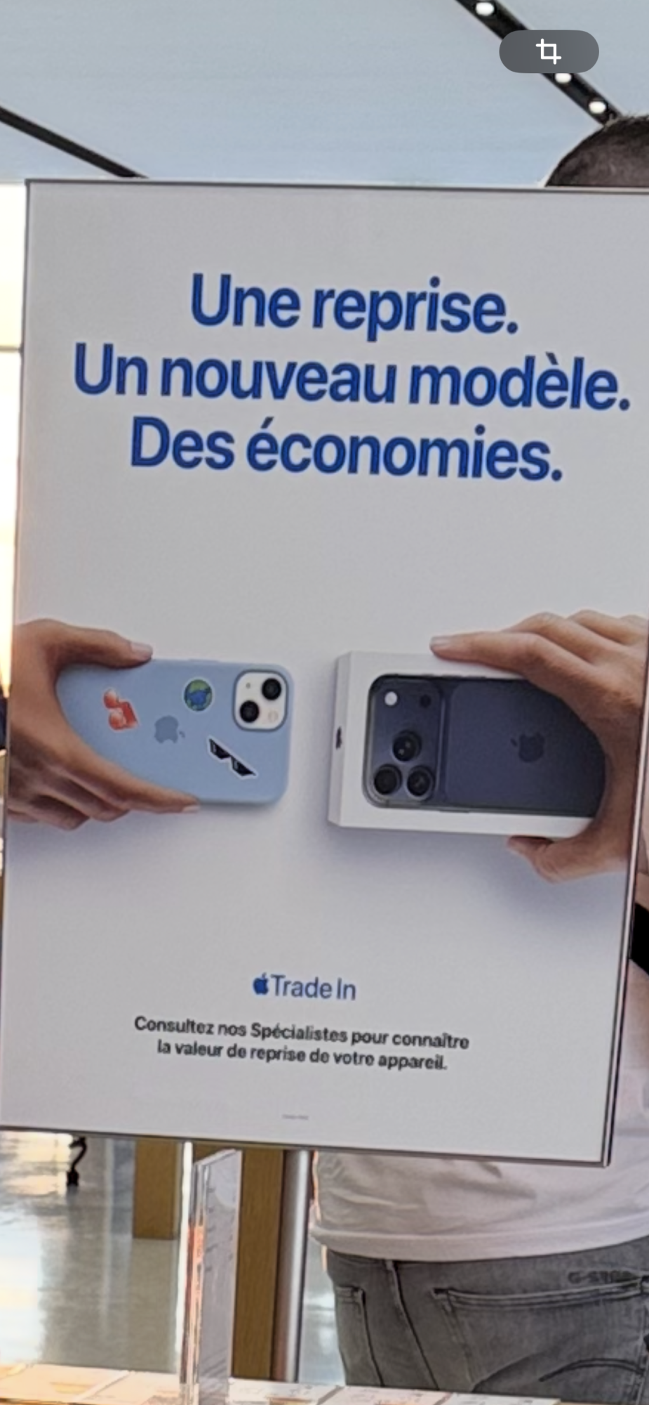

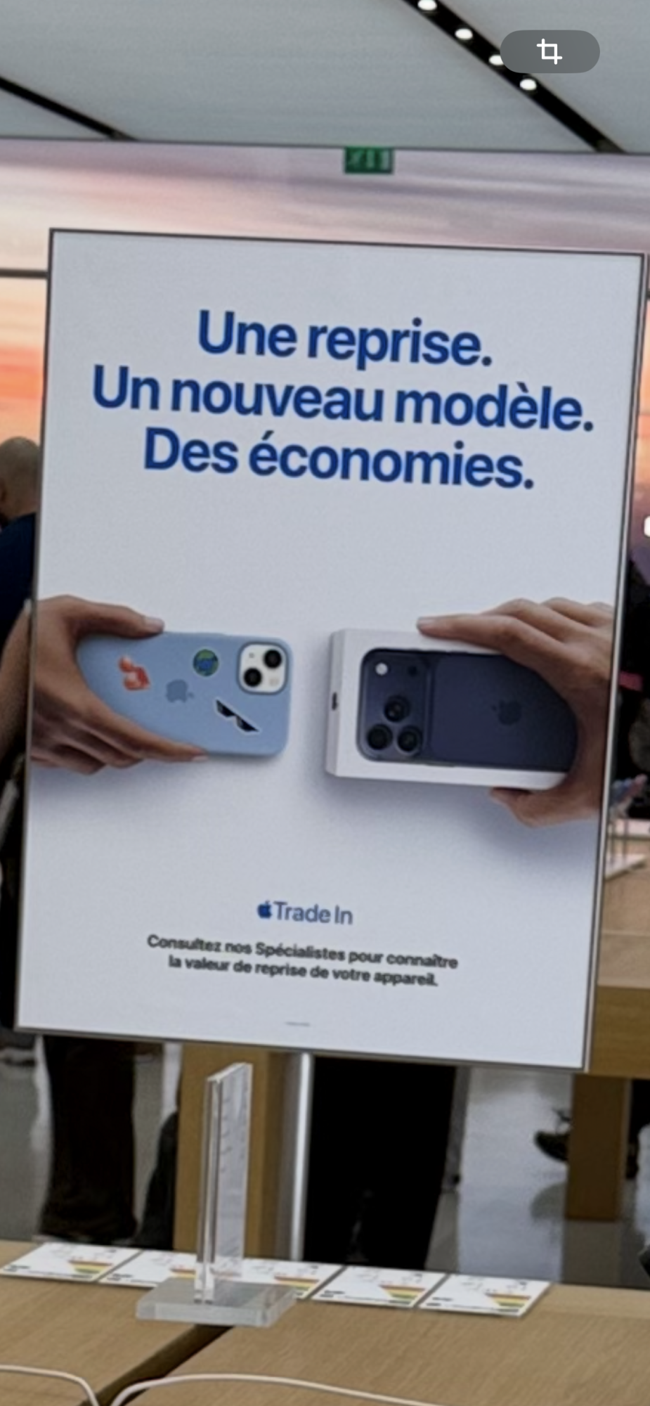

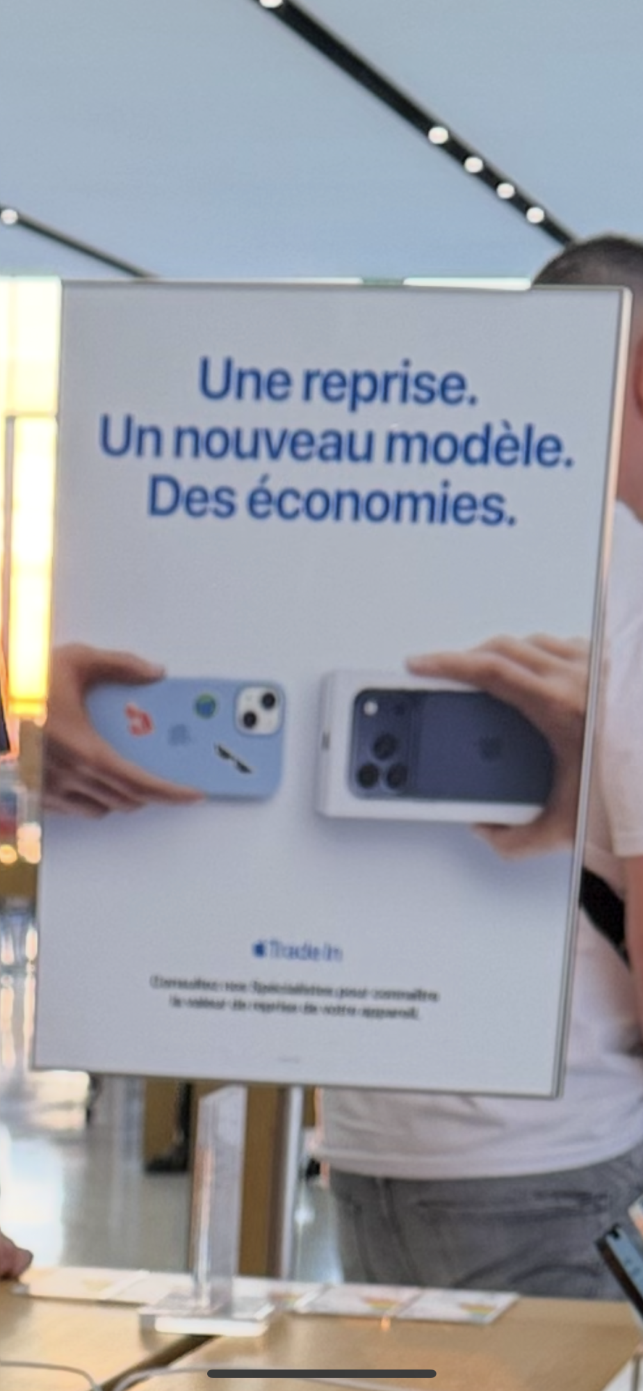

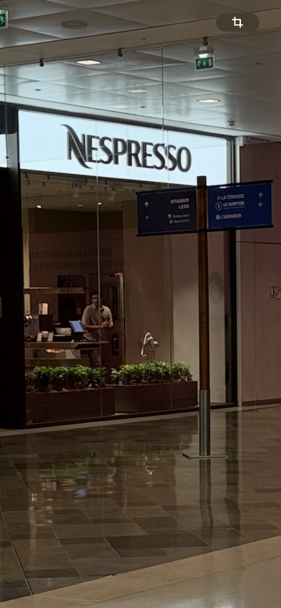

I really need your help guys. I got 1 last day to decide whether I have to return my 17 pro, and I can't make up my mind. i took a lot of pictures in an apple store. the first pic is MY unit, second one is the store. same pattern for every picture .
(1st is mine, 2nd is store, 3rd is mine, fourth is store, etc etc)
could you help me figure it out please ?
it seems both have issues with blur and focus, be it heic or raw, but mine seems to be more frequent? idk it doesnt make sense to me
@ToddH and @BlackrazorNZ what do you think ? i inserted a lot of pictures from the exact same angle just to be sure and concistent

it's weird because on occasions the 17 pro from the store would be blurrier than mine, but it seems to happen 1/7 shots, whereas usually mine was blurrier in 6/7 shots . and in some cases it's not really visible
im pulling my hair off with this thing

I feel like the difference between 2646 and 2647 would be enough for me to consider returning the device. 2646 is your phone and 2647 is the store model?
My 17 Pro Max is softer in some areas but not out of focus, those paired photos seem like it's a focus issue
as you can see it does happen with the one from store, just MUCH more rarely (as i said in 80/90% of the cases, mine comes out blurrier). for example here, the blurry one below is store's , sharper is mine . it's so odd.
yes that is correct , 2646 is mine, 2647 is store
also in some shots it's unvisible (like the one with airpods max on the wall, i can't see a difference)

Personally, I wouldn't regard the difference between the two photo sets as statistically significant.
If it was a hardware fault (which is the only thing that trying a different version of the same phone would verify), it would be consistently bad, not sporadically bad. And using the examples of mine further up, you wouldn't be able to 'fix' it just by taking photos at slightly different settings - hardware would infer a fault with the lens or the sensor, and either of those would cause replicable, reliable issues, rather than occasional ones.
My gut says it's a software issue and therefore it won't really matter which physical phone you purchase - it will need to be resolved through software.
It seems nearly concistent no? In 90% of the cases it's blurrier on unit A and clear on B
In 10% of the cases it's blurrier on unit B
I've read your post and it's definitely intersting but in MY case I think there might be both a software and hardware issue , seeing how bad most pictures look
