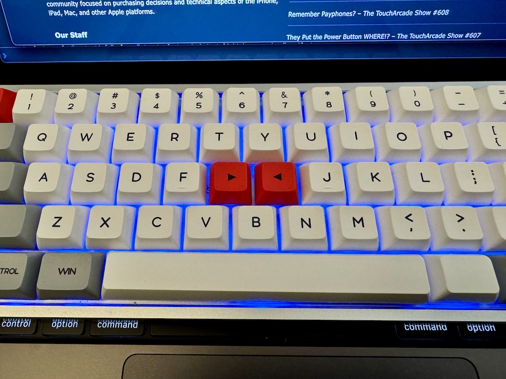

Hmmm. While that's a solution, I wouldn't be satisfied with random arrow keycaps here and there. Finding high quality XDA or DSA profile keycaps, however, could present its own challenges as most of the high-quality vendors produce mostly Cherry profile. I have a couple of very high quality KAM sets (uniform like XDA and DSA) but those aren't any lower in profile than Cherry keycaps, so probably not well suited to low-profile keyboards, either.
Fortunately for me, the key that was my problem was the G key so all I just had to give it a friend to avoid the two-tone junkyard car look.

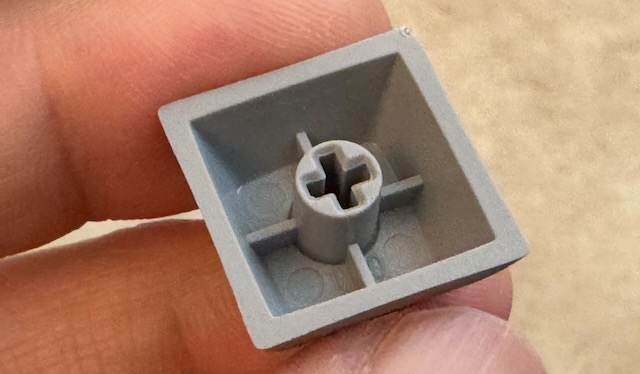

Hey, I think I just figured out why my Cherry caps and my XDAs worked. Both of those sets are thicker than typical and they have a crosshatch brace on the underside. The distance between the crosshatch and the bottom of the key is 4mm which is the total amount of travel possible in the low profile Jades.
I think that crosshatch is stopping the keycap from seating in too deep in because the low profile Jades have that circle mount stem instead of just a standard MX style stem. When I try regular OEM profile keys, they do indeed slam into the plate mount. The impact actually causes the caps to wiggle loose.
I think that crosshatch is stopping the keycap from seating in too deep in because the low profile Jades have that circle mount stem instead of just a standard MX style stem. When I try normal OEM keys, they do indeed slam into the plate mount. The impact actually causes the caps to wiggle loose.
That certainly makes sense. Looking at a couple of random Cherry profile keycaps here, I can see that some have a similar cross-pattern but not quite as thick/tall as yours appears. What brand are those?
I presume they're Epomaker caps as they came with my Skyloong SK68 (aka Epomaker GK68).
Unfortunately, it doesn't appear like they have any of those keycaps or that keyboard anymore, but I did see a 61 key variant going for ridiculously low overstock prices a few months ago. Every board in this family of keyboards seems to have the same XDA caps.
