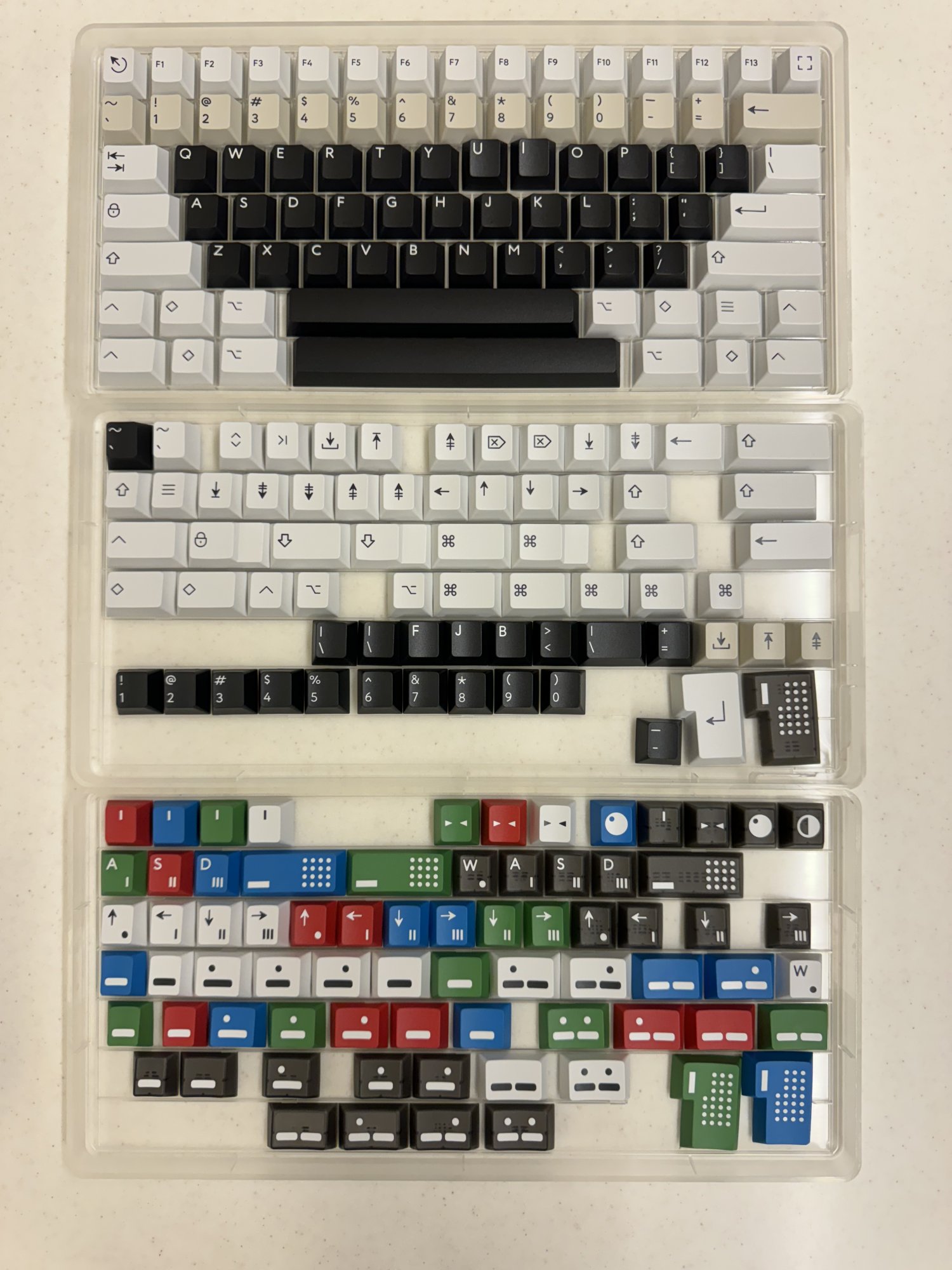

I have PBTfans sets as well, such as this Resonance R2 set that has all sorts of 1U novelties, on top of the aforementioned 1U keys. This particular set have Mac mods, ISO enter, but the UK and Europe specific alpha keys are extras that I didn't buy. The set is just lovely, great quality PBT material, fun semi-translucent novelties, really full kitting.
But honestly sets at this price range probably shouldn't be put into a Keychron let alone a K4 lol. But yeah key sets with great kitting option exists, they just generally are very costly.
