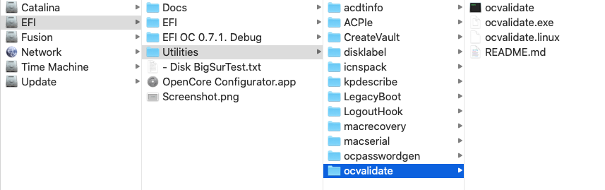

Location of OpenCore Utility files on my system. Note that the EFI OC 0.7.1 Debug folder is not required, just used by me for handy storage of unmodified OpenCore files in the EFI Volume.
Copy EFI/Utilities/ocvalidate to your home folder, shown in Finder with a house icon.
(After the validation, you can delete ocvalidate.)
In Terminal, enter:
xattr -c ocvalidate && ./ocvalidate config.plist
You should see "Completed validating config.plist in x ms. No issues found.". If not recheck your edits.

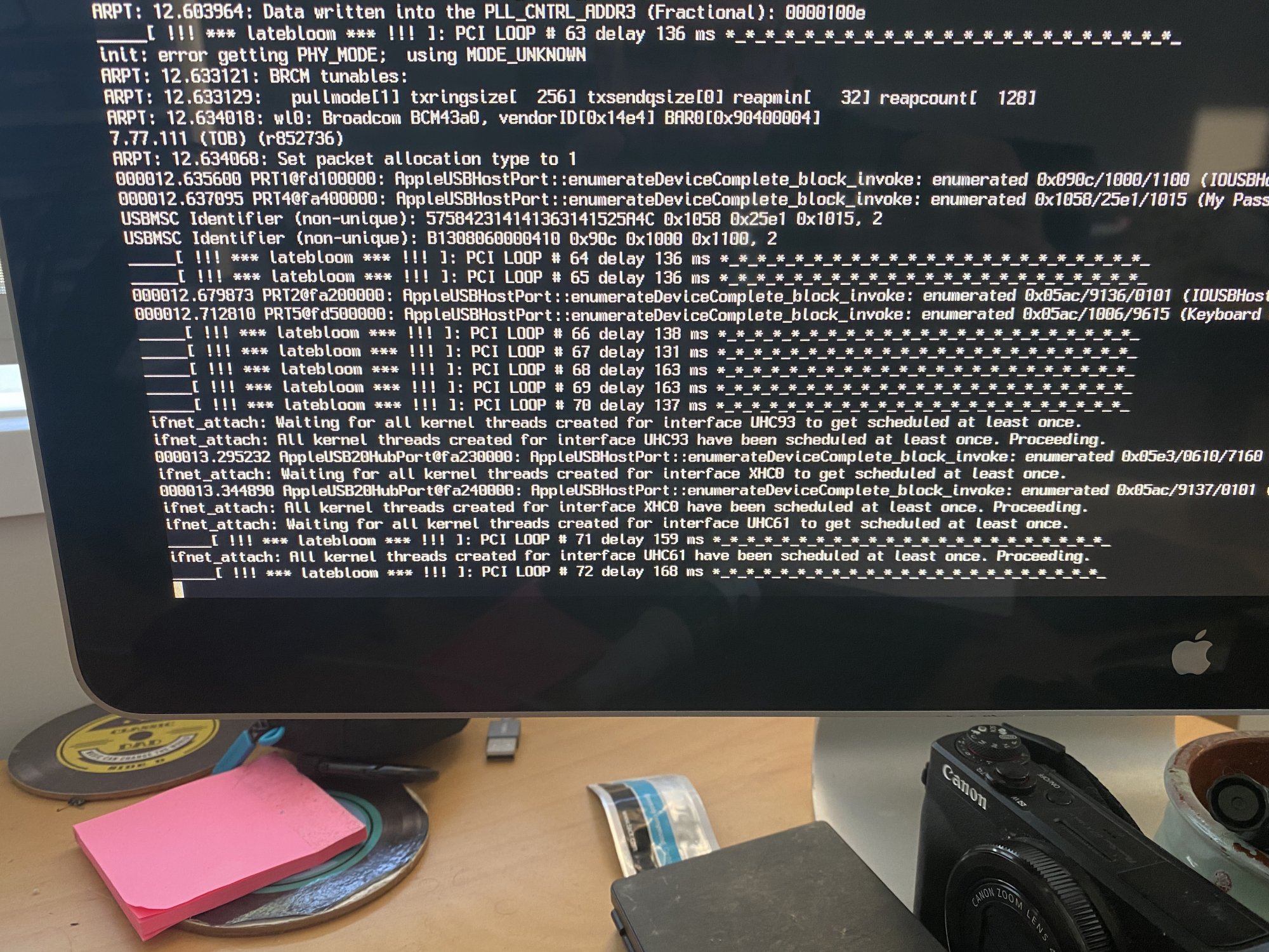

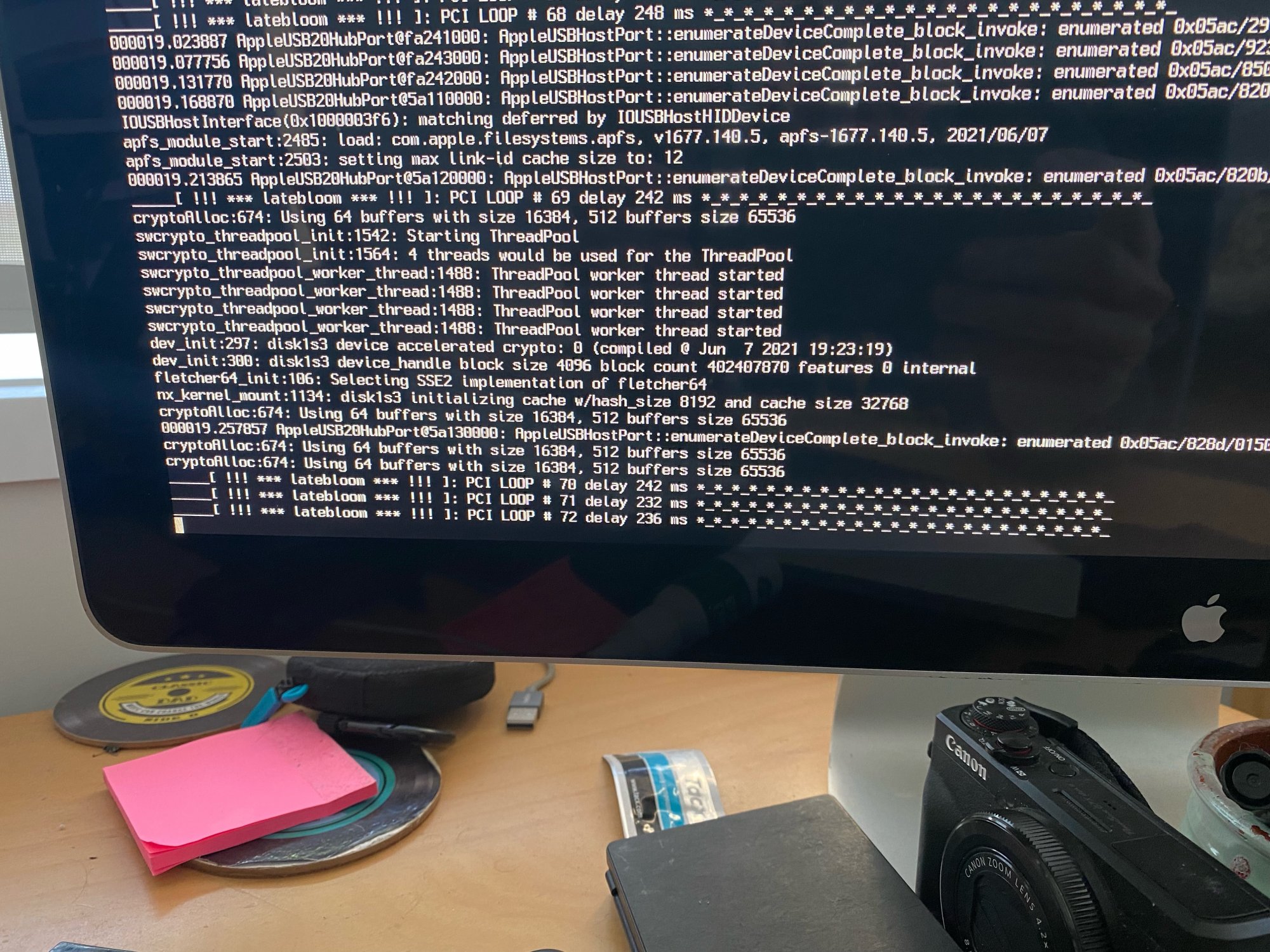

Having issues installing the new 11.5 RC build just like last time. Latebloom is injected but multiple boot hangs. Will try one more time and then wait until my enclosure comes tomorrow (or at least try to).
Remember to check your boot logs to ensure latebloom was able to hook on (ie. look for HOOK NOT PLACED, if present you have an issue)
I did. That didn't occur "HOOK NOT PLACED" code did not show up. Latebloom worked and was hooking everytime. I just updated to the latest RC luckily. I used my default 280/50/1 settings and go back into my desktop. I think downloaded the installer again and ran it. Before I did that, I reduced my numbers to 200/20/1 just to test since the first time I tried to install with my default numbers, it stalled and was rebooting. This time around it worked perfectly. Could be a bad download or who knows what happened. But I'll do a few reboots and see how it is working.
EDIT: So I just did a few reboots. 8 warm and 8 cold boots. I have 7/8 for warm boots and 8/8 cold boots. However, I had to keep my values at 200/20/1.
@Syncretic, I'm not sure at this point if you want to edit the front page for my stats. The delay numbers can change from update to update. For example, I had 220/20/1 to upgrade to 11.4 from 11.2.3. That number would not work to upgrade to 11.5 RC1. So I was at 280/50/1 which allowed me to upgrade 11.4 to 11.5RC1. When I tried to upgrade to 11.5RC2, that number wouldn't work during the install. I ended up reducing to 200/20/1 and had immediate success. Curious if this would also be the case with Monterey.
Weird, but I'm wondering if the number delay will change with each update. Just because it works for one version, doesn't mean it'll be the same for a subsequent macOS update.

I have a 4,1 flashed to 5,1.
I have Martin Lo's 0.7.1 installed with added Latebloom the only change to the Config file. (on USB in rear factory USB SLOT)
I have the args set as 250/20/1 and -v
I have been using the OWC PCIE SSD as my main drive and was running 11.2.3. Backed it up to 2 other drives prior to starting. Installed revised amended Config with Kext added to kext folder set at 200/20/1 -v
I had no luck with everything installed (ie computer with all devices etc installed in it) getting the software update to install 11.4. Tried 3 times and it hung each time. Was difficult to see where at as my hangs give a blurred screen with the crossed out circle symbol
Removed all drives, PCIE's including USB and NVME. Tried again. Still hung.
Started from fresh again, downloaded the 11.3 installer. Ran that. Installed no issues. Did the same with 11.4 and 11.5 no issues (bar at 11.4 it seemed to loose Bluetooth but that came back with 11.5).
I hot and cold rebooted about 10-12 times an booted in no issues at all.
I started to add devices back in, all PCIE's including all USB's connected no issue.
Bay 4 sled added no issue with boot.
When I add any other drive it hangs at boot. Whatever the drive is, any of the sleds or the optical bay. Any single one additional causes it to hang. Remove that drive boots fine again. I have changed the config to down as low as 100/20/1 -v and upto 350/20/1 same hangs.
Configuration of my computer is:
4,1->5,1
Used 250/20, debug=1, -v
Running 11.5
2009 Mac Pro 4,1
Dual X5680
6 x 16gb 1333 ram (1-3) (5-7)
RX580 flashed 8g GPU PCIE Bay 1.
WIFI Factory
Bluetooth upgraded to 4.0
PCIE-
Slot 1- GPU
Slot 2- OWC Mercrury Electra 6G- 500GV SSD (11.5)
Slot 3- Sonnet USB3.0 4port
Slot 4- Sparktech dual NVME (port 1- BS11.2.3) Port 2(Windows 10)
Sled Bays
Bay 1 – 4tb Partitioned all Mac OS Journaled (1x Mojave) 1xStorage
Bay 2 – 4tb Partitioned all Mac OS Journaled (1x Catalina) 1xStorage
Bay 3 – 4tb Partitioned all Mac OS Journaled
Bay 4 – 4tb Partitioned all Mac OS Journaled (1x HS)(1xSIERRA) 1xStorage
Optical Drive Bay 6tb Partitioned Mac OS Journaled Storage 3tb balance (1x BS11.2.3) (1xBS11.2.0)(1xTime Machine Container)
Screens 3 x Apple 23” Cinema Displays.
Various USB’s and USB controllers with storage, Mojave Installer, BS Installer etc
