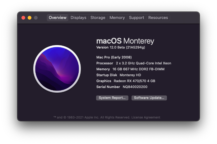

I have the same problem with Bluetooth, but only in Monterey! Have you tried Monterey? I do not know if it is because of Latebloom.

I have the BT 4.2 flavor of the Wifi/BT card, not sure if that’s part of it… most have the BT 4.0 here…
No, unless that is an issue in Monterey, that's not it. I have a BCM943602CDP Wi-Fi/Bluetooth module and it works just fine.

khronokernel
macrumors 6502
Sep 30, 2020
278
1,425
Alberta, Canada
Latebloom working nicely with macOS 12.0 Beta 4 (21A5294g):
