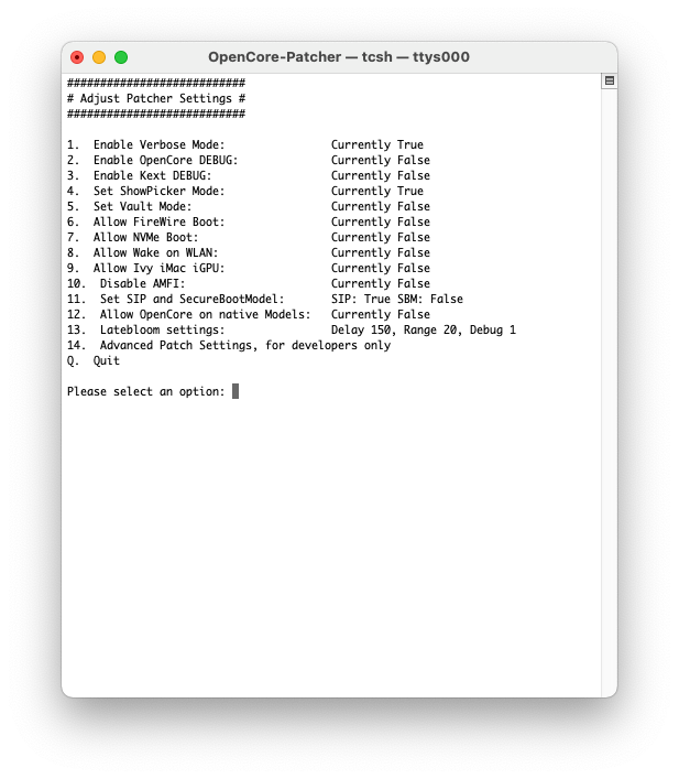

Is there a 'Latebloom for Dummies' post anywhere? Looking through this thread I see the basic concept is to either manually move the kext into place, or use the OpenCore Legacy Patcher to install it, and then to configure it for a specific delay until you find which delay works well for your configurations. However, I can't find a single post that really spells out the steps clearly.
The easiest way is to use OCLP 0.2.4 TUI (not supported in the GUI yet). You can adjust the Latebloom settings to what you want in the patcher settings and then install OCLP like normal.

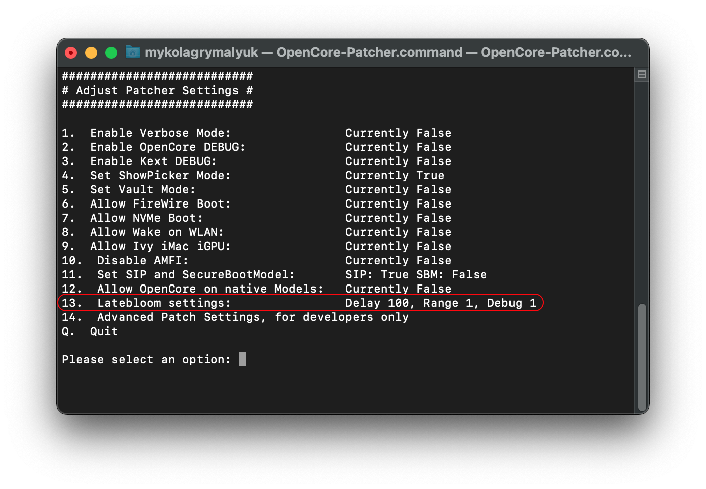

Not exactly, there's a couple posts here and there for general explanation but I can write one here regarding OCLP. Ofc I'm the co-author of OpenCore Legacy Patcher so there will be some self promotion ;p
Getting Started with Latebloom​
With OpenCore Legacy Patcher v0.2.4, the TUI Application (Text Based interface) gained Latebloom configuration support. Setup is quite simple for those already using OpenCore Legacy Patcher.
  • GUI (Graphical interface) and CLI (Command line) do also support Latebloom however precise configuration is not implemented. The GUI and CLI will check if latebloom arguments are present in NVRAM so users only need to use the TUI once and can continue using the GUI/CLI afterwards
If you're unfamiliar with OpenCore Legacy Patcher, we recommend checking both our guide and discord.
Configuring Latebloom​
Configuring Latebloom with the TUI is quite simple. Open the application and you'll be presented with the main menu. You'll want to head to Patcher Settings and you should see Latebloom settings:
Once you select that entry, you'll be presented with all the possible configuration settings:

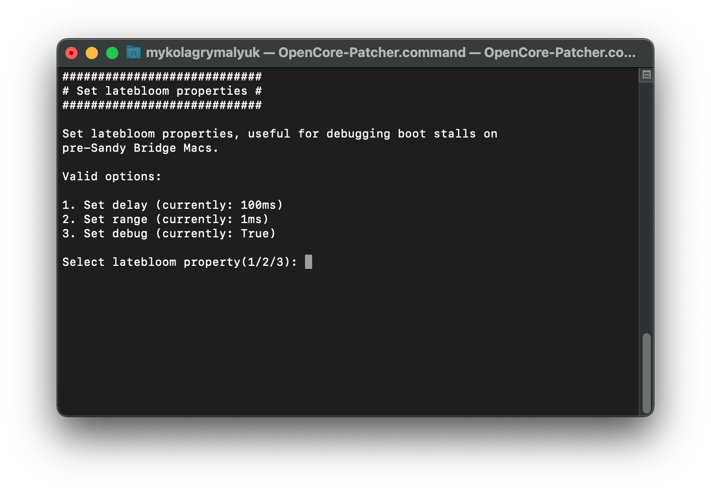

Latebloom Configuration Settings​
The settings are pretty basic and straight forward:
  • Delay​
    • This property, in milliseconds (ms), sets the delay per configuration loop during boot up.
  • Range​
    • This property, in milliseconds (ms), sets the range that latebloom's delay can deviate between per configuration loop.
  • Debug​
    • This property sets the debug level of Latebloom, at the time of writing only 0 (no debug) and 1 (debug) are supported.
Recommend users also check the first post of this thread for further clarification on Latebloom settings.
Recommended Defaults​
By default, OpenCore Legacy patcher will assume all pre-Sandy Bridge Macs should use a delay of 100ms, range of 1ms and debug enabled (1). However for certain models that commonly have issues, we increase the delay to 250ms.
  • These models are MacPro4,1, MacPro5,1, iMac7,1 and iMac8,1
Note that each user's machine may need different values, generally a good rule of thumb is the more devices present the higher the delay should be. Also slower machines may also need higher delay like the iMac7,1 and iMac8,1 series.
Additionally many users have also contributed their testing on the second post of this thread to better aid users what values are more common with certain hardware and hardware configurations.

Once this is done, head to Install OpenCore to USB/internal drive and install OpenCore to your desired disk. Reboot, test and if issues persist, continue adjusting and post back here with your finalized results.
Post #256 is also a good overview.

I'm now successfully using OpenCore Legacy Patcher on a variety of Mac models without issue. I do have approx. 20 close to identical 4,1 ->5,1 MacPros to roll out, and if I can get Latebloom working reliably it would make sense to do so now, rather than trying to patch and update these machines later. They work great with 11.2.3, but obviously it would be great to be able to have a uniform OS revision across all machines.
Look at page 11 of the thread for the Guide To Installing Latebloom Post # 256. If you feel there I something that should be added or changed please let me know.
I was going to beat myself up for not realizing that was there, then I noticed that revision was only released 3 hours ago, so I let myself off the hook! Thank you!.
It's unclear if 0.2.4 implements and allows you to configure Latebloom, or if it simply allows you to configure Latebloom if you have added the kext yourself.
EDIT: and while I typed that, another reply has answered the question. Thank you!
