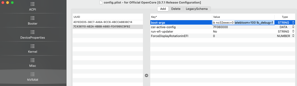

I'd grab a fresh config.plist from 0.7.1, It wouldn't let me attach mine, but its not much different then stock with the latebloom line.

Just talking about missing the NVRAM section to add the boot args. Grabbing a new config and latest version of OC Configurator should surely fix that. I wouldn't want to accidentally make a typo in that file. :D

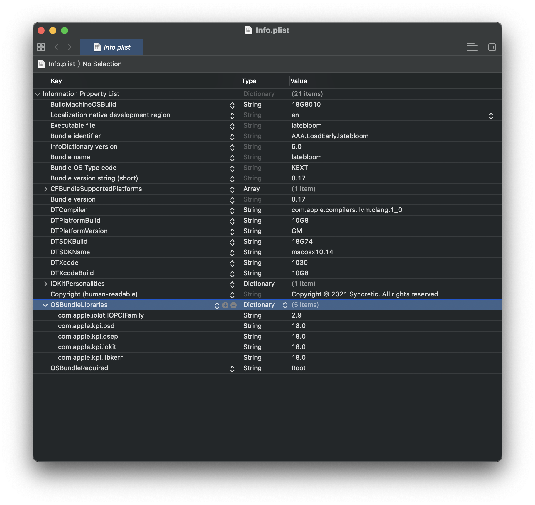

latebloom has no other dependancies in your EFI so could be the first, last or anywhere in between. An easy way to tell is by looking at the OSBundleLibraries to better see if any kexts in your EFI are needed. As you see below, all the kexts latebloom needs is within macOS. The info.plist is located under latebloom.kext/Contents/Info.plist

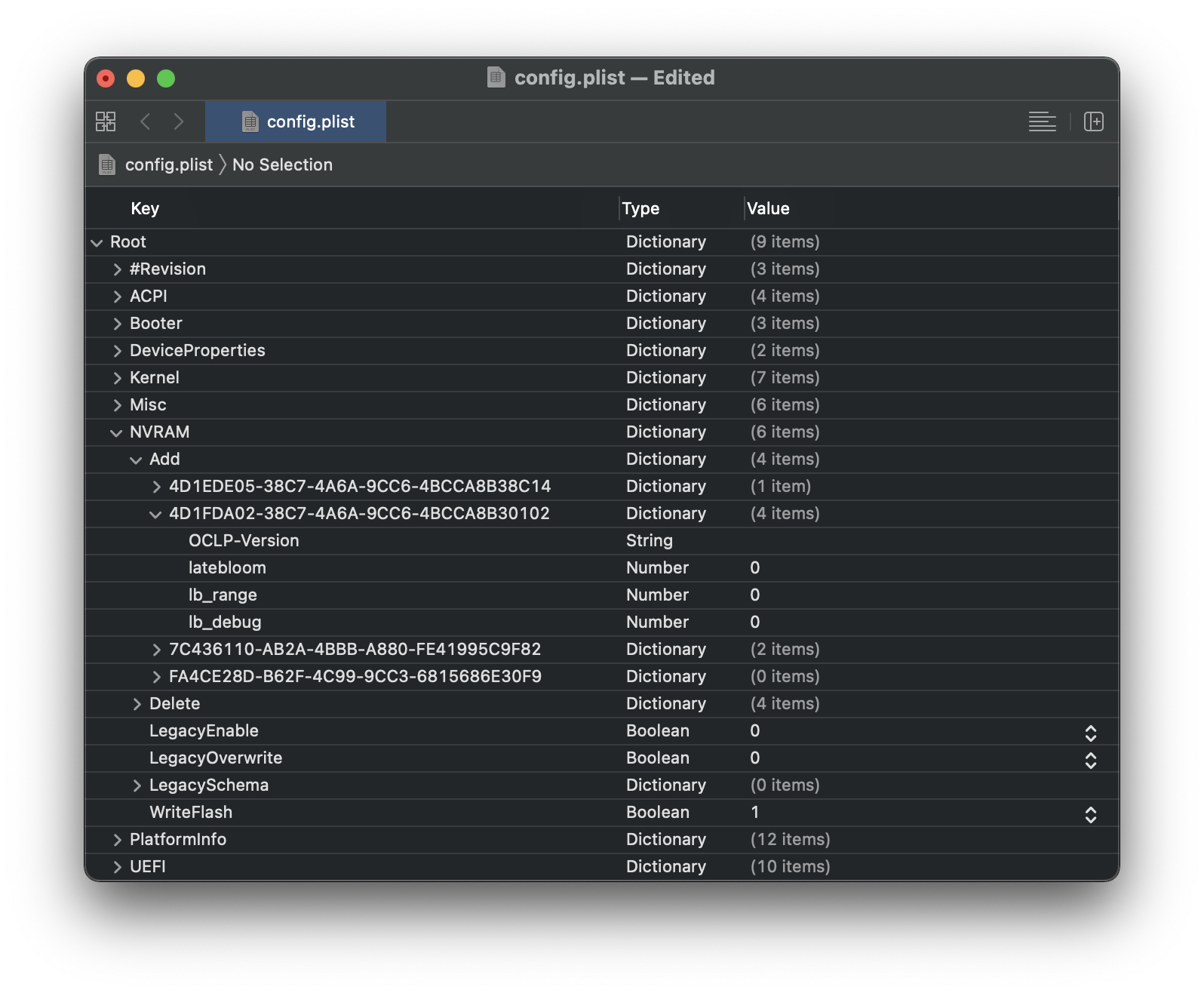

@Syncretic Have a small suggestion for latebloom, specifically the idea of defining arguments as stand alone variables in NVRAM instead of just boot-args. Idea is that the user won't clutter their boot-args as much, similar to how RtcMemoryFixup allows you to set the RTC Blacklist either with the boot-arg rtcfx_exclude=xxx or with the stand alone variable rtc-blacklist
For reference, the Lilu/OpenCore GUID is 4D1FDA02-38C7-4A6A-9CC6-4BCCA8B30102 however we use it for OCLP to set the patcher version and could be used by latebloom as well. Would recommend not using 7C436110-AB2A-4BBB-A880-FE41995C9F82 as that's Apple's Boot Variable GUID which Apple may be used to store undocumented variables potentially matching yours.
