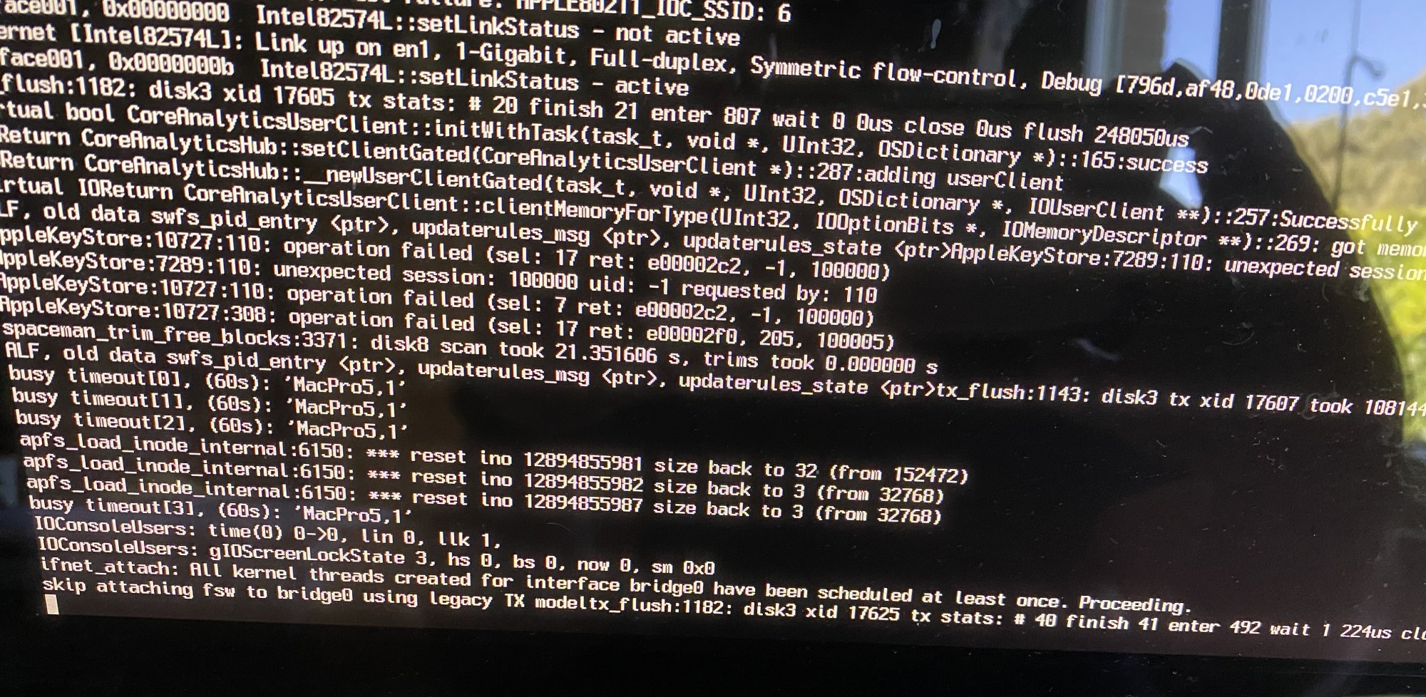

Sorry not have positive things to report after six attempts to boot Big Sur 11.4 through latebloom. Verbose mode tells me latebloom seems to do what it's supposed to do (using delays of 100 and 270 ms, and a random additive delay of +/- 20 ms, but the boot process has ended up crashing several MINUTES later every time.
Perhaps my Mac Pro 5,1 is not the best testing ground for latebloom. Before latebloom, I only got my Mac to boot one time out of roughly 30! It doesn't have any NVMe blades or SSD disks, just four regular hard disk drives (one of them moderately fast, at 7200 rpm). It also has a Titan-Ridge Thunderbolt 3 PCI card and an updated Wi-Fi/Bluetooth module. It has a 6-core X5765 processor running at 3.07 GHz.
Any suggestions?

More challenging systems are an important part of these tests; they'll help establish the limitations of this method, and possibly provide clues to a better solution.
Your picture appears to show a common hang point, but that photo doesn't show any signs of latebloom. Did you definitely see the words _____[ !!! *** latebloom *** !!! ]: Hook placed successfully. Count = 0 prior to this? Latebloom doesn't actually prevent hangs, but because the delays typically have at least some effect, it's unusual to see a hang exactly where it would have hung without latebloom. I suggest verifying that latebloom is definitely loaded and the hook is successfully set, because it looks like perhaps it's not. (As I noted in an earlier post, my own method involves recording the boot screen in slow motion on my iPhone, then scrolling through it slowly. Crude, but effective.)

It's possible to confuse a sequence of delays with a hang. Use lb_debug=1 to see where the delays are being inserted.
Yes, I definitely saw several loops (over 30, if I remember correctly) of latebloom adding hundreds of milliseconds. I've repeated the process with a delay of 1000+/-20 ms. Same result, and the hang occurred at exactly the same point. Perhaps if I were to set the delay to something like 10000 ms it would eventually boot, but the process doesn't look promising on my hardware. After all, not using latebloom got me to the 11.4 desktop once after 30 tries! If you have any suggestions as to values I might attempt next, I'll try to comply, but it seems I'm running out of options.
Yes, I had already set that. I interpreted the boot process had hung after 5 minutes of inactivity in verbose mode.

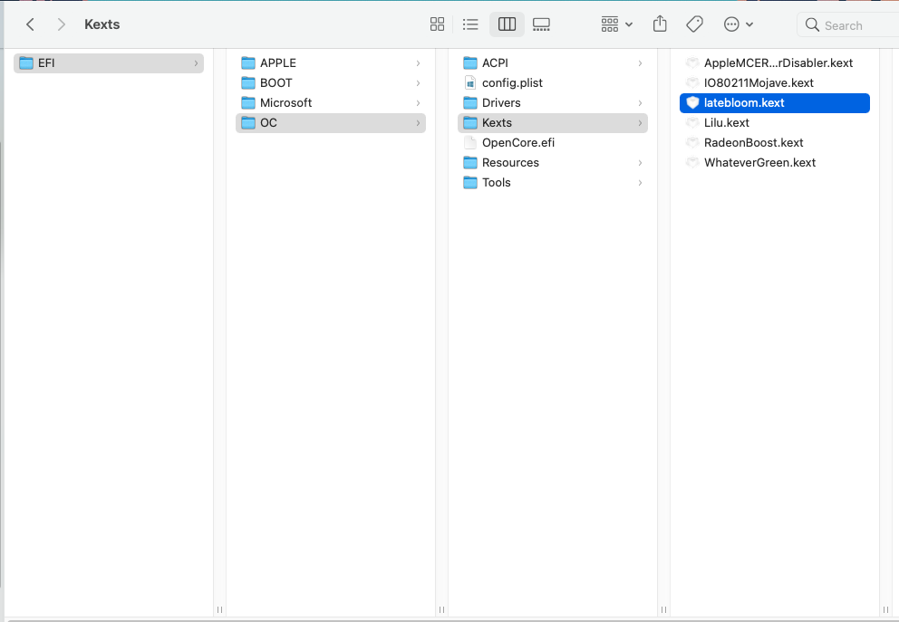

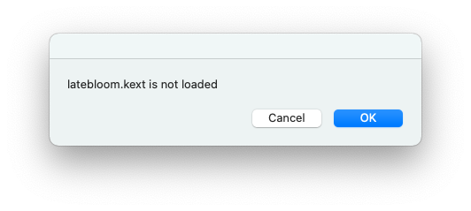

For the life of me, I cannot get this to work. I don't understand what I'm doing wrong, but I must be missing something, despite reading this thread over and over again.
Here's what I've done.
  1. Added the kext file to the EFI > OC > Kexts folder

  5. I used the previously mentioned script to check if the kext was loaded, but it says it isn't.
What am I doing wrong here?

I totally forgot to add the kext entry into the plist file when I started over.
I added the entry by using the script created by @startergo on post: https://forums.macrumors.com/thread...on.2303986/page-2?post=30090448#post-30090448
This solved it for me.
  1. Added the kext file to the EFI > OC > Kexts folderView attachment 1805642
