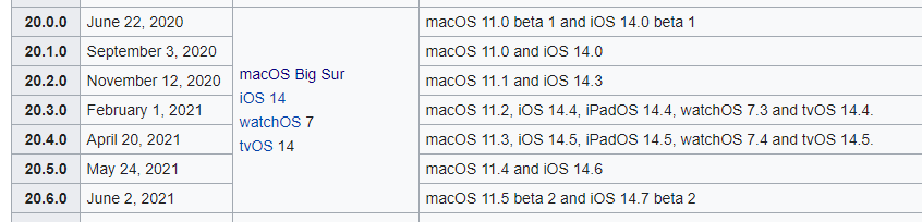

@Syncretic ... Perhaps I am mis-interpreting the MinKernel setting but shouldn't the value actually be MinKernel 20.2.4 (Mac OS 11.2.4 and above - in reality Mac OS 11.3.0 plus ... Can also be MinKernel 20.3.0 to be safer) as opposed to MinKernel 20.4.0 (Mac OS 11.4.0 and above) which actually excludes Mac OS 11.3?
If I am correct, this might explain some of the odd results as LB is actually not injected for those testing 11.3.
@Syncretic ... Perhaps I am mis-interpreting the MinKernel setting but shouldn't the value actually be MinKernel 20.2.4 (Mac OS 11.2.4 and above - in reality Mac OS 11.3.0 plus ... Can also be MinKernel 20.3.0 to be safer) as opposed to MinKernel 20.4.0 (Mac OS 11.2.4 and above) which actually excludes Mac OS 11.3?
(on mobile, can't verify right now) My recollection is that Darwin 20.3.x was MacOS 11.2.* and Darwin 20.4.0 appeared with MacOS 11.3. I'm fairly certain I checked that on my own 11.3 installation. (I am, as always, also prepared to be proven wrong.)
Reactions: HuRR
I think you might be right. I am currently on 11.4 and performing a uname -a reports,
Code:
20.5.0 Darwin Kernel Version 20.5.0:
I would assume that 11.3 was 20.4.0.
Reactions: Dayo
Makes sense then. Just somehow worked on the basis of the "x" in Darwin x.y.z being essentially "VersionMacOS" + 9 with the rest being the same values but likely to be wrong as hazy about where that came from.

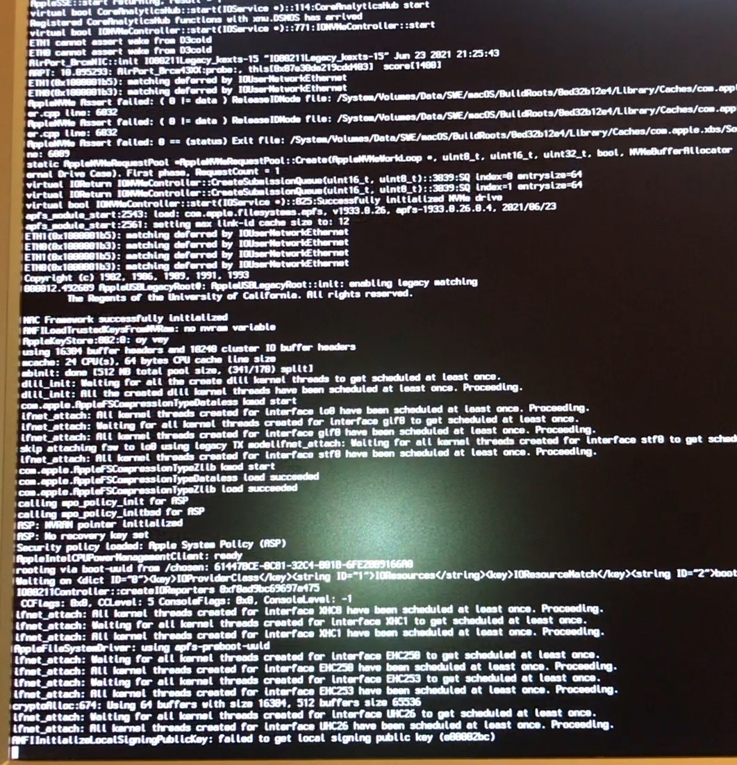

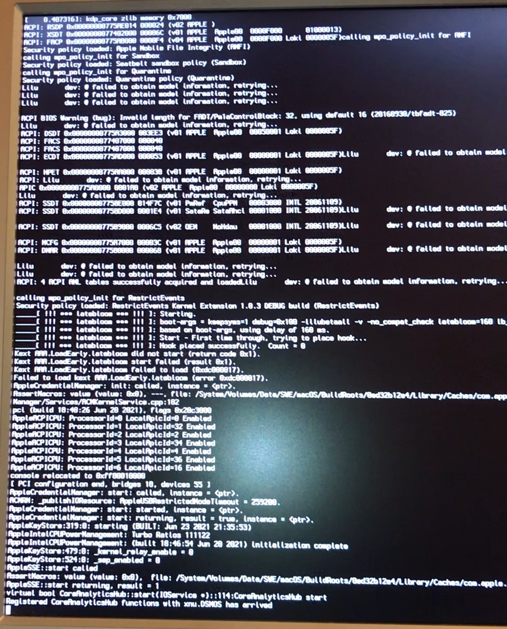

I've just finished over 3 1/2 hours of experimenting and am no further on. My previous attempts using settings from 50-130ms all stalled at AMFIInitializedLocalSigningPublicKey. After reading later posts, I've tried from 150 and increasing by multiples of 10ms (eg. 160, 170. etc) up to 250, then 300, 350, 500 and other combinations in-between and, on my 5,1 system, I only get a successful boot through to the Monterey desktop on an almost random, non-repeatable, basis. One boot and kext load success - confirmed using the AppleScript posted by Macschrauber and running the Terminal checks (using a highish delay setting) stalls at AMFI on the next reboot every time.
I did find that moving the kext string to 2nd place after Lilu failed every time, whereas keeping it last offered a better chance of success - although, again, non-repeatable.
Each verbose boot screen (on the successful and unsuccessful boots) all did show 'Hook placed successfully. Count = 0', but this was always followed by:
Kext AAA.LoadEarly.latebloom did not start (return code 0x1)
Kext AAA.LoadEarly.latebloom start failed (result 0x1)
Kext AAA.LoadEarly.latebloom failed to load (0xdc000017)
Failed to load kext AAA.LoadEarly.latebloom (error (0xdc000017)
Is this correct / do other members see these error messages, even though the 'Hook' is successful?
I've attached images extracted from an iPhone video file, in order to capture the rolling messages. They're a bit fuzzy but I hope are sufficiently readable to maybe be useful to someone (NB. the images got uploaded in reverse order). I've disabled the latebloom kext and am back to reliable boots with just OCLP 0.2.3, which is a significant step forward for me in getting more mileage out of my cMP.
I'm also seeing these messages.
Reactions: startergo
My success rate seems higher with lb_debug=1 even when not booting in verbose mode. Could debug messages have a positive effect on the timing?
That’s the classic programming conundrum - “it works with debugging output, but fails without it.” In this case, the additional output adds a few milliseconds for each output line, so yes - debug messages absolutely can have an effect (positive or negative) on the timing.
