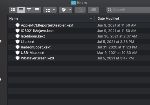

Do you have implemented the latebloom kext correctly? You always write about boot-args.
Code:
kextstat | grep latebloom
should return something

@eVasilis Latebloom did not hook for you. Check your config.plist

kextstat | grep latebloom returns nothing and "log show --predicate 'sender == "latebloom" AND composedMessage CONTAINS "Hook placed successfully"' --start $(date "+%Y-%m-%d") --debug" returns:
Filtering the log data using "sender == "latebloom" AND composedMessage CONTAINS "Hook placed successfully""
Skipping info messages, pass --info to include.
Timestamp Thread Type Activity PID TTL
Log - Default: 0, Info: 0, Debug: 0, Error: 0, Fault: 0
Activity - Create: 0, Transition: 0, Actions: 0
The section in config.plist with latebloom:

It is the last entry.
so latebloom.kext has not loaded at all

Did you copy the kext in the kext folder?
