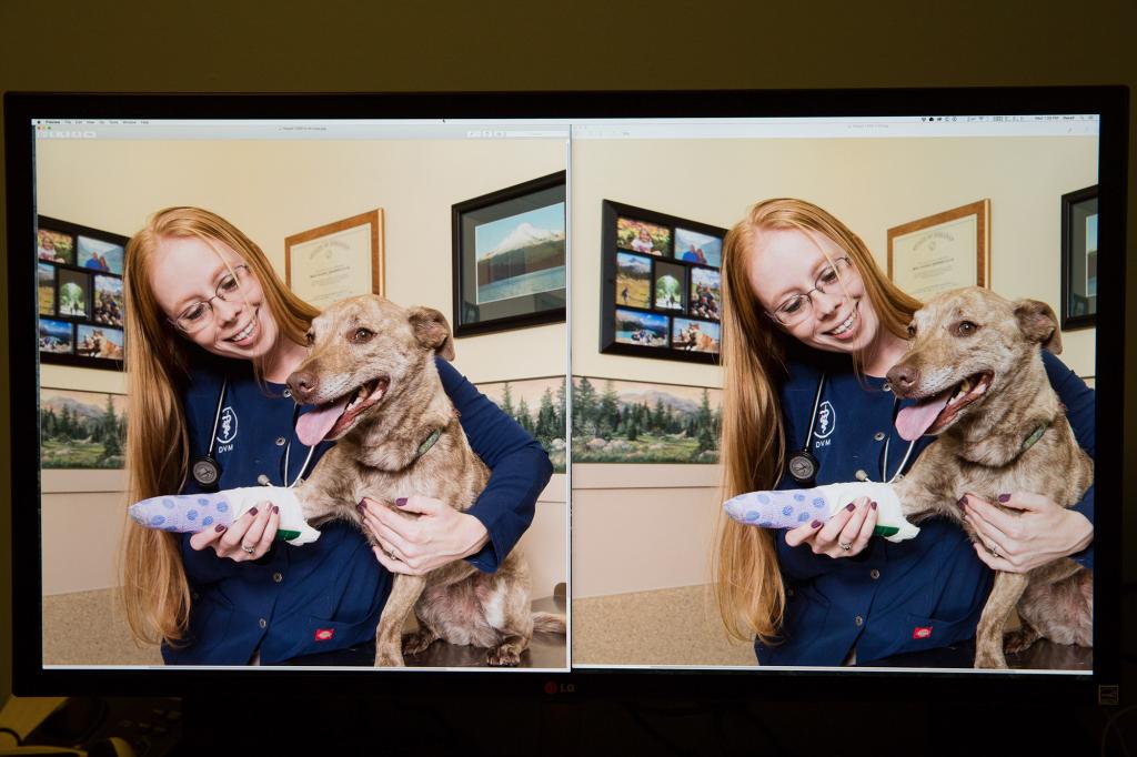

I've noticed that when I scroll, one half of the screen sometimes scrolls at a different rate than the other half.
I also see that problem (scrolling / screen updating) at different speed in left and right half of the screen. In my case, it happens each time I wake the screen from standby. I have to power the LG off and on to fix that until next standby cycle.
in addition when the scroll problem appears, I can see a small area of pixels blinking in the center of the screen (must search, will not find it easily), and also in the center of the top area of the screen.
I use hackintosh with GTX760.
In my opinion it is a firmware bug in the LG. Is it possible to update?
I've attached a photo I took of the screen while scrolling. Anyone else seeing this on their LG?
When I switched the screen off and on the issue completely disappeared, so it's not a huge problem.
Maybe this is because the screen is actually 2x panels stitched together, and the firmware in the monitor that is separating the SST stream into a stream per panel is a little bit buggy?
Or maybe it's a buggy GT 750M GPU driver?
Yes it happened to me. Unplugging cable switching on or off monitor or switching ratio in the monitor menu solves the issue for me. It happen very rarely. I observed it maybe twice. Once happened that whole half of panel became just colour noise. It happen close to wake from sleep it never happened during work. It seems it is bug in firmware.
