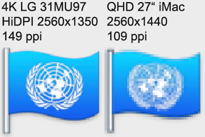

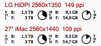

How do you find 2560x1350 HiDPI? I've read elsewhere that as it's scaled and not pixel doubled then the look isn't quite as good as the recommended (but far too large) retina setting. At 2560x1350 do you still consider it "retina"? What I mean is, is it a big step up from a standard, old fashioned display or eye poppingly better with a noticeable improvement in text readability?
I'm asking because the main reason I want to upgrade to 4K is for text clarity as I spend most of my day editing code. :eek: Yes, I could use a larger font setting, but kind of defeats the object of having lots of code on screen at once so I can see what's going on.
Hi AJClayton,
to my eye the HiDPI 2560x1350 (which I currently select with "SwitchResX" or "Display Menu" as I'm typing this on my MP 5,1/280X where this resolution is not part of OS X 10.10.3) is really good, a lot better than "normal" QHD 2560x1440 of a non-retina iMac or my 27" Apple Cinema which is standing to the left of the LG.
Most of the time I'm using HiDPI 2560x1350 (office, Safari etc.) or HiDPI 3200x1687 (Photoshop, Lightroom, Capture One, Adobe CS/CC etc.), my current setting is left display/27" ACD, center display/LG 31MU97, right display/Dell UP3214Q.
In my opinion the HiDPI resolutions of the LG (& UHD Dell with HiDPI 2560x1440) are superior to the old QHD resolution of the 27" ACD/TBD/iMac.
If you use an old Mac like my Mac Pro 5,1 and a "(flashed) PC graphics card" I would recommend SwitchResx and Display Menu to get all the possible HiDPI resolutions you want.
When I use my nMP and 10.10.3, OS X already offers all those useful HiDPI resolutions.

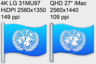

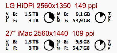

Hi AJClayton,
Thanks for the detailed reply. The graphic you included really shows what a difference it makes. My existing monitor is an ACD 30" which is just over 100 ppi so the step up will be even better for me.
With the help of people such as yourself, I've pretty much made up my mind to go for an LG. I'm just going hold fire for the official release of 10.10.3 to see if Apple and LG update their specs to show 60Hz, but that's pretty much a given from the experiences of those on this thread running the beta. I've got a nMP so I'll get the full list of resolutions you mentioned.
