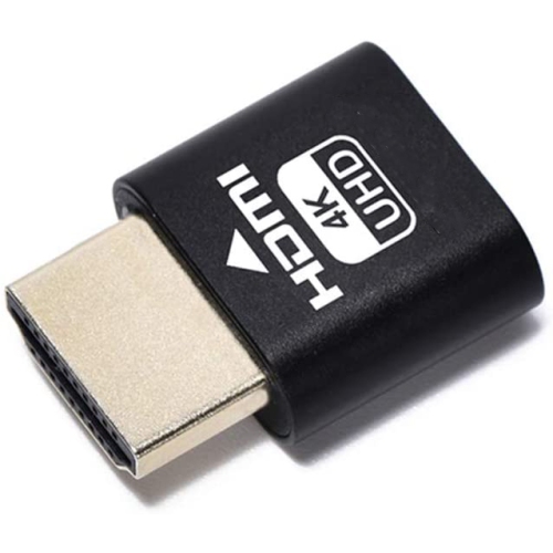

BUT: today I discovered that if I have another monitor connected to the HDMI output of the Nvidia card everything works perfectly even after reboots!
Replying to my own post, I can add that I today have verified that using a HDMI dummy/emulator plugged directly in the graphics card works just as well as the Dell monitor I used earlier. The Thunderbolt connected display works consistently well on cold boots, reboots and wake from sleep.
