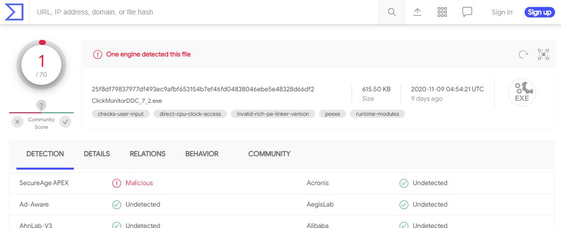

Trying to download the ClickMonitorDCC software. Seems like the link https://clickmonitorddc.bplaced.net/ is no longer available. The software can be found at a few other places e.g. MajorGeeks. But... when I download it and test it at virustotal.com I get a warning that one engine (out of 70) detected a problem with the file. Probably a false positive but anyway, it makes me wonder if it is safe to install?
