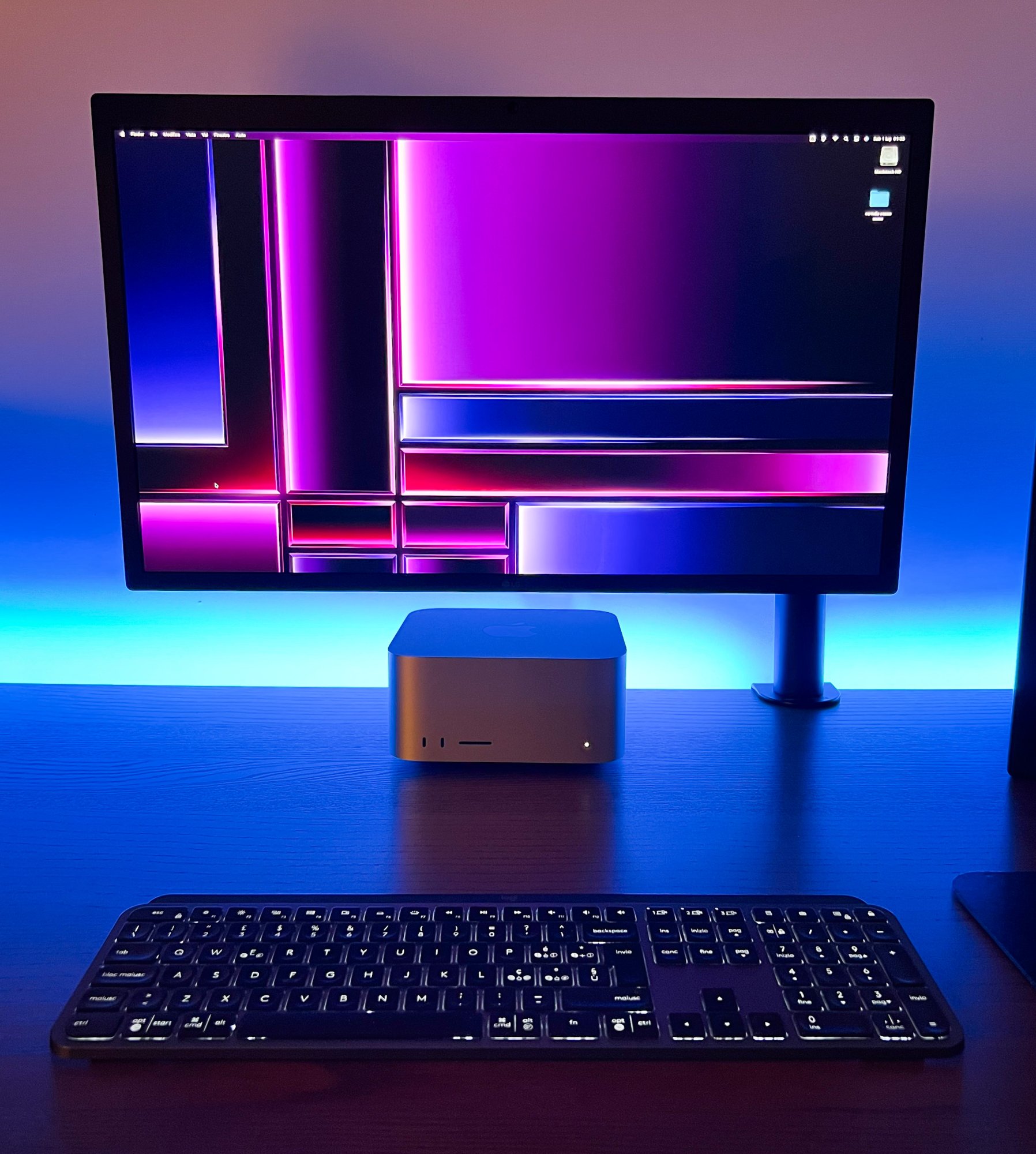

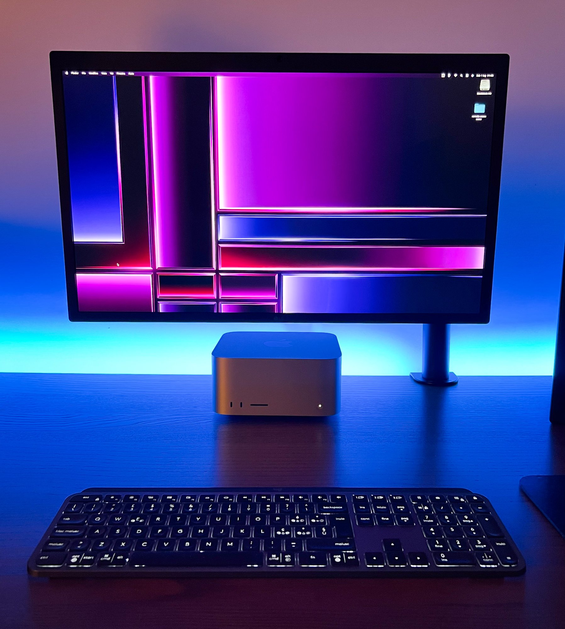

Yes it’s the KLP, the date production is January 2023. The panel looks much better than the first version from 2016. The ports look sturdy.

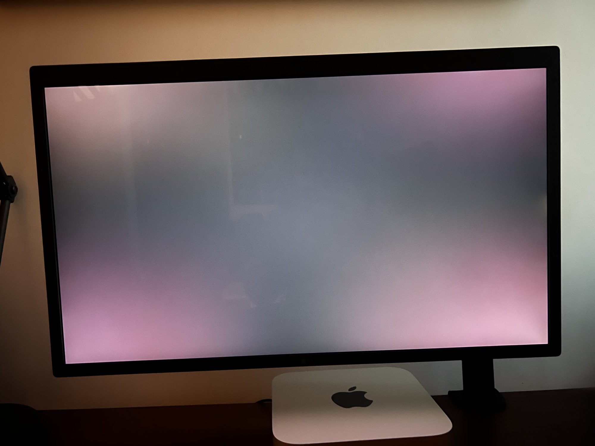

I removed the stand since I didn’t like the design and build quality. Replaced with a vesa arm. I may say it looks much better!
Reactions: AnakChan

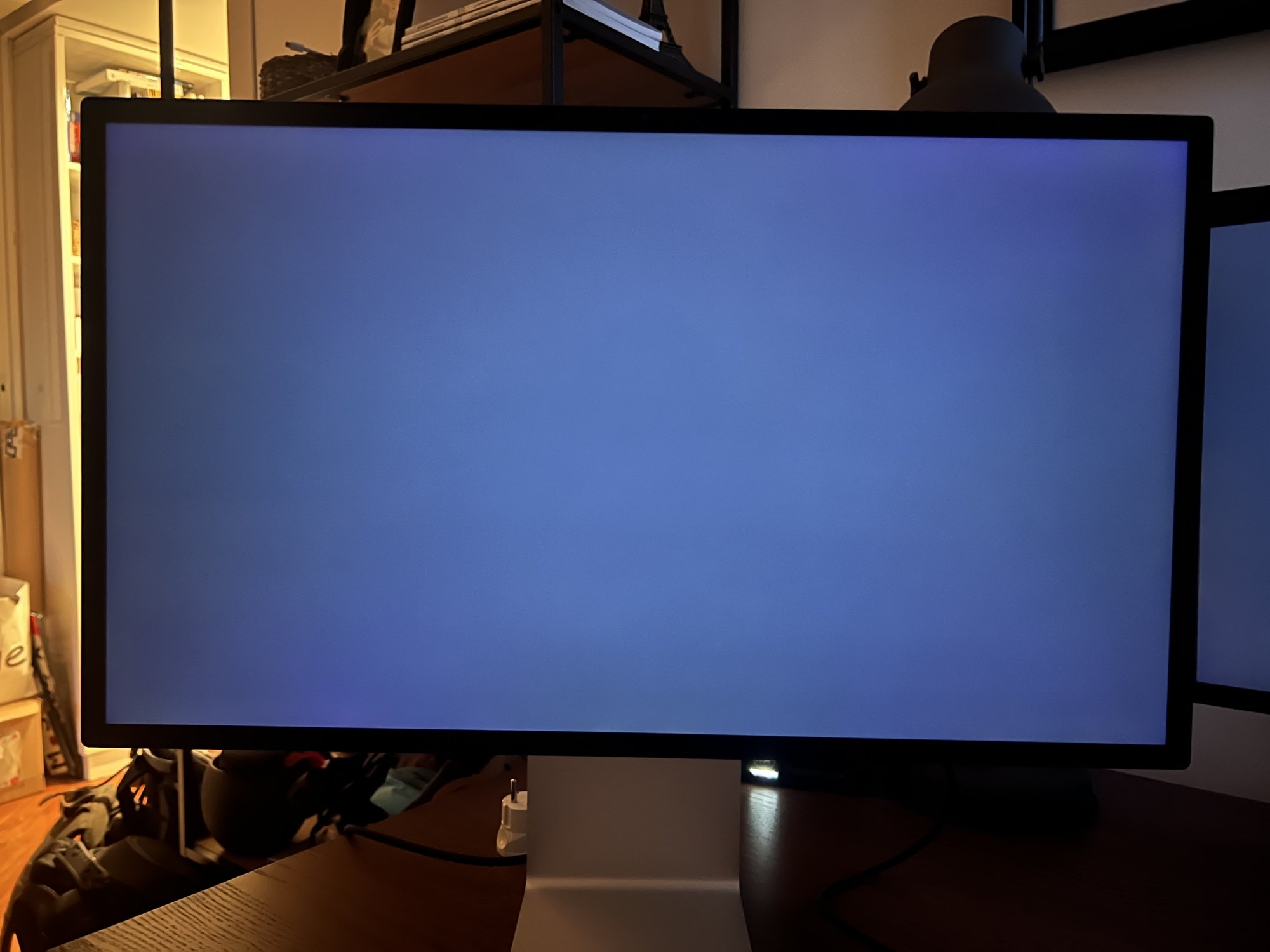

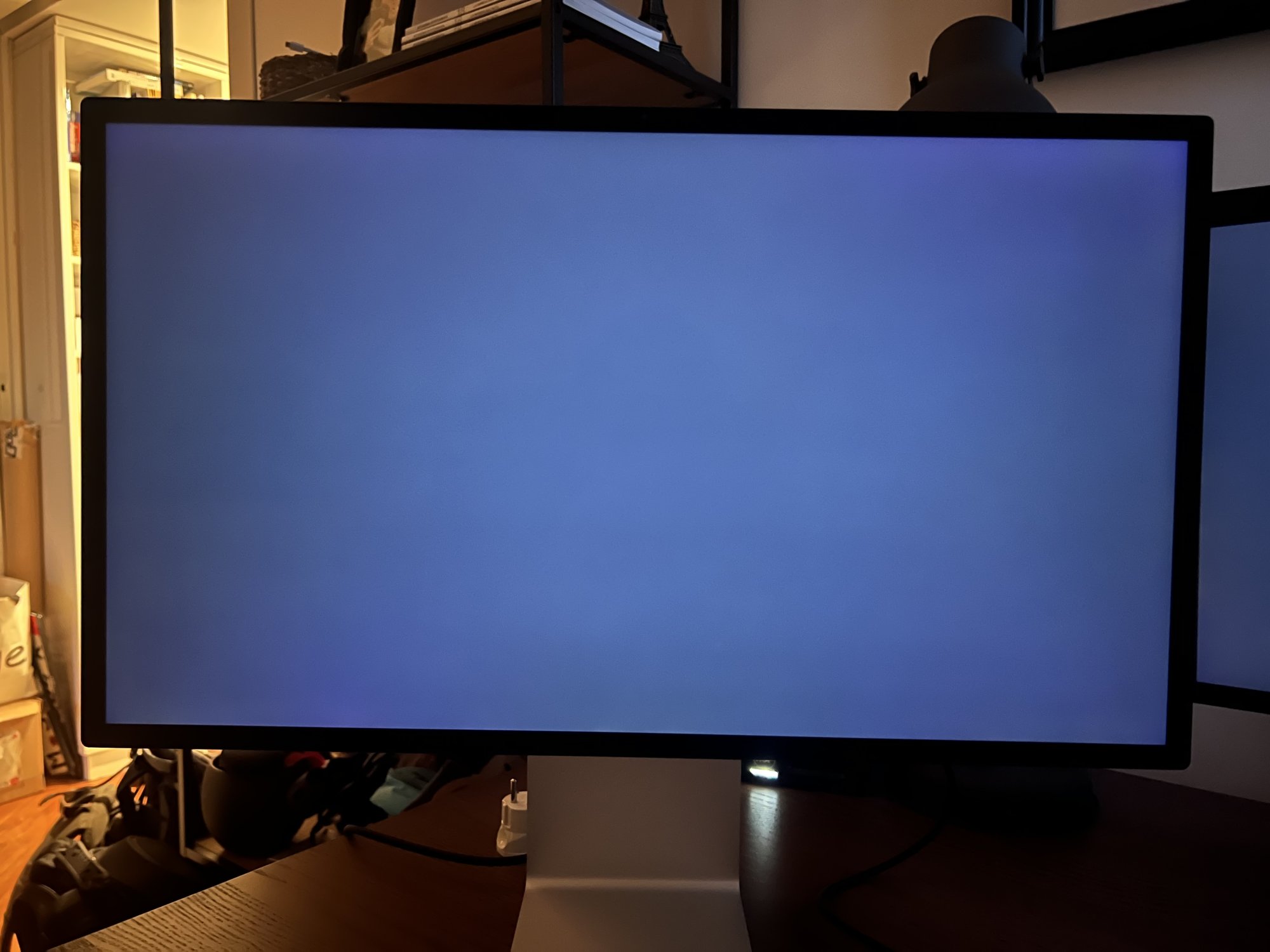

Picked up a Studio Display to compare with the LG. In dark room the difference is massive..

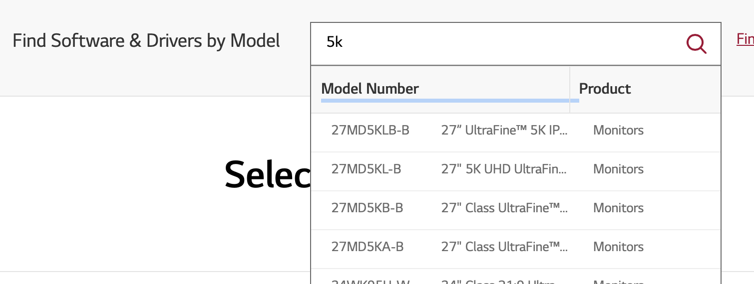

I ordered the LG Ultrafine 5K with article number 27MD5KL-B. Today the store I bought it from contacted me saying that particular model is out of stock and they have a newer version in stock which is the 27MD5KLP-B.
Does anyone know what's the difference?!
I've found a manual pdf for KLP and I see that both models listed in it - KL and KLP. I couldn't find any other differences with the older version. Also there're no reviews of the new model yet. I guess it's a technical upgrade like newer TB chip (TB4 instead of TB3), maybe a bit different matrix panel and this is it.

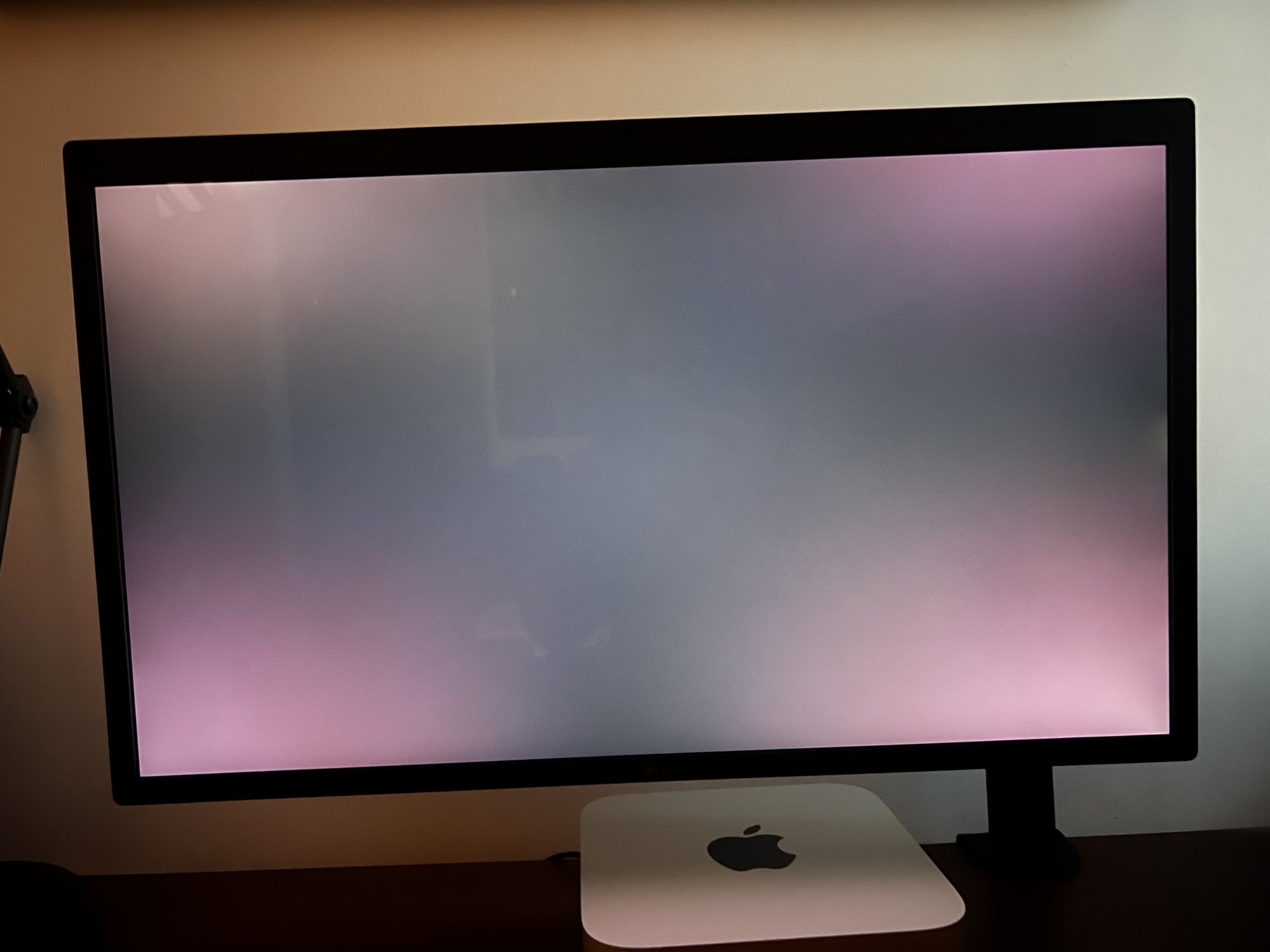

My LG UltraFine 5K monitors don't look like that. Seems that your monitor is defective. I'd contact LG...
It’s not defective, it’s perfect and the panel looks absolutely beautiful but the studio display has a glass in front of the display which I think reduces a lot the amount of glares around the edges and the overall viewing angle. I have seen them one next to the other so I can tell the differences.
Hey, you do you.
For anyone else reading this, that pink hue in the four corners is not normal. I had the same issue with both of my older LG UltraFine 5K monitors years ago. I contacted LG, and they sent me two brand new monitors which did not have that issue.
Hey, you do you.
I know what you are talking about but it’s not this issue. I had the first version of the LG 5k and it did have pink hues in the corners and they were very visible even when the monitor was showing normal content. LG fixed all the problems here I can see. Here it is a totally different story. In my photo is very much accentuate. It’s just the backlight of the screen when the panel displays a total black scene in a totally dark environment. Try it on yours, take a picture, and you’ll see.

I'm actually pretty interested to find out what, if anything, has actually changed with the new variant. Where did you find this new P variant out in the wild? All I can find is the L-B and LB-B variants, and oddly the LB-B is cheaper most places right now at $1,099. The only difference between the L-B and LB-B is the latter is only available through "business channels" and comes with w 3-year warranty instead of a 1-year.

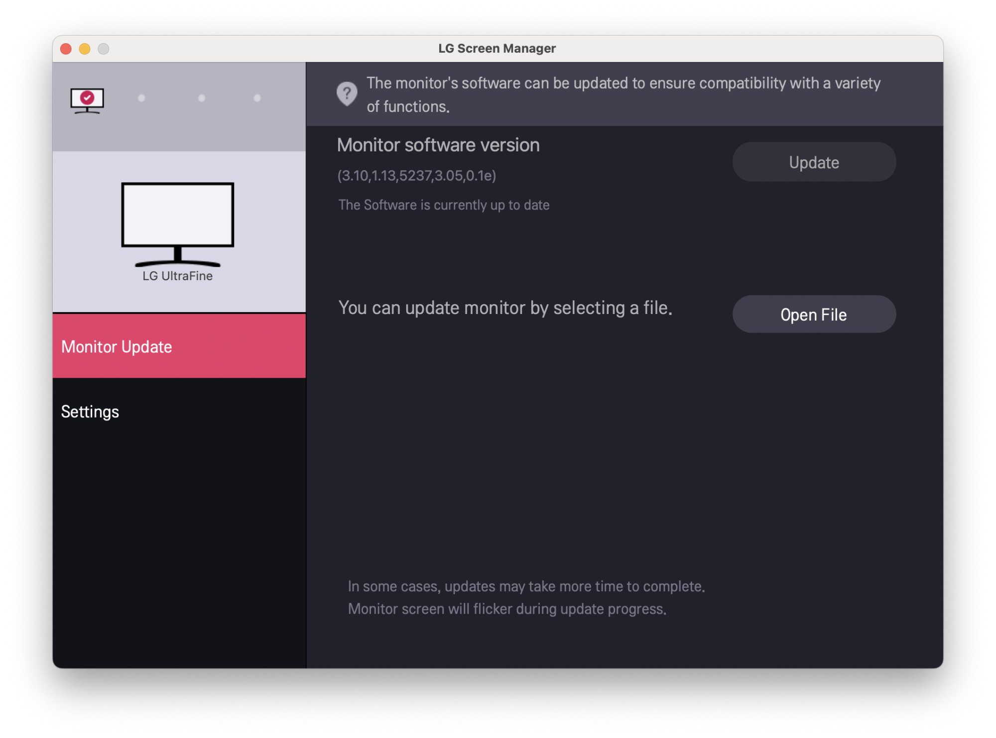

Thanks for the notification. I just updated. It took around 10 minutes to get from 0 to 40% and then about 20 seconds to get from 40% to 100%. At 40%, my screen went black, and I had to login to my macOS account again. I did unplug the power cable from the monitor after the updated completed, since that is what the instructions said to do. It probably was not necessary, but better to be safe than sorry. I am curious what they changed in this version.
Using LG Screen Manager from the App Store.
Before (3.04,1.13,5237,3.04,0.1e)
After (3.10,1.13,5237,3.05,0.1e)
Cool. The main point being LG Screen Manager is an app in the App Store. Didn't have it.
