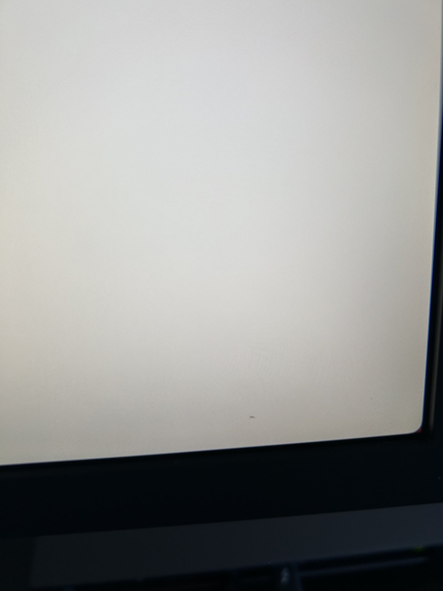

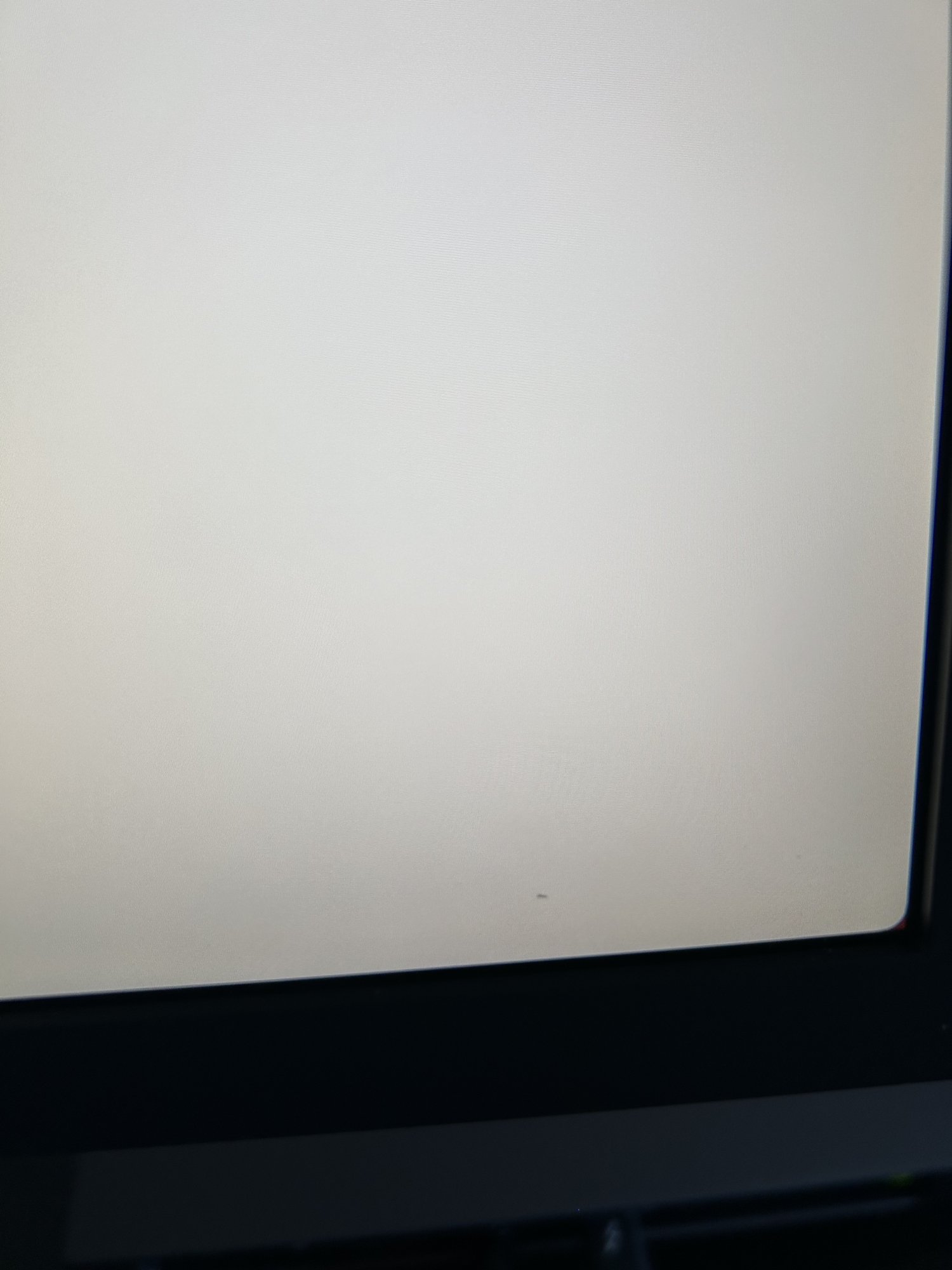

I got the 2019 27MD5KLB-B I ordered from eBay that was listed as "Open Box". There is a small area in the bottom right corner of the display where I think there may be a small piece of dust or debris under the glass. It is about the size of a "." character. Any way to fix this?

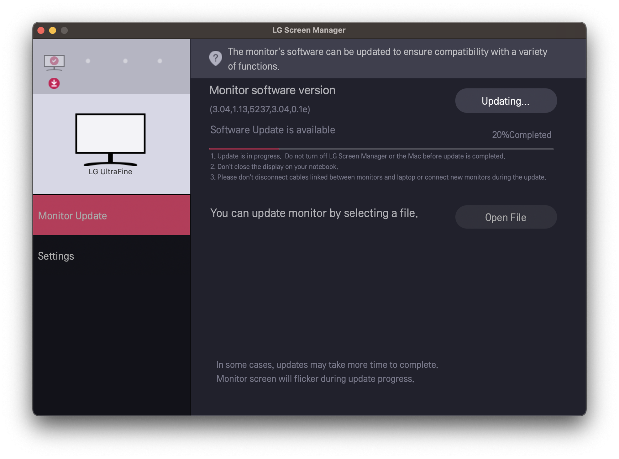

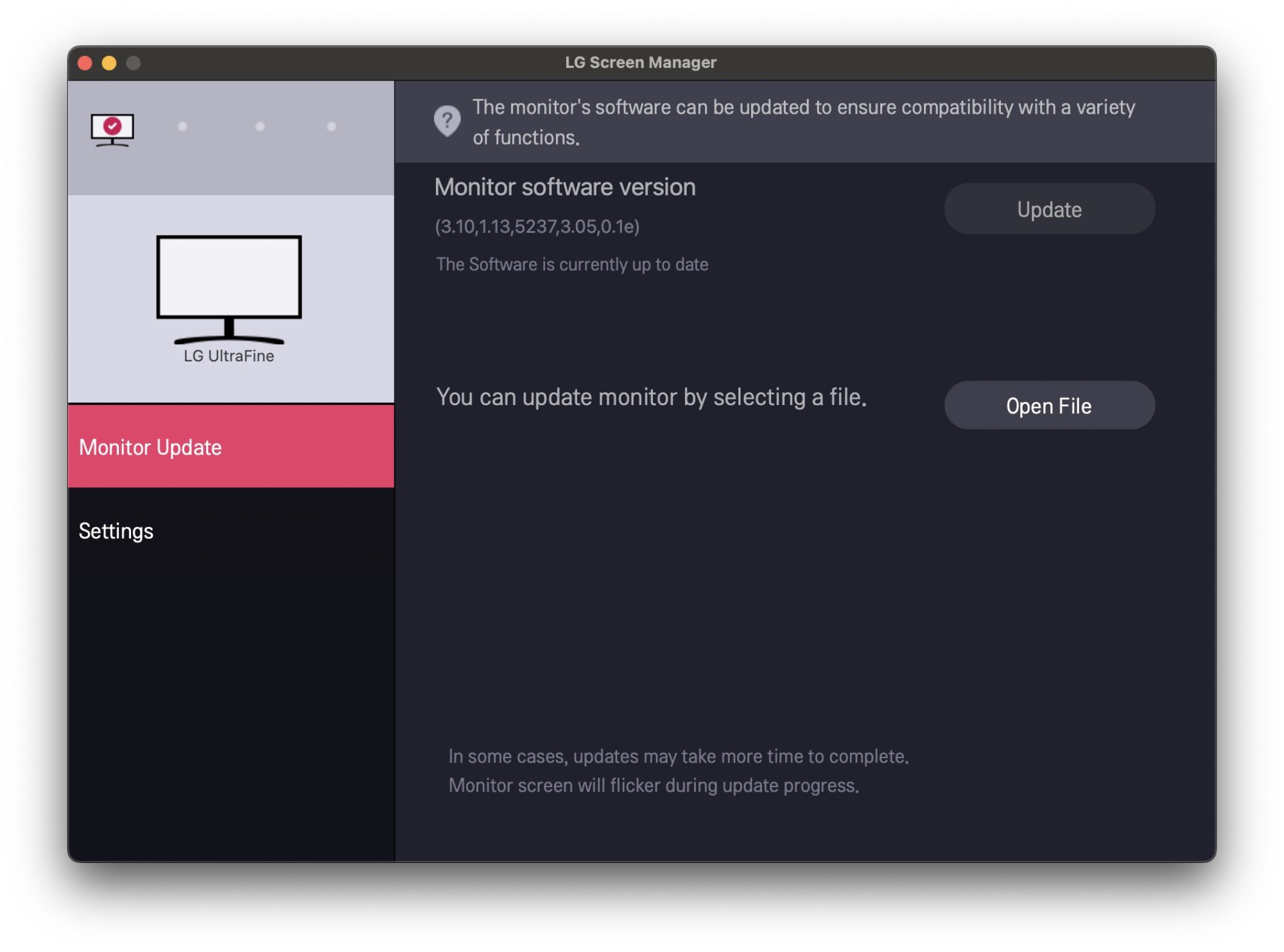

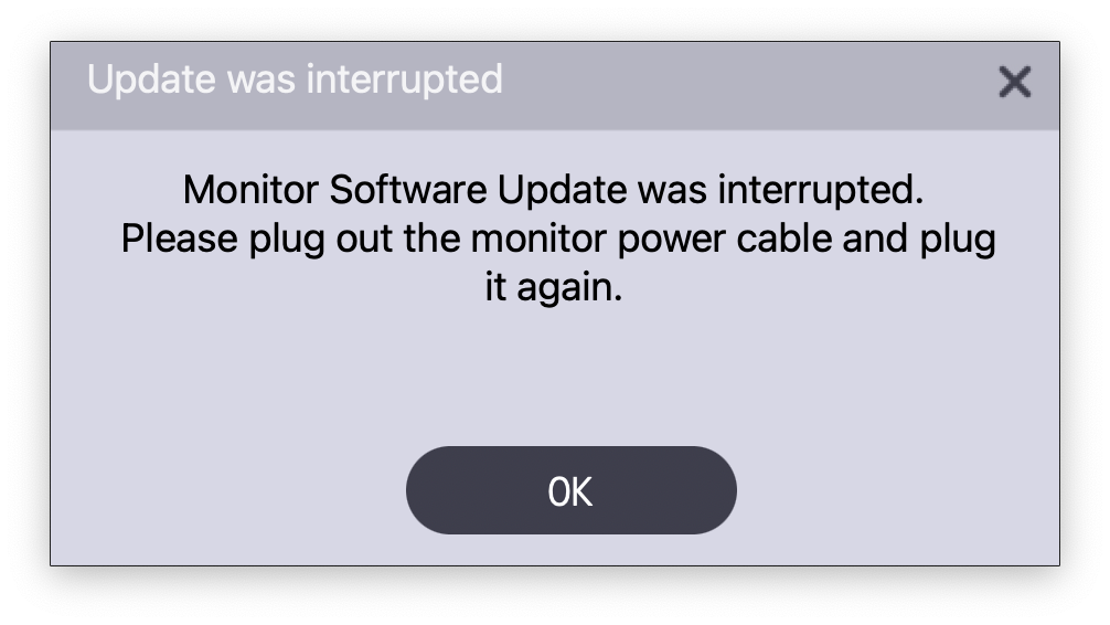

im trying to update my 27MD5KA through Lg screen manager in Macos Ventura but gets stuck at 20% and then its cancelled. Anyone have similar problem? I tried a bunch times and updated to Sonoma, still not working.
Mine is a 27MD5KL so it may not be relevant but I did not have that problem and my version is 3.14,2.23...etc so it has updated to a later version than what you have. I am a bit neurotic about not touching anything while it is updating. All the best with getting yours sorted.
Reactions: LotsOfBees
LotsOfBees
macrumors newbie
Nov 21, 2023
2
2
i figured it out, on apple silicon macs you need to install rosetta or LG Screen Manager will fail after downloading the firmware binary, no idea why.
After installing rosetta the update is working!!
