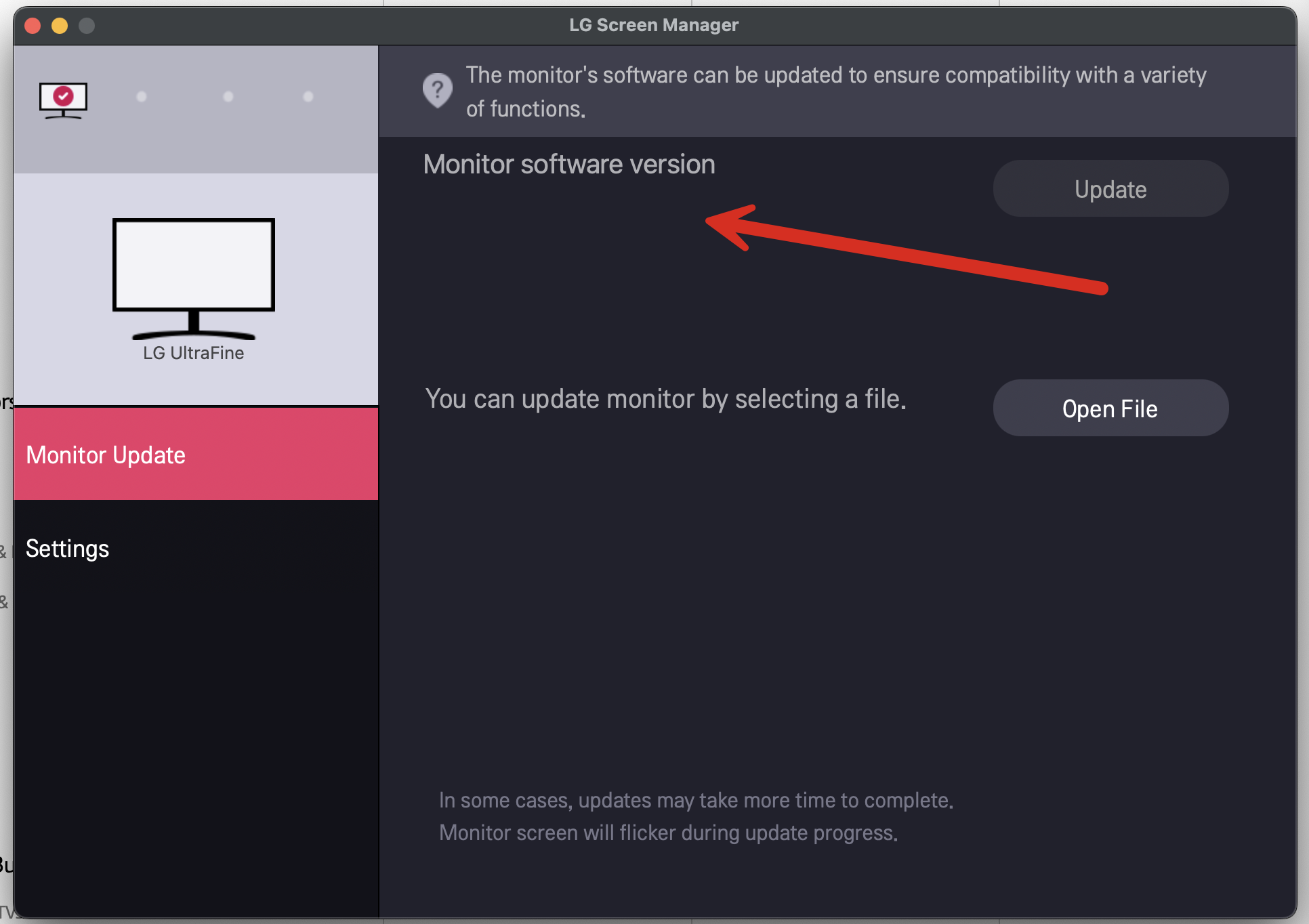

I just got one of these used and I'm having issues with the camera and adjusting the brightness. I downloaded LG Screen manager to check my firmware and it won't even show me what version I'm on or provide an option to update. anyone experienced this?

  3. LG Screen Manager App won't tell me

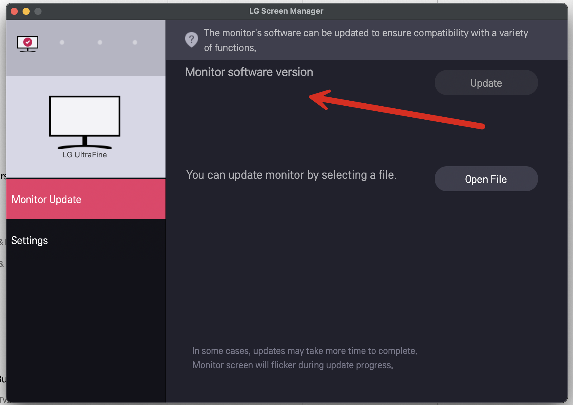

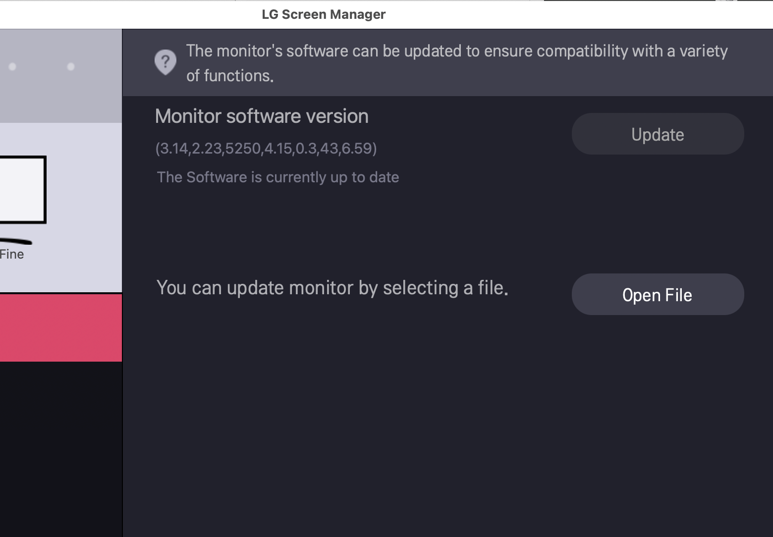

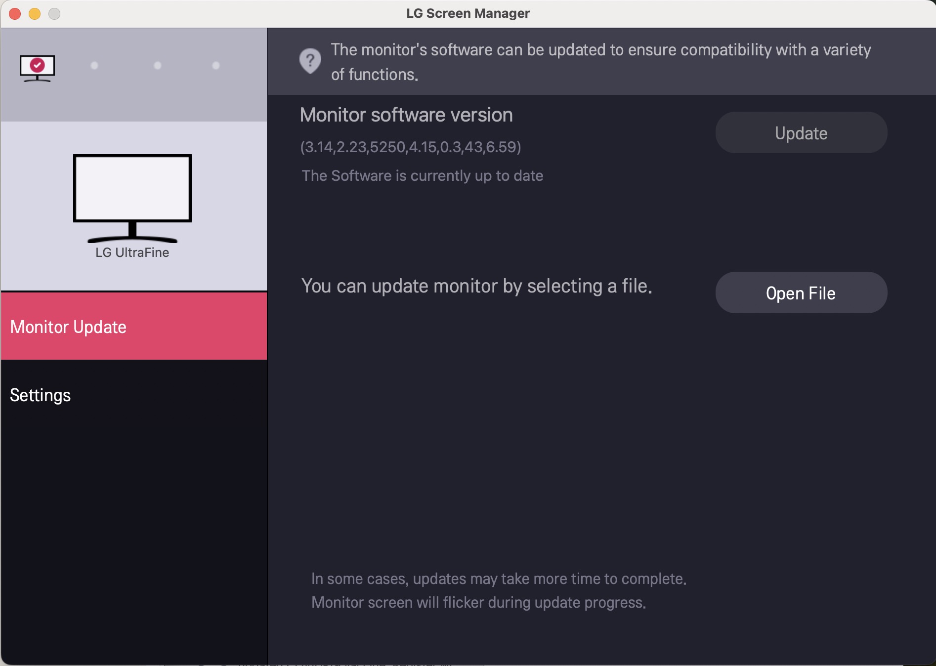

The screen manager app takes most of a minute to give results - I would understand you giving up through thinking it is not working before it slowly gives the results.
hm, I checked back several times over 30 minutes and still nothing, I should be expecting to see something here, right?
Yes, as above. I feel a bit useless as far as trying to help any more as I am fortunate enough that this is simply working for me - in rather less than a minute - and I am able to adjust the brightness and all that.

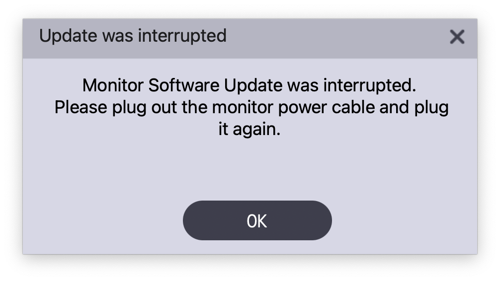

I keep getting the below error when trying to update the firmware. I've unplugged everything from the monitor, tried different USB-C ports on my Mac, rebooted my Mac, and of course power cycled the monitor itself. Anyone have any other ideas?

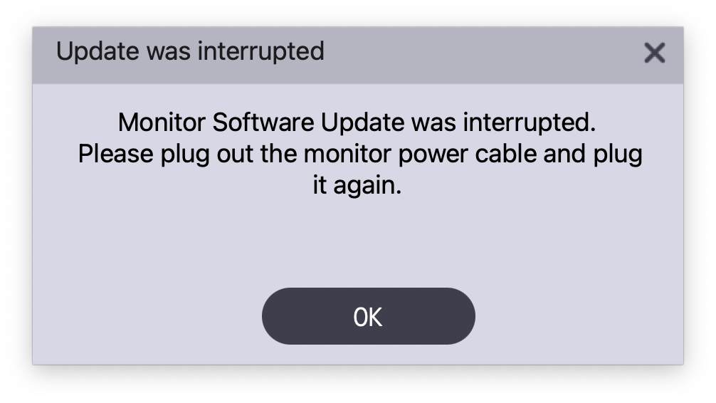

Likely to be the cable in my experience. If you’re not using the original cable, try that one.
Reactions: Lucky736
Unfortunately, I am using the original. It's a few years old and has a bit of wear on it so I've been wondering whether it's worth buying a new Apple TB4 cable as a replacement.
When my current cable is tapped or jostled lightly the monitor will lose its connection until I unplug and plug in again. I'm hoping it's just the cable and not the port(s) themselves.
Btw since my post above I tried multiple more times in safe mode and still no dice with the update. I guess a new cable is the next thing to try.
If all else fails, buy a new Thunderbolt 4 cable (the official Apple one, not 3rd party). I know you shouldn't have to, but it's fixed all of my issues.
