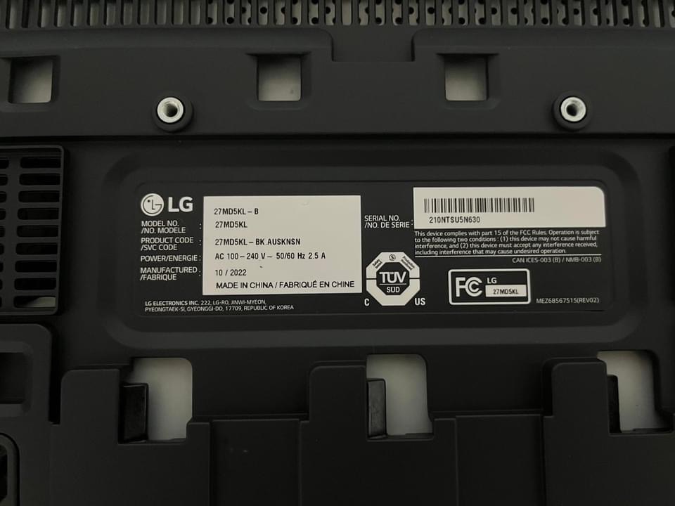

Hello everyone.
I'm new to the community, I just registered to participate and ask a question.
I found this thread in this forum, referring to the LG Ultrafine 5K monitor.
I want to purchase a monitor with 5K resolution for my desktop work environment under the Apple ecosystem.
Since the Apple Studio Display is out of reach for my budget, I am looking for alternatives.
I have a purchase option for a used LG Ultrafine monitor.
A colleague is selling it to me for $400. It seems like an option that I can undertake, but while researching the specifications, performance and durability of this monitor I have encountered many problems, such as color uniformity on the panel, desoldering problems, loss of contact between the Thunderbolt / USB C ports of this monitor, firmware update problems, dead pixels, that's why I ask if these problems persist in all versions of this monitor model? or only in the first versions?
I attached a screenshot of the specific model they are selling me.
I am attentive to your comments.
Thanks in advance.

Hello everyone.
Thanks in advance.
You won't get picture quality problems with 2022 UltraFine, but desoldering problem still can happen.
Reactions: BoneTraiL
The 5K panel is the same as what Apple uses. So I would not expect any issues with color uniformity or dead pixels. Since your co-worker owns it, can't you check out the display before purchase??
In terms of build quality, don't expect Apple standards. And firmware updates are no doubt less stress-free than with Apple.
But $400 is a lot less than $1600.
