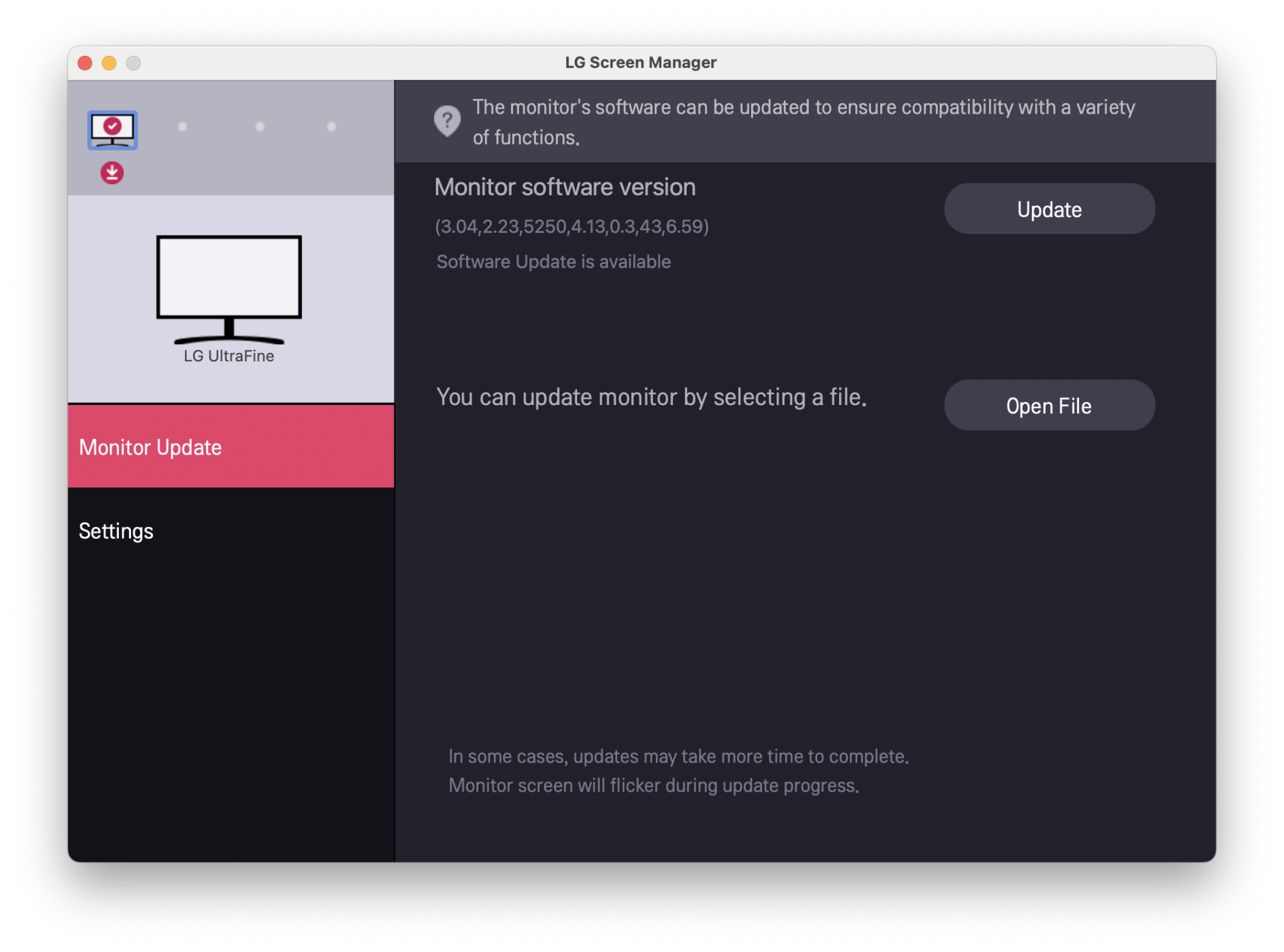

New owner here.
Where I can find firmware changelog? the one inform me to upgrade is (3.04,2.23,5250,4.13,0.3,43,6.59)
eldho
macrumors regular
Aug 16, 2011
161
82
New owner here.
To upgrade the only way I know is to download LG Screen Manager from the app store and run that app. It takes a while - half a minute or so - to tell you what you are on and to give you update options. My up to date version is (3.14,2.23 etc)

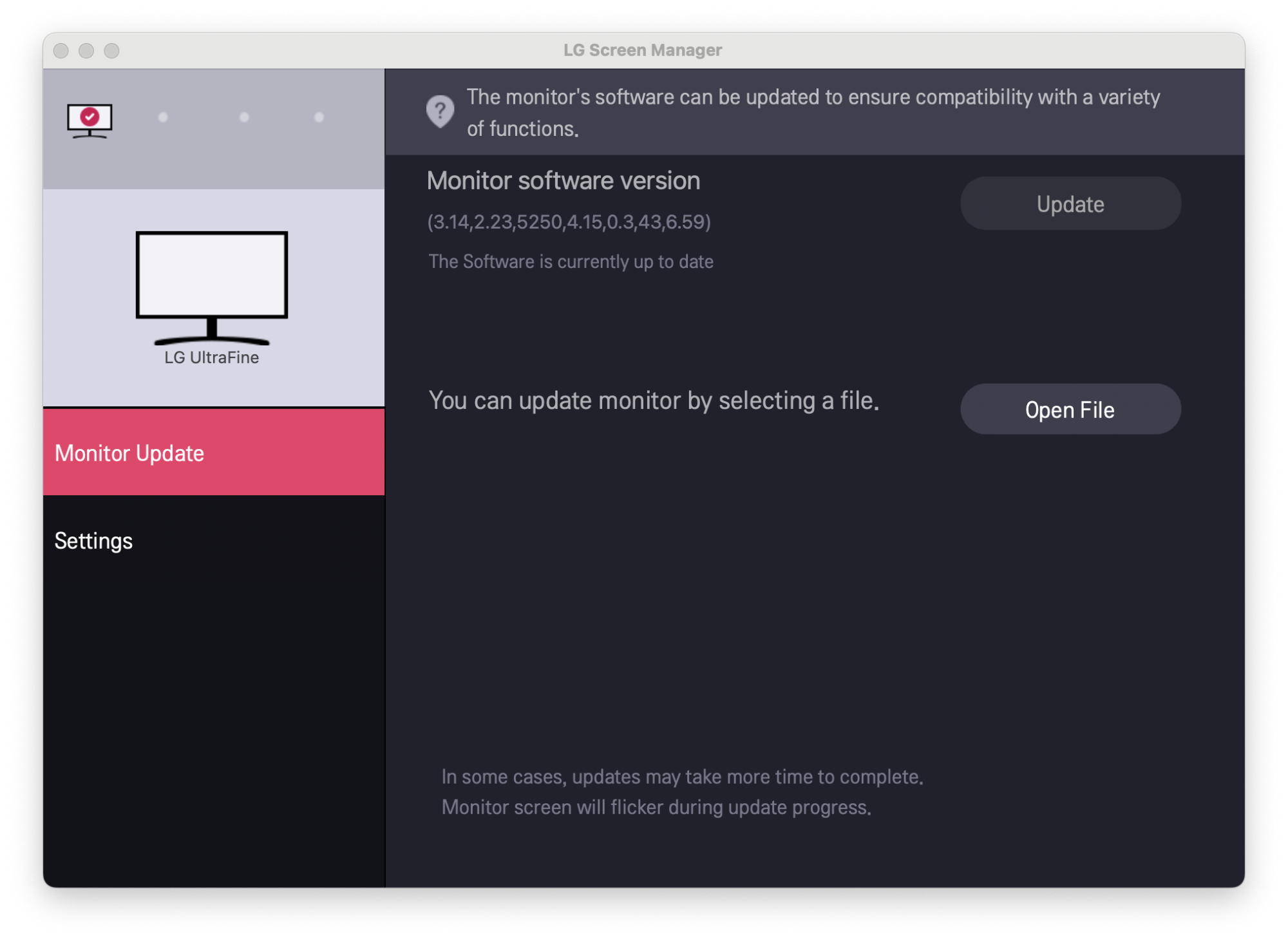

So, a quick update:
I ended buying the hideously expensive TB4 cable from Apple (1m length), and the firmware update still doesn't work. :(
In better news, I've only tested a couple of times, but so far my monitor seems to be waking up much faster? That was the main reason I wanted to update the firmware anyway, so if the new cable continues to result in fast monitor wake-ups I'll be happy even if I can't update the firmware.
NB: I also updated to Sonoma 14.4.1 (from 14.3) so it's possible that's a factor in the faster wake-ups. At some point I'll try the original LG cable again to rule that out.
So just a quick update - I was able to update my firmware today! I'm not exactly sure what changed to allow it to happen as it's failed repeatedly for me, even after I purchased a brand new Apple TB4 cable.
I shut down my computer last night (rare for me, usually it's in standby mode with the occasional reboot). Today when I started it up, the LG Screen Manager loaded (it starts at login) and prompted me to update the firmware. It's failed many, many times before but I decided what the heck, let me try one more time, and for some reason this time it worked. 🤷‍♂️
Screenshots of my firmware before and after are below:
After​
Before​
Reactions: oKUtItyp and eldho
