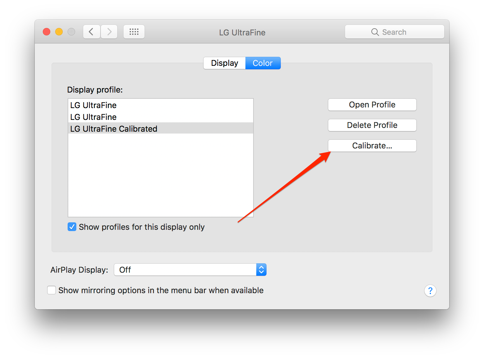

My question is about third party calibration/colorimeters and if people are having success with them. I found my color to be awful right out of the box, although mine was bluish-white & too saturated. I tried the built-in calibration with only limited improvement. I called LG Friday and they said their testing is not complete on whether third party calibration software will work with this monitor (?). So an x-rite system seems to work well with this monitor?
Thanks.
Did you do the option key click one to get the advanced options? I did that and it came out pretty decent. The advanced one gives you some gamma options that the normal one does not.
I was not aware of that option, thanks. I'll try it. (But just got up and half of my USB hub is not showing up, including my backup external drive which gave me 5 error messages. One thing after another...)
Reactions: Weaselboy
Sorry, but I do not see how the Option key click works... can you elaborate? Thx
Sure thing... go to this screen and while holding down the option key on your keyboard mouse click Calibrate and it will open the calibration wizard with some advanced options.
Press and hold 'option' down while clicking the calibrate button. You get a 'Native Gamma' and 'Target Gamma' option you don't get otherwise.

Thanks. The first thing you're asked to do once you start the process is to set the display's contrast to the highest setting... can you even adjust the contrast of this 5k display? if so, how? Thx
Generally for Apple displays brightness/contrast have been interchangeable, so the first thing with calibrating the LG is to turn the brightness up to full max, then follow the steps in the calibration guide.
