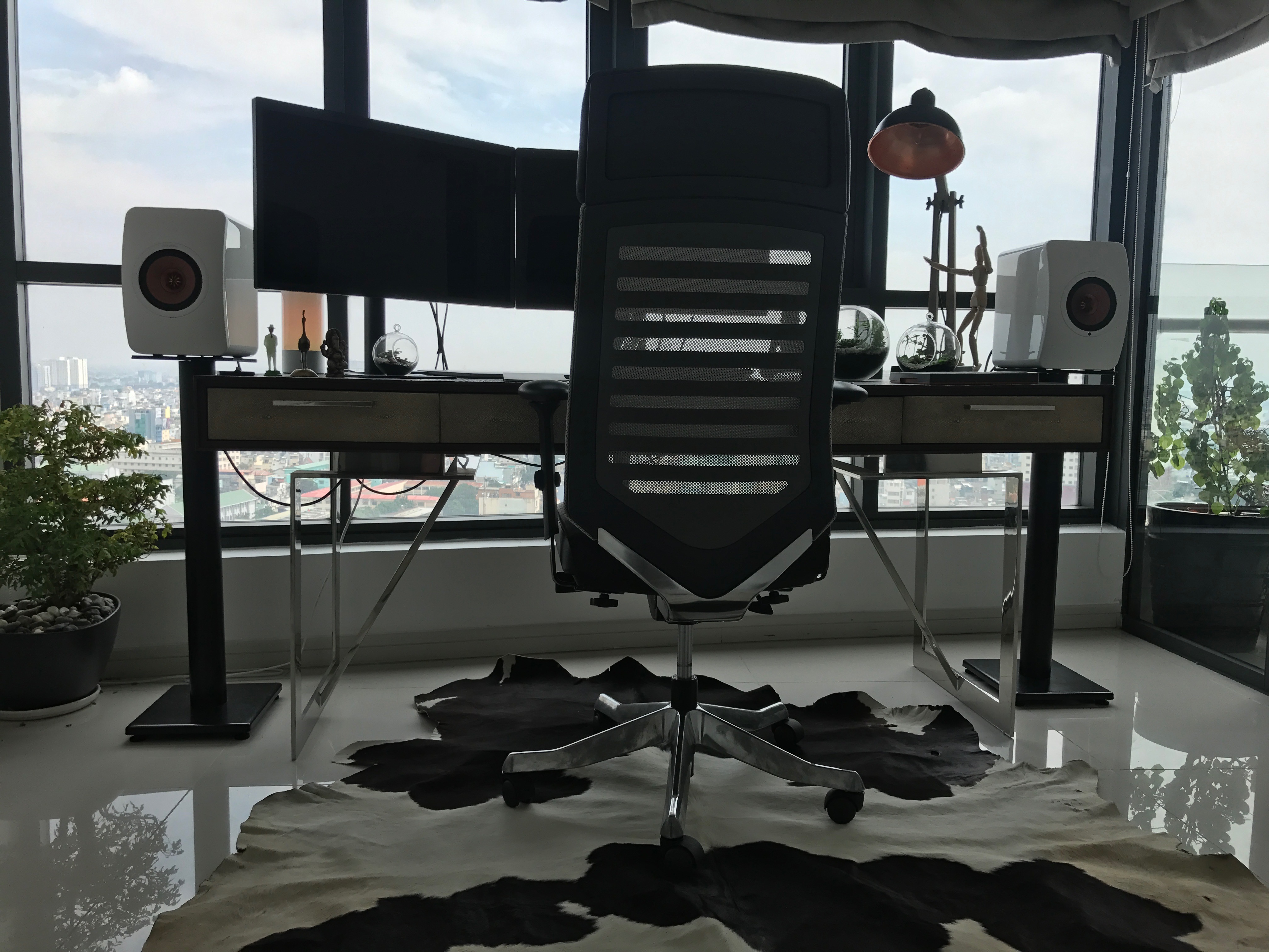

Ohh, my current setup in case another source of interference is spotted.

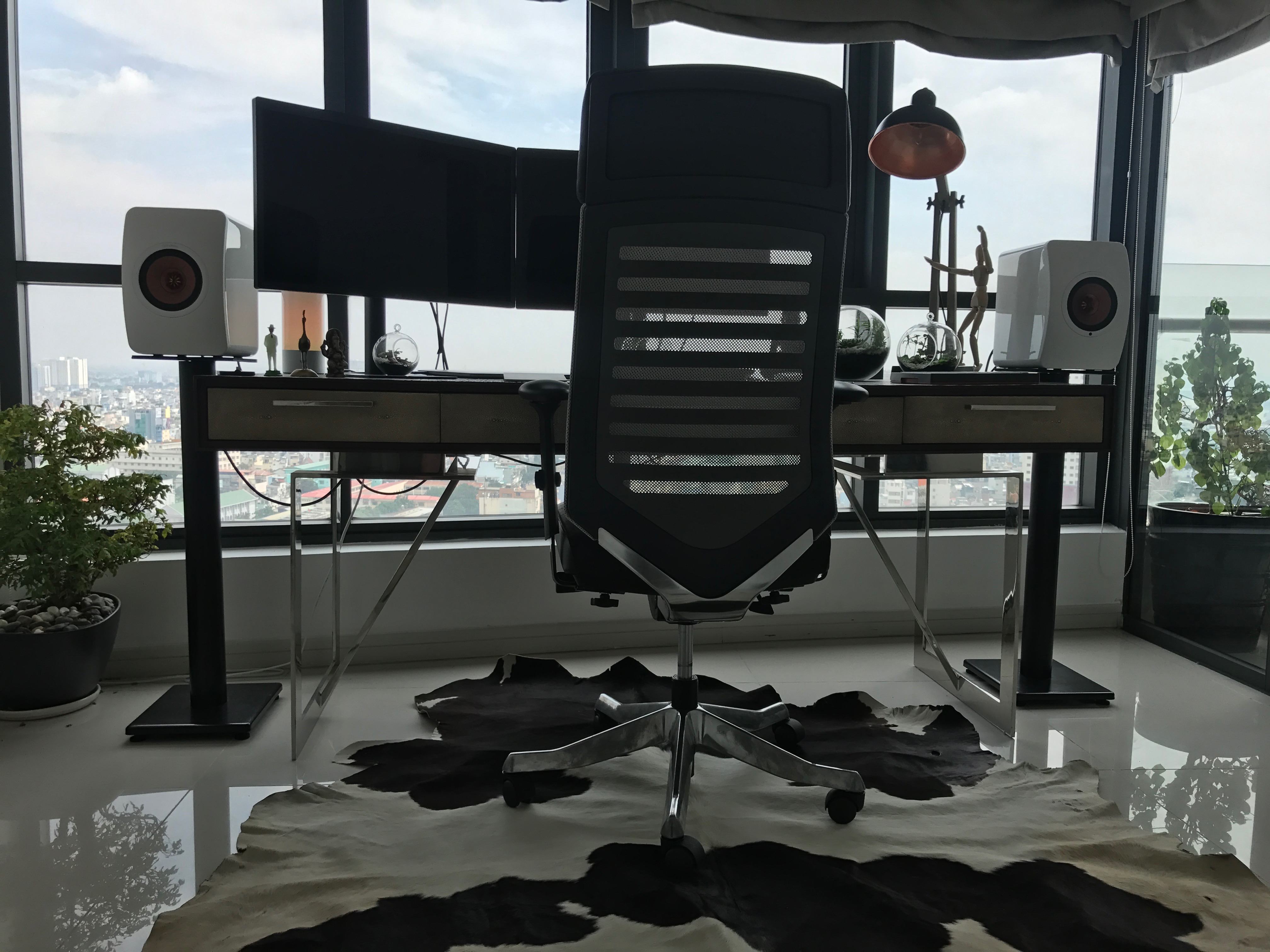

When were your 5Ks purchased. If they're original units, then they need the shielding installed (open a case with LG for each one). The interference would definitely impact bluetooth as well as WiFi. I've had the shielding installed and my bluetooth issues went away. On a related note, my plugging in/out issues have seemingly disappeared on their own. I recall still having those issues while on 10.12.4, but the stopped having issues before I upgraded to 10.12.5. I continue to see no issues now. No clue why the issues went away, but I'm happily using my setup now.
