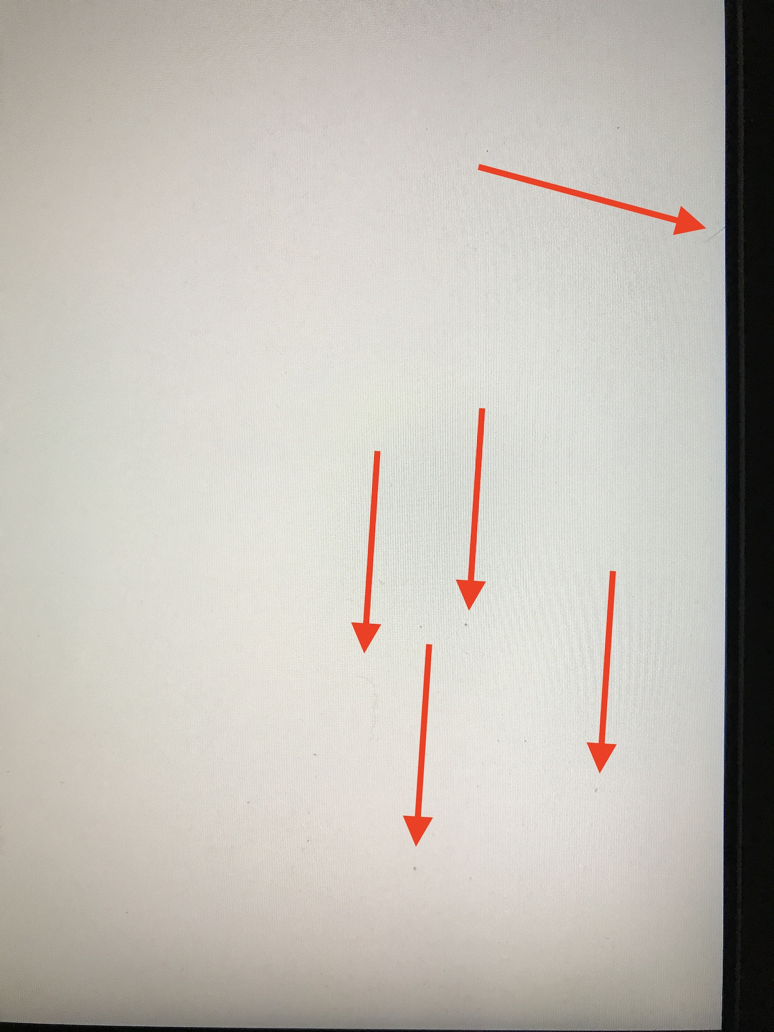

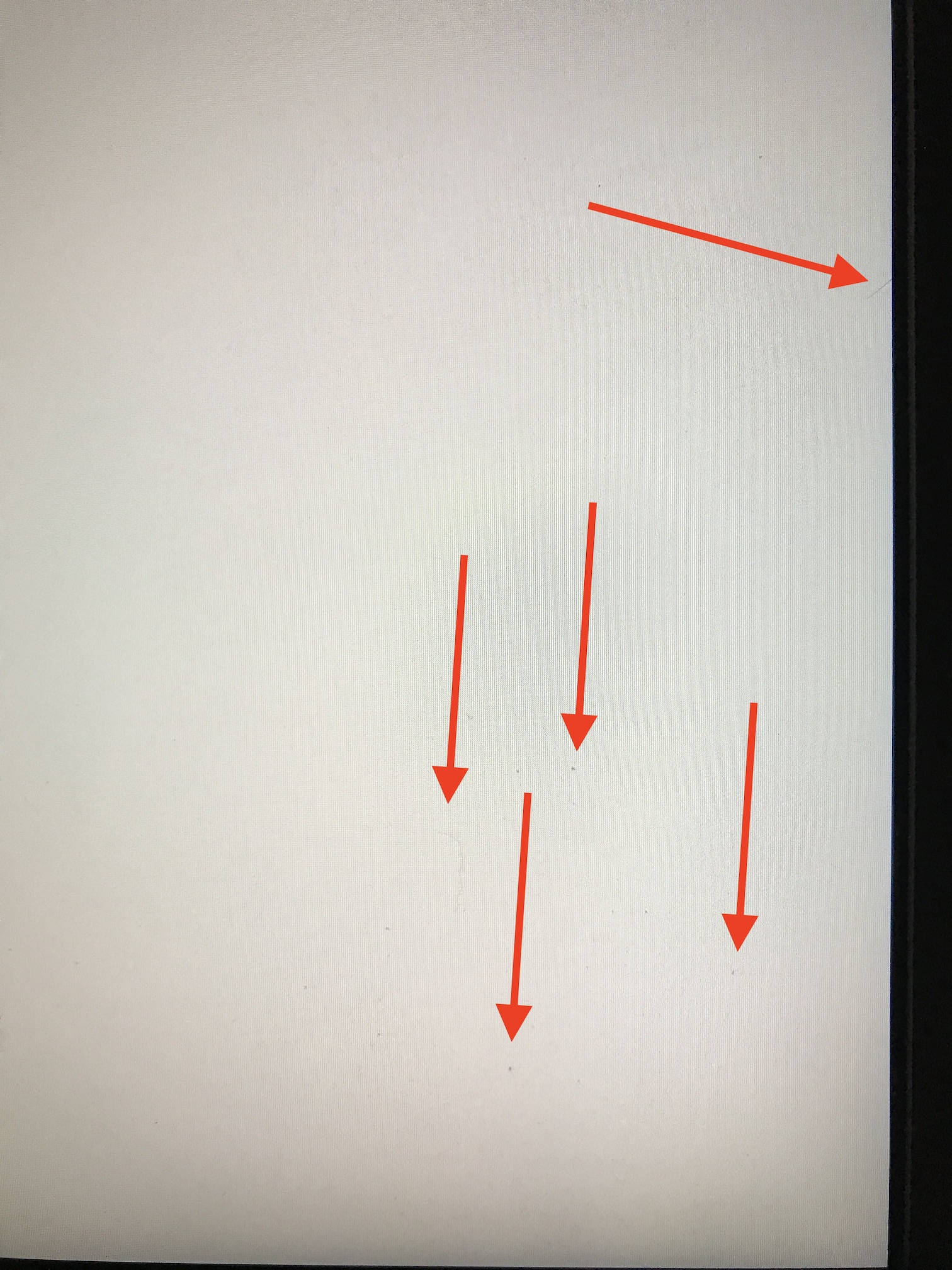

has anyone here experienced specs of dust inside their Ultrafine display? I called LG and they simply gave me an authorization code to take it to service center which is over 30 miles from me and in a very bad part of the city. If this is a common issue, I will sell the display if LG gives me a new unit. Your thoughts?
This is just one side of the problem. It's on the other side as well.
