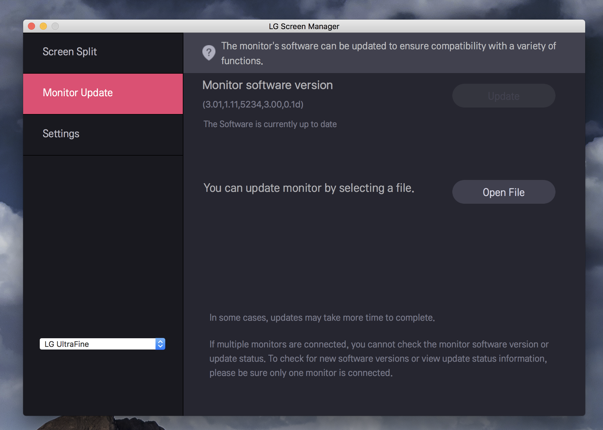

Hi All,
Newbie here. I'm unable to get the latest monitor update for my Ultrafine 5k. LG Screen Manager says I have the latest version but I still have 3.01,1.11,5234,3.00,0.1d. I'm running the latest stable release of Mac OS Sierra (10.12.6) using a 2017 MBP 13-inch with Touchbar.
Can anyone pull the update file from their machine and share it? For a few weeks now I was hoping that updating to High Sierra might prompt the update as I figured it may have prompted others due to their running the High Sierra BETA, but reading through this entire thread (very entertaining btw!) I'm getting worried that I may never get it. LG Support has not been useful, at all, insisting that I have the latest monitor software. Hoping someone here can help me out!
Thanks,
Jack

There is no “update file”. The firmware comes bundled with the LG Screen Manager. Make sure you download the latest version from LG’s website.

I'm using the latest 2.06 Screen Manager listed on their website. Below is a part of the log file generated by the screen manager software, which I think is causing the notification to fail:
Code:
2017-09-08 21:12:55.117 LG Screen Manager[1124:510074] GLHubKit::detectHub
2017-09-08 21:12:55.117 LG Screen Manager[1124:510074] bcdUSB = 784
2017-09-08 21:12:55.117 LG Screen Manager[1124:510074] Find_UsbDev: not to use usb3.0
2017-09-08 21:12:55.118 LG Screen Manager[1124:510074] bcdUSB = 528
2017-09-08 21:12:55.121 LG Screen Manager[1124:510074] bcdUSB = 528
2017-09-08 21:12:55.124 LG Screen Manager[1124:510074] bcdUSB = 768
2017-09-08 21:12:55.124 LG Screen Manager[1124:510074] Find_UsbDev: not to use usb3.0
2017-09-08 21:12:55.124 LG Screen Manager[1124:510074] Find_UsbDev: found 2 GL hub.
2017-09-08 21:12:55.124 LG Screen Manager[1124:510074] Hub Num: 66922204
2017-09-08 21:12:55.124 LG Screen Manager[1124:510074] =============> Call detectHub() API in showFWVersion() err: [0]
2017-09-08 21:12:55.124 LG Screen Manager[1124:510074] =====> Call CheckGenesyLogicHub() API ==============>
2017-09-08 21:12:55.125 LG Screen Manager[1124:510074] Get Hub
2017-09-08 21:12:55.125 LG Screen Manager[1124:510074] =====> Return value matchChip : [1] ==============>
2017-09-08 21:12:55.125 LG Screen Manager[1124:510074] =====> Call CheckGenesyLogicHub() API ==============>
2017-09-08 21:12:55.125 LG Screen Manager[1124:510074] Read XROM data failed, address = 00000000, err = e000404f
2017-09-08 21:12:55.125 LG Screen Manager[1124:510074] perform getXromData fail, -536854449
2017-09-08 21:12:55.125 LG Screen Manager[1124:510074] =====> Return value matchChip : [0] ==============>
2017-09-08 21:12:55.125 LG Screen Manager[1124:510074] Hub Num: 1
2017-09-08 21:12:55.125 LG Screen Manager[1124:510074] HubBuffer=0
2017-09-08 21:12:55.126 LG Screen Manager[1124:510074] Hub Num1: 1
2017-09-08 21:12:55.126 LG Screen Manager[1124:510074] getHubInfo: Device0: bcdUSB 0210
2017-09-08 21:12:55.126 LG Screen Manager[1124:510074] getHubInfo: Device0: portNum 1
2017-09-08 21:12:55.126 LG Screen Manager[1124:510074] getHubInfo: Device0: productName USB2.1 Hub
2017-09-08 21:12:55.126 LG Screen Manager[1124:510074] getHubInfo: Device0: vendorName LG Electronics Inc.
2017-09-08 21:12:55.126 LG Screen Manager[1124:510074] getHubInfo: Device0: deviceAddress 2
2017-09-08 21:12:55.126 LG Screen Manager[1124:510074] getHubInfo: Device0: releaseNumber 5234
2017-09-08 21:12:55.126 LG Screen Manager[1124:510074] getHubInfo: Device0: deviceSpeed 2
2017-09-08 21:12:55.127 LG Screen Manager[1124:510074] getHubInfo: Device0: matchVID 043E
2017-09-08 21:12:55.128 LG Screen Manager[1124:510074] getHubInfo: Device0: matchPID 9A46
2017-09-08 21:12:55.128 LG Screen Manager[1124:510074] convertHubTypeToPartNumber: hub[0] = CHIP_ID_GL7394_SPI
2017-09-08 21:12:55.128 LG Screen Manager[1124:510074] Hub Num2: 1
2017-09-08 21:12:55.128 LG Screen Manager[1124:510074] GLHubKit::getHubInfo
2017-09-08 21:12:55.128 LG Screen Manager[1124:510074] GLHubKit::getCompleteHubInfo
2017-09-08 21:12:55.128 LG Screen Manager[1124:510074] getFwVersion: chip_id is CHIP_ID_GL7394_SPI.
2017-09-08 21:12:55.128 LG Screen Manager[1124:510074] getUpdateMode
2017-09-08 21:12:55.144 LG Screen Manager[1124:510074] getFlashIndex: flash index = 24
2017-09-08 21:12:55.370 LG Screen Manager[1124:510074] getFlashIndex: flash index = 24
2017-09-08 21:12:55.568 LG Screen Manager[1124:510074] getUpdateMode XROM1 = XROM ,  XROM2 = XROM
2017-09-08 21:12:55.568 LG Screen Manager[1124:510074] getUpdateMode FwVersion1 = 21044 ,  FwVersion2 = 21043
2017-09-08 21:12:55.568 LG Screen Manager[1124:510074] getUpdateMode romCheckSum1 = 40106 ,  romCheckSum2 = 64238
2017-09-08 21:12:55.568 LG Screen Manager[1124:510074] getUpdateMode checkSum1 = 40106 ,  romCheckSum2 = 64238
2017-09-08 21:12:55.568 LG Screen Manager[1124:510074] Update Mode = 5 LoadPage = = 1
2017-09-08 21:12:55.568 LG Screen Manager[1124:510074] GLHubKit::getHubFwVer
2017-09-08 21:12:55.568 LG Screen Manager[1124:510074] GLHubKit::getCompleteHubInfo
2017-09-08 21:12:55.576 LG Screen Manager[1124:510074] getFlashIndex: flash index = 24
2017-09-08 21:12:55.576 LG Screen Manager[1124:510074] FW version 5234
2017-09-08 21:12:55.577 LG Screen Manager[1124:510074] findUpdateFiles: bin file = /Applications/LG Screen Manager.app/Contents/Resources/update_data/GL3523_VBYS1_LGE_PDDock_FW5222.bin
2017-09-08 21:12:55.577 LG Screen Manager[1124:510074] Unable to open firmware file.
2017-09-08 21:12:55.577 LG Screen Manager[1124:510074] findUpdateFiles: can't open bin file!
2017-09-08 21:12:55.577 LG Screen Manager[1124:510074] Ready for FW update
2017-09-08 21:12:56.495 LG Screen Manager[1124:510074] FW Image file URL Content
NotAllowedPage
2017-09-08 21:12:56.495 LG Screen Manager[1124:510074] Wrong File Name got from server

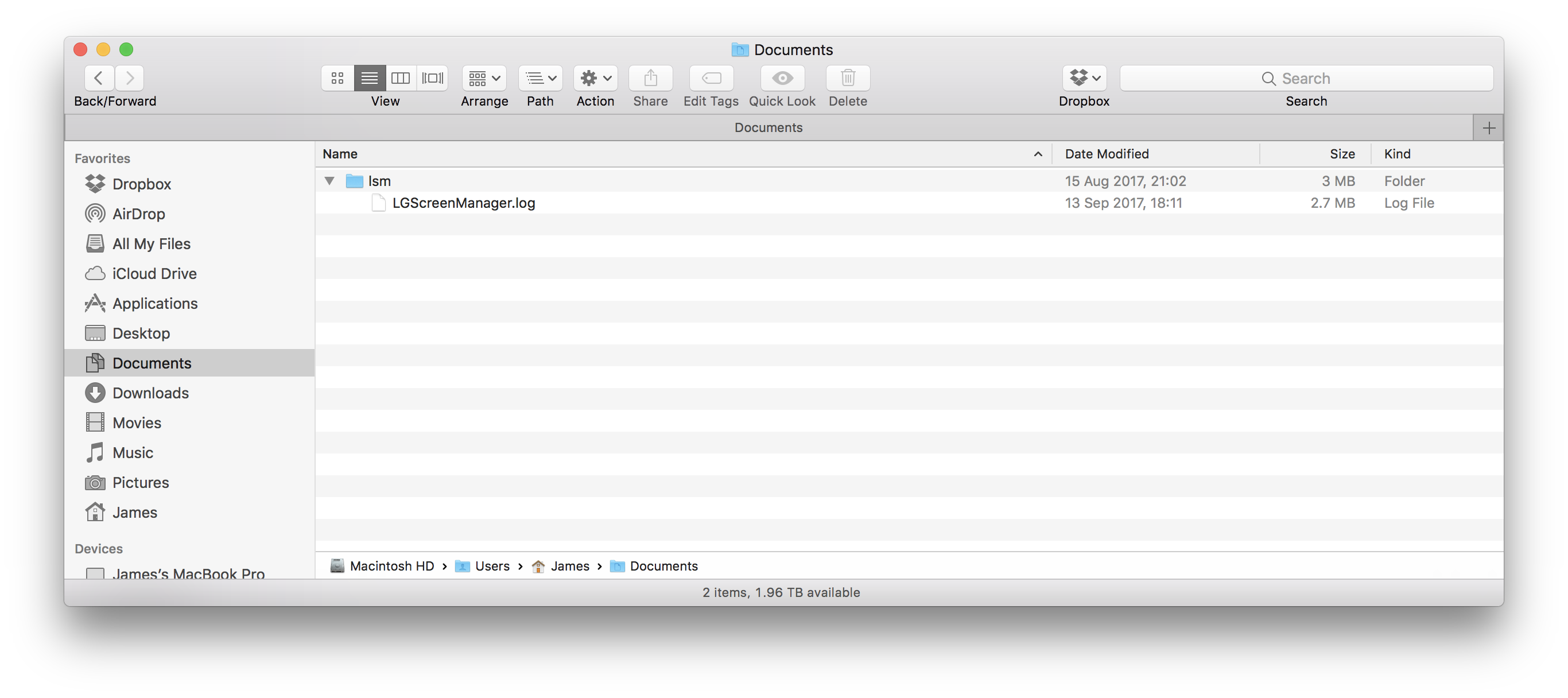

[doublepost=1505584027][/doublepost]Anyone help me with a quick issue:
1) Do you guys have this folder ("Ism") with file ("LGScreenManager.log") in your Documents folder? What is it for?
[note I've hidden the other docs in Documents temporarily, so it's on it's own in there]
2) Do I need to keep the folder/file, or can I delete one/both?
Clearly they're related to the LG 5K Display ("LG Screen Manager" app?) in some way... but miffed on what it's for and why it's decided to help itself to inclusion in my private Docs folder!
Thanks in advance.
Yep... I had that also after I ran the app and updated the firmware. It was just a log of the firmware update and I deleted the whole folder and nothing bad happened.
Many thanks Weaselboy! Yeah I was just re-reading through this thread a minute ago, and found your original post (#1199) about this happening:
I just tested, and mine also seems to wake about twice as fast as it did.
Also, just a warning for anybody doing this update. Don't get panicked when it seems to have stalled. Mine got to around 20% or so and sat there a good two or three minutes apparently doing nothing, then slowly started inching along again. I'd say the whole thing was about seven minutes.
I noticed the FW installer made an install log in a folder call lsm in my ~/Documents folder.
Good to know this can go in the Trash! ;-)

Hi,
I have exactly the same issue. In the same conditions (macOS 10.12.6 and LGscreenmanager v2.06) and the button for firmware update is grayed out despite my monitor FW showing up as 3.01,1.11,5234,3.00,0.1d.
What the hell is happening with our versions of LG Screen Manager that there is no LG Screen Manager.app/Contents/Resources/update_data/GL3523_VBYS1_LGE_PDDock_FW5222.bin?
For the record, though located in Spain, I have downloaded both US and UK versions of the v2.06 Screen Manager app with the same results in both cases.
Can anybody who has successfully updated to 0.1e extract the .bin file from the Contents of the Screen Manager application and share it with us here, please?
