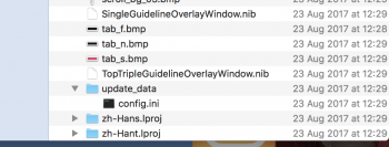

Here is what I found in the lsm log after trying to update the firmware on my LG 5k Monitor:
http:/lmu.lge.com/ExternalService/lgscreenmanager/mac/FW/27MD5KA_MP3/MODEL_27MD5KA_SV3.04_CV1.13_HV5237_NV3.04_AV0.1e_20170705.zip
If you type that into your browser it will download what I believe is the latest firmware available for the LG 5K (I think the firmware is dated July 2017).
BTW I have upgraded my monitor but it seems to lose the update after a few days. The LG Screen Manager is very flakey as well.
GL
Use at your own risk.

WOWWWWWW IT WORKED!!!!!!!!!!!!
THANK YOU THANK YOU THANK YOU! how in the world did you find that file? Can you please show me the lsm log, so that I can find the update files in the future?
For everyone trying to update, this indeed works. download the zip file and then "open file" within the LSM to manually update. You do not need to unzip the zip file, it is password protected, but LSM still recognizes it and is able to use it
It certainly has also worked finde with mine!!!!
Thank you very much for discovering this!
It would also be interesting to know where you found that entry in the lsm log file.

Bob, thank you so much! Was able to update just fine, and am enjoying the more granular volume control! Strange that this link showed up on a monitor that already updated to the latest version. I only hope that we don't have to go through another one of these debacles once the next update hits.
Thanks also to everyone in this thread who tried to help!
Reactions: tonidavid5
Unfortunately you now need a password to unzip it,.. did anyone save a copy?
Worked just fine here as well! Thank you bob48
Side note, make sure your laptop is not in clamshell mode while doing this. The upgrade will work, it just won't wake afterwards. But it upgrades the firmware with ease.
