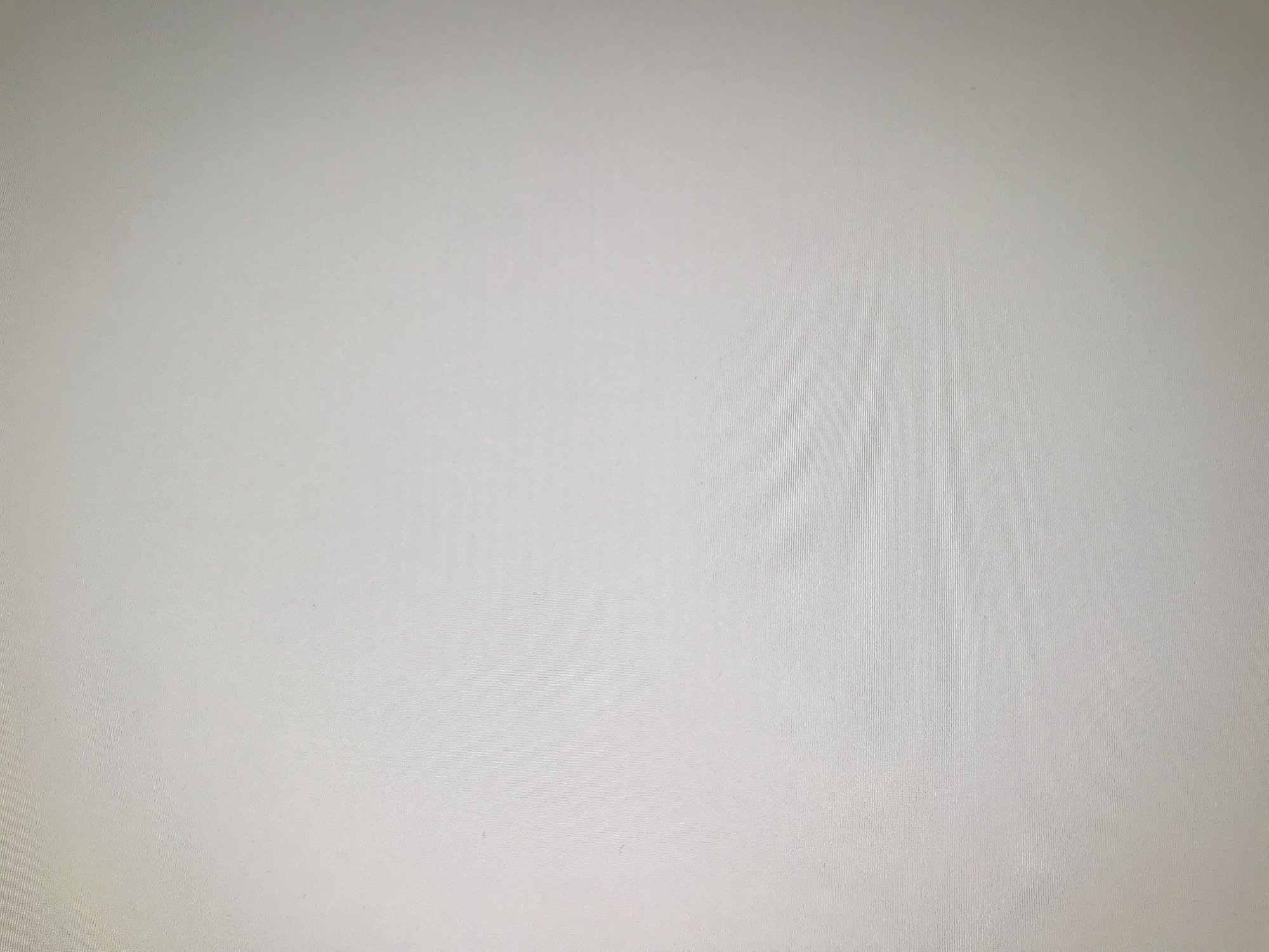

Thanks but are you using it with an M1 Mac and if so do you get the intermittent issue where the lines are out of place in the center?
I am using it with an M1 MBP and I definitely get the intermittent issue with the out-of-place lines. Happens around every ~4 times my MBP wakes from sleep (while plugged in to the LG5K).
Simply re-sleeping and re-waking will fix it -- no need to unplug and replug.
This occurs on two separate LG 5Ks I own, one at home and one at work. It does not appear to be localized to a small set of devices, and is highly reproducible among M1+LG 5K combinations.
In my estimation, the most likely cause is something with the M1's embedded GPU not knowing how to properly handle the dual-output stream over Thunderbolt the LG 5K is based on. (It's basically two displays glued into one, from what I understand, which is how the iMac 5K also works, and is why the iMac 5K can't be used as an external display.)

I'm on a M1 mini with an Ultrafine from the the Dec 2020 batch, see the same issue of out of place lines in the center from time to time but -same here: with a sleep/restart they just go.

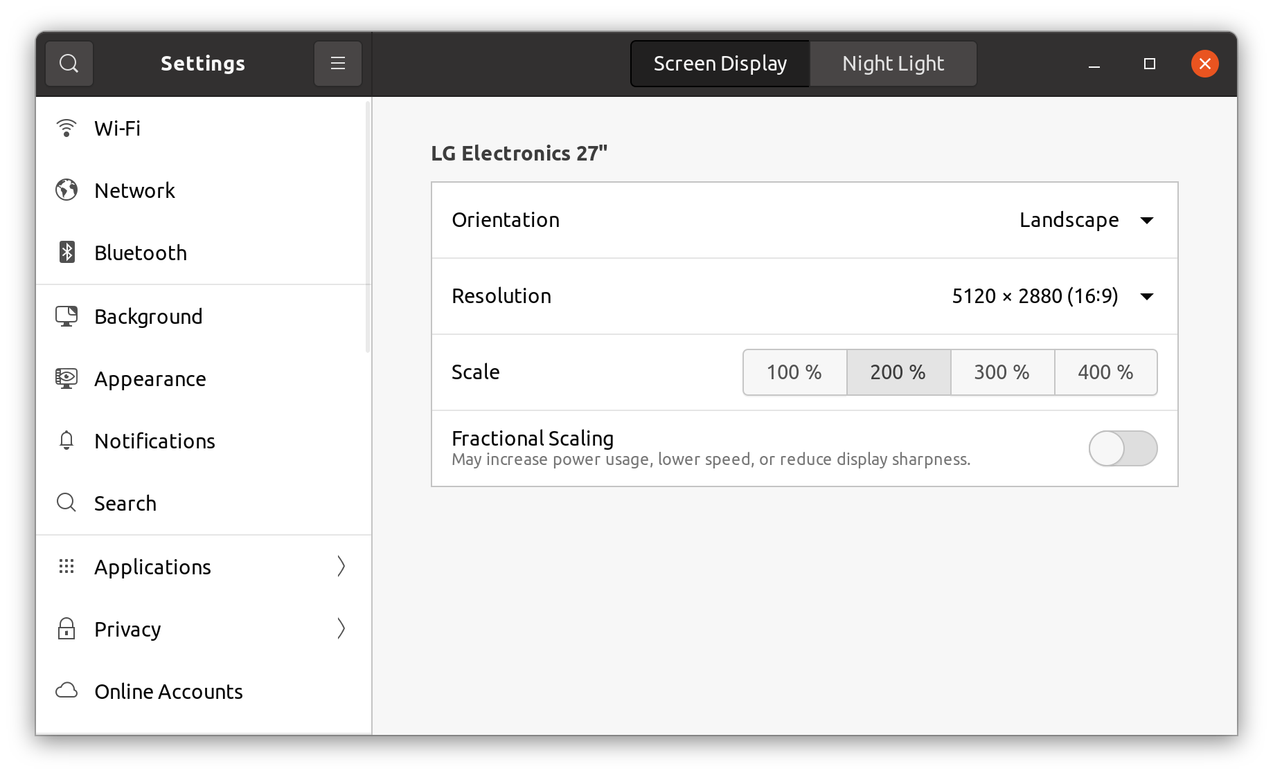

Hi there, I just got a 2016 Ultrafine 5K (27MD5KA-B) and I am using it with my Dell XPS 15 9560 running Ubuntu 20.04 with GNOME 3.34 in X11 mode and happy to report everything just works, perfectly! Full 5K 5120x2880 resolution at 60 Hz, audio, mic, brightness control (using this app: https://github.com/ycsos/LG-ultrafine-brightness ). Connect and disconnect is reliable, and so does putting the laptop to sleep and wake. xrandr detects this display as 2x 2560x2880 panels.
This is seriously the best monitor I've ever seen in my whole life, and I encourages everyone to consider this monitor, even if they're using a PC! Just make sure that your PC desktop/laptop has 2 DP outputs from GPU wired to the Thunderbolt 3 controller (this is the case with XPS 15 series and Lenovo X1 Carbon).
The current monitor market is very sad right now that many are producing 27" 4K (no more 24" or 21" 4K), which is a bad compromise: too big when used at 2x scaling, and too small when used without scaling. Those ultrawides aren't good either as they're either standard 1x ppi or the compromised 163 ppi. We have to use fractional scaling on those displays which only Windows and Android supports well. Even with native support, it is impossible to keep bitmap image sharply scaled at those fractional scaling as you can't defy the laws of physics! Only these Ultrafine 4K/5K from LG/Apple has the perfect 218 ppi where scaling things to 2x is in the "just right" size.

1 - the problem with the lines in the middle is still there (again thanks for the tip to put the monitor to sleep)
